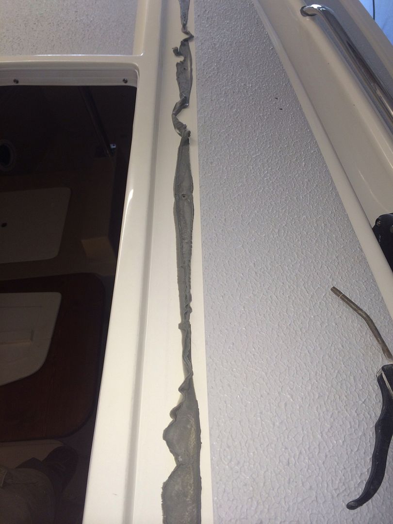

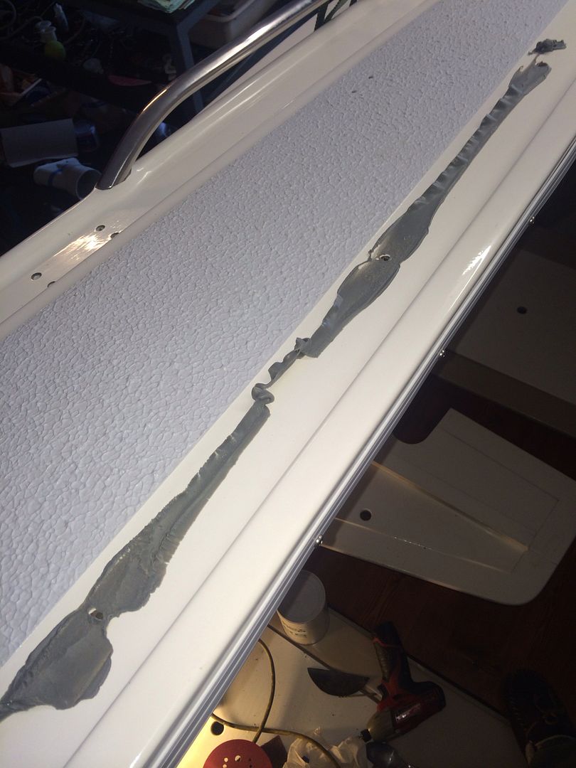

I didn't like the way the gelcoat was denting in inside the cabin where the screws were holding on the new hatch slide rails. I realized that I should have epoxy potted the screw holes exactly for that reason. I also noticed the butyl tape really wasn't evenly squeezing out. I decided to take them off so I can epoxy pot the holes, use fender washers with pan-head screws to secure them, and this time I will bed the rails with 3M 4000 UV (which is what CD recommends over butyl tap. In these pics you can see how the butyl tape only compressed and squeezed out around the screws. I was also be shaving a bit of the lip on the forward facing edge of the sliding hatch because its scraping on the non-skid. As suggested by Roy in another discussion, I'll probably also use a rubber door sweep under behind that leading edge to keep water out in the event of heavy spray or rain while trailering.

The smashed butyl tape was pretty easy to peel off since it isn't old. I drilled out the holes to 11/32 and epoxy filled them. I'll re-pilot the holes and bed the rails some evening during the week when I have time for a short project.

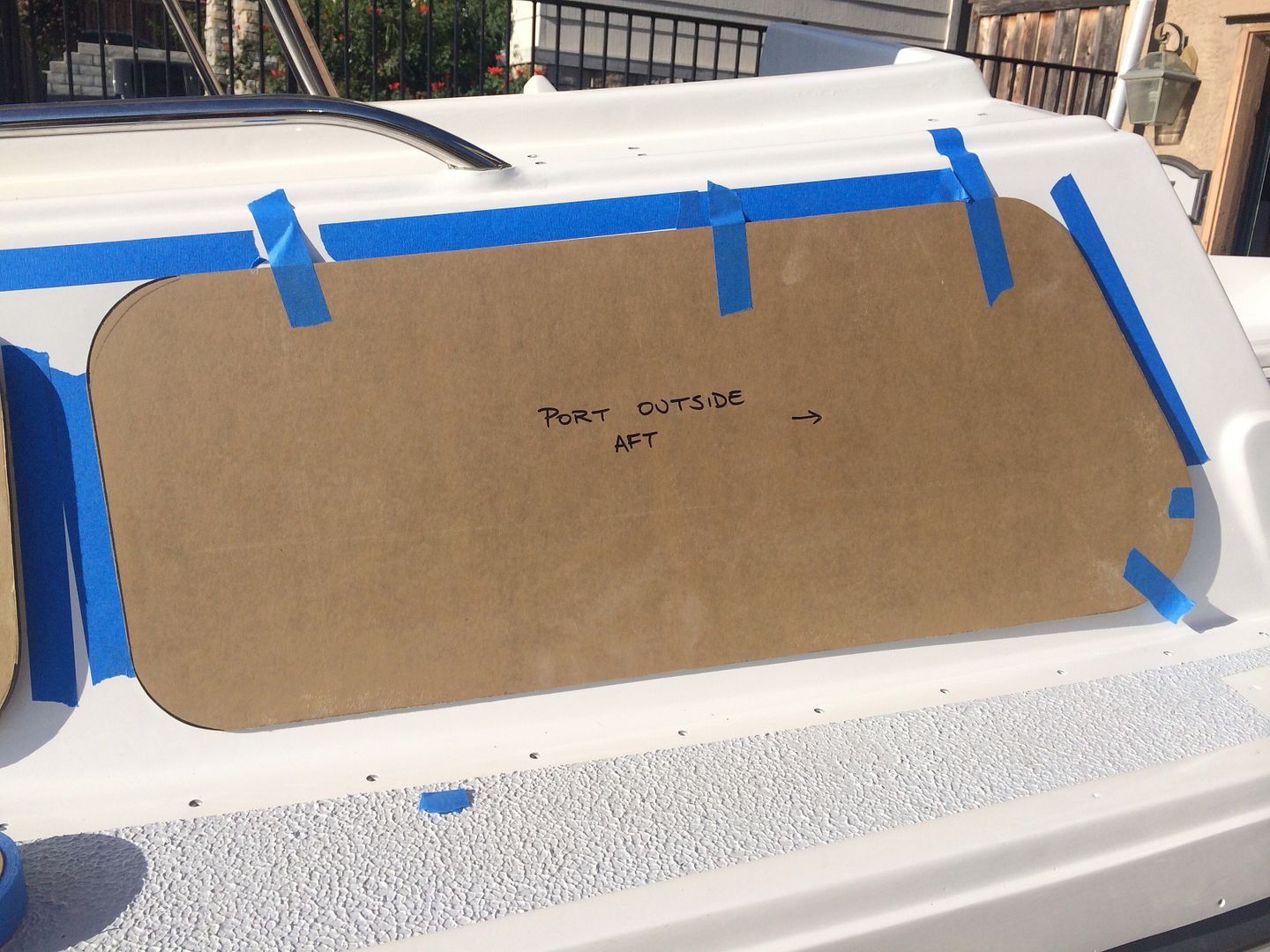

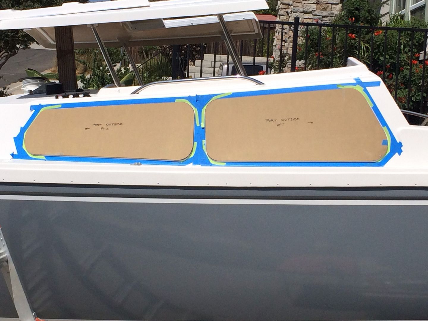

Next up was finally getting to the windows. I cut the Lexan a long time ago and now I can finally get them mounted since all the paint is done. The first thing I did was to position the windows exactly where they need to be and used blue tape to tab them in place. I used tape strips to mark the outside lines so when I come back to place them, with 3M VHB tape, I can place them exactly because I only get one shot.

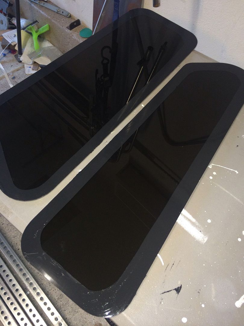

Many boat builders use black paint on the inside edge of the window to hide the adhesive and 3M tape that you would see through from the outside. I wasn't too sure about what paint to use or what its sheer strength would be, so I thought it would be wise to 'paint' on a thin coat of the DOW 795 and let it cure overnight. Then when I put on the 3m tape and mount the windows you won't see anything through the Lexan. I had already marked the inside window cut outs from my templates and checked the clearances when I dry-fit the windows. I used a razor to cut off the protective paper and then used a semi-stiff steel putty knife to glaze on a thin coat of the DOW 795. When I had an even coat I used the tip of the razor to peel up the rest of the main center protective paper, leaving me a nice border. When this is cure tomorrow I'll put the 3M tape about center in the border area. After the windows are mounted fast by the VHB tape, I'll caulk the 795 on the outside and inside gaps.

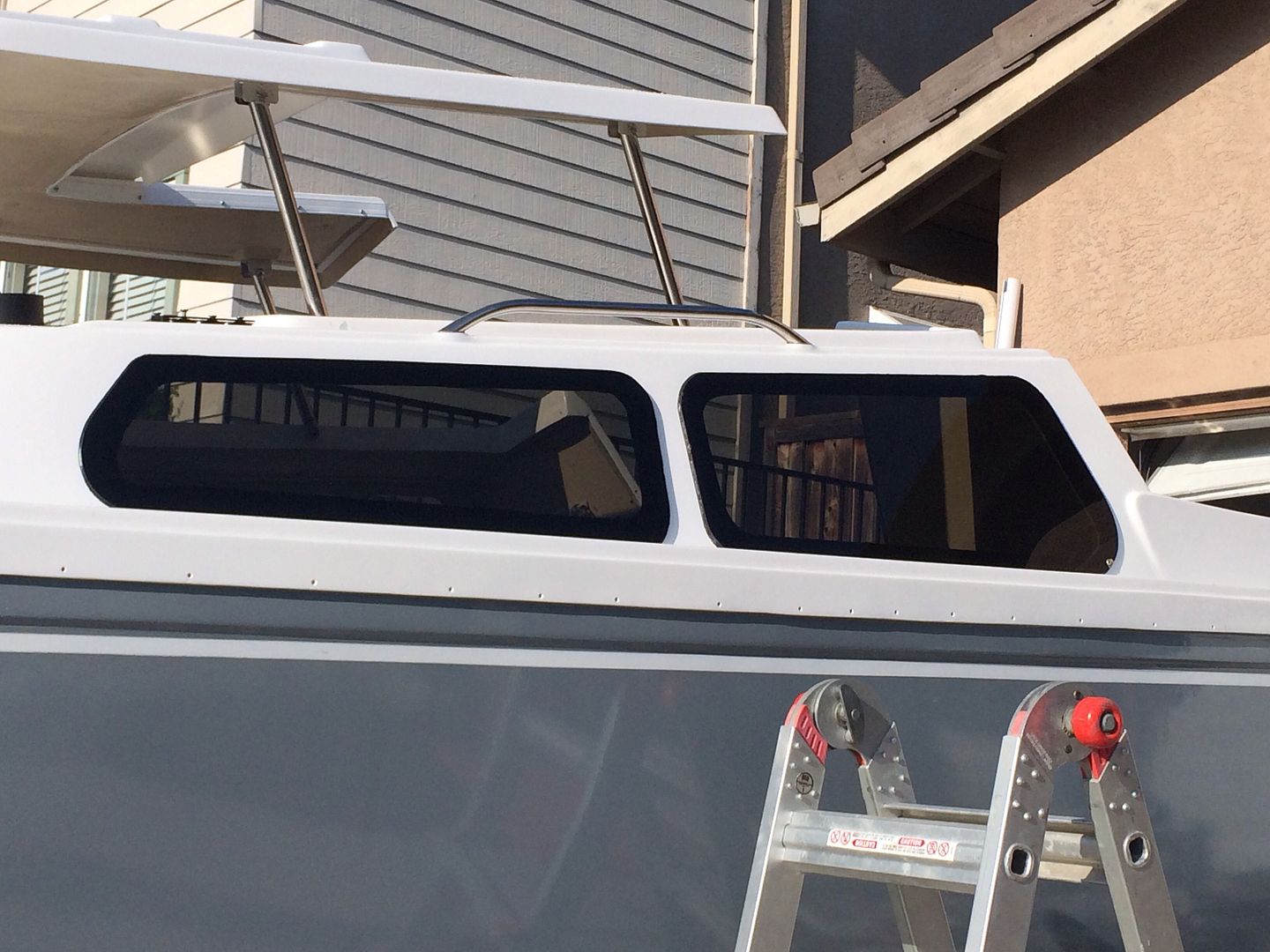

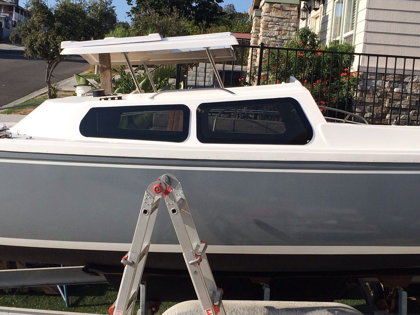

Well, it turns out that using a thin coat of DOW 795 rather than paint was a bad idea. The 3M VHB tape didn't want to stick to it very well. After cleaning with denatured alcohol it stuck a little, but even after pressing it hard with a roller it could be pulled off. I should have tested this theory on a scrap piece first.
I really had no choice but to press on. The tape would stick and had just enough hold that it wouldn't pull off from a straight 90, but it would come away by peeling from the end. I test mounted the rear window and firmly pressed it with the roller. The 3M tape trapped the painted cabin sides firmly with no problem, so I imagine it would have held equally well had I used black paint on the window border rather than the Dow 795. Overall, the window held in place without peeling away accept for the aft bottom corner of the rear window where the cabin has the most curve. To hold that corner I used a #8 half inch screw. I piloted the hole on the bitter outside edge, clear of the tape. I did not go through the cabin wall, and then I over drilled just the window pilot hole so the screw wouldn't crack it. I hand tightened the screw so it just pulled that bottom corner. After that I masked off the surrounding cabin sides so I could smooth the 795 after calking it in the gap. Same on the inside of the window.
Sep 8, 2014
2,551
So after a nerve racking hour or so, I caulked the Dow 795 around the outside and the inside. I used a rubber caulking tool to smooth the bead and then peeled off all the tape and the paper. Looks pretty good and the 3M tape held enough to get her done. The Dow 795 is really the primary adhesive so I'm not worried about the window seal not being strong enough. BTW, the rubber caulking tool was probably not the best, I think I would have gotten smoother results with a wet finger. Maybe I'll try that when I do the port side tomorrow. Its been a few hours in the sun and everything seems to be holding up well.
