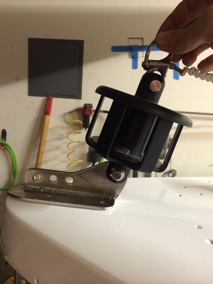

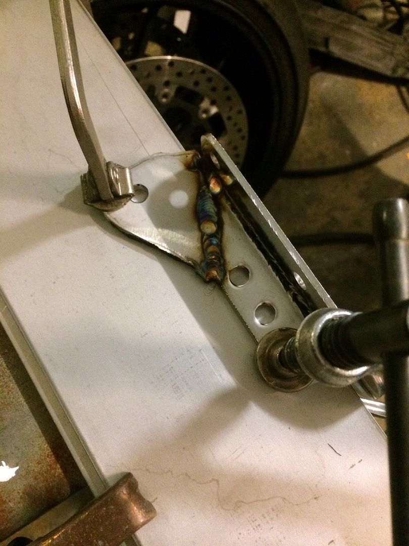

In other small projects... The furling drum needs to be mounted farther back from the forestay than the stem fitting allows. Cap'n Don used a special sized Winchard U-bolt that fits the stem fitting bolt holes. I decided to weld an additional tang on the aft end of the fitting to give me a 5/16" pin hole above and just behind the rear bolts. I traced the profile of the back end of the stem fitting onto some stainless flat stock of the same thickness, then cut it out with my plasma cutter. I welded it to the stem fitting while firmly clamped to the welding table so it wouldn't twist from heat. I refined the shape with my stationary drum sander and a flap disc on the angle grinder, finishing with fine files. Later, I'll give it some time on the polishing wheels.

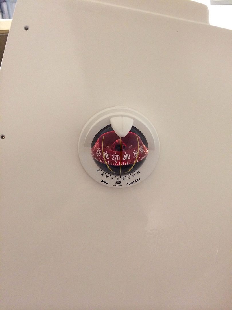

Last week I worked on the Bulkhead Compass. I went with the Plastimo Mini-Contest 2. The Ritchie Venture or Navigator would have needed a bigger hole... even the Plastimo Contest 101 was too big. I decided that making the hole smaller would be easier than making it bigger. I think this compass is a great size, the Ritchie Navigator is HUGE!

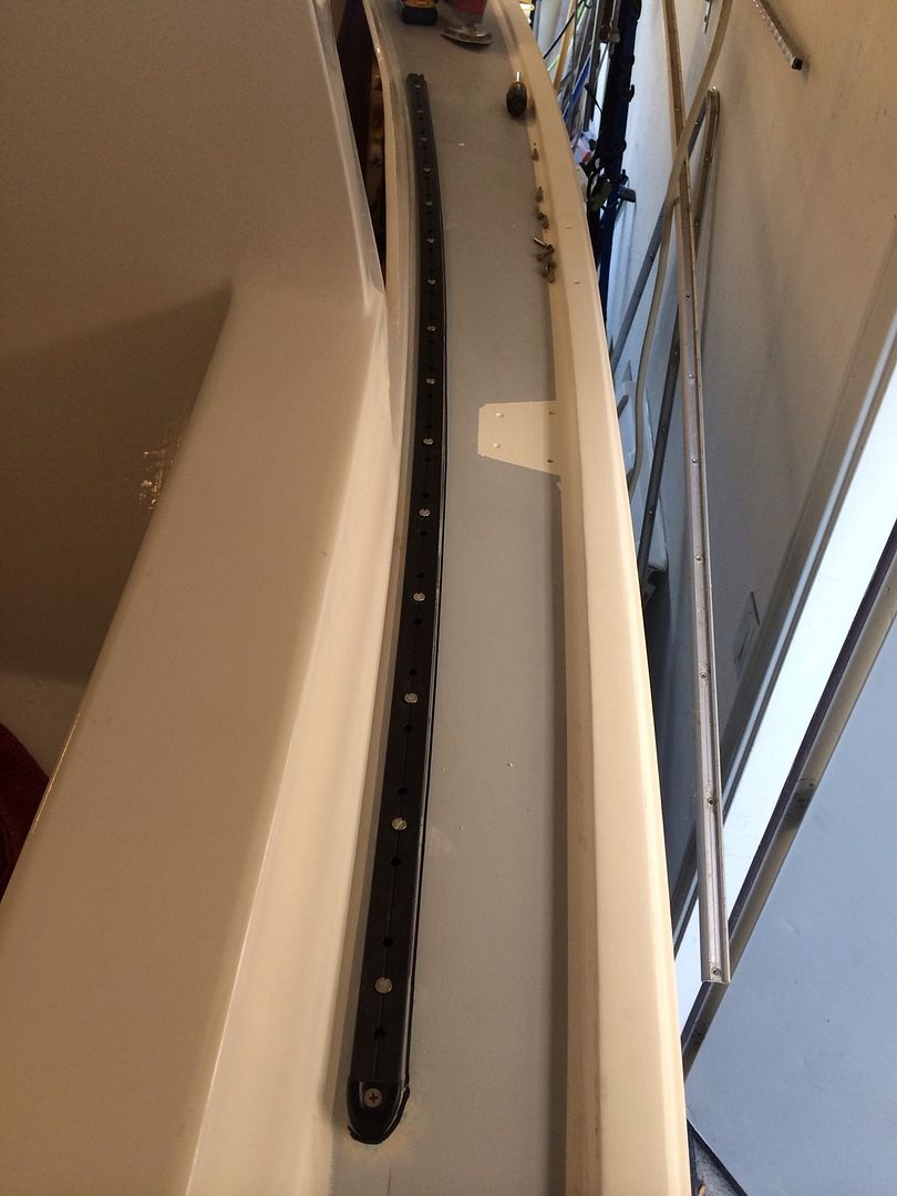

Here are the longer inboard tracks.... All the holes have been drilled for the curve, epoxy potted at 5/16, then re-drilled to 1/8" in the epoxy. After that I was able to repaint the footprint under the track with white. These are 4 feet 11 inches long Ronstan tracks. The thing I like about them the most is that they come with plastic isolator collars, kind of like a washer that hugs the under side of the machine screw head so the stainless never touches the aluminum. For the end caps I potted the hole in epoxy and only tapped the hole for 1/2 inch screws, that way I can unscrew the end cap and remove my genoa car from the end. I still have the shorter 3 foot 3 inch tracks, I'm still on the fence about mounting them on the outboard toe rail. If I do I can just redial the holes, its solid fiberglass so I don't need to pot the holes.

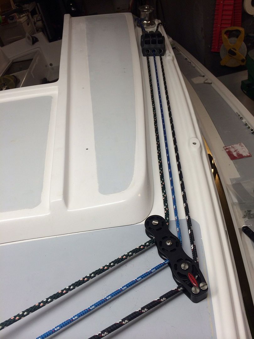

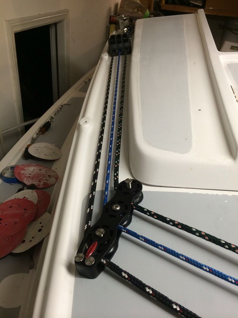

I was supposed to be finishing the last of the gloss white topcoat (first coat) but I got distracted by mounting all the deck hardware so I can make sure all the holes get potted and everything gets masked off. As I mentioned before, none of my surface mounted hardware will be mounted over nonskid, just glossy white surfaces.
I picked the Ronstan triple deck organizers. They are a little less expensive than Harken ESP and slightly more than an inch shorter with roughly the same sheave size, handles up to 3/8" lines. They fit like a glove all the way in the back corner of the cabin top giving me a fair lead down the sides of the pop top. Two important things, the farthest inboard line stays clear of the pop top by about 1/2" and the angle from the deck organizer to the halyard plate keeps the lines clear of where my thru deck fittings will be for mast lights and VHF connector. Nice straight shot to the clutches... All the holes have been over-drilled and potted. In the pics you can see the 'feet' I made from thickened epoxy so the flat bottomed handrails sit flush on the drip-rail.

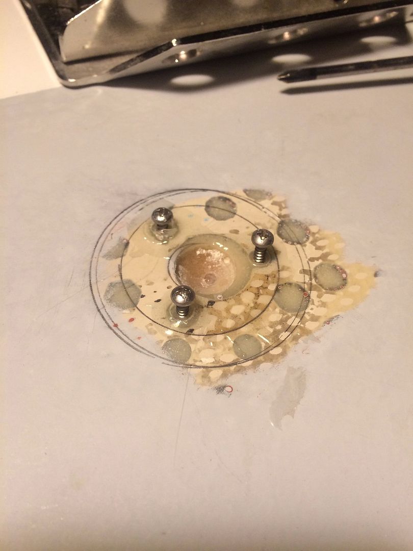

And for my last trick... here is the definition of 'anal retentive'... This is the epoxy filled hole for the mast wiring connector. I got the same kind as the boat had before so the holes were already roughly in same place and epoxy filled from when I fixed the wet deck around the connector. The mounting screws are tiny #4, so when I lined up the position to re-drill the holes I actually over drilled them at 1/8" and not all the way through. Then I used an old ship-wright trick and waxed the screws with chapstick and reset them in the holes with Loctite 5 minute epoxy. When it was hard but not fully cured about an hour later I backed the screws out. Ta-dah... tiny screw holes that are threaded for a sure-footed attachment when I finally bed the housing. This pic shows the screws backed half-way out, the threading goes all the way down so the crew heads will actually touch the deck (5/8" screw). I had to check and make sure they would back out before I took the pick, lol!

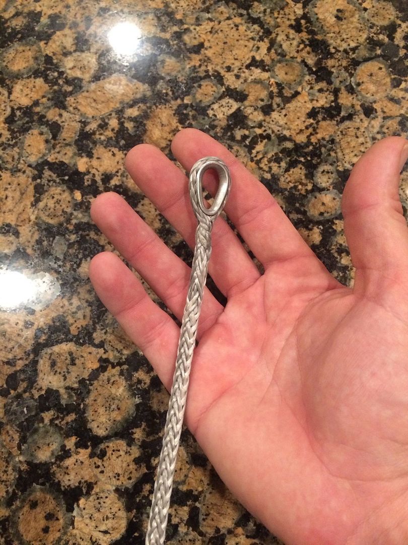

This a brummel lock splice in 3mm heat annealed Dyneema with a closed sailmaker's thimble. So what what do you all think I'm up to now? Besides painting... yes, I'm still fracking painting (groan).

Good guess Gene... close, but not exactly. The New England Ropes STS (Stronger than steel) HSR (Heat Set Rope) is heat annealed under tension, so it's stretch is .6% with very low creep. The working load (40% of breaking load) on 3 mm is 2030lbs, so it is stronger than 3mm (1/8 1x19 stainless wire) by a factor of 2.9! So, on a length that is say 25 feet (300 inches) you would expect initial stretch of just 1.8 inches. Several Riggers who have stretch and break tested this line have noticed you can get most or all of the stretch out of the line by pulling it to only 20% of its working load and letting it dwell for a while, then it just won't go any farther than that even at a higher load. Creep is a different factor but its super low on this line, but still needs to be taken into consideration.
The short story, this stuff is as good as or better than Colligo Dynex Dux at half the price. Actually, Colligo doesn't carry 3mm (smallest is 5mm). Funny thing is, the Defender regular price is almost the same as the West Marine 40% off sale price when I got mine... and for Memorial Day defender is having a big sale! 3mm STS HSR is .87 per foot!

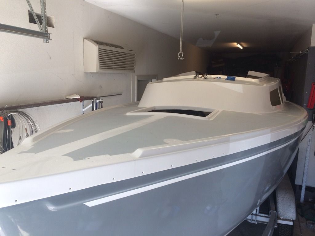

I'm still at it, slowly but surely... So I got the second coat on the outside rails, now I finally moved the hull back inside so I can complete the second coat on everything else. Its getting hot, and I really need to be painting out of the sun. Plus, all the bird crap is REALLY annoying. I'll probably place my order for Kiwi Grip tonight!
