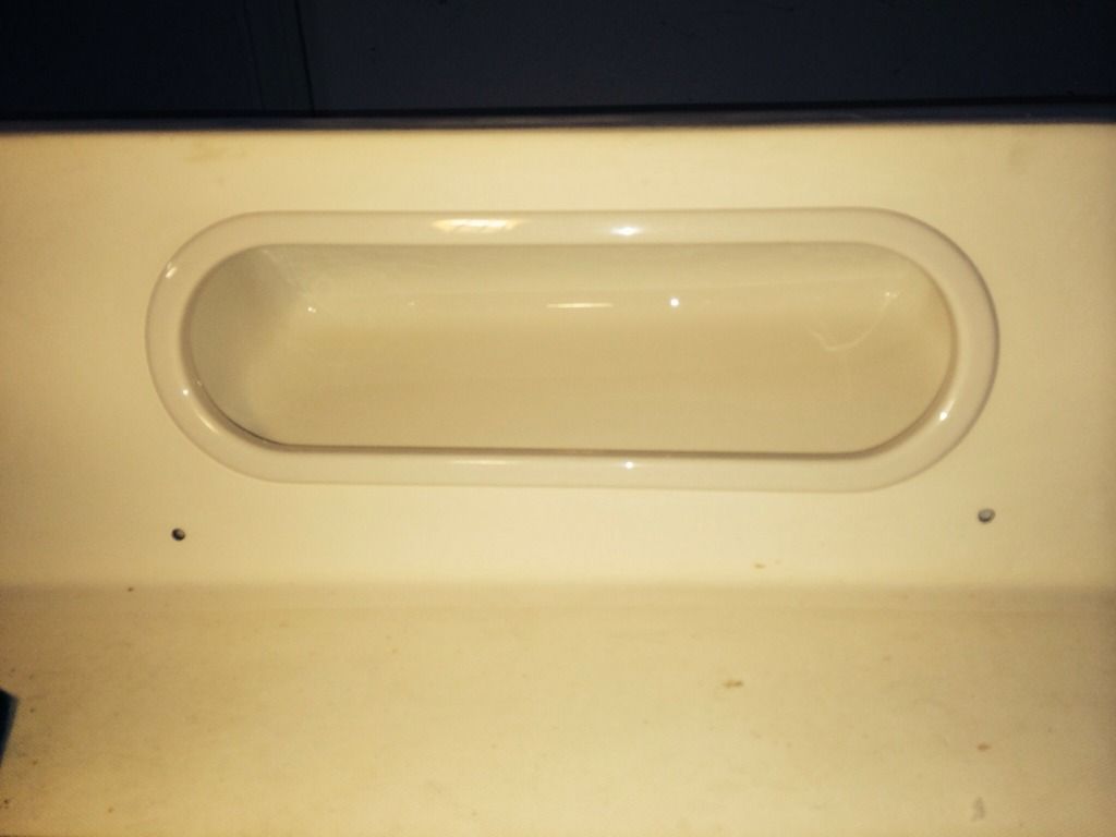

I needed a small victory since the sanding and prep in the cockpit continues... endlessly; so I sanded an painted out the the little stash compartments in the cockpit. I used the Interlux BilgeKote enamel for this because priming, sanding, and then rolling and tipping Brightsides would just be ridiculous. To tell you the truth, I really like the enamel and it brushes out fairly well without a primer on sanded and de-waxed gelcoat. I honestly think it would make a good top-coat for the budget minded. At $50 a gallon it is still cheaper than buying 4 quarts of Rustoleum enamel (I think). Anyway, the trim ring is just set in there for the pic, will be glued in with 4200UV after the cockpit is painted out.

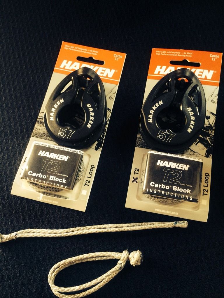

Solution to the new Genoa Cars... The 40mm blocks will only take up to 5/16 sheet. My sheet is 3/8, as recommended by many as being easier on the hands. So it was either get a new headsail sheet in 5/16 or put a bigger block on the genoa cars. Ronstan doesn't make their 55mm Orbit single blocks with the same dyneema soft loop as the 40's, so I found a pair of Harken 57mm T2 single blocks that came a pair of dyneema soft shackles for $37.50 each on eBay. I'm not sure if the soft shackles were supposed to come with the blocks or the seller threw them in for free... The T2 blocks are supposed to come with line or loop, and I had ordered the loop... they sent me the packs with line so I guess they realized the mistake and threw in the soft shackles. That worked out better for me!
The soft shackles were a little longer, so the block didn't want to stand up straight with the rubber collar in its recessed slot on the car. I might get some springs later, but for now I put in a stainless washer that lifts the rubber collar up out of the slot... works for now. You can see a noticeable difference between the two block sizes.

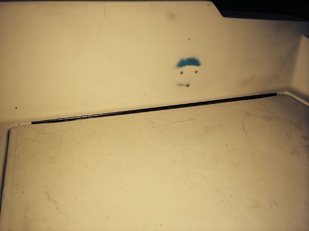

As I progress in painting the primer coat in the cockpit this question circles back on the cockpit hatches, 'what hinge to use?'
I had planned on putting in Stainless Piano hinges. The first problem is that the hinge stock I have on hand isn't actually stainless; no big deal, it was only $8 and good for trial fitting. Anyway, my concerns are this. First, I have to epoxy fill the little recesses that were molded into the lids for the standard hinges to make a flat surface. Second, when in the closed position the hinge leaves are practically flat against one another, so the only fastener I can use are stainless pop rivets. Even with rivets I doubt it will work out, the leaves will still not be allowed to close enough to one another. Also, the space is tight that I don't think I will be able to get my rivet gun in square and tight against the surface when installing. Below is pic of what it would look like (using the non-stainless hinge stock to check);

Today I am going to sand the paint off the inside of the cockpit seat/hatch lids, then add some strips of 8.5 oz cloth and resin just to re-enforce the flimsy outer edges. Later the insides will be painted with gloss white Brightsides. I don't have to make up my mind today, but I will before I paint. I can reinstall the standard stainless hinges, try the piano hinge, or try some Marlon hinges...
Jul 23, 2013
487
1981 Catalina 22 #10330 Bayview, ID
My 0.2? Don't overthink it. Just put the stock hinges back on. It's not an heirloom hope chest : ) They worked for 35 years. Save your time, money, and creativity for other places. BTW, I'm putting gas struts in mine now, so there'll be a blog post on that in the near future.

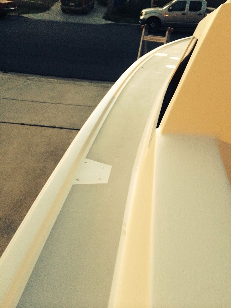

This update is a week late, below is what I did last weekend. The extra day (Presidents Day) was a huge help, although Monday I used mostly for clean up.
So the primer on the decks and caring top, including rub rails, is now complete with the exception of the inside of the cockpit. I had to buy another quart of primer (Thank you SBO for quick shipping). When I started painting almost a year ago I had purchased a gallon and that should have been plenty. It really would have been more than enough but I lost quite a bit of paint to evaporation and skinning in the can. My advice is always buy extra quart cans at the big box store and divide up your gallon right away... down the road you won't have a dried up skin when you open a fresh quart.

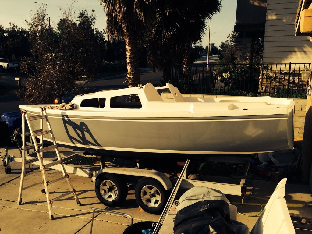

I'm in class this weekend so I won't get much done... I just need to complete the priming in the cockpit and then I can begin the wonderful task of sanding with 220 by hand. This step is critical, it takes brush strokes or errant contaminants out of the primer while giving me the chance to check for nicks or pin holes that require filler before top-coating.
