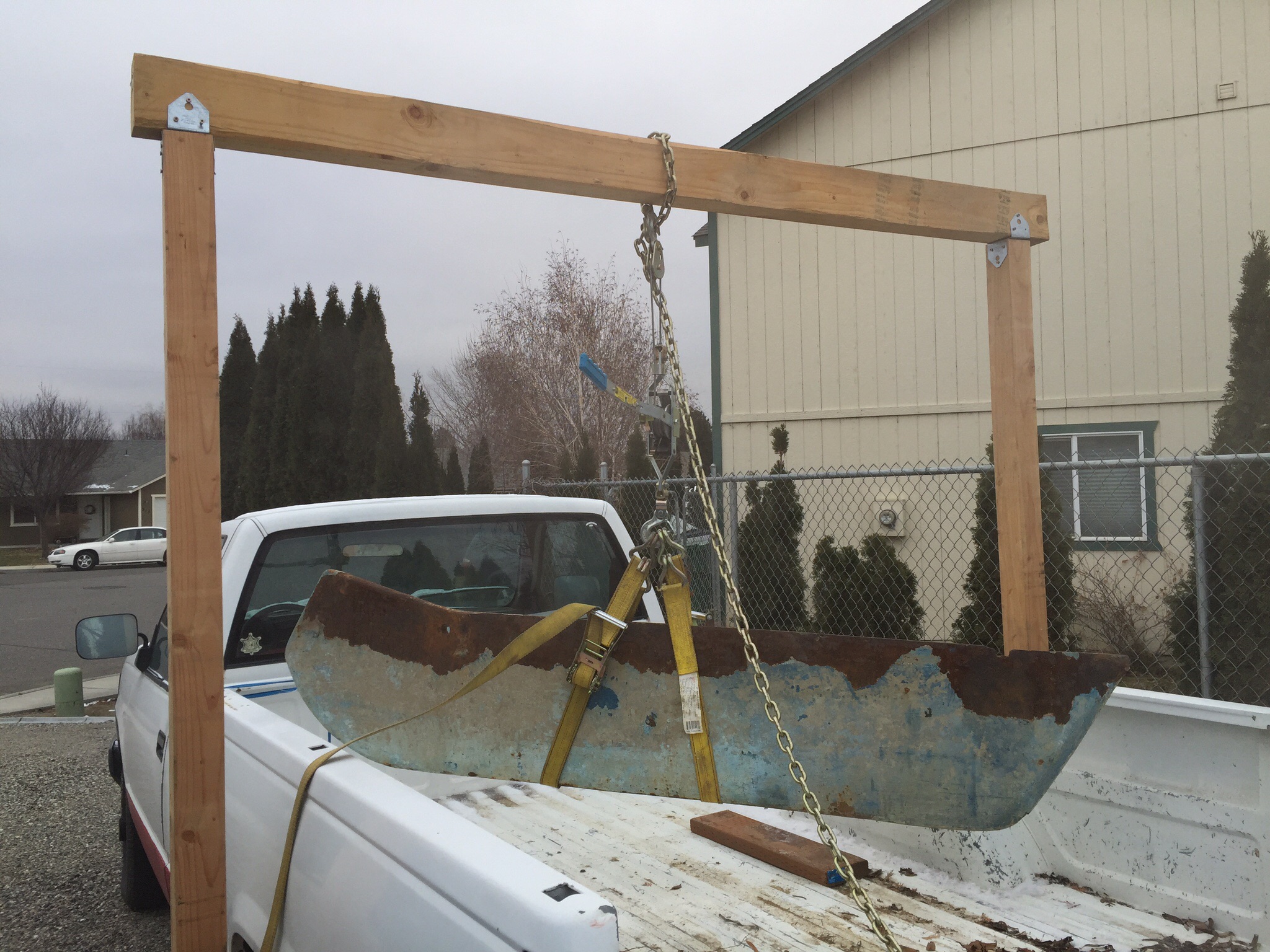

It could be worse: 18 degrees and snowing and I'm moving my keel around! Jealous of the San Diego weather.image.jpg

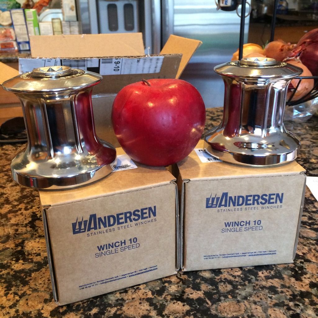

My Christmas present from my sister arrived a little late... Not sure what was going on at Atlantic Rigging Supply, but these winches were ordered in November and finally arrived on Jan 14th. No worries, they are finally here and they look great. I think the Andersen winches are a best buy, a stainless steel drum which won't fade like anodized aluminum will and won't eventually corrode and flake like chromed bronze. At $159 each I think they are a great deal, pretty much exactly the same size and mounting bolt pattern as the stock ARCO 6's that were on my boat.
FYI, I noticed Atlantic Rigging Supply raised their price to $189, but West Marine now has them for $159. I was going to move my ARCO 6's up to the cabin top as Halyard winches, but I like these Andersen 10's so much I just might buy a second pair... boat jewelry!

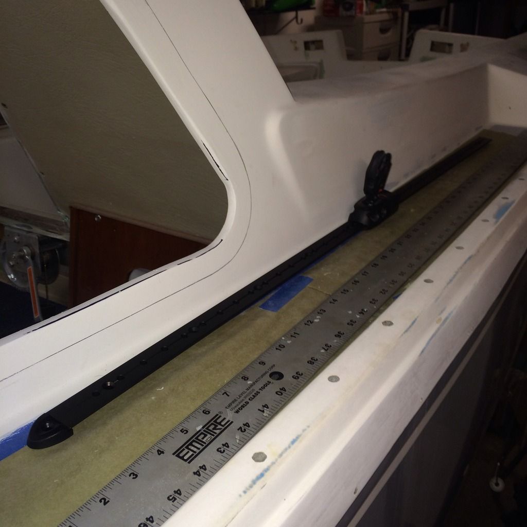

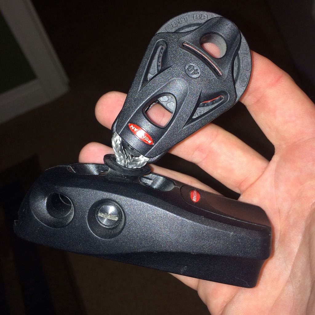

Some more post Christmas goodies... Inboard track and new genoa cars. The Ronstan cars have push-button locks and come equipped with 40mm orbit blocks. The blocks take a max line size of 5/16, which is probably why they have been on sale... I've been watching the sale price steadily drop until they reached $39 each, at that price it is worth it just for the cars and I can swap out the blocks later. My sheets are 3/8, I already test fit my lines. 8mm still works well but thats what I got for halyards, the 3/8 for the sheets is for sure too big. Worst case, I can switch down to 8 mm or 5/16 sheets.
The tracks are only 3 foot 3 inches (39") vs the OEM 48" outboard tracks. As you can see in the pic I'm going to mount them with a stand-off from the cockpit combing to the rear of the track. That way I can still slide the cars off the track from the back, but the leading end will have the tapered tip on it. I figure my most extreme lead angle won't have me running the car that far back anyway, and I'm only 3 or 4 inches shy of the original track footprint on the front end. I won't permanently mount the track until I pretty much have all the rigging set up as well as my bimini top, just in case there might be mounting hardware conflicts.
The whole deal with 2 39 inch tracks and 2 genoa cars came in at $215 with free shipping;

Luke, can you tell me what the original measurement was between the bow fitting and the forward end of the genny track?
Maybe it's just me, but it always seems like the genny tracks on my boat are way further aft than they should be.
Sep 8, 2014
2,551
Catalina 22 Swing Keel San Diego
Well Gene, by the way the crow flies (which is a tape measure roughly straight from the end of the outboard track to the bow/stem fitting its about 12 feet 3 inches. If I curve the tape along the inside edge of the toe rail I get about 12 feet and 6 inches.

Winches that pretty could make a man want to upgrade his boat in order to keep up......
Thanks, man. My straight-line measurement is only slightly longer, at 12' 8".
