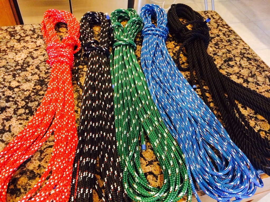

All new Running Rigging
Today is the annual 40% off Bulk Rope Sale at West Marine. First of all thanks to Stingy Sailor for his detailed blog post 'All Lines led Aft' which summarizes everything and includes a breakdown of each line and length. As he points out, you can shop many great deals online but the 40% during this annual one day sale at West Marine still beats those prices.
So I pretty much got exactly the same stuff. The New England Ropes VPC hybrid & Stay-Set Yacht Braid are great values and let's face it, for the blistering 6 Knots I'll get in a puff on my C22 there is no need for far more expensive exotic race fibers.
I only made some slight changes from Stingy's list of lines & Lengths;
- I don't need a Headsail Downhaul since I'm using a wire luff headsail with a Harken Small Boat Cruising furler, however I bought the line anyway since I need the same size for the furling line.
- I'm going to do an internal Main Outhaul for 2 reasons, to reduce clutter on the boom and because I had to shorten my boom by roughly 3/4"... The screws in the boom end cap were so corroded they broke off so I had to cut of the old cap and replace it. To make sure I have enough room to pull on the out-haul I am going with the internal set-up. This changed the required line from 5 feet to 25 feet.
- I'm not going to use a topping lift, going with a boom-kicker instead. Further simplifies clutter on the boom, plus having a split back-stay it ends up being in-line with where the topping lift would go.
- I didn't get the line for the tiller lock. If I get a new Tiller Tamer it will come with new line.
- I added some inexpensive 3 strand black nylon line for my mooring lines and fenders, since it was also on sale.
- I didn't get anything for a Cunningham, main Downhaul, or any Spinnaker stuff (since I have no chute anyway). once I get all the other rigging set up I will address these other things.
I kind of went off Stingy's suggestions for a color scheme to break things down but added my own flare based on what colors were available. I decided to buy all solid color lines because, well, white lines get dirty! Lines that are same color & same size were added together and cut in one piece because all lines had enough extra added in for splices and fudge factor... so later as I rig each line I can cut and splice more precisely and have less waste.
Here is a break-down of the lines and the sale prices;
VPC Hybrid 8mm Red (65 feet @ .70/ft) $45.50 - Headsail Halyard
StaSet 5/16" Black (60 feet @ .72/ft) 43.20 - Covers Boom Downhaul, Boom Vang, and Mainsheet Traveler
StaSet 3/8" Green (45 feet @ .89/ft) $40.05 - Main Sheet
StaSet 1/4" Blue (125 feet @ .49/ft) $61.25 - Covers Mainsail Internal Outhaul, Jiffy Reefing, Continuous Furling Line, and I left the 10 feet for the Boom Topping lift in there for extra
3 Strand black Nylon 3/8" (50 feet @ .51/ft) $25.20 - For 2 mooring lines and lanyards for fenders, plenty of length added for fudge factor and splicing
Not Pictured, but ordered because they were not in Stock;
VPC Hybrid 8mm Green (60 feet @ .70/ft) $42 - Mainsail Halyard
StaSet 3/8" Red (70 feet @ .89/ft) $62.30 - Headsail Sheet (enough to cross sheet)
Total with tax = $345.41
I could do the math on the regular prices before the discount, but I think I would have been around the $525 mark had they not been on sale.... so not bad eh?

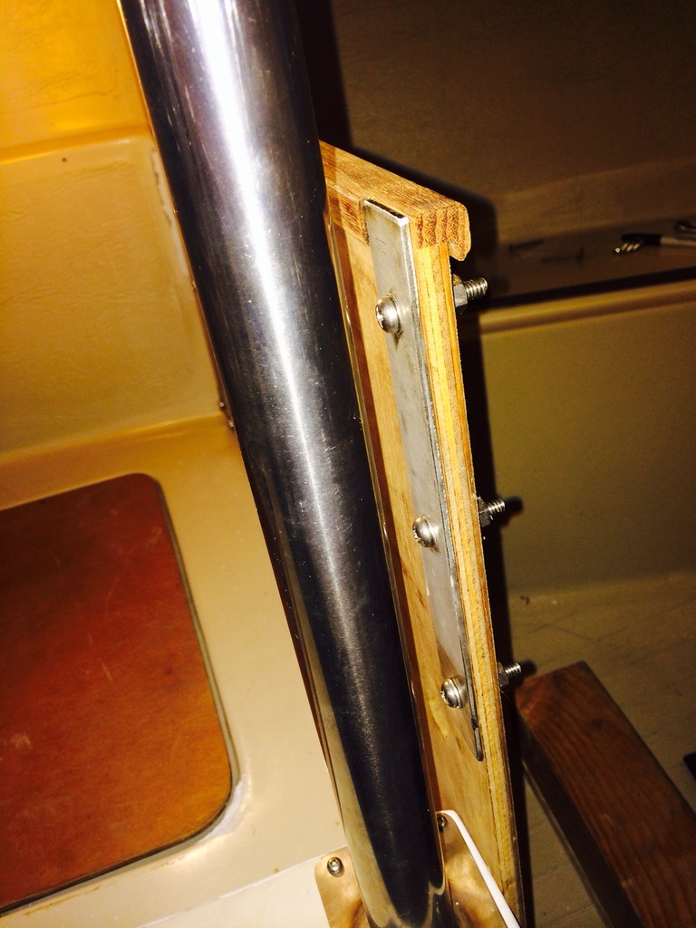

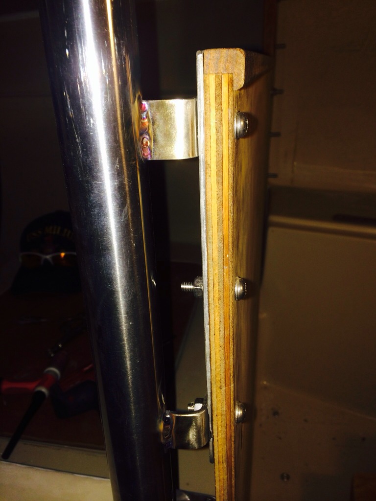

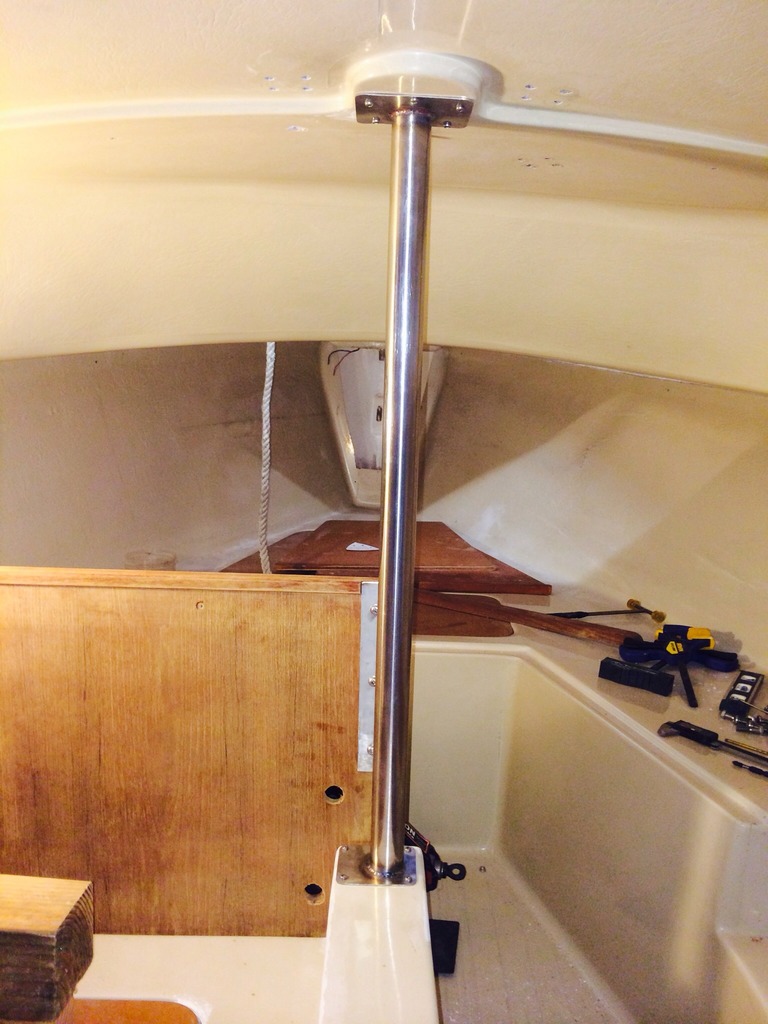

Finish welded the new stainless compression post today, finalized the top bolt that goes through the mast step and deck. I upgraded it from the flimsy 1/4" lag screw to a 3/8" ARP stainless 12 point.
I just have to finalize how the wood bulkhead will be supported by the new post. See third pic. I don't want the two parts permanently welded together. I think I will hand fab some small right angle brackets that will line up with the three 1/4" bolts on the flat stock.

My hull flexes enough, that I wonder if this method would provide sufficient lateral support without the welds breaking over time.
Thoughts?

I'm not familiar with the construction of your hull and where the flexing is taking place, but all things being equal in deck-stepped mast sailboats of this size then go by the following;
- Every deck-stepped mast hull has a compression post to keep the cabin roof from collapsing in. The tension of the shrouds and stays are trying to shoot the mast through the hull as if it were an arrow, the hull being the bow, and the shrouds the bow strings. If there is flex in your cabin roof then the compression post may be too short even if only by 1/8 inch. I used a a jack to flex the roof up to place the compression post so it is pre-tensioned when installed. If you have you rigging down on your boat and you try to remove your compression post you should have to use a jack to get it out. If it slides out with no problem, then it is too short.
- The welds in this example will not crack. Steel, even stainless, is much more ductile than other alloys like aluminum. They will flex to a certain degree without cracking. In this application all of the force is in compression, straight up and down on the tube of steel, no lateral stresses are placed on the flanges where the welds are. If it was two tubes welded together in the middle, that would worry me.
- Look at the previous pics in the thread where I extended the chainplates. That is another area where you could do something similar which would take stress off the hull. The extended chainplates tie into the lower hull liner, equalizing the pull of the shrouds to the hull structure rather than just yanking on the floating bulkheads. This is a common upgrade for racers.

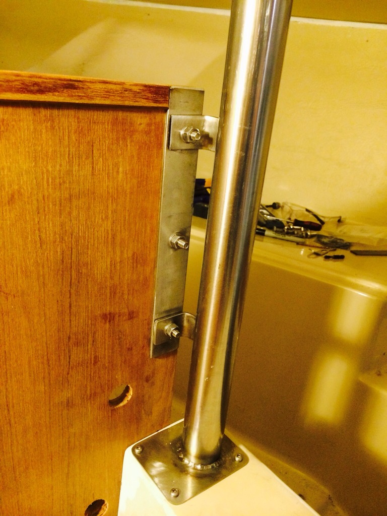

It was a lazy Sunday, I fiddle farted all morning and lolly-gagged all afternoon but I managed to finalize the compression post by fabricating two right angle tabs and then weld them into place. These give something for the port floating bulkhead to bolt to where it used to screw to the old wood compression post.
This set up is amazingly solid, if you grab the new post and heave on it the whole hull shakes... exactly as designed. This finishes up the major work on the interior. I will take all this back out and then I can finish up the last bit of polyester filler and shaping and then get my gel-coat repair guy to do the color match and patching. After that I can pretty much put all the teak trim back in and button up the interior!

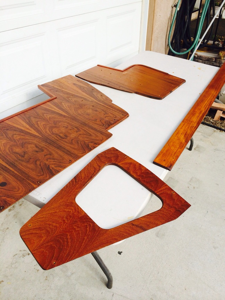

I've been pretty slack the last 2 weeks, doing work in very small bursts. The gelcoat repairs are almost done. I think I'm going so slow because my very short attention span doesn't mix well with all the sanding involved. I've also made several mistakes which require several touch-ups, but I guess that is what I should expect in the learning process. Now that I have the process worked out I would be quicker if I had to do it again.
I also got going on the Cetol of the interior teak. Looking good so far. I am only doing one coat on the interior teak just for the color followed by a couple coats of varnish. No need to go crazy, I'm not trying for the 'Bristol' finish. What I have is still 1000% better than the way it was.
If I keep the momentum going this week into the weekend I should have the interior put back together over the next 7 days.
