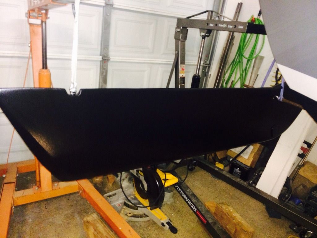

Keel & Keel Pocket were hot coated and bottom painted. Probably going to wait till the weekend to final mount the keel. I want to give the paint plenty of time to cure so I don't gouge it up.

One can only observe your work with awe and envy. A remarkable job sailor!

Dammit man, that is just SO pretty!

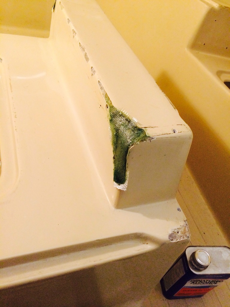

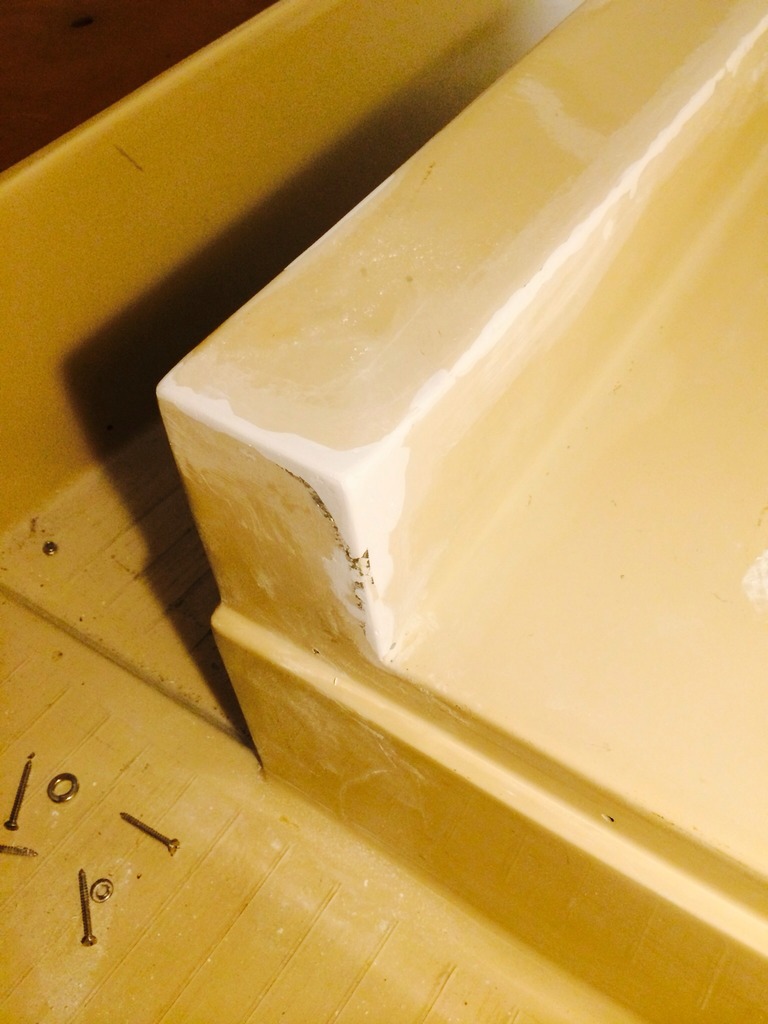

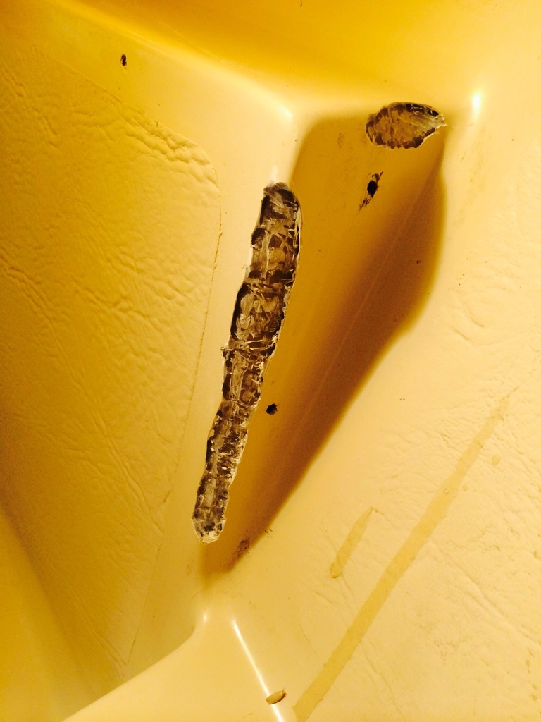

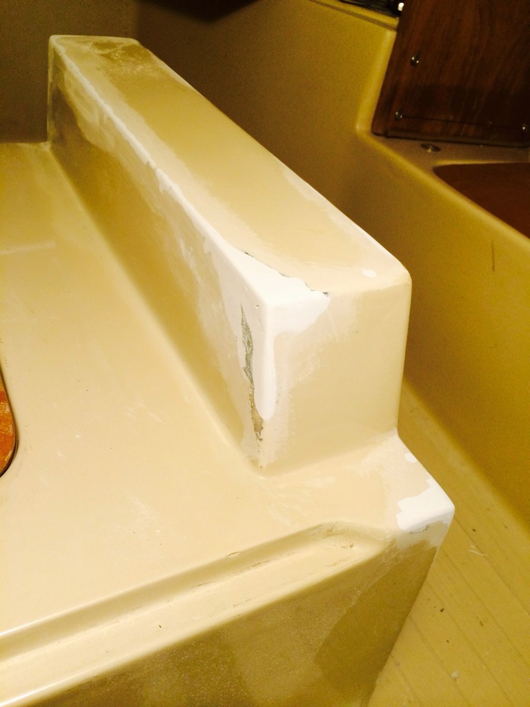

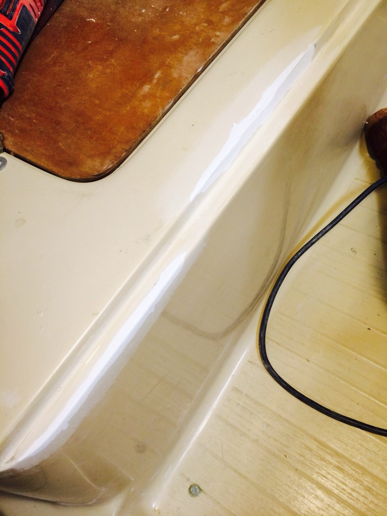

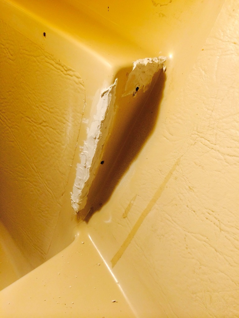

I'm also working on the interior. The gelcoat repairs is pretty much the only thing I really need to do before I can put all the teak back in. I picked up a pint of Evercoat polyester filler to kick start this.

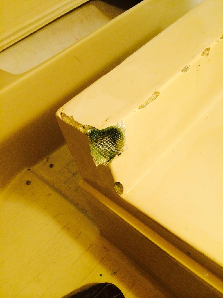

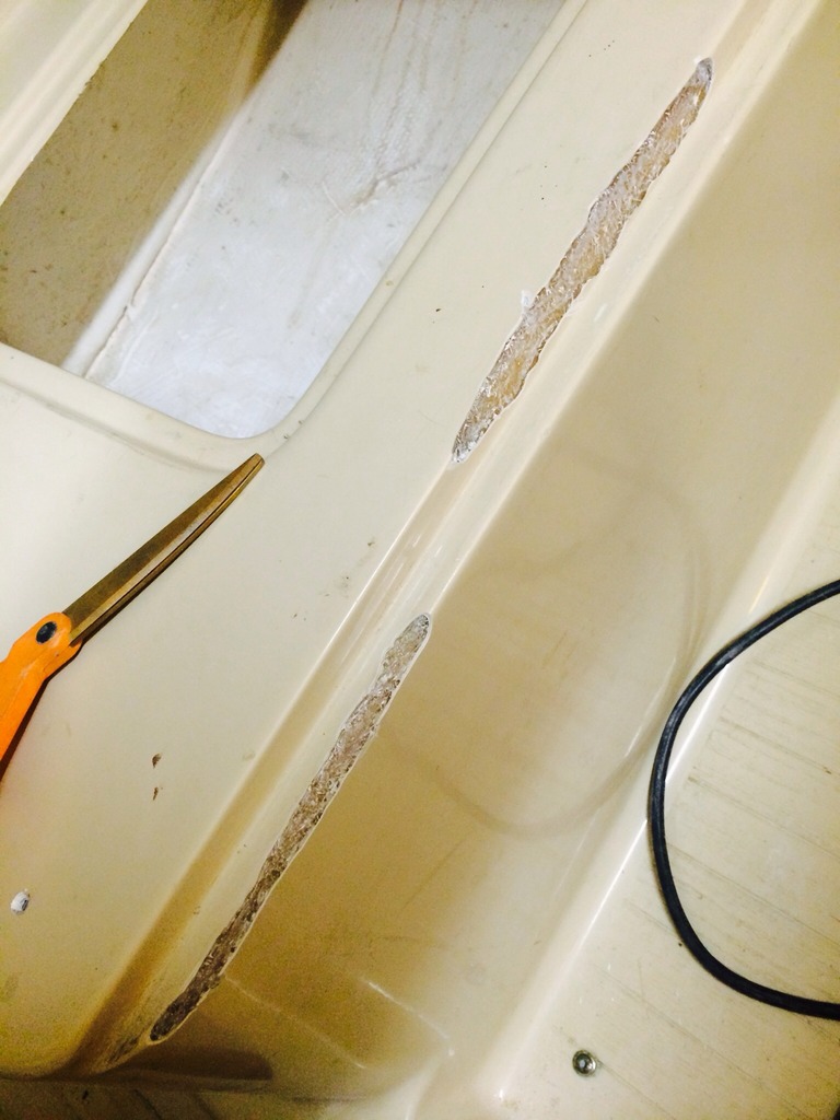

For those of you who might have missed it before, there was damage to the interior tan gelocat on several hard edges. This is a factory flaw; the gelcoat is sprayed in the mold and then they hand lay fiberglass followed by chopped mat. If they don't carefully get the glass down into those 90 degree edges you end up with voids. They are really weak and break easily, especially because those edges are the most vulnerable to impact!
Below I broke the pics into time lapse for each section. First I used a very light hammer with plastic tips to tap the edges and located additional areas of voids, breaking away the gelcoat. I sanded the areas with my dremel tool and the regular sanding drums. Then I could apply filler, which went on in several coats and then sanded to shape each time. I'm planning to have a local Gelcoat repair guy come by the shop and apply the new coating, probably he will mix the color by eye. I've had this done before on a Jet Boat I had in 2007-2008. Still less expensive than buying a pint of color matched gelcoat.
The two areas on the keel trunk needed more extensive repair. the voids were bad and the way the molds come together was a mash up mess inside. I used some Bondo Brand polyester resin I've had in the shop for 5 years, and scraps of the 8.5 oz cloth. The resin had to be strained through a wire mesh, but I did a test batch and it kicked off fine. I like the Bondo Brand polyester resin because its kind of a honey brown color and turns green as it cures with the MEKP catalyst. You always know you got a good mix when you see that consistent green, and Bondo resin is cheap at WALMART! Keep in mind, I only use polyester resin is non-critical, non structural repairs like this one which is strictly cosmetic!

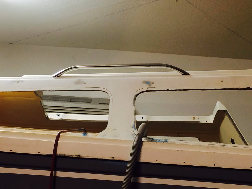

Here is a sneek peek at something else I am working on;

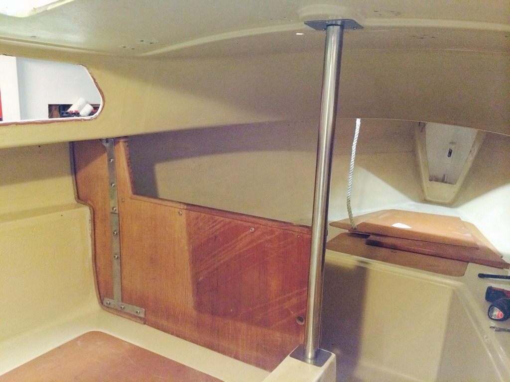

Today I fabricated the new stainless steel compression post and the heavy duty chainplates. Nothing is welded yet, just mocked up in place. I still need to get my new mast-step and halyard plate, then I will weld a stainless flange nut on the inside of the upper mount plate. Once I make sure everything is square and plumb I'll tack all the components in place before removing to drop my finish beads. I also still need to cut the access holes so I can put backing plates on the lower horizontal of the two chain plates.

James, those are 24 inch stainless grab rails from West Marine. They are mounted farther outboard than the original teak rails so I have room to mount a triple rope clutch for lines led to the cockpit.

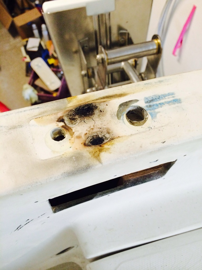

When its perfectly ok to set your boat on fire...

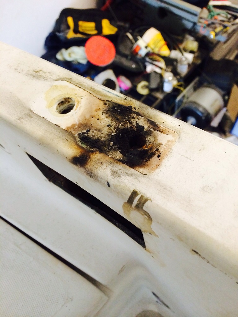

I'm trying to get all the projects done that require serious modifications or other work that stands in the way of painting the deck. One of these projects in particular has the potential to catch the boat on fire, and it did!
Don't worry, it was a tiny flame that I blew out pretty quick but it was a necessary evil. I had to do this before I painted, this is why,

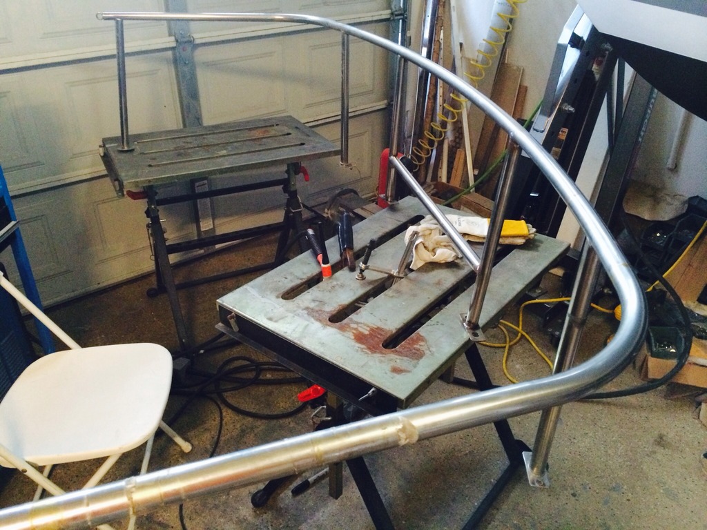

So what in the Sam Hill would I be doing that would catch fire to my transom? Welding of course... It had to be done in place with the stern rail installed. There is so much variation to these things and nothing is truly square. So anything I want to modify or add to it has to be tack welded in place, actually as many tacks as possible to ensure the metal does not move during finish welding.
I'm not quite done yet, I need to pick up another pack of 3/32" 308L Stainless filler rod. I welded all the tacks with .045 rod (which is really thin). This is fine for tacks, but the finish welds just eat up the filler rod so fast and don't fill gaps very well. Anyway, its mostly done.
Before I show this installed on the transom you all can chime in on what you think the two major upgrades that this new stern rail gives the boat;

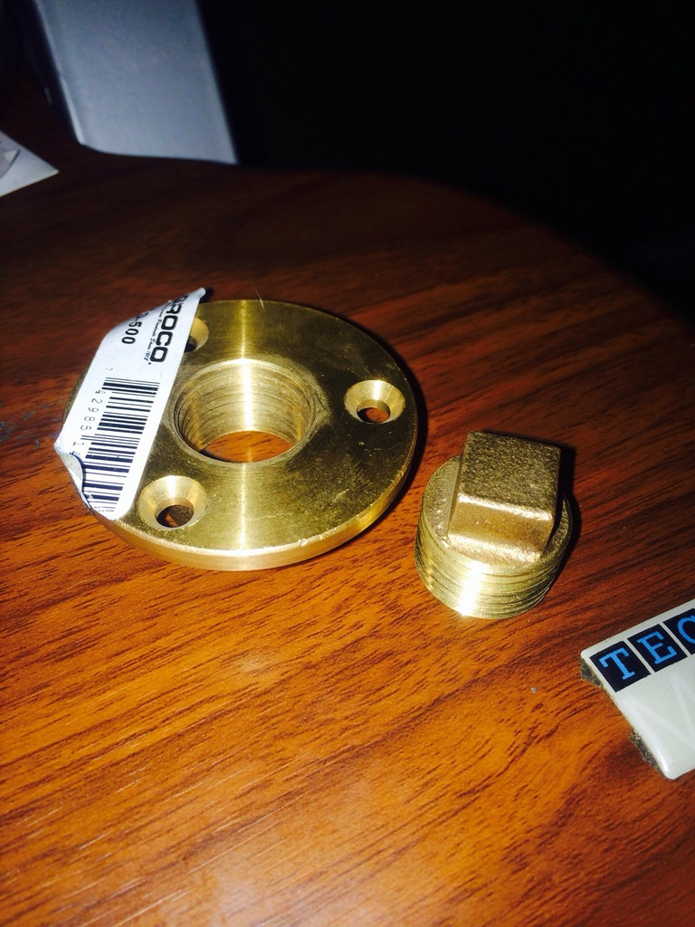

So I started looking for some type of fitting that I could use that was a thru-hull but I would be able to screw a bolt into it from the bottom of the hull, it had to be bronze, and of course it had to be water tight, LOL! So after a little searching the old inter-webs I came up with this;
This is Garboard Drain Plug From Groco (TH-500), it costs $11 direct from Groco, but there are other online sellers who have them as cheap as $8.50 or so.
