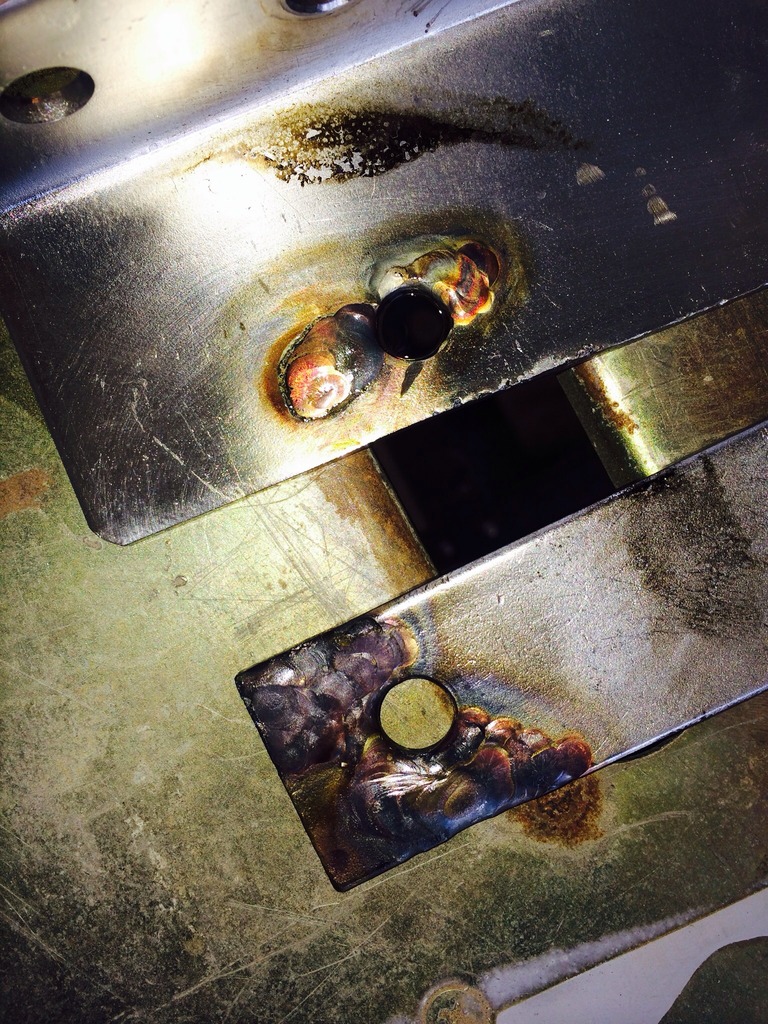

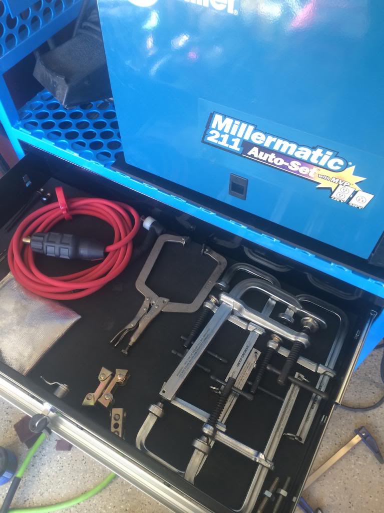

I actually did these a few days ago. I love any chance I get to fire up the TIG welder. The two repairs are on one of the Tiller Straps and one of the pieces of the Motor Bracket. In each case the PO had cut off a bolt or nut and the grinder or hacksaw gouged into the steel. Simple matter of filling the area with small puddles of 308L filler rod and then grind/sand smooth.
The first and second pic is the custom welding cart I built just over year ago. It holds my MIG & TIG welders along with my Plasma Cutter, two gas bottles, and has a tool box drawer for consumables.

The next pic is the gouges in the steel with the weld puddles. Later you will see them ground flat and polished smooth.

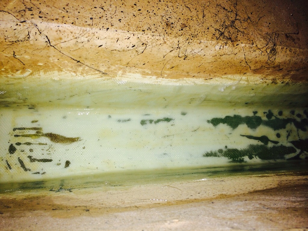

Now that the bottom job is done I am relieved to get back to some small repair jobs that don't require 80 steps over several days... Here is where I fixed the port cockpit combing I had mentioned before, someone with a heavy foot had cracked it. It was repaired (poorly) and covered from the top with grip tape. Easy job with the hull inverted; I just sanded the area well - my oscilating tool with the triangle sanding pad was perfect for this job. I have plenty of that 8.9 oz cloth left from the cut-offs when I did the bottom job so I cut 3 rectangle pieces 10 x 24 inches and layered the box section. The damaged area was only maybe 2 inches, but I decided to re-enforce the entire box since it seems that combing is the most popular first step into the cockpit and was generally too flexible to begin with. The starboard side is not damaged, but I plan to do the same improvement to that side for entry and egress when starboard side to the dock.
It was a quick job, less than hour... it tool longer to sand than it did to lay the glass and resin in. You can see hints of the cracks to the center in the first pic;

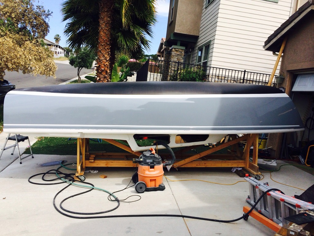

Topsides paint preview
First coat... actually, 1.5 but more on that later. The boot-stripe and sheer-stripe are still primer.

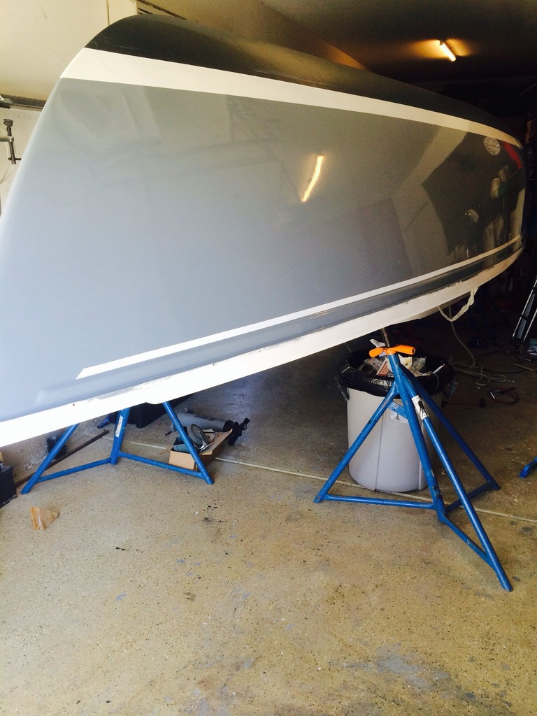

I put on the second coat yesterday, no need to post another pic because it really looks the same. Only problem is I'm not happy with the results at all. For some reason the last coat did not tip-out as well as the previous coat. I'm not 100 percent sure what I will do just yet. I have plenty of paint to do a 3rd coat if needed, but I don't want to repeat the same mistake and end up with streaks again.
I went over everything with the Interlux tech rep... I think I will paint in the gloss white in the boot stripe and cove stripe then let it cure for a few weeks. In that time I'll get the hull flipped back over and on the trailer, and get the transom painted. When the paint has had plenty of time to cure I will cut and buff with fine polishing compound and glaze. If that doesn't do the trick I will wet sand with 400 grit and put on another coat, probably spray this time.

It does look good from 10 ft away... and maybe I should calm down and leave it at that.
I've done quite a bit of reading across the ol' inter webs today about cutting and polishing compounds, specifically on Interlux Brightsides. The majority of the comments say 'the manufacturer says don't do it'... while there are some that say 'You gotta let it cure so its hard, and the 1000 grit wet followed by rubbing and polishing compound. It works, I do it regularly'. When I talked to Interlux tech support the rep didn't say not to do it. I also have plenty of paint for a 3rd coat (technically it would be a 4th).
Regardless, with any problem if I can take some time to step away and rethink it while regaining some energy I often find that it works out better that way. The bottom line is that the bottom job is complete and I can flip the hull back over. The bulk of the work is done and revisit the level of finish I'd like to achieve on the color at a later time.

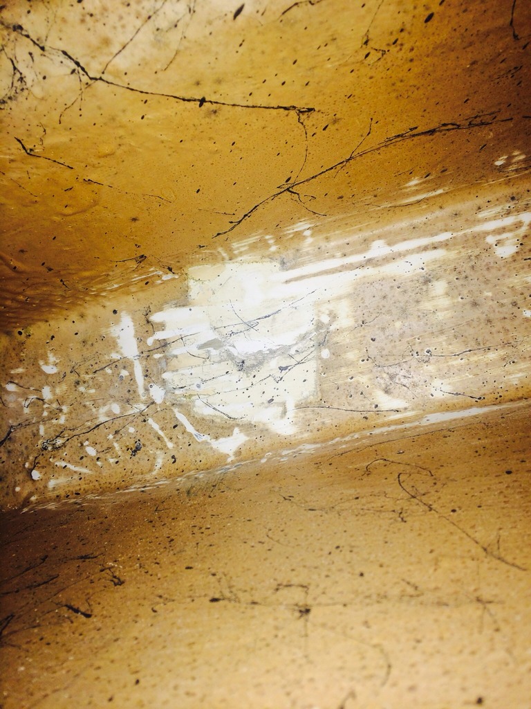

I have lemon scented bleach and SoftScrub with Bleach, but I also found the below pictured spray on sale and decided to give it a try, ZEP professional Mold & Mildew Stain Cleaner
This stuff is strong and VERY effective. Safety warning, wearing a respirator while cleaning interior spaces is a no-brainer on this one, but you also MUST wear eye protection that seals on your face like goggles. This stuff will quickly get to your eyes if you spray interior spaces of your boat. I didn't have any kind of chemical specific safety goggles so I grabbed a pair of ESS tactical Shooting Goggles that the Army gave me years ago in Baghdad, lol. They were tinted but kept that sting out of my face.
The paint on the overhead of my aft storage areas is tan with the slings of black paint through them. I'm not sure if that was supposed to be the color or just years of dirt build up and age, but this ZEP stuff turned the paint white! Very effective at cleaning up the mold and I was sure to spray any areas where spores could be hiding.

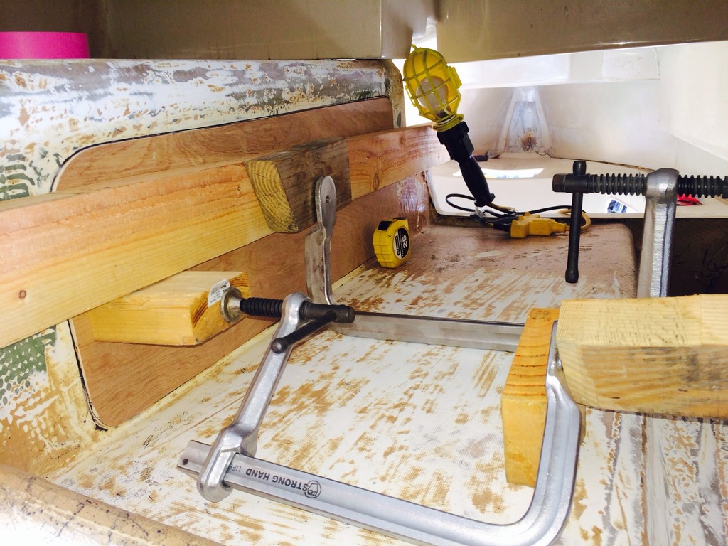

I had mentioned before that my manual bilge pump was mounted in the bulkhead of the port cockpit seat. That fiberglass is pretty thin and the action of pumping the handle makes it flex pretty bad. Probably not the source of the spider cracks I have since I doubt anyone has had to vigorously pump water out of this boat, but the potential is there.
I decided to re-enforce this area by laminating in a section of plywood, soaking it with epoxy and putting a single layer of glass cloth over it to seal it up.
The first pic shows how I braced the outside with an extendable ratchet brace used to secure cargo in my truck bed. I knew I would be putting considerable clamping force on the bulkhead from the inside and I did not want the epoxy to cure and leave a permanent outward bulge.
The second pic shows a 3/16" plywood sheet braced against the bulkhead. I used my reversible welding clamps and some blocks to apply expanding clamping force when I set it in place with thickened epoxy. I always brush on a coat of un-thickened epoxy to raw plywood to soak in before I batter on the thickened epoxy. After this section set up I put a single layer of the left-over 8.9 oz cloth to seal it in. This area, including the raw plywood underside of the cockpit sole, has now been painted with white Interlux Bilge Kote.

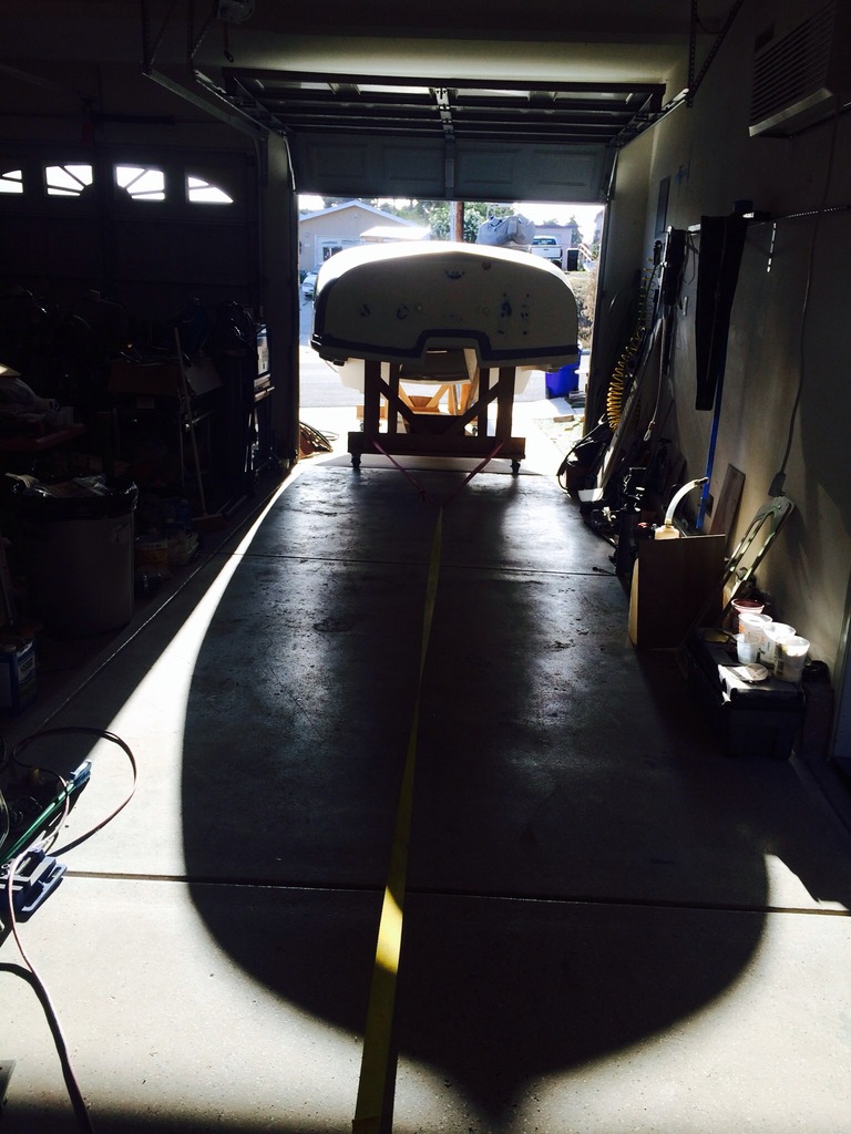

I cleared the long bay of the shop getting ready to bring the hull back inside. I was really enjoying the feeling of walking the full length of 37 feet without running into anything or tripping. Then I fouled it by hoisting my hull back through the door;

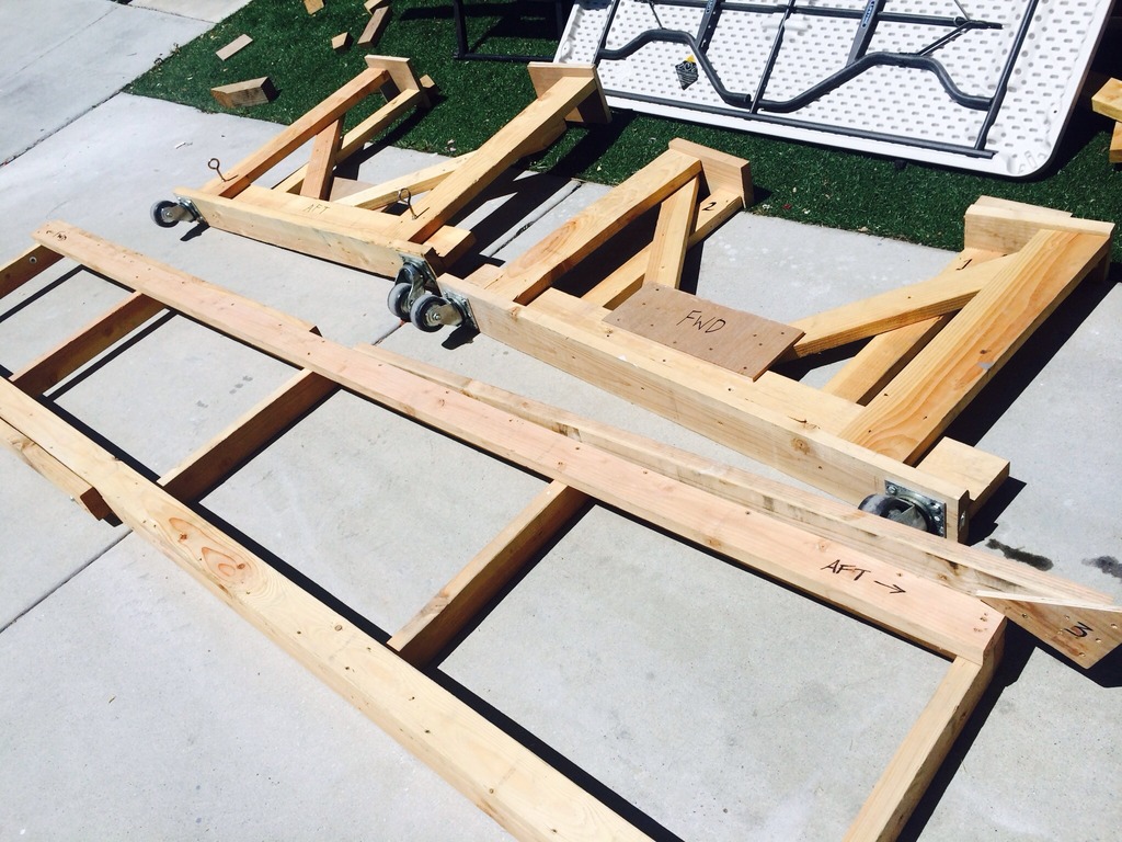

The cradle is easy to install or uninstall under the hull using the stands. The lumber is put together with screws but the three main parts are assembled with bolts. Not too hard to store or carry around in a pick-up truck.
I offered it up to Capt Don, but if he doesn't need it then it'll probably go on Craigslist.
