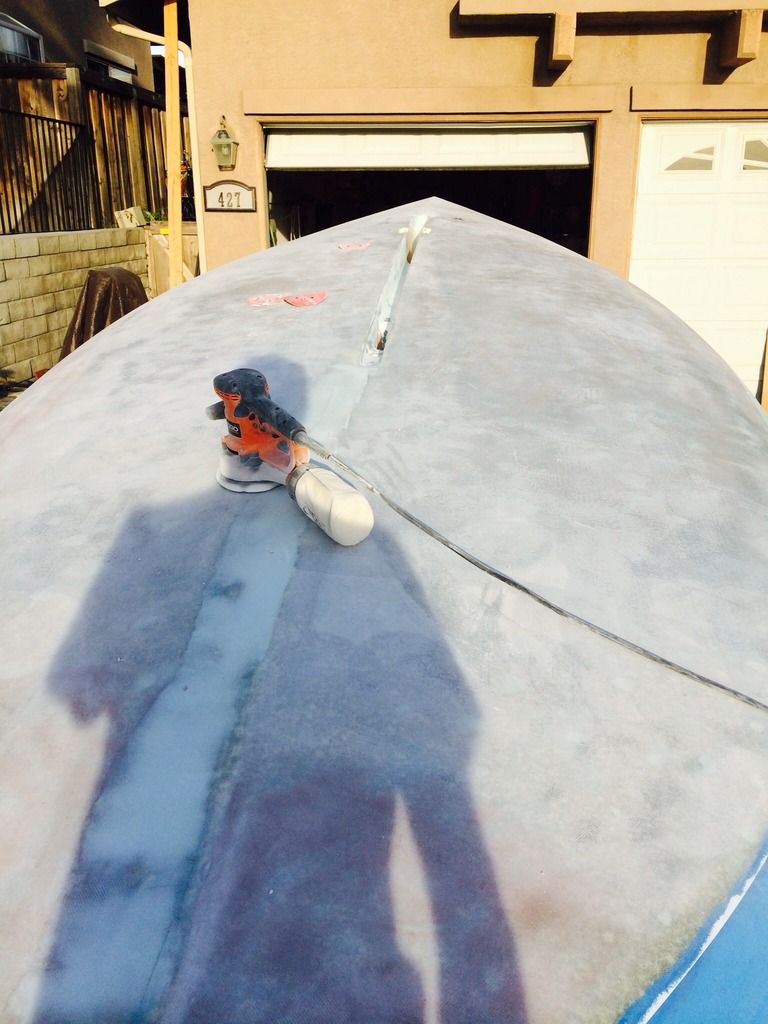

that is the way that I prep glass for finishing... thicken up some epoxy to gel/thick gel consistency and squeegee on in a skim layer then lightly sand that down. from that point forward the paint should be able to fill the rest
