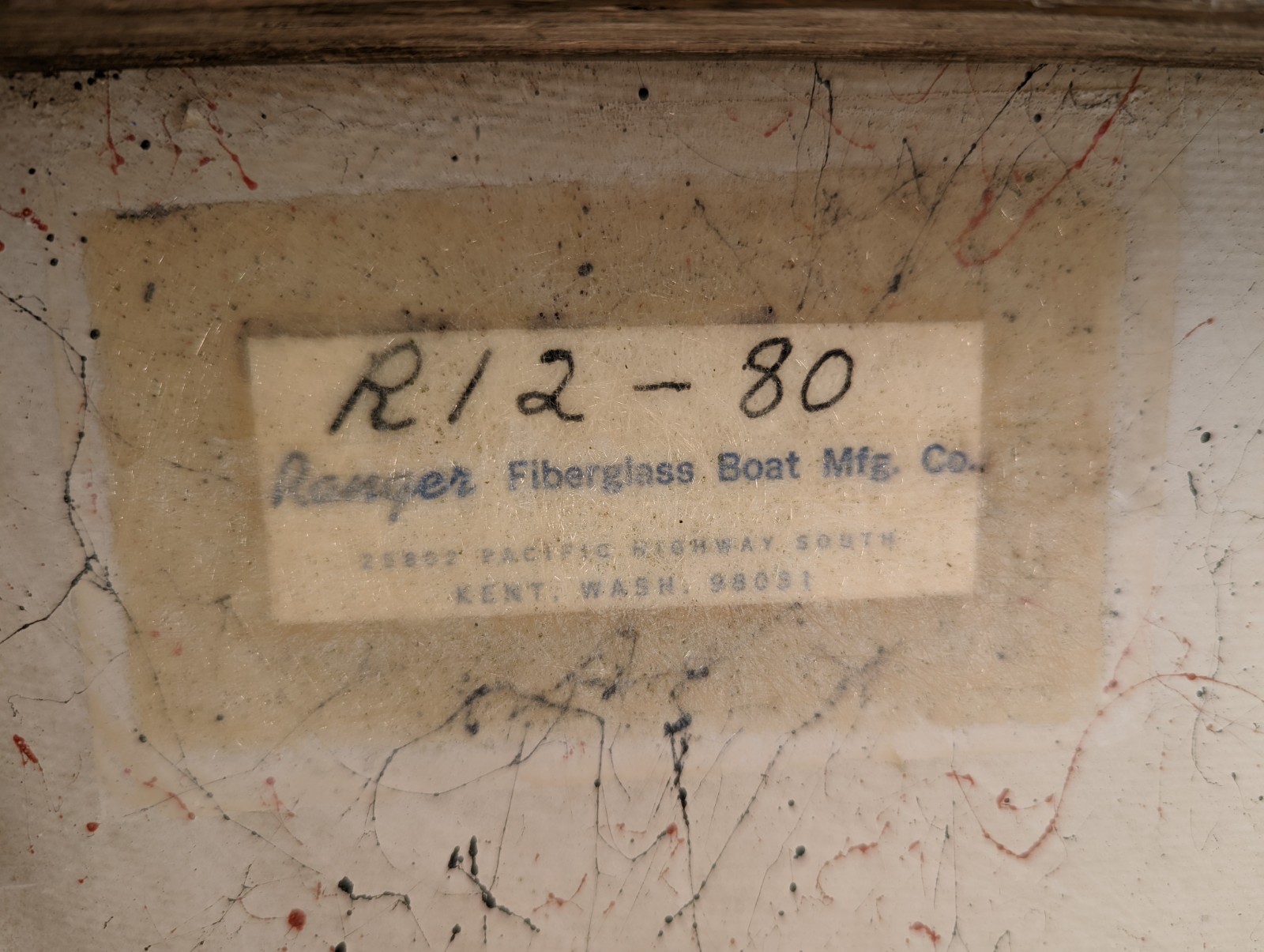

Pictures of my hull and the orginal sail bag. Mine is number 118 made in 1979 - does anyone have a higher numbered hull? I wonder how many years they made these.
I just purchased the same one as you have with the light blue color a few days ago. I'm very excited!

My hull is serialized as 01417.
According to one HIN decoder, "This MIC (RFB) stands for the company name Fluid Motion Llc which is currently Out of Business. This boat manufacturer has other company names (RFB sometimes goes by these name(s) Platinum Marine, Ranger Boat Co, Ranger Fiberglass Boats, or ). This company (Fluid Motion Llc) is owned by John Livingston and is located at 25802 Pacific Hwy S in Kent state of Wa. I... Fluid Motion Llc has started making boats, yachts and other watercraft as of 6/26/1972 and went out of business on (3/27/2001) in the following country: USA. ... The US Coast guard provides this comment about this watercraft manufacturer: 123085 Chg From Type 14 To 11 Name Chg. 990304 Ranger Purchased By Fluid Motion; Old Poc Was Howard Smith. (owner). Tonyford-rni-email-010227-canoe Mfg Pkg Mailed-010302. 03/27/01 Howard Smith Sold Company To John Livingston."
Here's an aerial photo of the company from 2002. There appears to be several 18' hulls to the North part of the yard and two 9' hulls (maybe Minto's) to the East highlighted in yellow.
That's pretty awesome, you really did some digging here. My hull serial is: 022028 (I hope I am reading it right since mine has one more digit than yours).

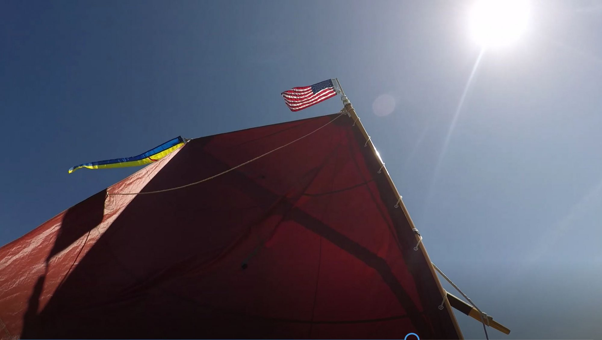

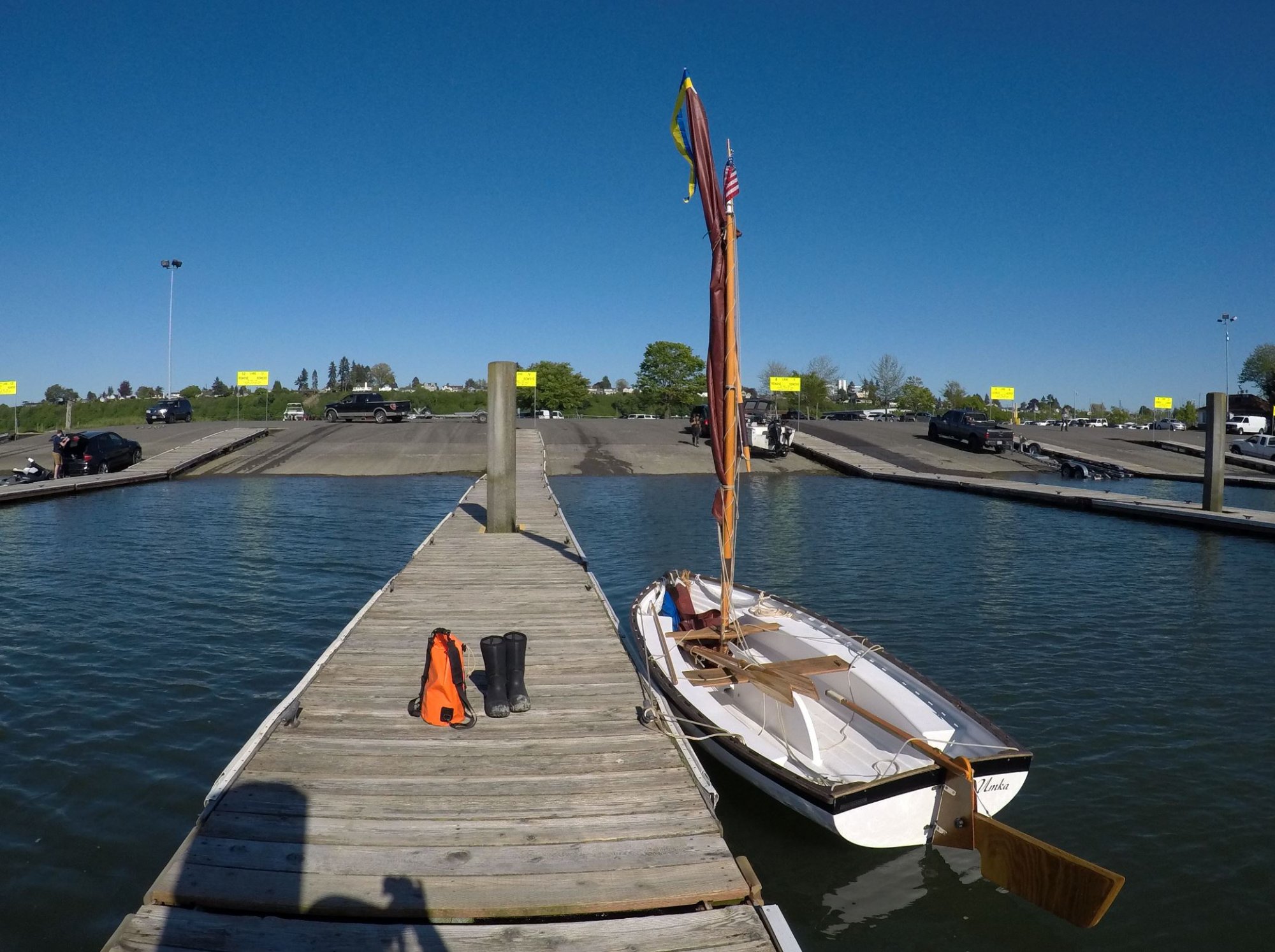

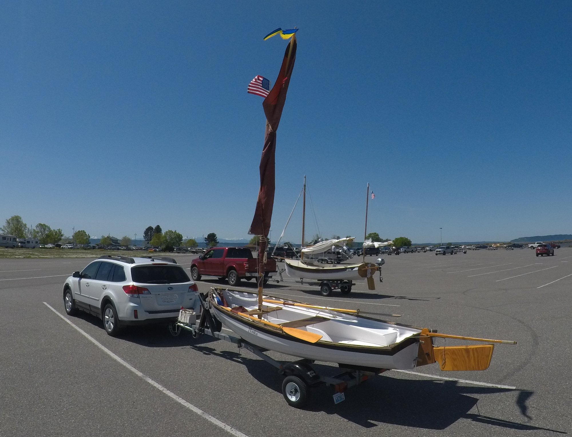

The first test of the reinforced thwart and mast step was successful this past weekend. I sailed her twice in the Puget Sound and once on the lake. The first day on the Sound was steady wind about 10 mph gusting to 15+ and the tides were strong. The second day was pretty calm (2-5 mph) and the tides were ripping through the channel making it nearly impossible to sail or row. The lake had a steady breeze around 8 mph, which allowed for some onboard adjustments. The boat sails true without any weather or lee on the tiller.
I realized that the spiral lacing works the best on this rig. It keeps the luff on the mains'l straight and flush with the mast from the throat to the tack. I adjusted the traveler here and there and will need to work on that some more to keep the sail full when sailing loose footed (I haven't used the boom that I made yet).
Sailing the Sprit-rig definitely requires a brailing line. I think I mentioned that it saved my fiberglASS once before. It's easier than dropping halyard and having the mains'l all fouled up and in the way in a gust and getting clocked in the noggin with the block.
Ready to launch
Spiral Lacing
Brailed and returned to dock
I recognize the area in your photos, I live just a few minutes away. I'm hoping to run into you and Umka one of these days so that you can give me a few tips before I take my girl out on our maiden voyage together.

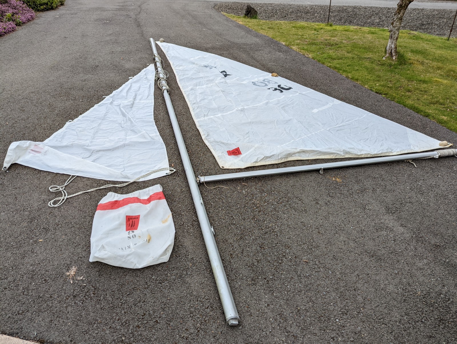

Does anyone have an video of the R12 sailing? Curious who ended up landing this package from Bellingham:
Besides my R-12, this is the first one I have seen with an aluminum mast. All the other ones that I have seen have been wooden masts.
Mine came with an aluminum mast.. I have it stored in the garage with the original sails too. Haven't ever used them yet.. Don't know that I will since I removed the plates for the standing rigging and won't be putting them back in any time soon.
