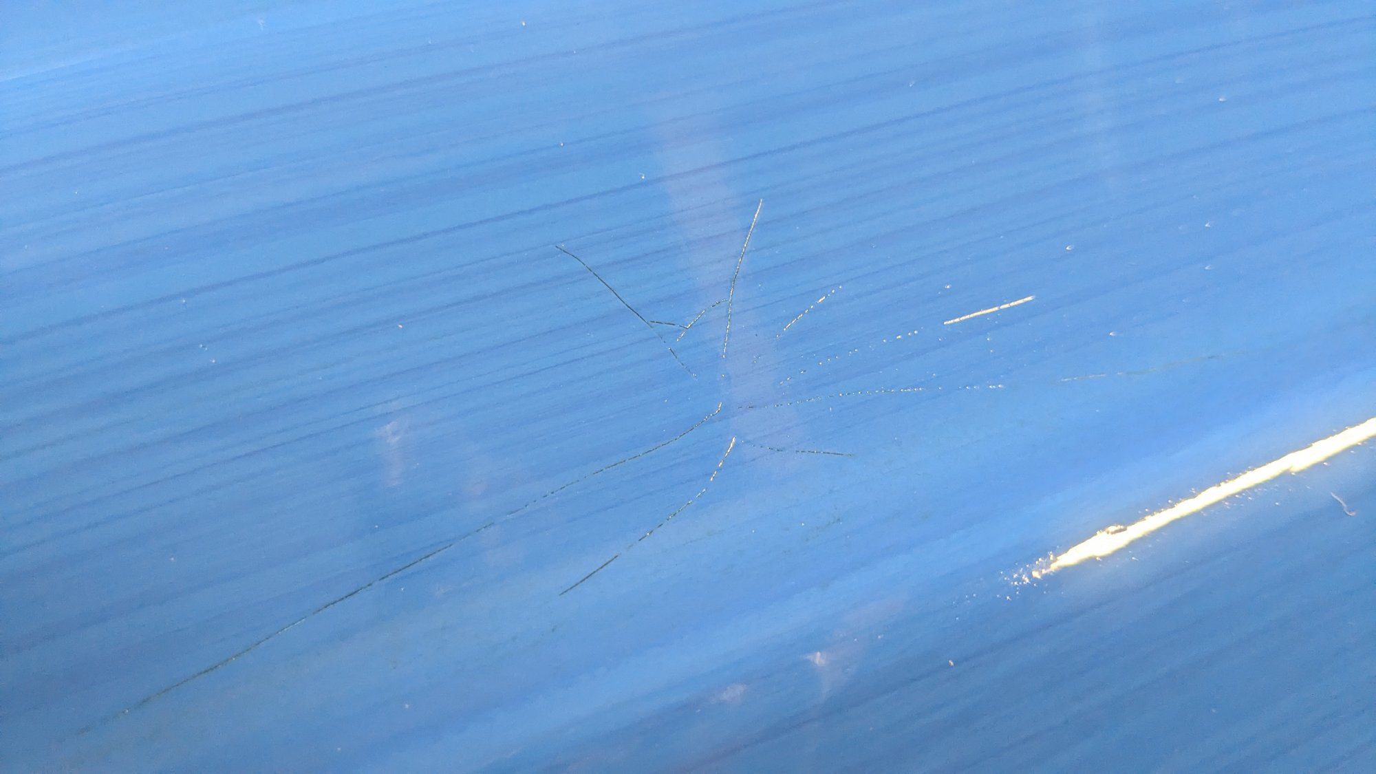

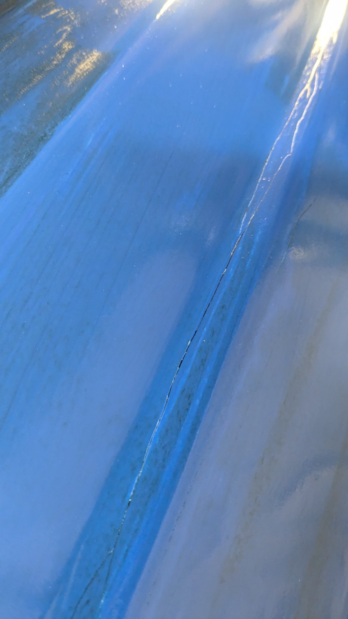

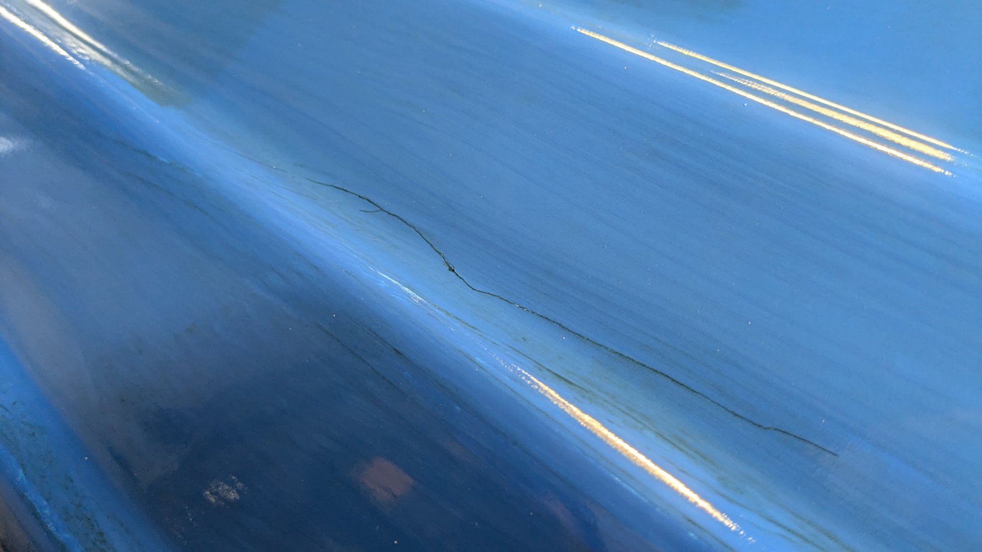

I took all the hardware and gunwales off my Ranger 12 to clean it up and repaint it. It was green and there were many runs so I sanded it down and decided to switch to the original blue and red.
Now that I've got 1-2 coats on the hull, I'm seeing many places with concerning cracks. They aren't just superficial because I can feel them and they are still very visible after 1 coat (2 in some places). I'm not sure if they were always there or if I caused them when I flipped the boat over without the support of gunwales and benches. I think they actually were there but just weren't visible against the old dark green. I also have noticed a couple of these inside along the benches.
I was sailing this boat last summer just fine so I'm wondering how (or if) to proceed.
Options:
  • Ignore them, they are fine! (I was sailing this boat last summer)
  • Suck it up, grind, re-glass, re-fair, re-paint. If I ignore them I'll be sorry.
  • This is a job for an expert, call around and find a pro to fix it
  • The hull is toast, time to get a new boat!
Thoughts? Thanks for any help!

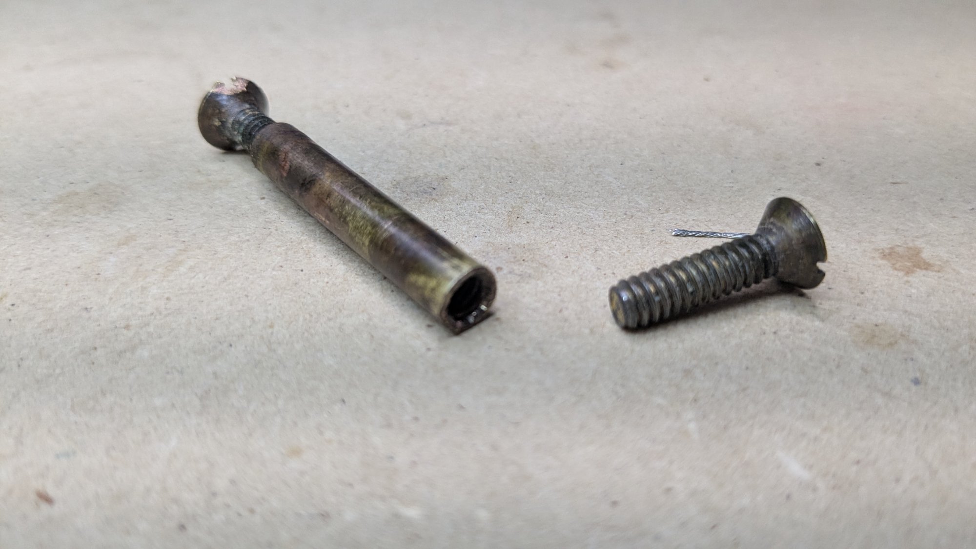

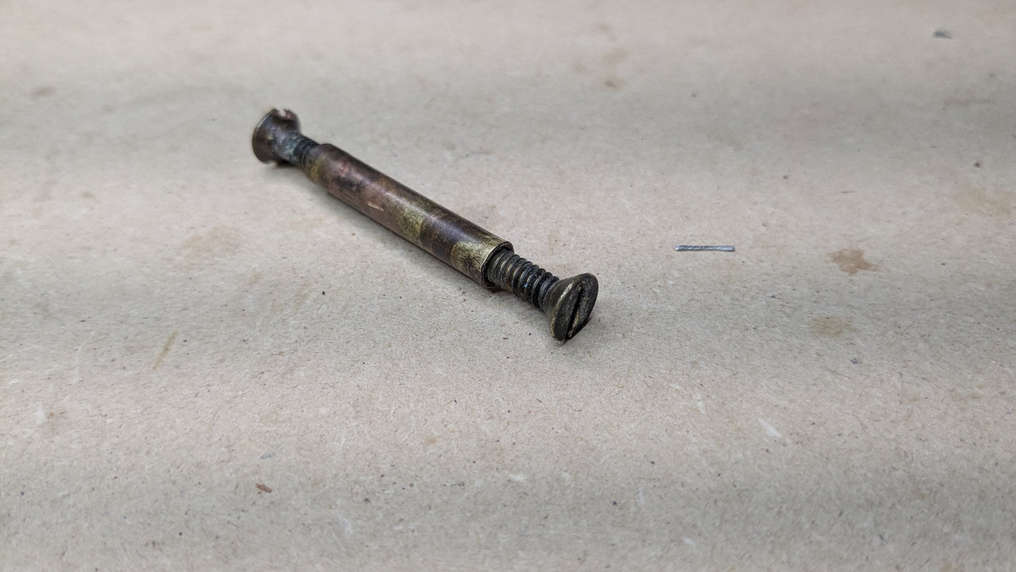

Anyone have suggestions for where I might find replacements for this fastener?
It came off my Ranger 12 and, along with about 30 more, is used to secure the gunwales. I believe it is brass, 1.5" long, 1/4" OD. It doesn't have to be an exact match as I'd be very happy to replace it with something that roughly looks and works the same. I'm missing two of these.
If not, any suggestions on alternatives?
Thanks!

I have not seen a part like that. I can understand how it was built and used in your boat.
Places I would give a contact to would-be.
Duckworks Boat Builders Supply in Port Townsend. Operations manager is Scott Jones. About Duckworks Boat Builders Supply
They are pretty well connected with the Northwest Maritime Center. Home | Northwest Maritime The Center is a workshop and a museum of old wooden boats. They may be able to give you a possible source.
Longship Marine is a consignment store in Poulsbo, WA, that receives many old fittings.
Good Luck
23,855
I am guessing that you could find a piece of tubing, cut it to the correct length, then you could thread it and buy screws to match.

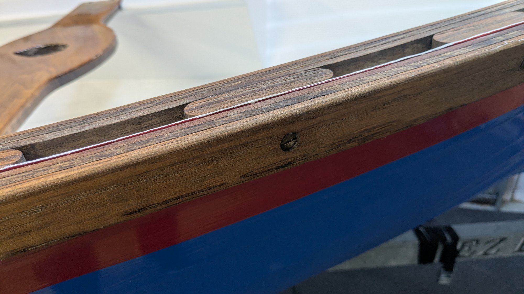

Hi @PNW Sailor, does the cap on your transom wrap around the top of the transom at all or is it just attached on top? Is it the exact size of the transom or does it overhang a bit? Also is it just screwed on or also epoxied? Or bedded with something gooey?
I'm replacing mine (missing from my boat when I got it) and trying to figure out the best approach.

They are coupling nuts. McMaster has them in SS not bronze. The stainless one should work for you.
May 13, 2023
17
Ranger R12 Jordanelle Reservoir
I don't see anything in 1/4" OD unfortunately. Did you see that on another page?
13,556
How accurate is your measurement? A ¼" OD is .25 inches, the coupling for a 10-32 bolt is 19/64" which is .297 or about 5/100 of an inch larger. With that small of a difference it should work, although the thread is probably different from what you have.
