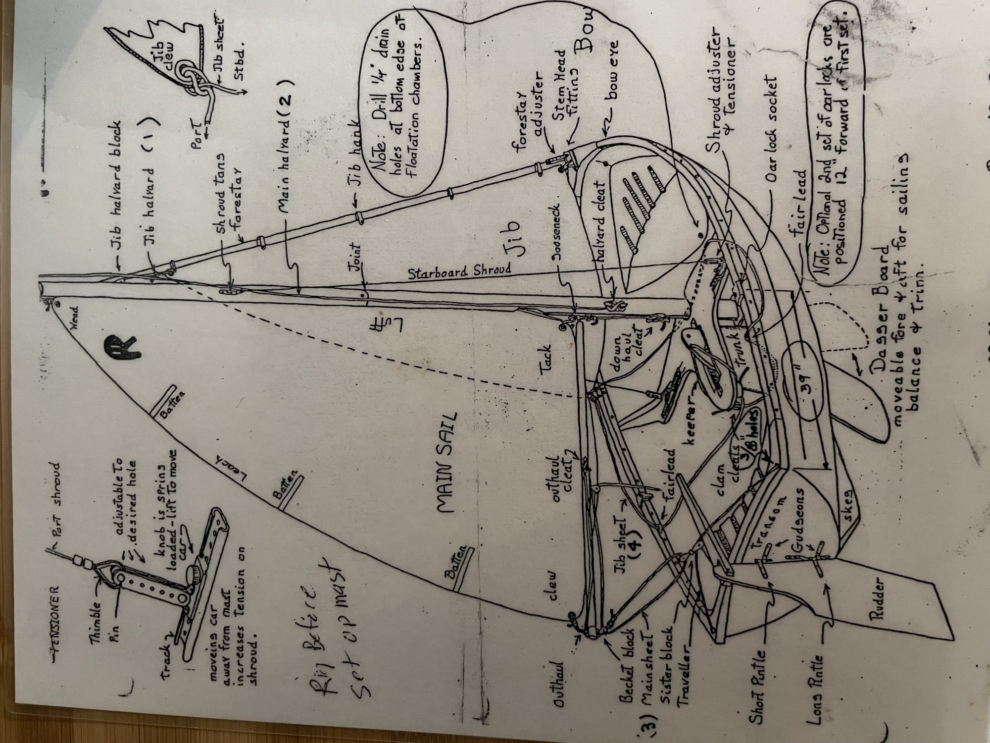

  • Is there a reference for what thickness the different lines should be on an R12 with aluminum mast and boom (exactly like the drawing posted here)? Or can people share what has worked well for them? I saw both jib and main halyards should be 1/4" but I'm wondering too about other lines like downhaul, outhaul, jib and main sheets, boom vang, and centerboard. I've noticed a lot of the lines don't really fit in the their blocks or cleats, so definitely wrong sizes.
Thanks!

Walking inside while on the trailer should not harm the hull. I would hazard a SWAG that on a boat that size 3/16 or even 1/4 would do of all of the smaller control lines.

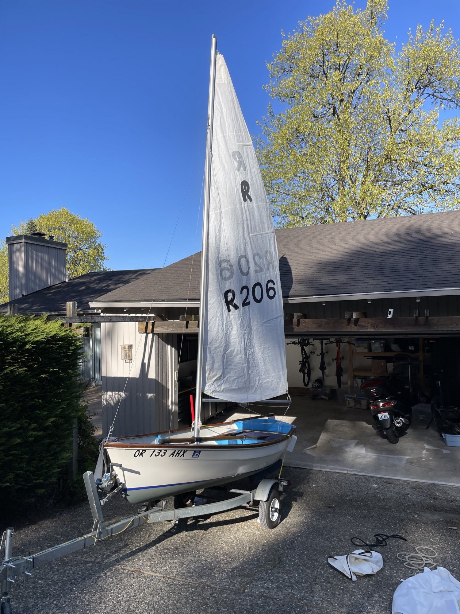

Yeah I was thinking the same thing. The larger lines for sheets work great. The most irritating one honestly is just the line for pulling up the centerboard. It doesn't really fit in the v jam cleat.
Also I finally got mine in the water yesterday and it sailed great! Really nothing that needs immediate updating, ready to go for the summer.

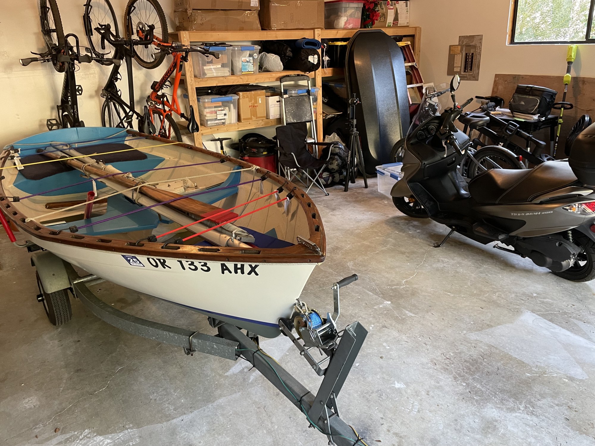

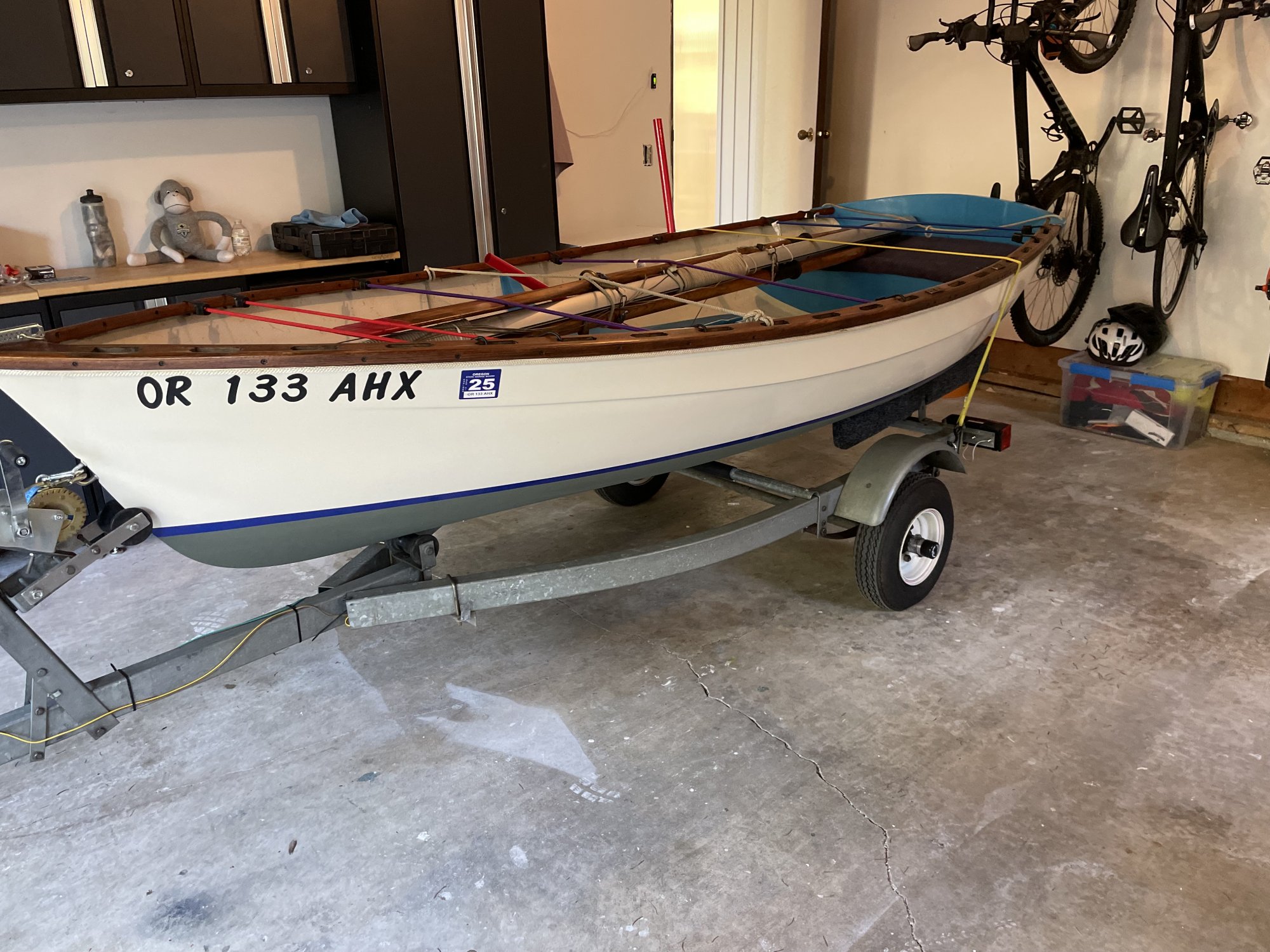

I recently purchased an R-11 that appears to be in pretty decent shape. The shake-down sail went pretty well, except for a split tiller. But the boat moves very well under sail and while rowing.
One question, I don't really know how the main sheet is supposed to be rigged. There's a traveler line that crosses the stern. After passing from the boom, through the traveler, and then back through two small blocks on the boom, should I just hold the main sheet in hand, or tie it off, or am I missing some hardware? Any thoughts, suggestions, or ideas are very much welcomed.
Apr 8, 2010
2,247
Note that the dagger board has two separate "down" positions, so that you can balance the CE sail area with only the main up if you want to sail that way.
Ray Richards, N.A.M.E., was a great designer. (IMHO)
Note also the "family resemblance" to his Ranger 20 and 24 hull designs.
That "slotted" teak gunwale was a factory option, BTW. ($)

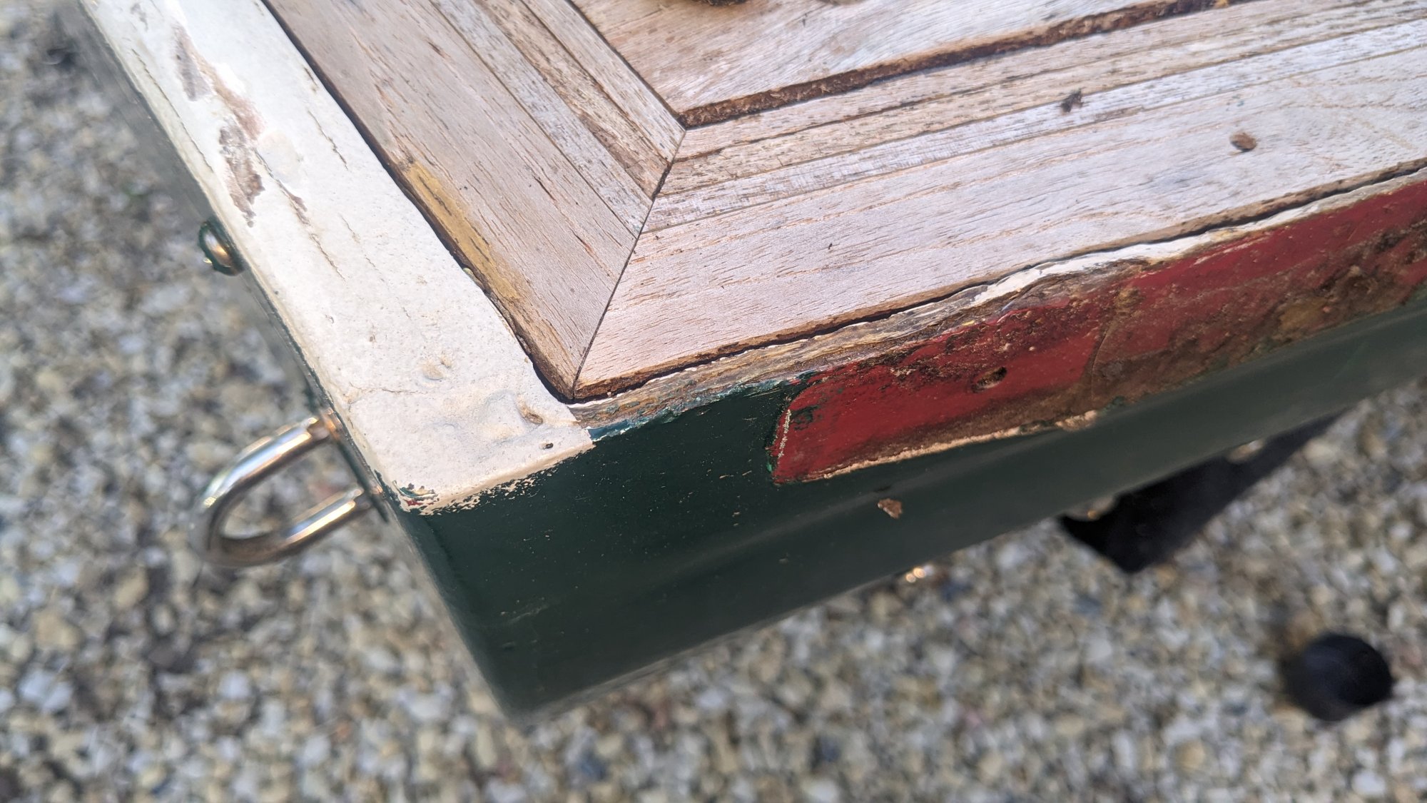

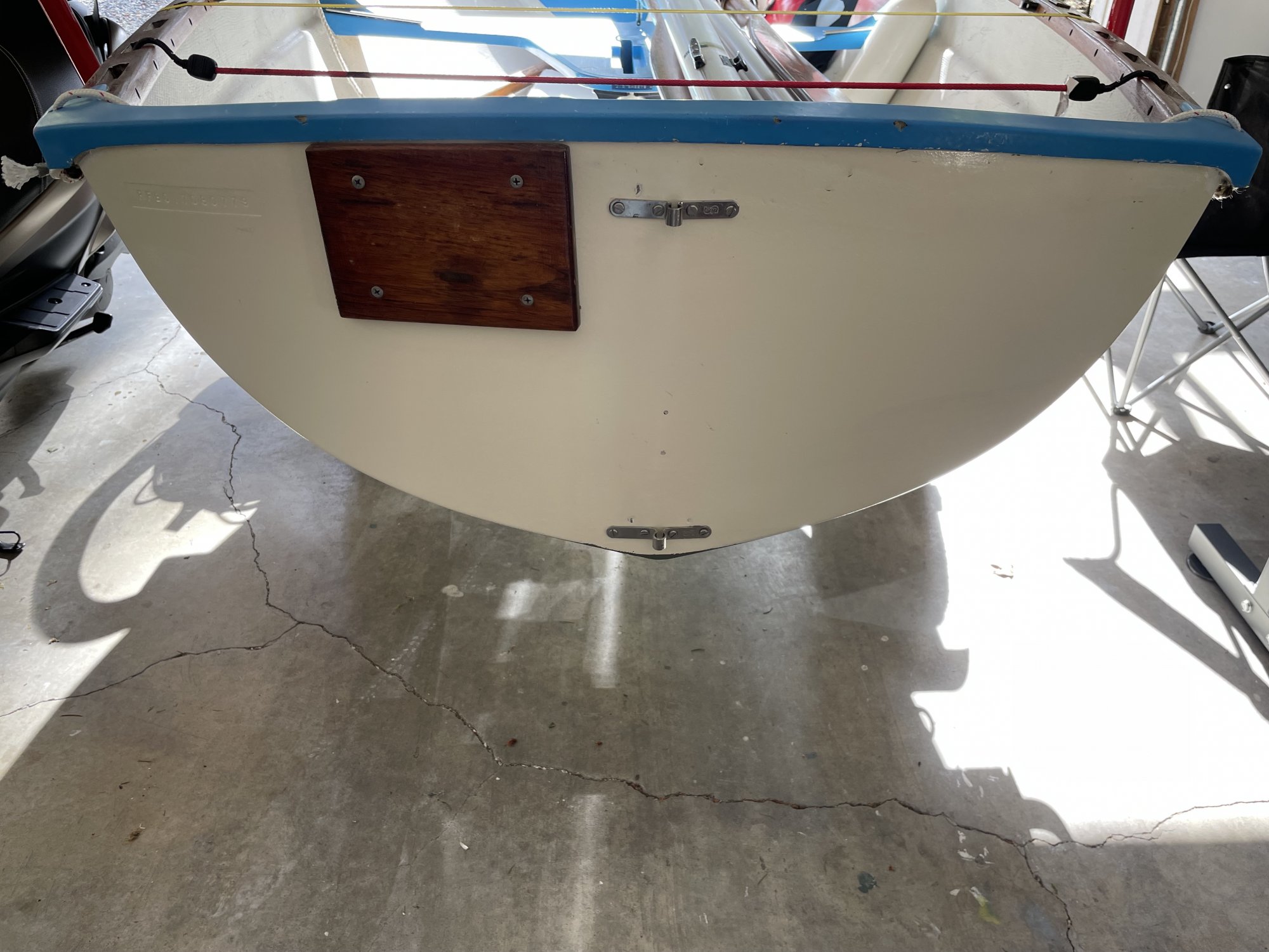

Can anyone post up-close pictures of the transom on their Ranger R-11? I'm painting mine and figured I'd restore the transom as much as possible since someone removed the teak cap and painted over everything at some point. I'd like to at least know what I should be shooting for.
Thanks!
May 13, 2023
17
Ranger R12 Jordanelle Reservoir

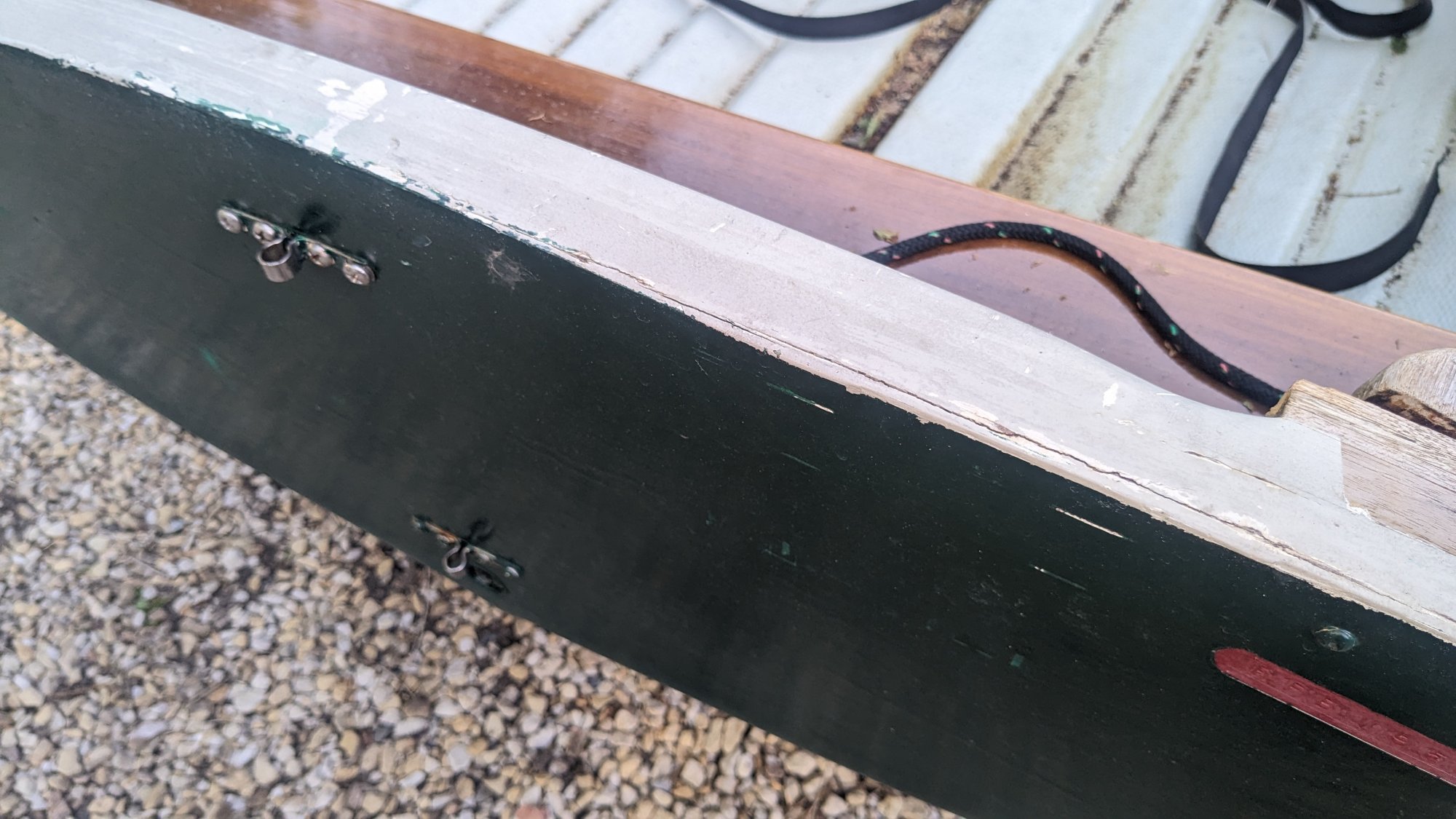

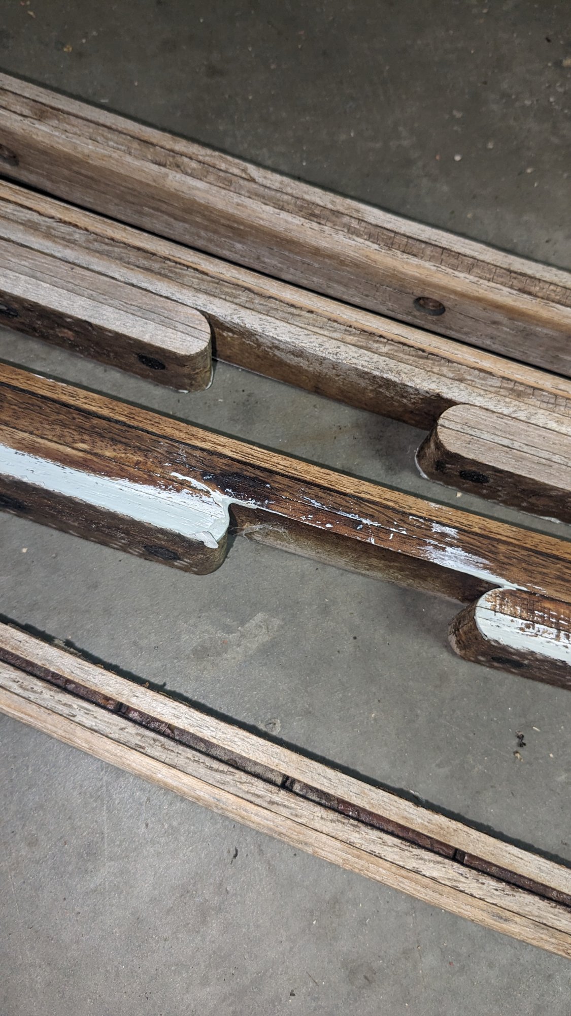

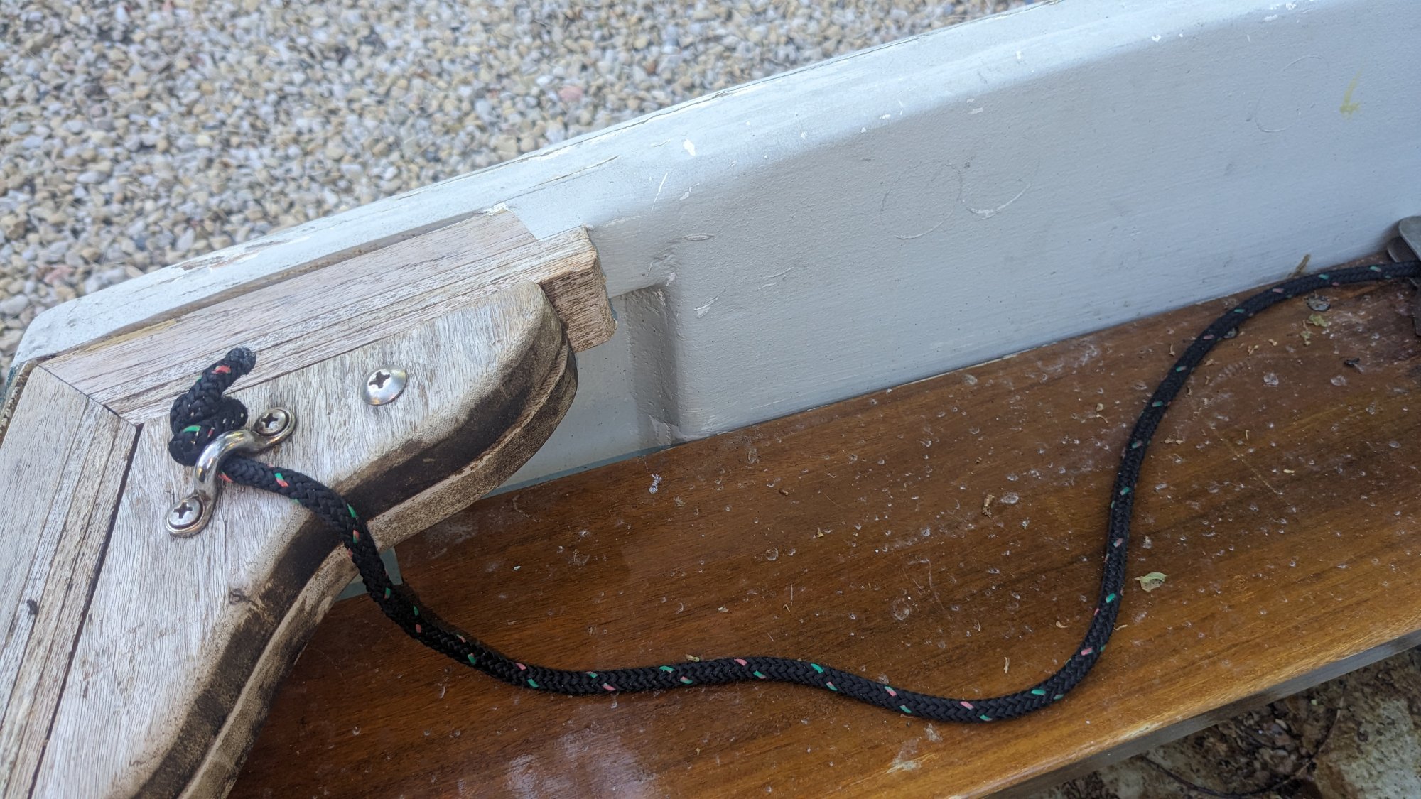

Here are some close ups of the transom. If I don't get some good deails here or elsewhere I'm just going to sand back the paint on all the wood to see where it starts/ends and so I can finish it more nicely. Then after repainting I'll add a wooden cap to make it look even nicer and to protect the top of the transom.

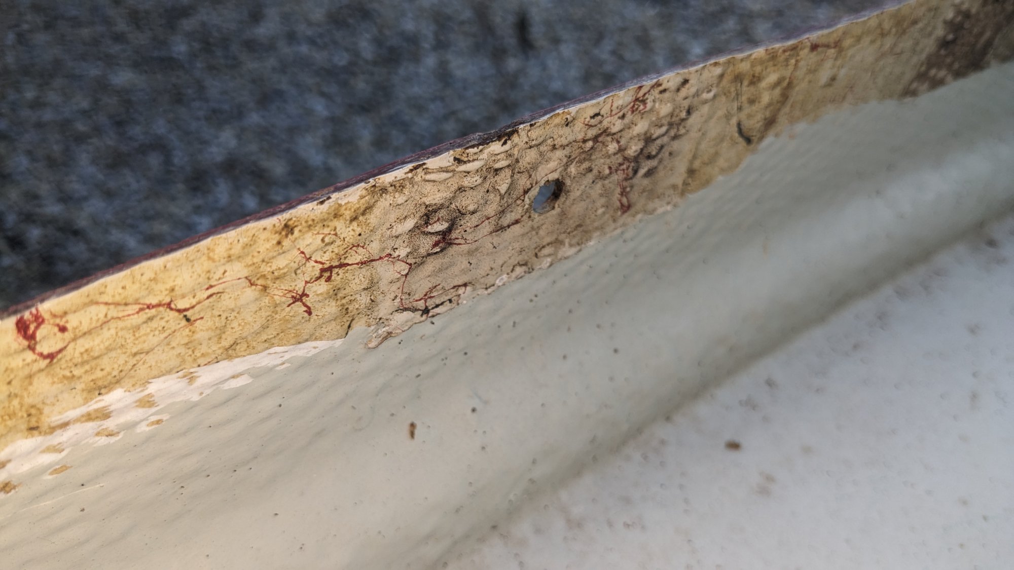

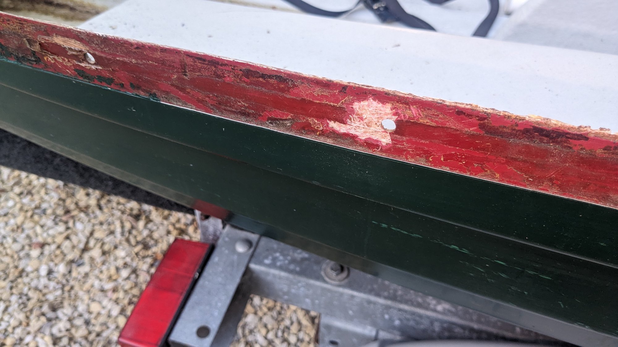

The other can of worms I've opened up is I decided to refinish the gunwhales which were looking tired and repaint the hull which had a lot of old runs in it.
As you can see, (1) the gunwhales had glued themselves to the hull in places and then tore off a little fiberglass and (2) the top edge of the fiberglass hull is a little frayed in places.
My plan is to sand everything down, inside and out, for adhesion and to get rid of the old runs, prime with Total Boat's Wet Edge primer on any bare fiberglass spots, then paint inside and out with Wet Edge topside paint.
Here are a couple questions about painting and fiberglass:
  • Should I put a fold of fiberglass over that top edge or is it ok for it to be a little frayed like that?
  • Does that prime/paint plan sound ok otherwise?
  • I've also got a couple holes from hardware I got rid of (koosie holder) that I plan to patch the same way.

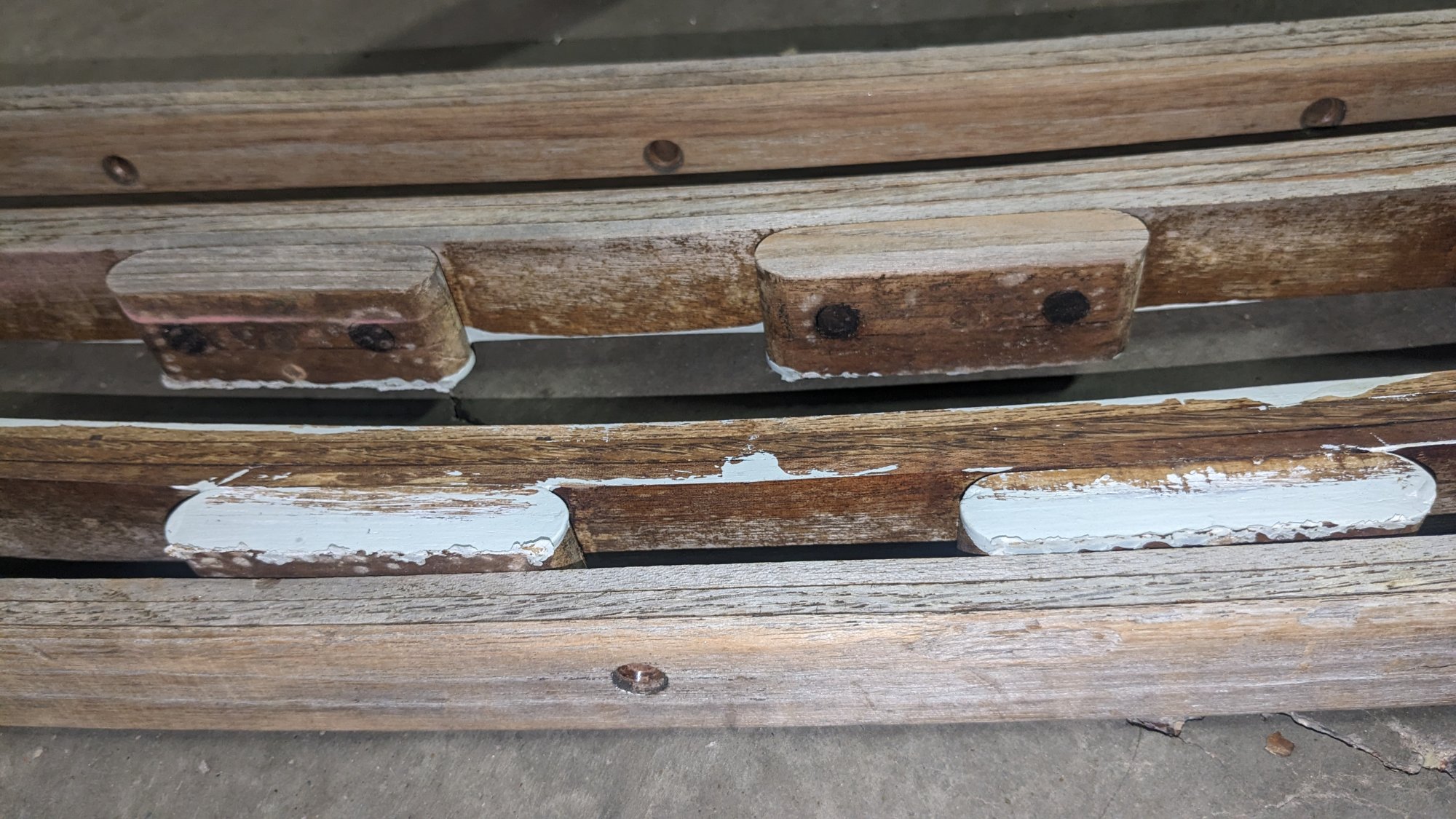

About the gunwhales, can anyone tell by looking if these are teak or not?
If they are, I can definitely see sanding off the paint, gluing the cracks where needed, putting new oil on them and they'd look ok. Otherwise, they are pretty beat up and I'd consider at least just making new ones.
The other gunwhales question is again about the banged up top edge of the hull, should I consider putting a cap on the gunwhales?
Thanks everyone for any tips or thoughts!

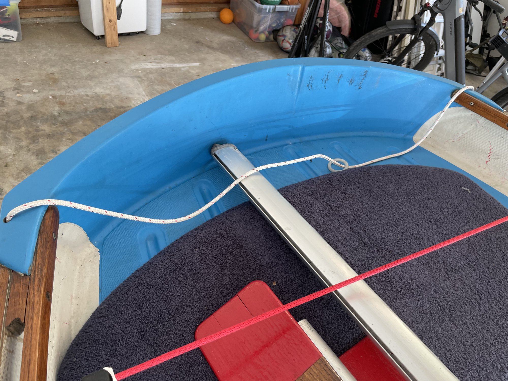

Thanks @Old Ranger . I will say though that your boat doesn't really look anything like mine (or the other boats I've seen in this ranger-12 thread). Am I crazy? Do you have a later model? Lots of details are quite different, many similarities too, but I swear the hull shape isn't even quite the same. Definitely your whole stern area is totally different. Mine is flat on the back with no bench across the transom, just the two side benches.
Apr 8, 2010
2,247
Note that the Ranger 12 and Ranger 11 are totally different designs. Totally.

I think the original post was asking about the transom on a Ranger 11, and I am pretty sure what I have is a Ranger 11. I could be wrong, but it's 11' and it's a Ranger.

So on that note, I'd still love some close up photos of the transom on a Ranger R12. Thanks everyone!

Your post: "Can anyone post up-close pictures of the transom on their Ranger R-11?" :)
