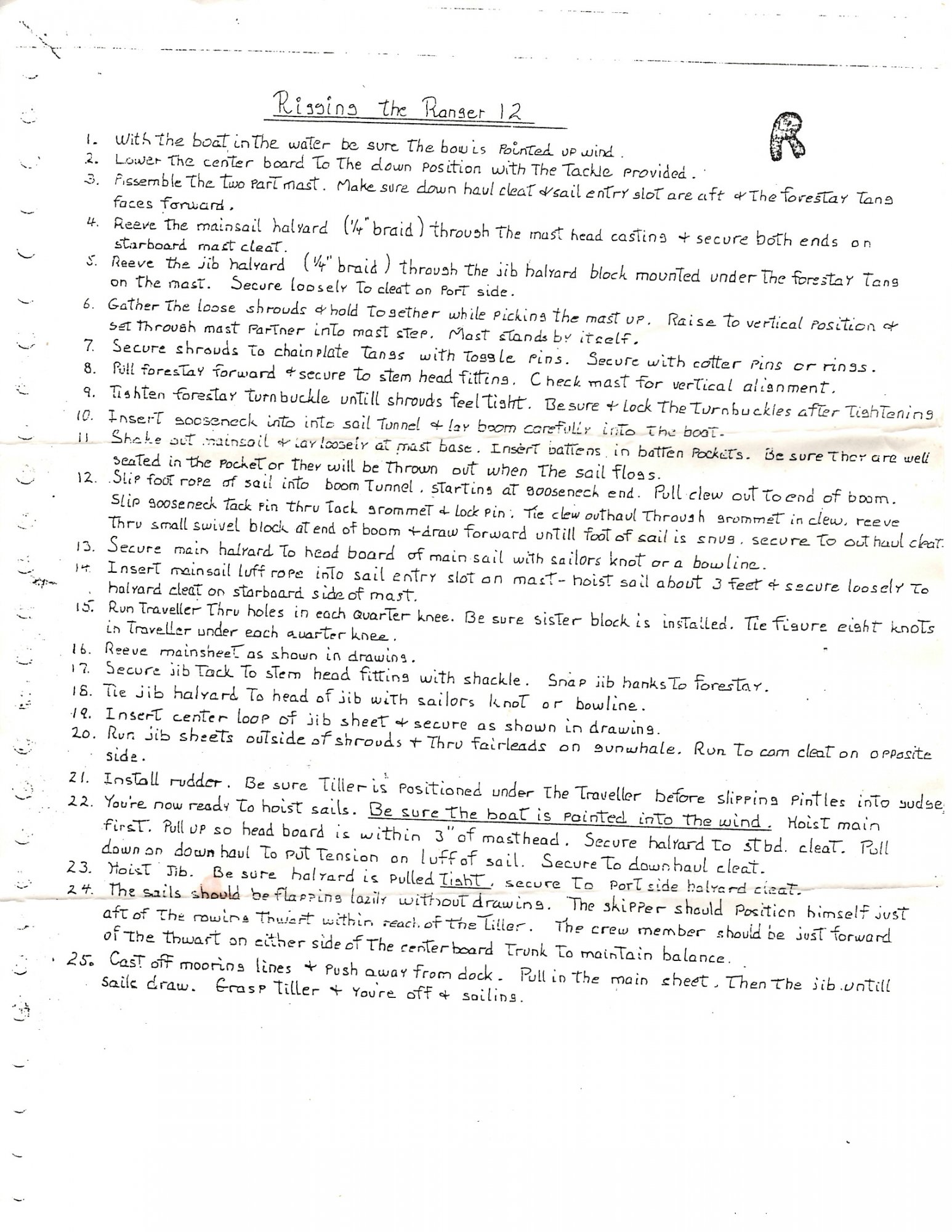

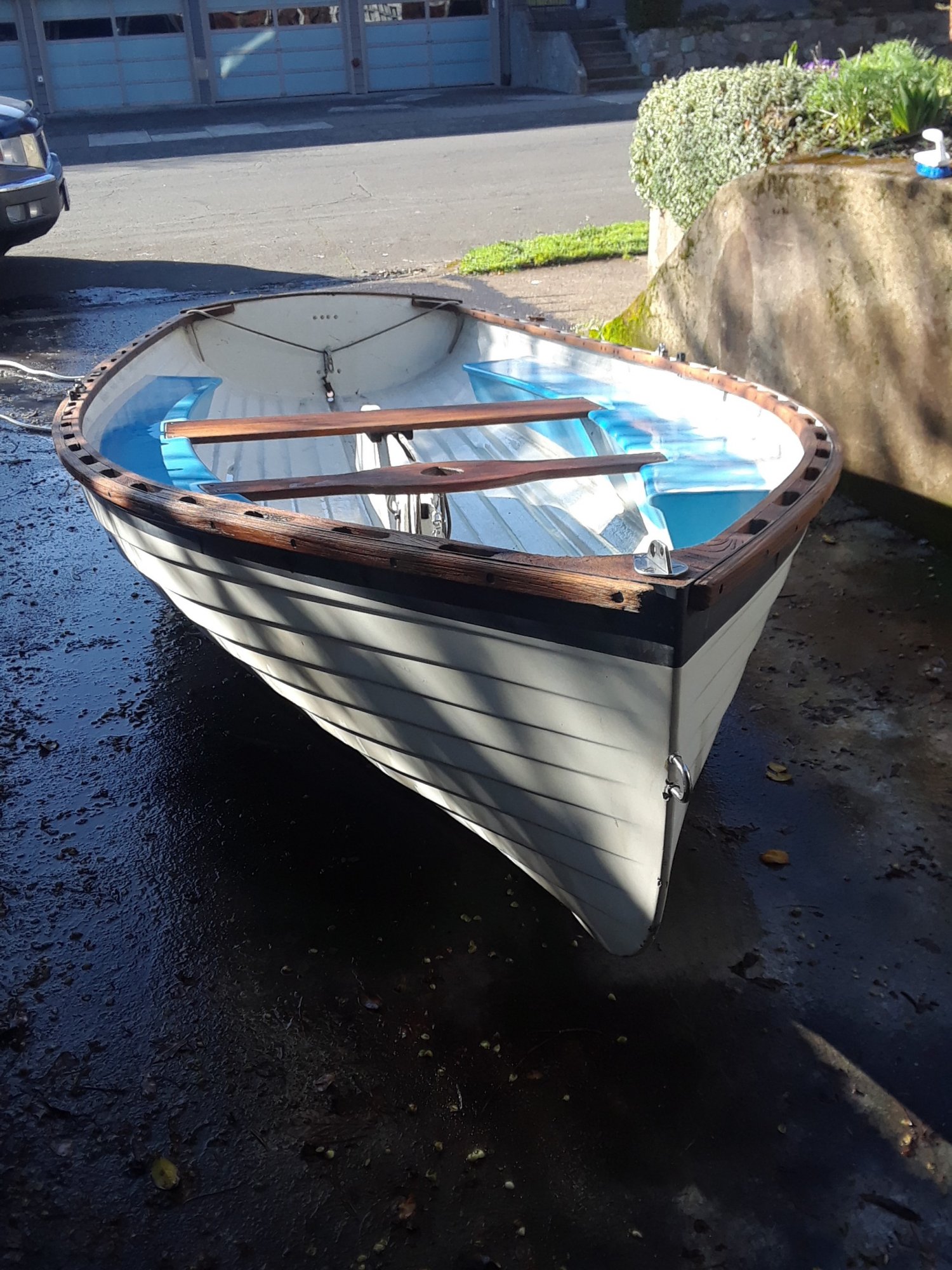

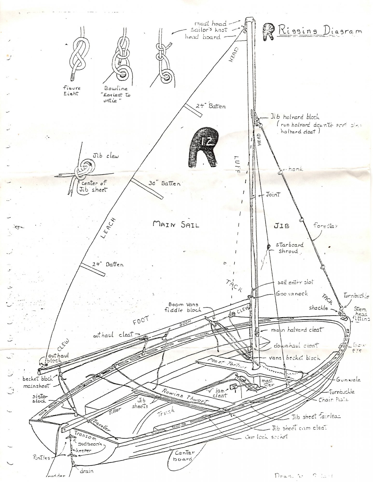

SInce this is the definitive source for Ranger 12's on the internet I'll post my few pieces

@Waco
That’s a fantastic diagram of the Ranger 12 rigging! That’s spot on. I actually haven’t set any of the original rigging up or even taken the sails out of the bag yet! I’ve been waiting for some warm and dry weather to lay everything out on the lawn and set it up. Now I’m sure I can do that with the details from the rigging diagram and instructions. Thank you!! John

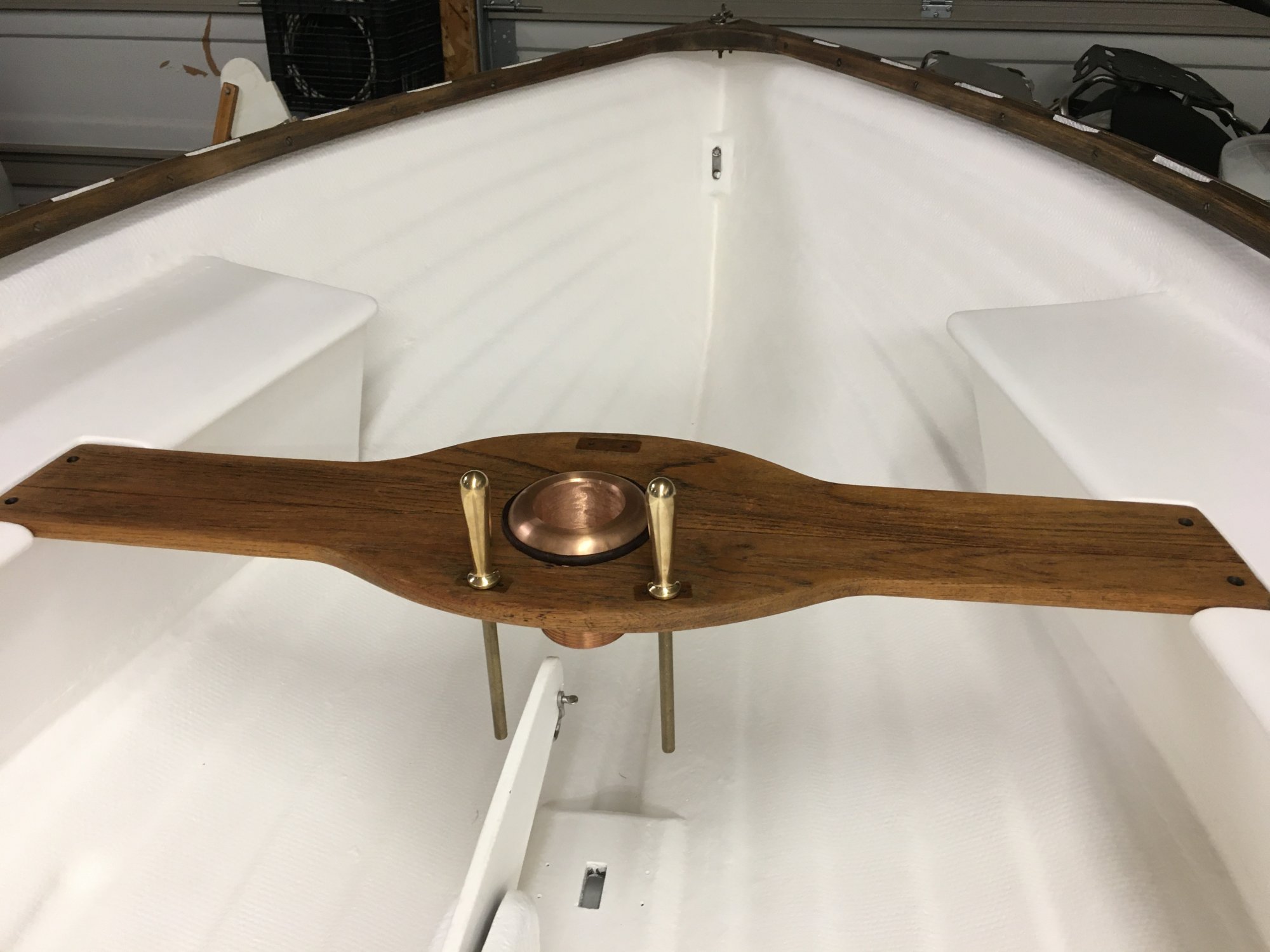

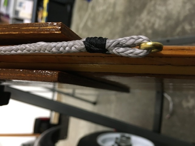

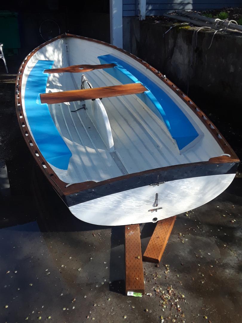

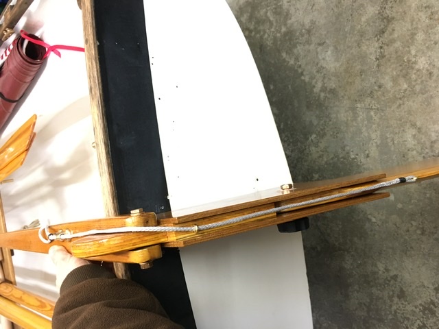

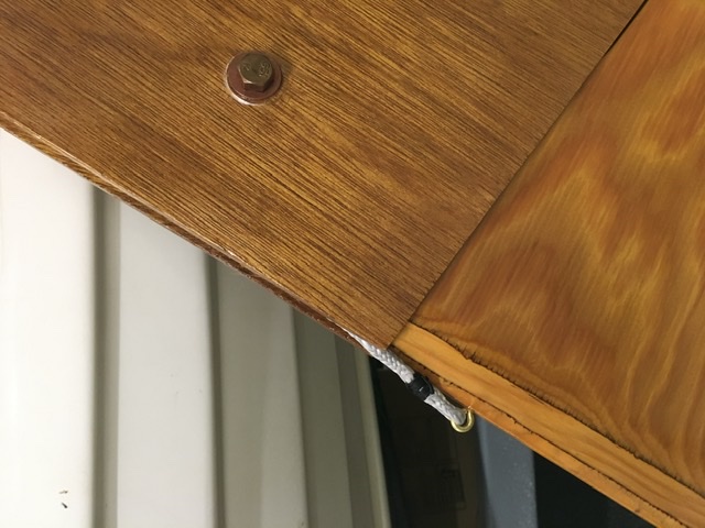

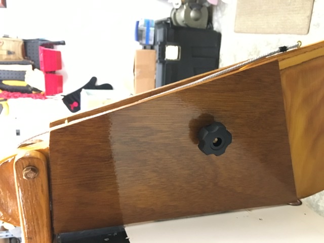

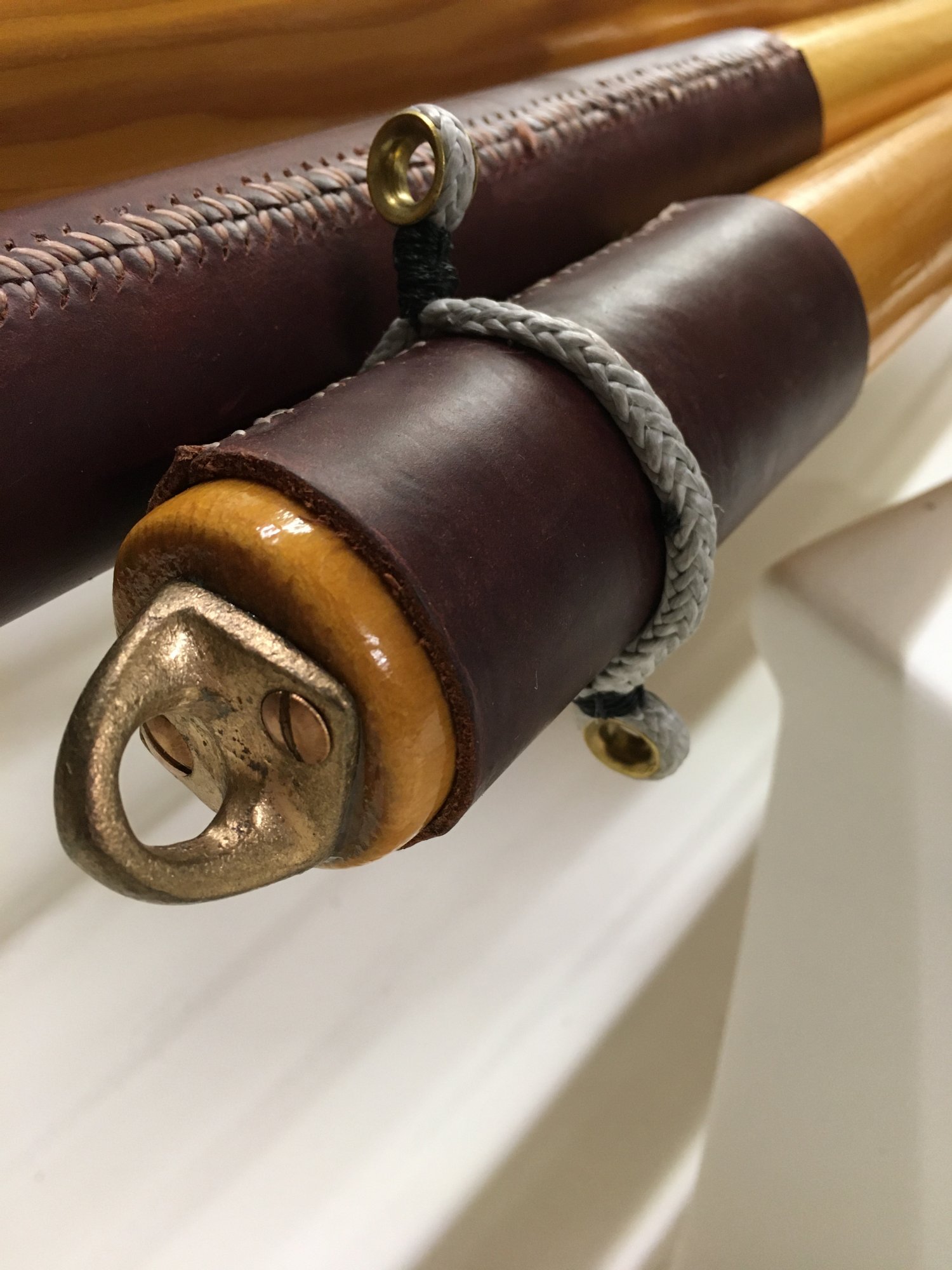

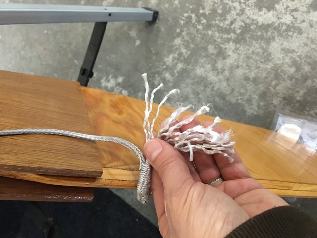

Here’s some photos of the Ranger 12 conversion still in the works. I’ve tweaked a lot of things since these photos after bending the sails, but essentially it’s same design. Rigging without the boom is much simpler for a lot of reasons. The way spritsails were intended. But I have both options I suppose and I need to get on the water to find out for sure.
Dec 12, 2019
31
Ranger 12 The Puget Sound - North

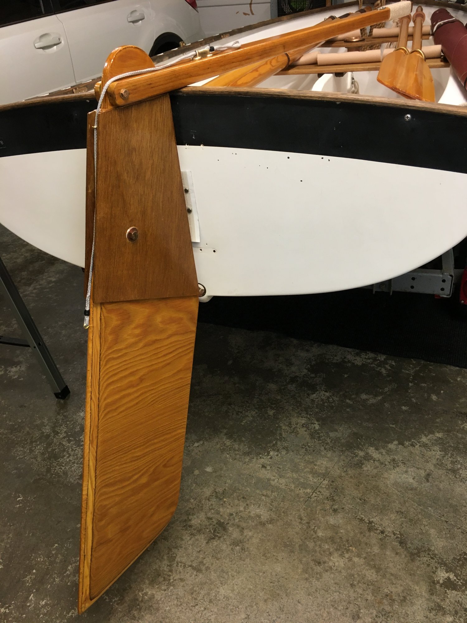

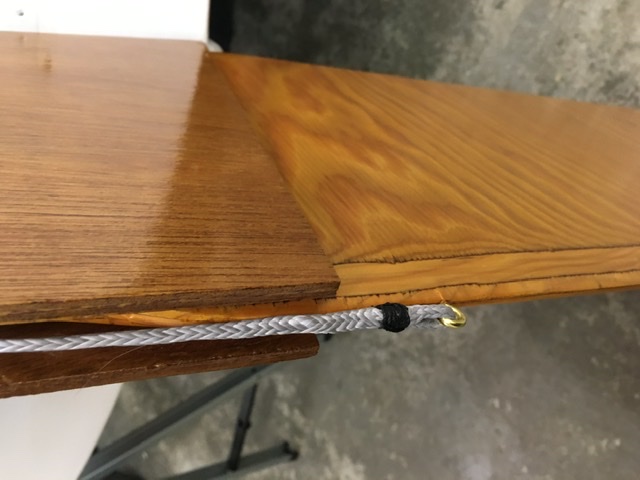

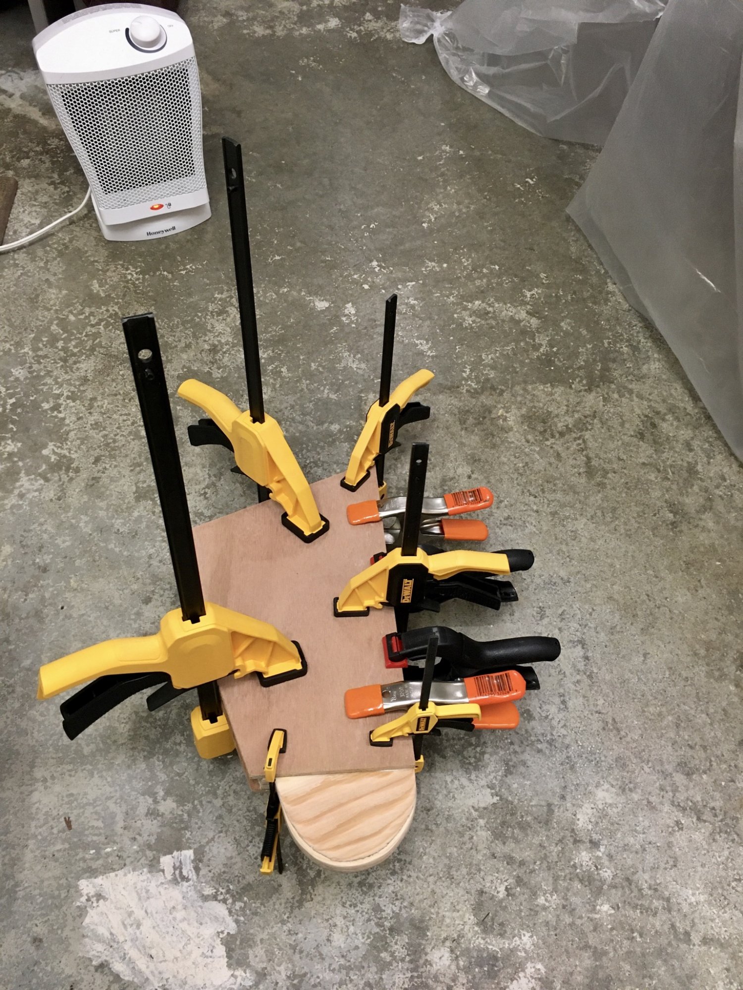

More photos of the rudder. The bronze gudgeons and pintles are being cast shortly. Those are the last pieces I need to get her sailing.

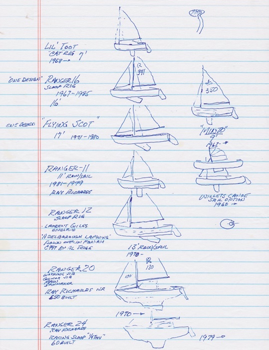

Here's are some more clues and history on the Ranger 12. Ranger claimed the dinghy used to create the mold was an Adelborough Lapwing designed by Laurant GIles. I believe the mold actually came from an Aldeburgh Lapwing designed by Morgan GIles. The original boat was flown over in the early 70's by Al Teige, a Pan-AM pilot, who brought it back in a 747. Here is the website for the Aldeburgh Lapwings. Aldeburgh Lapwing They appear very protective of their dinghy and probably wouldn't be to impress to learn of the Ranger 12.

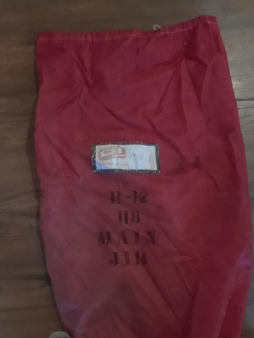

Pictures of my hull and the orginal sail bag. Mine is number 118 made in 1979 - does anyone have a higher numbered hull? I wonder how many years they made these.
My hull is serialized as 01417.
