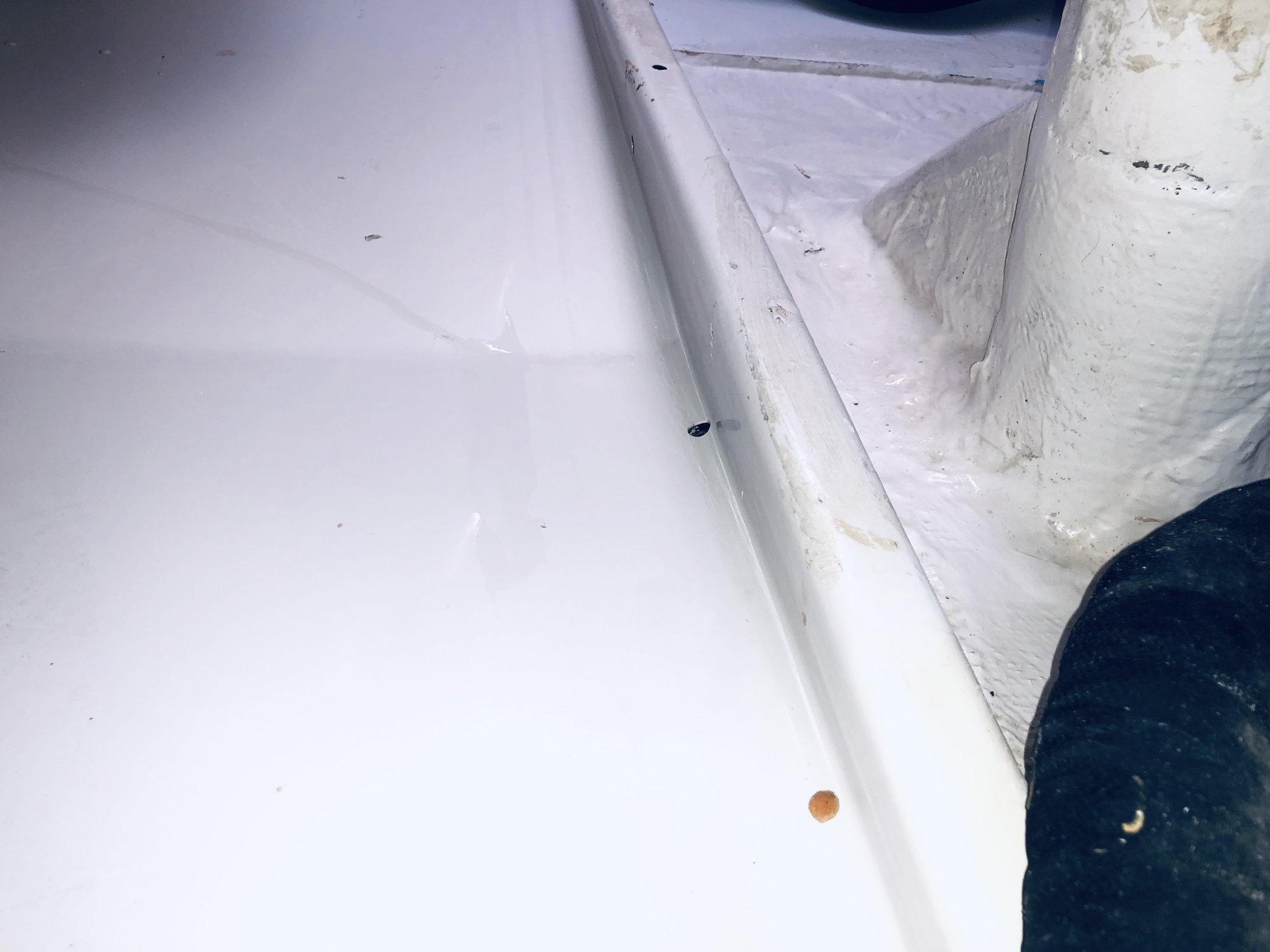

Yes this is the original HMH and fuel tank. Epoxy repair seems to be holding but it is taking a long time to get all the diesel out of the bilge. Still showing up 2 days after the repair. Keep checking the tank and it looks like there is no more leakage.

i noticed that the diesel found its way inside of some of the fiberglass places that overlap. its so thin it wicks its way into the fiber.. and it takes time for it to work its way through the fiber and out the other end of the fiberglass tabbing. toss in the dirt that builds up in the area under the engine that cannot be reached. it's a sponge for the fuel.

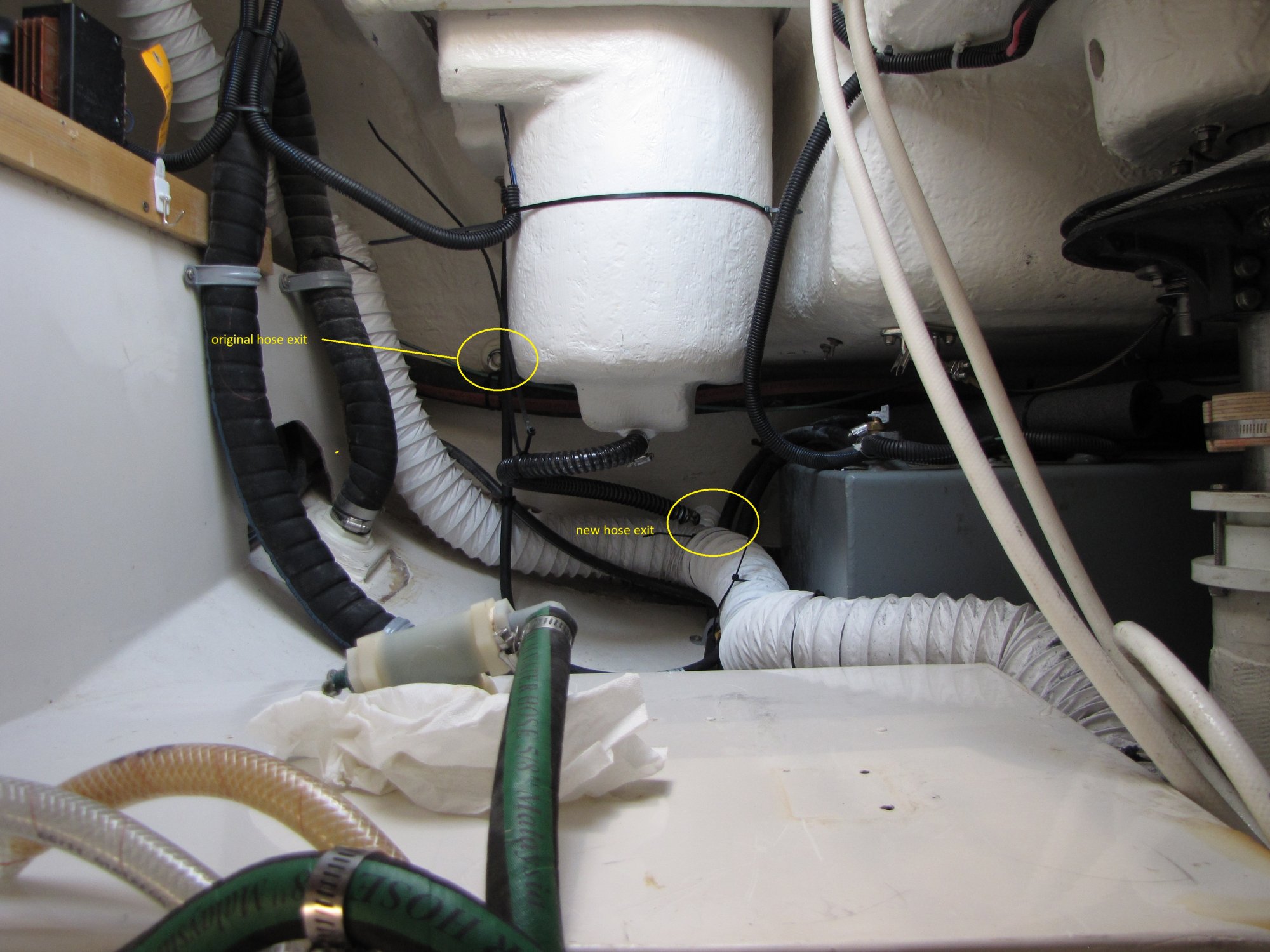

Amazing to see that area without the fuel tank. Mine isn't anywhere near that clean. Is your HW tank in the 2nd picture? If so, what size and make?
The hot water tank is in the dumpster. Yeah.. i spent around 4-5 hours cleaning this area out since this is a one time deal with full access like this. at some point in the future i'll replace the HW tank.. at this point i have too much left to do before its time to get in the water.

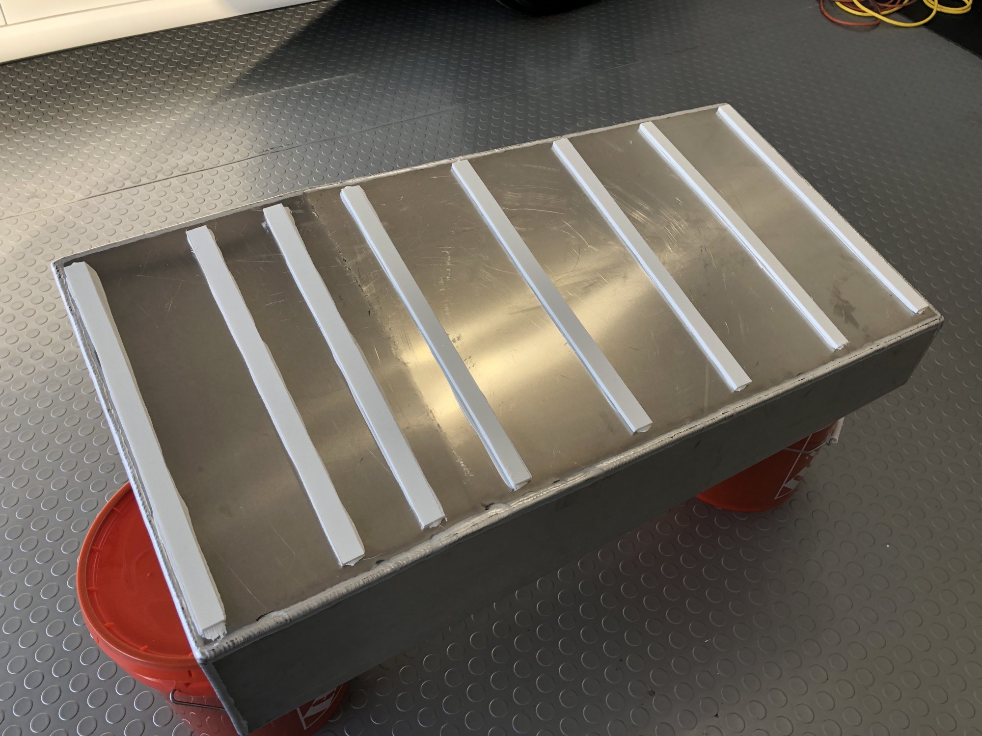

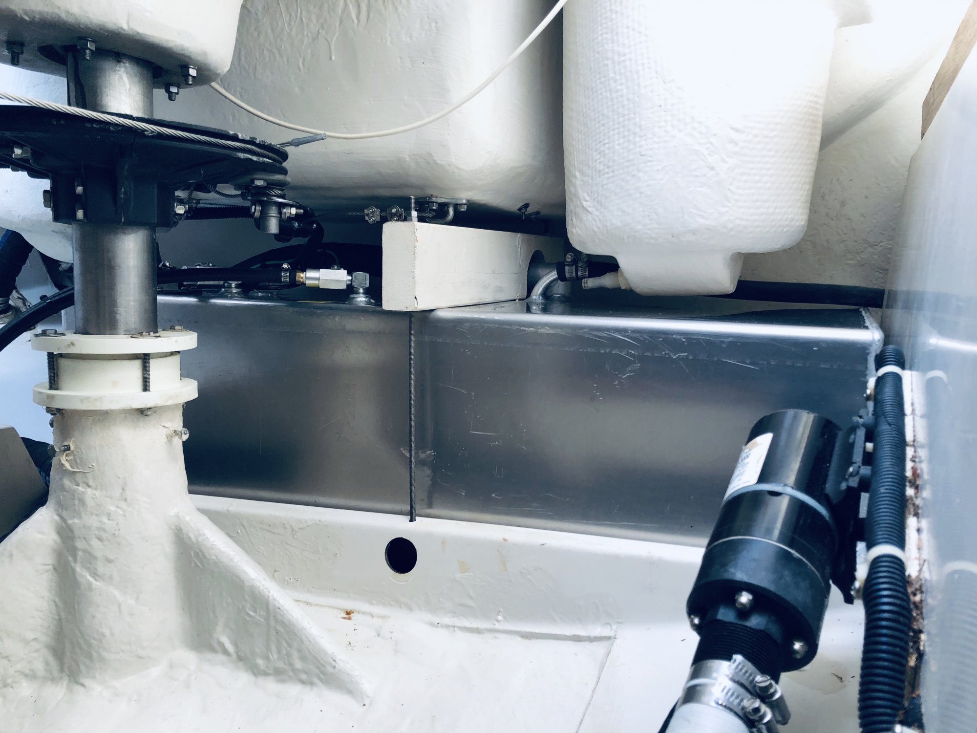

Boat yard opened up this past weekend so i was able to get in and get some work done..
Installed the fuel tank and ran the fuel lines!
I did follow the recommendation to lift the tank off the base.. i installed several strips of starboard to keep the tank out of any water that might drip and run down to the drain i drilled.
i then treated the entire outside of the tank with CorrosionX HD.
