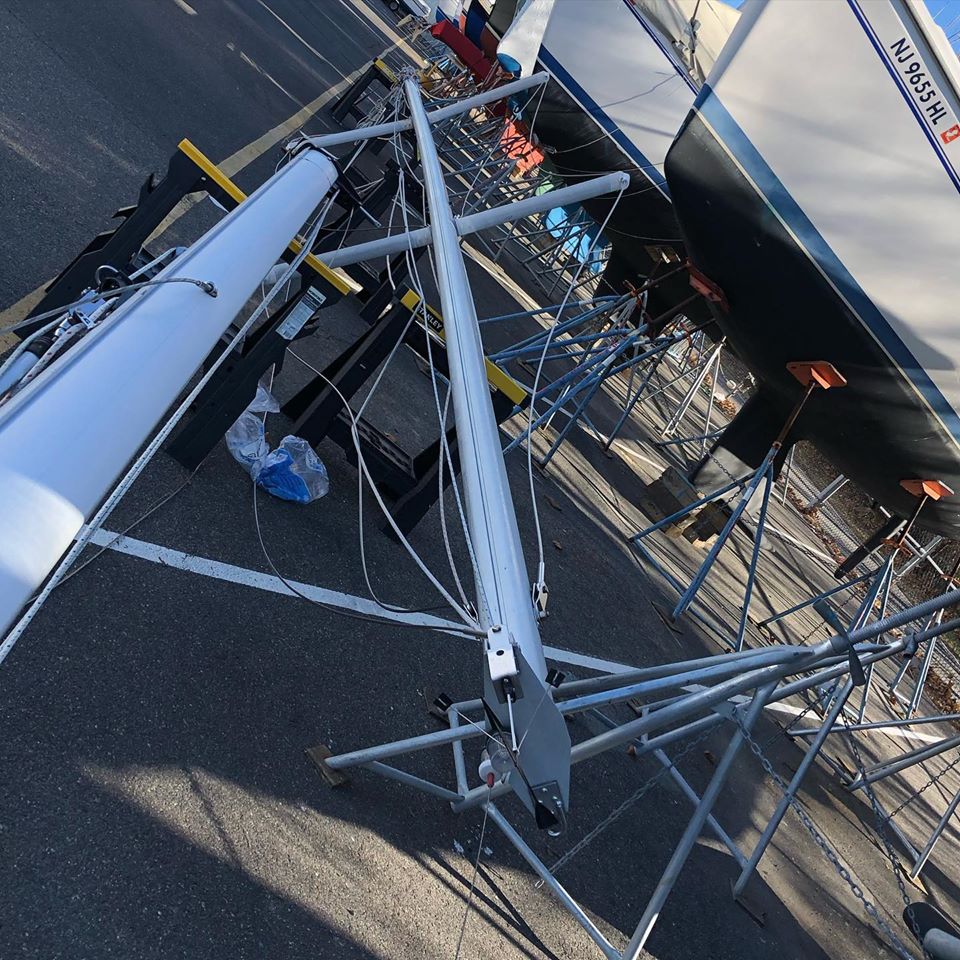

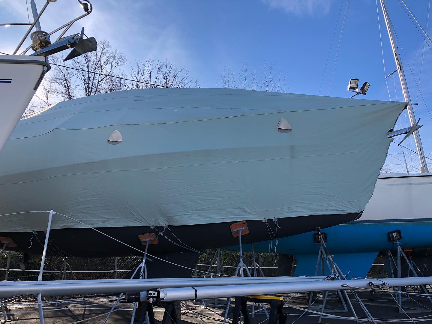

The cover that came with my boat (#48) is a mast-down cover. So every year I take my mast down so I can put the cover on. My club organizes 2-3 of these "mast parties" each season where we take 7-15 masts down in a single day. Splitting the cost across all the participants costs about $150 per person for the crane, and everyone helps take everyone's masts down so the labor is "free".

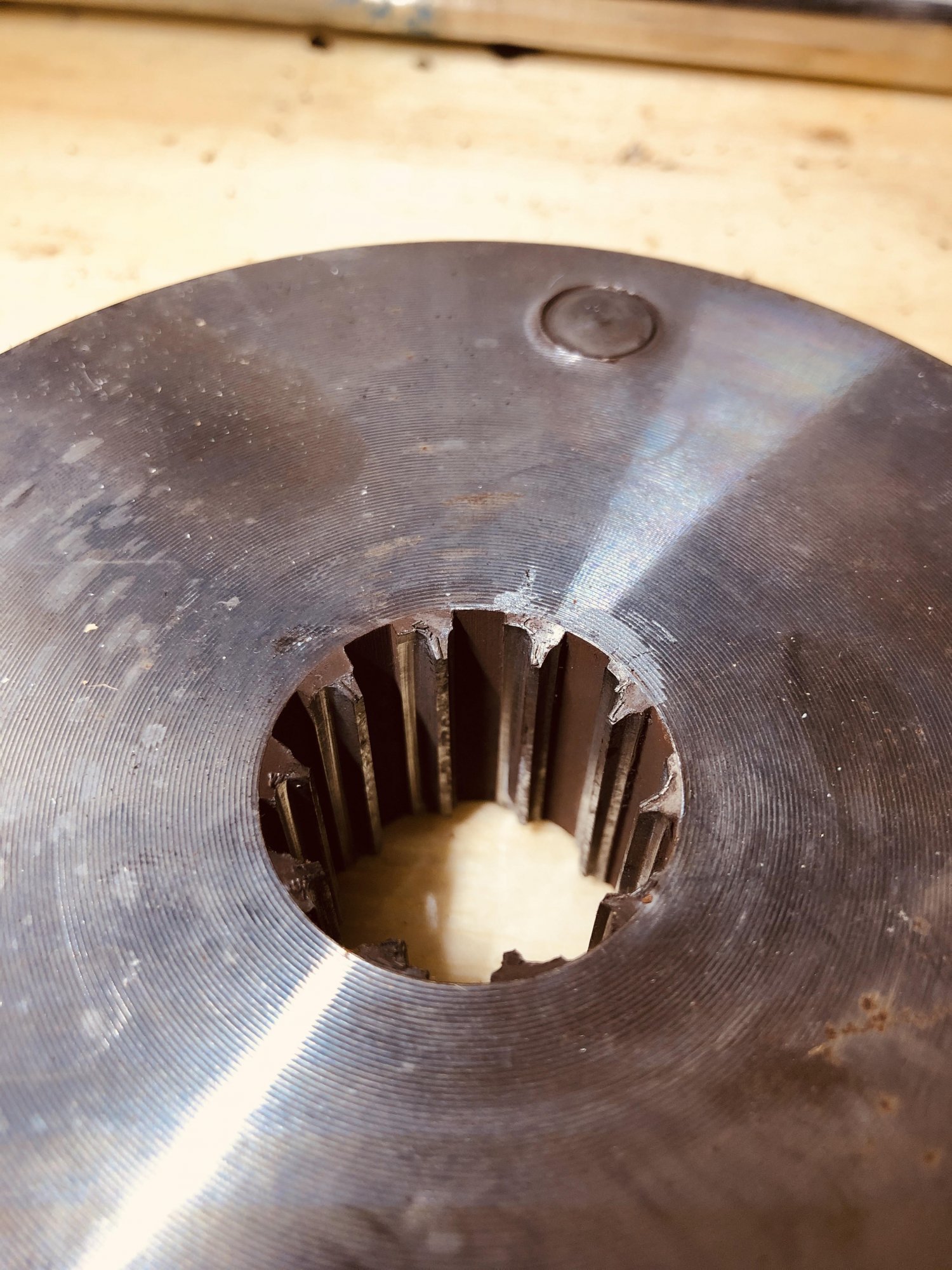

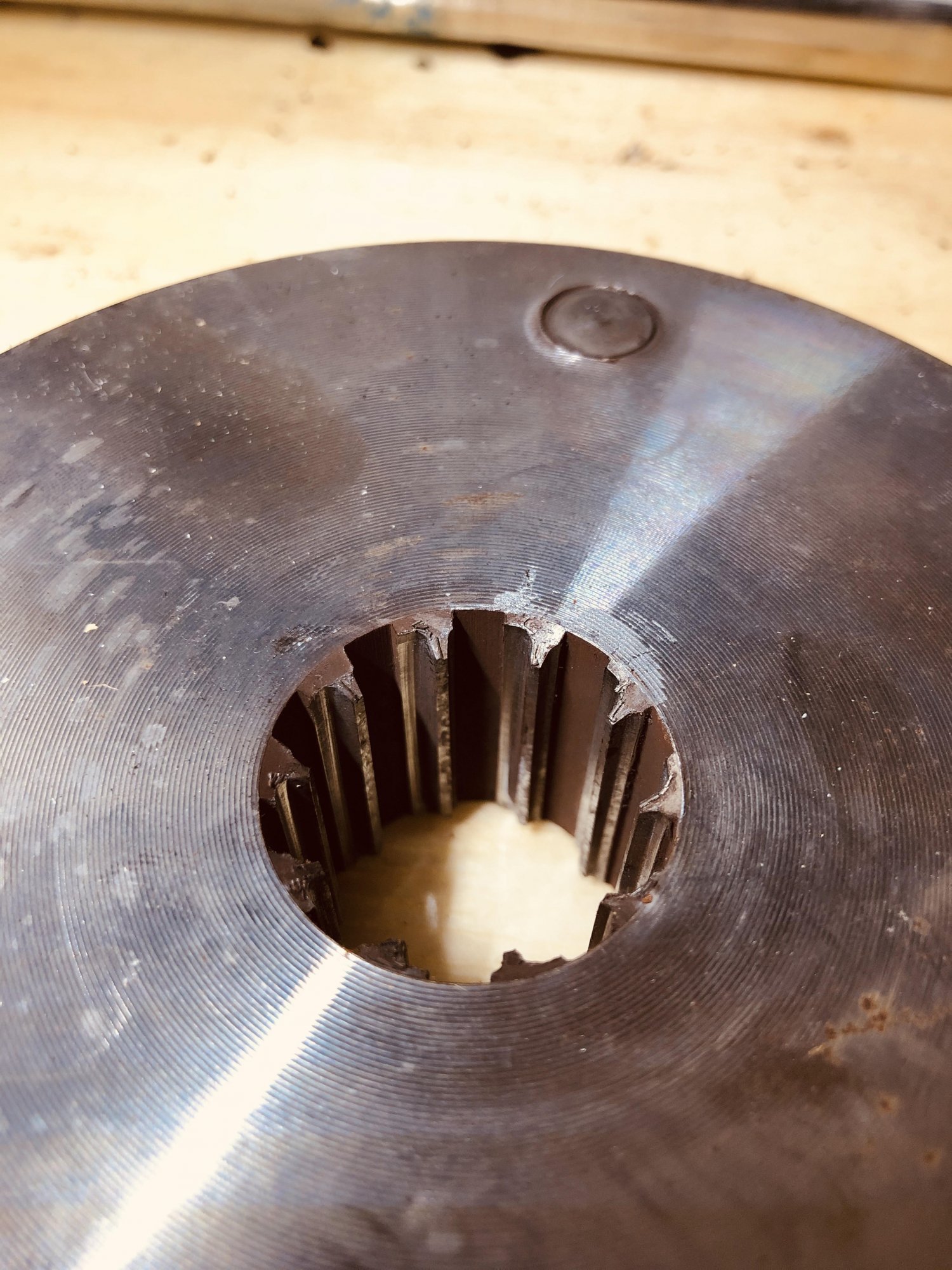

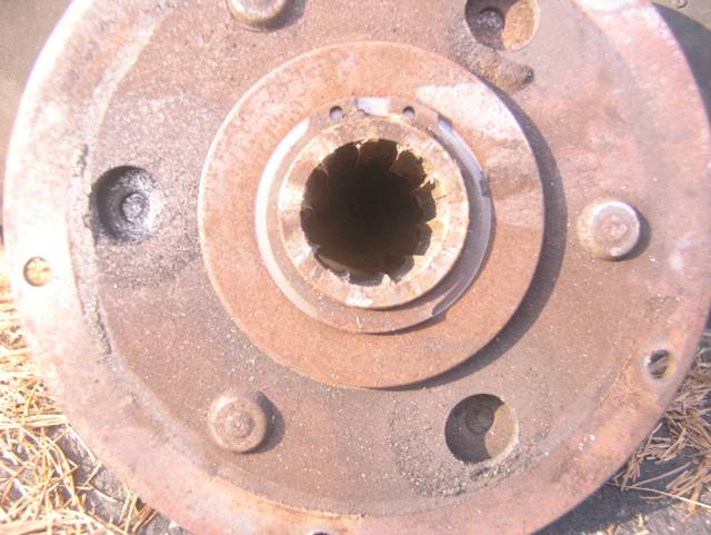

pulled the trans while doing the mounts and discovered the splines on the damper plate have about 10% of their teeth left.. so new damper plate on order
Here is the rub on the damper plate. First I'm betting it was an R&D damper with a polly ribbon instead of springs. These dampers are too stiff for the torque rating for the MX25. They end up cracking. You probably have the input spline shaft of the tranny worn like mine was as well. The problem is if you just replace the damper it will eat it up again if it is not spot on. Don't be fooled here as it may feel ok, but just the top corners of the splines of the damper will be in contact not the full surface. You either have to replace the input shaft or mount the damper on a custom ring that will push the contact point further into the shaft where there is no wear. I cut my ring out of AL and used a Sacs Damper plate #1866--50-002 that was rated for the proper torque. I have now almost 10 years (800 hours) on this novel repair and no apparent problems. I need to change my Cutlass bearing (mine is epoxied in, that is another story) so I will pull the engine up and remove the tranny (easier than taking the rudder off) and see how it looks and let you know.
Thanks Witz... i reached out to my transmission guy and send him some photos of the splines.. i'll send him the trans if it needs a new input shaft. and Thanks for the info on the buzzer.. I have to replace that european connecting strip in the engine pod since it does show corrosion and it sounds like a lot of others have had issues with that connector overall.. maybe that will resolve the buzzer issue.

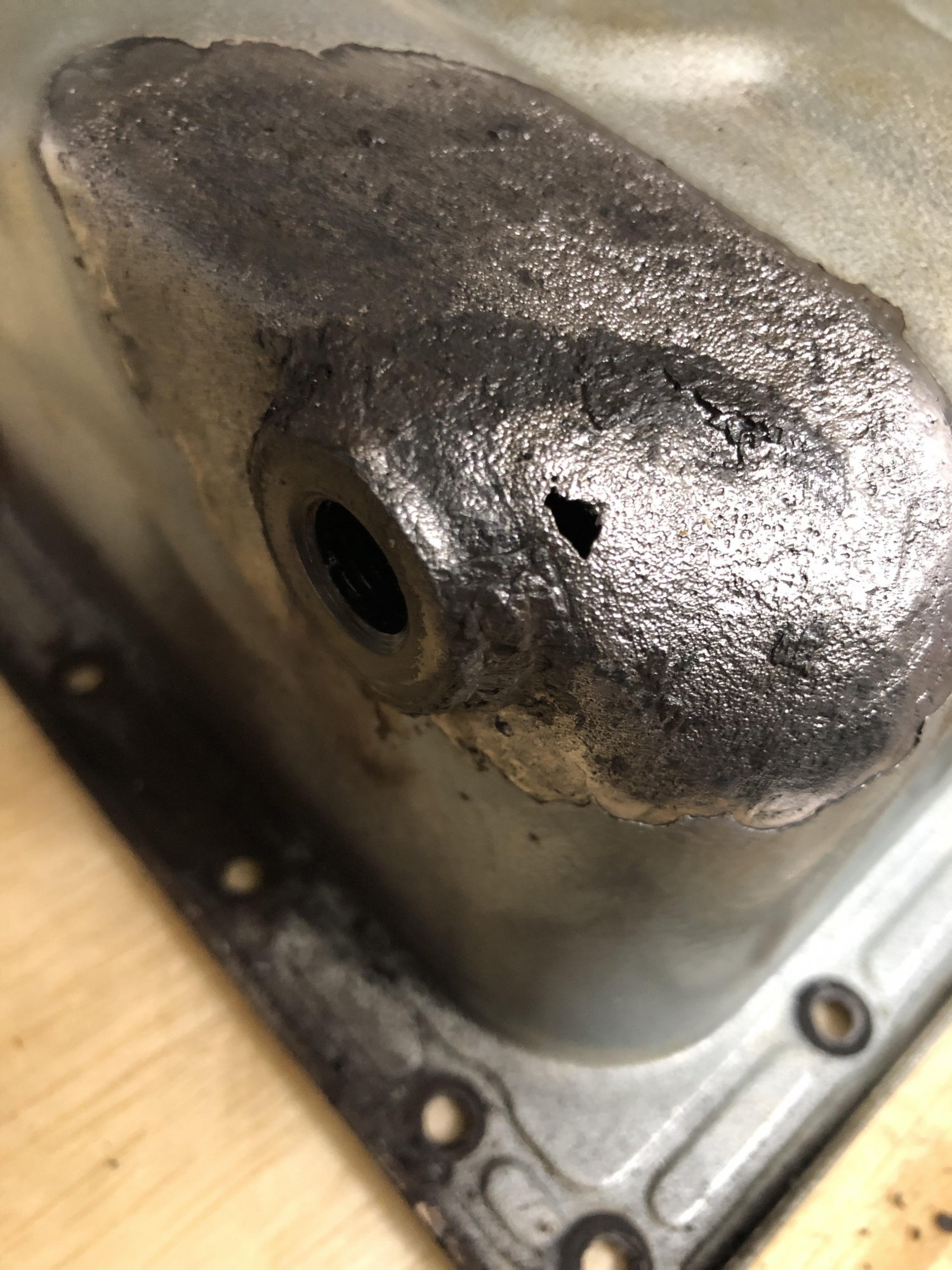

Oh yes.... the rabbit hole deepens!

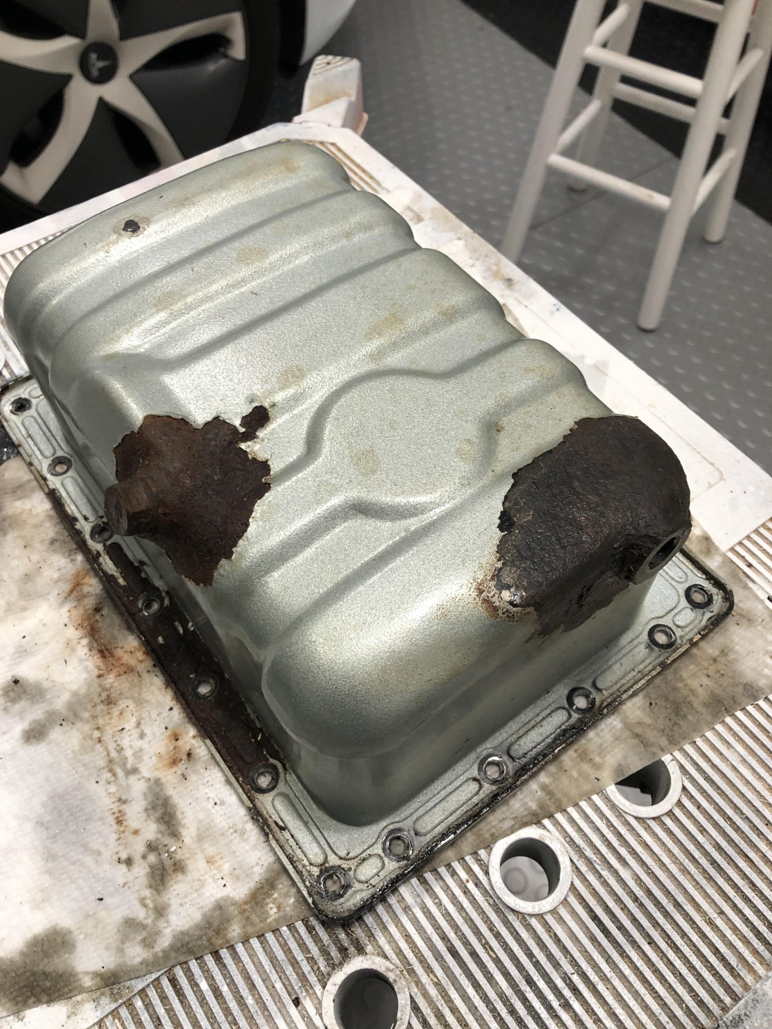

slow oil leak which the surveyor suspected oil spillage from an oil change.. turns out not. i dropped the oil pan today and discovered this beauty..

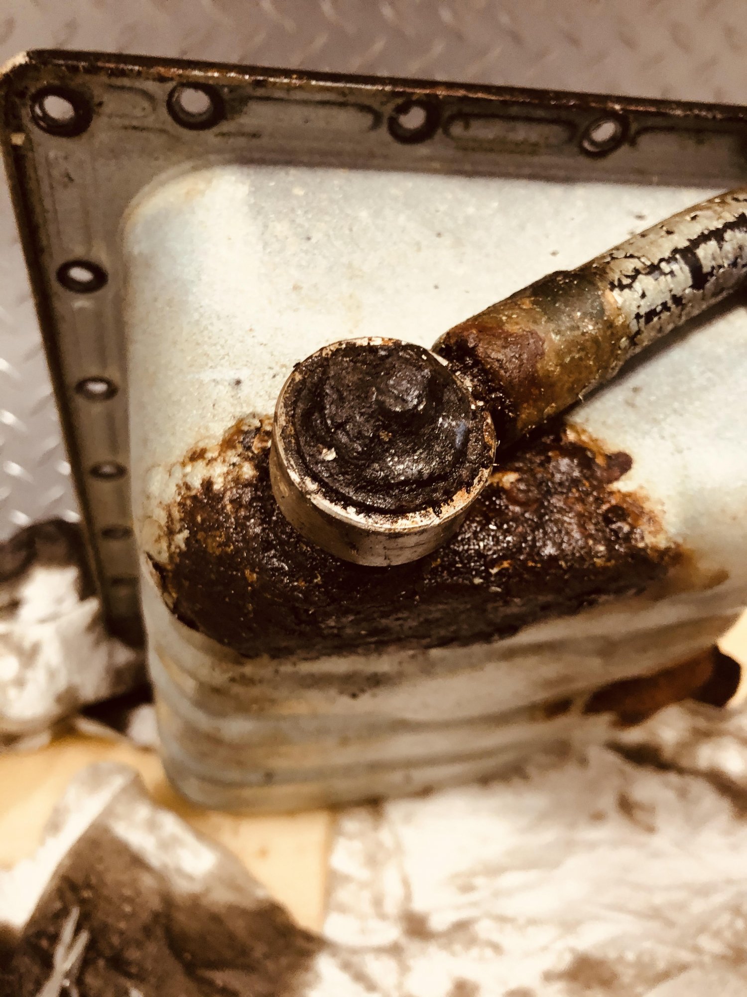

brought the pan home... started cleaning and getting the rust off and waalaaah..
Now the question is... repair or replace?? this is the sort of thing that jbweld could take care of... the metal is so thin i wouldn't try welding..
new part is $400.. jbweld is $7.. blown engine due to total loss of oil from jbweld failure.. $15,000..
gotta love these decisions..
here's the overall condition of the pan for reference.

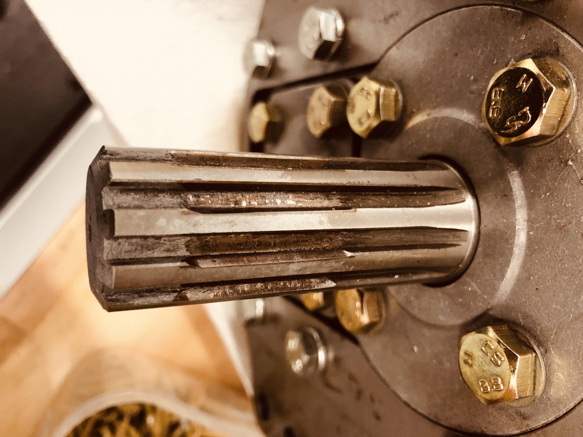

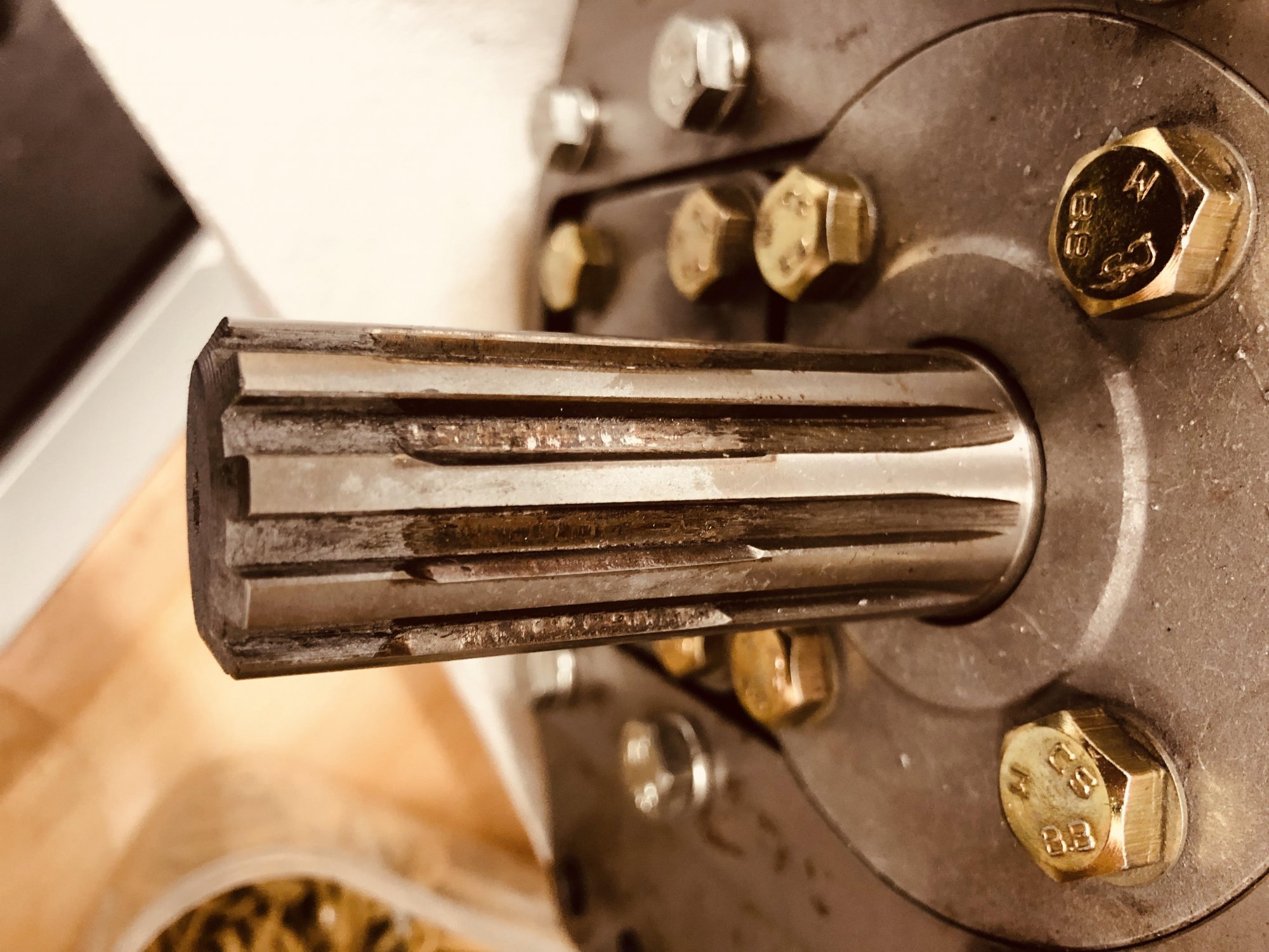

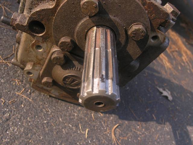

Here's my damper plate and trans input shaft..
Ordering a new damper and sending out the trans to have the input shaft replaced.
I guess the silver lining in all of this is that the engine should sound totally different..
Look at the play between the plate and the shaft my god!

found one new one online for $250.. decision made.. new oil pan ordered..
Yep R&D damper... Piece of junk. What Damper did you order? With these light flywheel weight odd cylinder count diesel engines, don't idel them for long periods of time...i.e. to charge your battery bank. This creates the maximum torsional vibration and works the damper plate.
i've not ordered a replacement yet.. but i believe it will be the Sachs 10-1866-061-001 when i do. according to the specs everything lines up on that model number..
Dec 25, 2008
1,580
catalina 310 Elk River
I believe RP used that one. Might want to ask him how it worked out. I used a softer one but had to make an adapter ring.

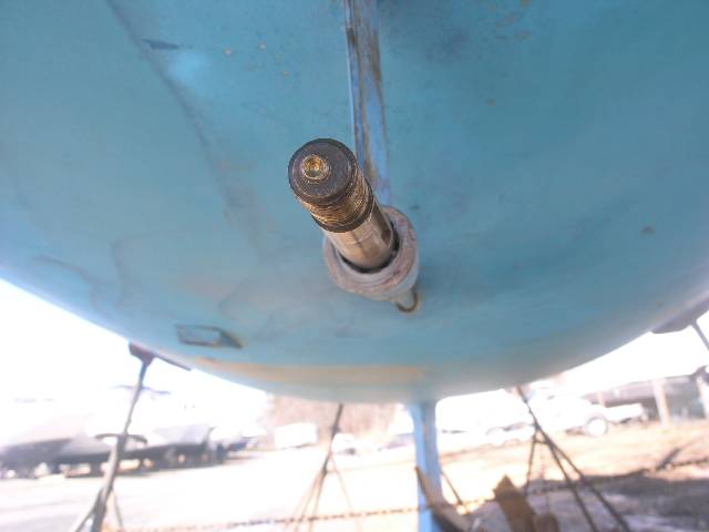

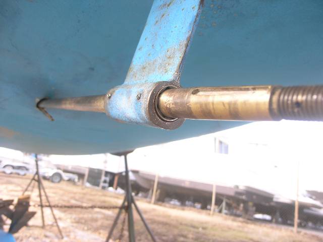

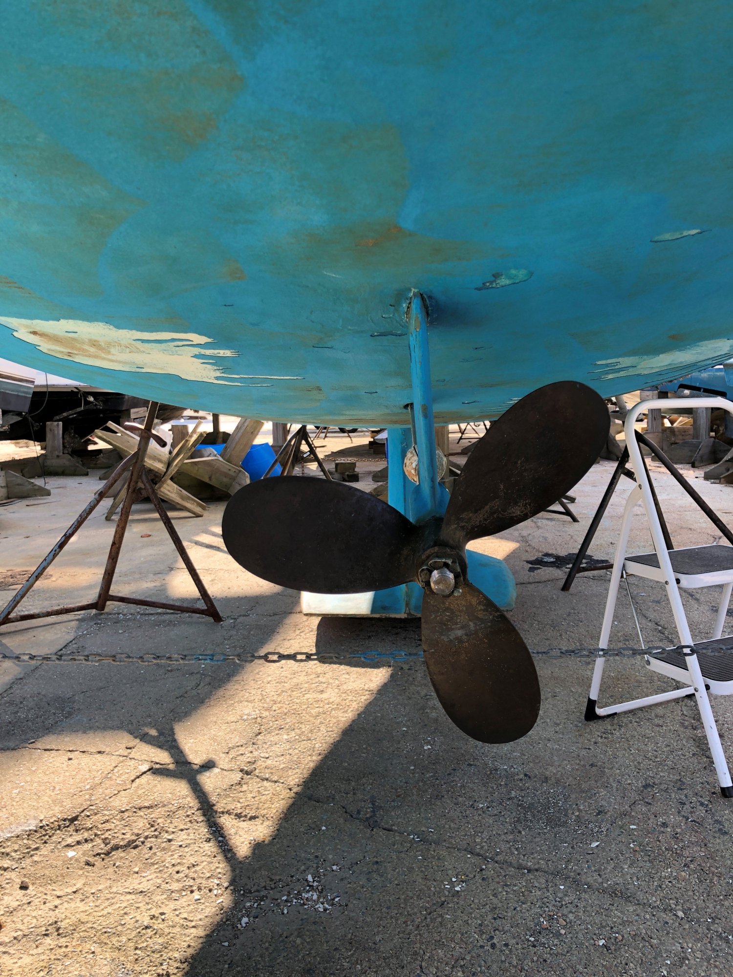

Anyone else's strut alignment look like this? it doesn't appear to be damaged and my alignment was perfect. Did Catalina design them like this to reduce prop walk or allow for the shaft to be removed?
Dec 25, 2008
1,580
No, Looks bent to me, but pictures can be deceiving.

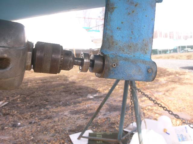

However... mine was so far out (cocked froward end up in the direction of the shaft) that when I replaced my cutlass I could not get the shaft back in. For mine, it appeared to be poor manufacturing, they must have just jammed the shaft in and it finally wore out the cutlass into alignment. So it just may be poor manufacturing in your case as well.
I ended up drilling out the strut and floated the new cutlass bearing in place with epoxy for perfect alignment. My alignment with the keel has always been pretty good.
Does she pull hard to one side under power if you let the wheel go?
The left picture was after new bearing was installed.
The middle picture is showing the strut drilled out but cutlass not epoxied in yet. Notice the gap at the bottom.
The right picture the 1.25" drill process.
Yours looks to be bent to starboard a bit. Mine is centered. Yours should be okay since the alignment is good. Shortly after I purchased my boat, I noticed that the skeg was loose, and I had to tighten the mount bolts. The boat only had 19 hours on it, but had been in the water for two years.
