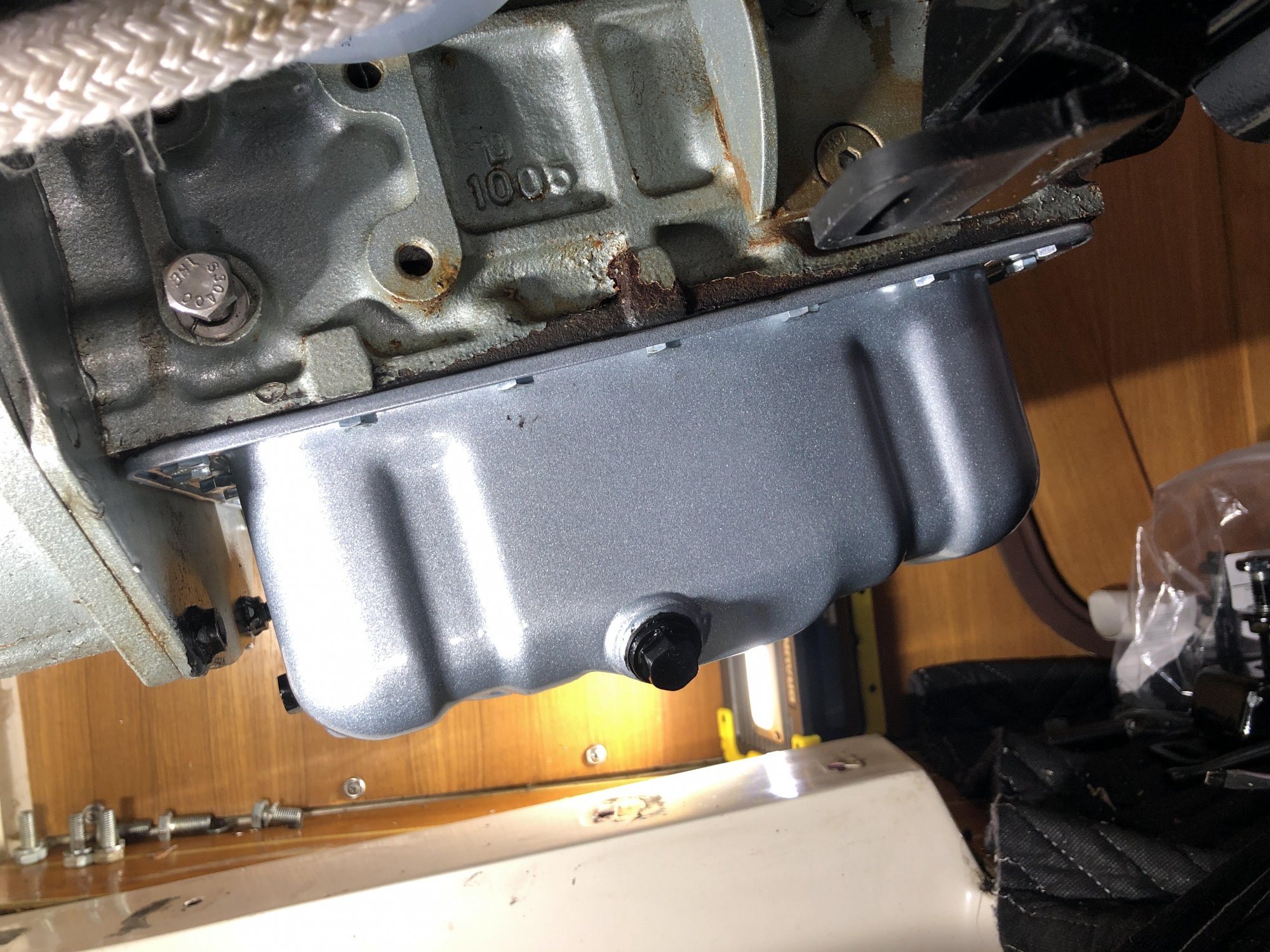

Replaced the oil pan today..
Went with new bolts since the original were rusted.. point to remember if you ever do this job.. only get bolts as long as the threads are on the original.. i went with full threaded bolts that were the same length and they bottomed out in the block. Apparently the threads are not cut as deep as the original bolts are long.
i also got rid of that sump hose. Its just another point of failure and i change the oil out of the dipstick tube with a vacuum tool.

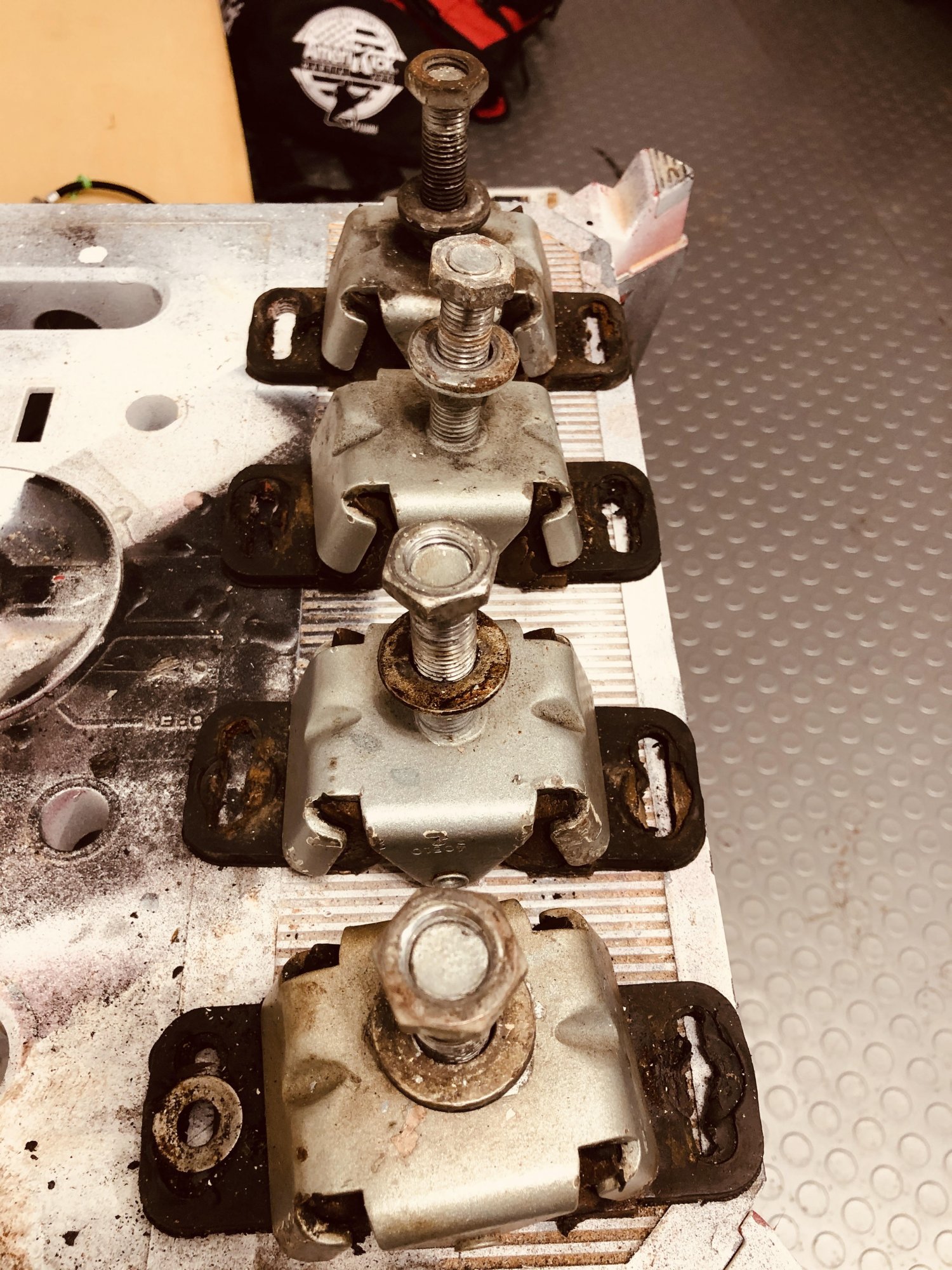

you were luck to get the bolts out. SS+AL+NACL =seize up!
Honestly, i don't know how the heads didn't come off the bolts with how much torque i had to put on them.. only 2 of the bolts were in there like that.. the other 6 came out relatively easily

The 2 rear port side twisted off on me with an impact wrench after 3 days of PB blaster. Fortunately by using replacement OEM mounts I had lateral adjustment to drill and tap new holes. Why manufactures don't get the SS+AL+NACL =seize up factor I will never know...at least put anti seize on them!

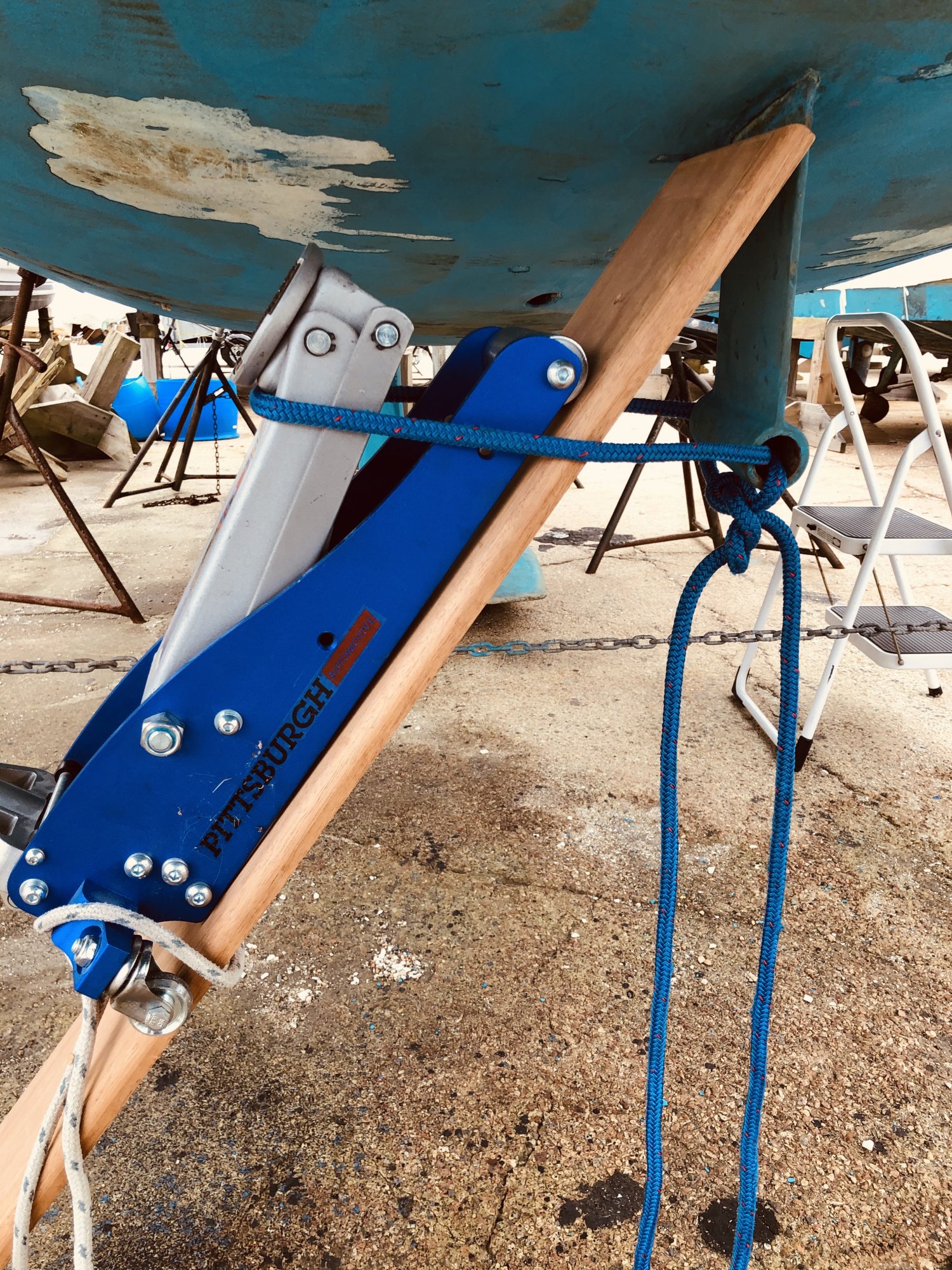

Finally made some more progress today.. Straightened out the strut.. installed the new shaft, new PSS, new cutlass bearing, and rebuilt transmission. here's a pic on how i straightened the strut .. that's a piece of mahogany.
it was far easier to straighten that i expected... i had to adjust the twist on the strut once it was straight and i was able to do that with the old shaft as a lever in the cutlass.

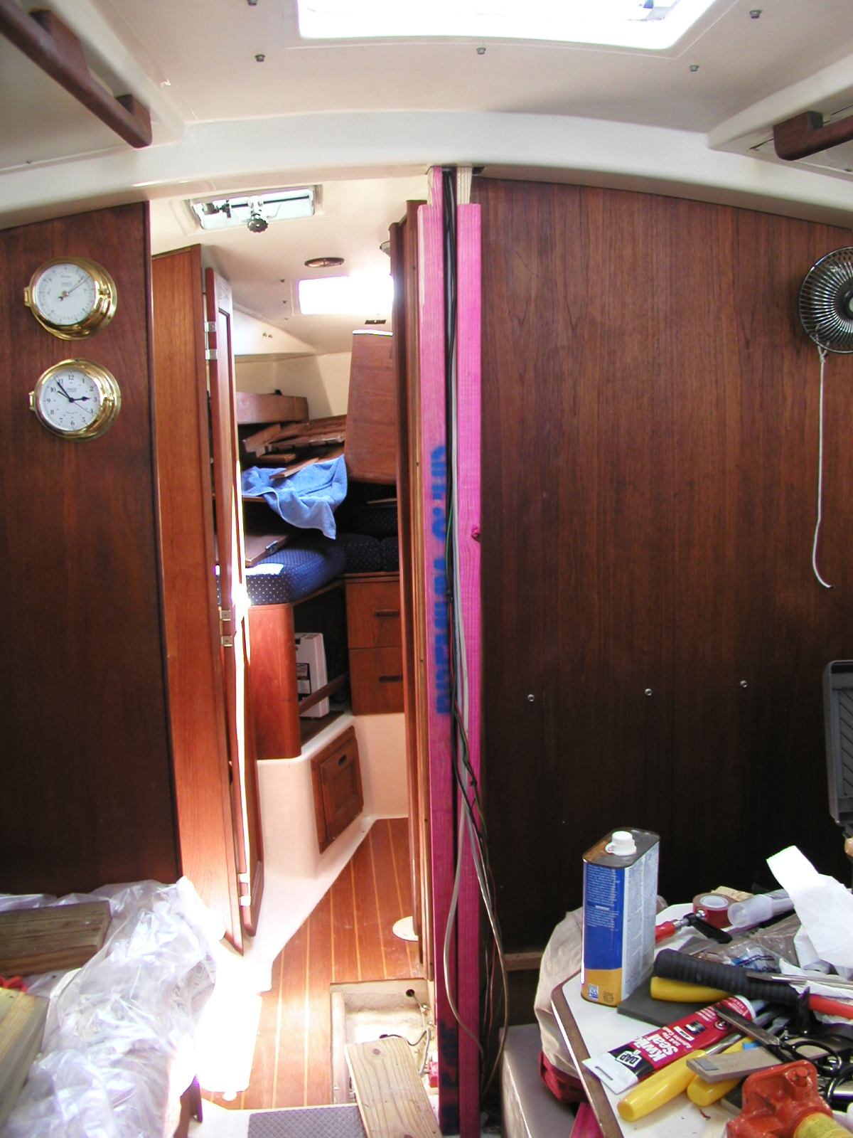

Will be nice to not have the salon look like it was hit by a hurricane at some point.. Does anyone else feel like any onboard project totally overcomes the space inside with tools, parts, cushions, and everything else everywhere???
Yes, sounds pretty familiar.

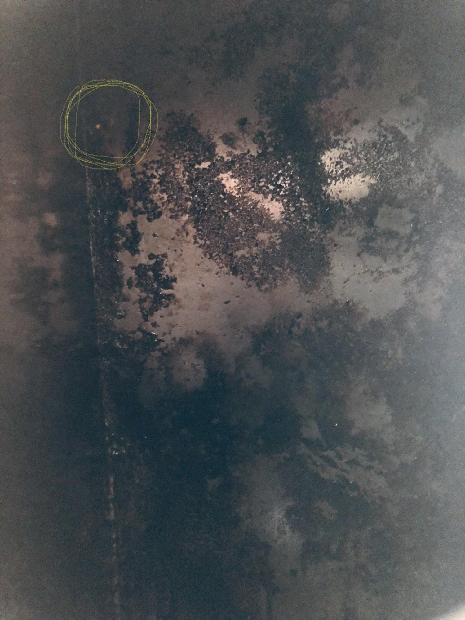

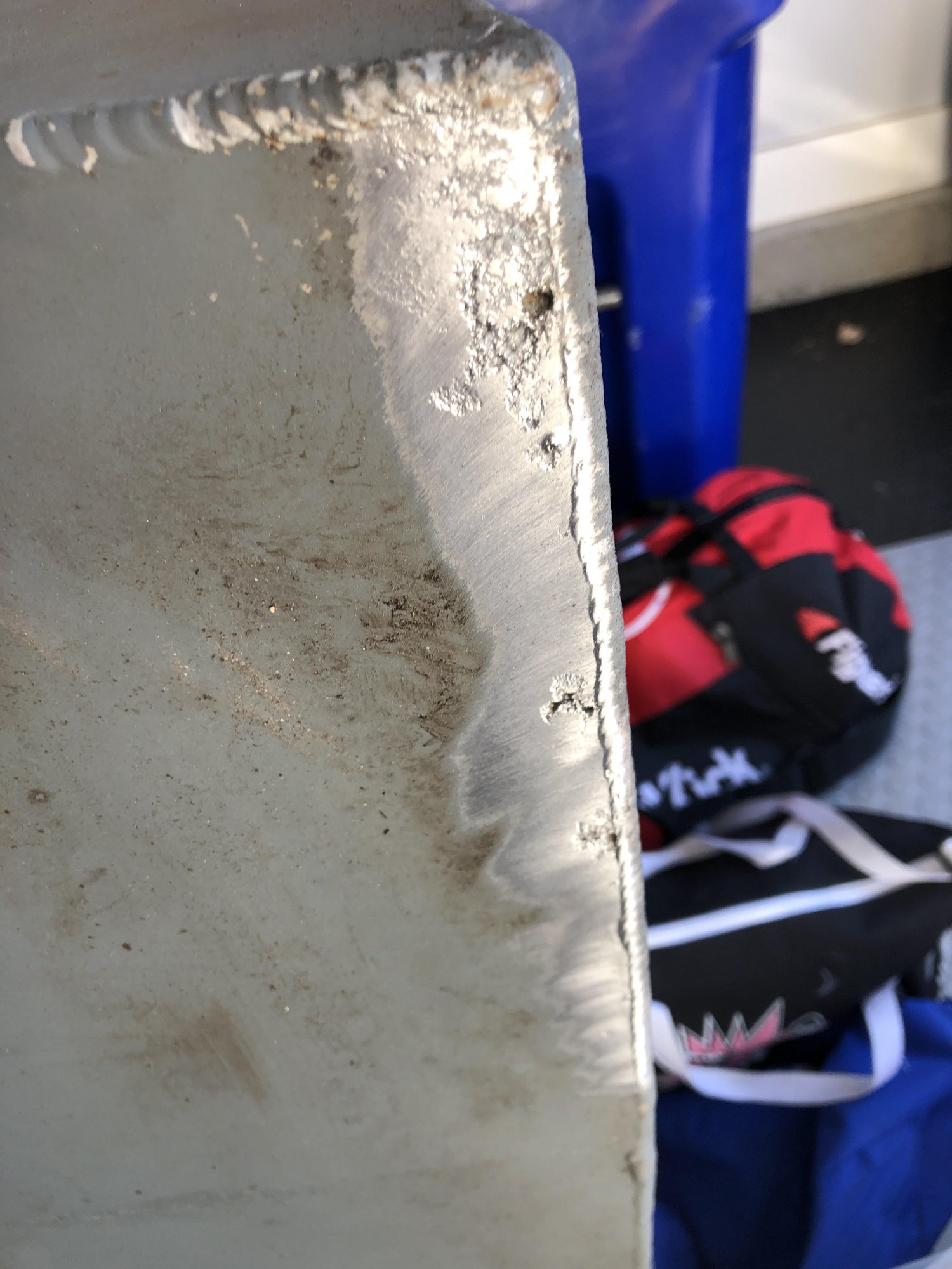

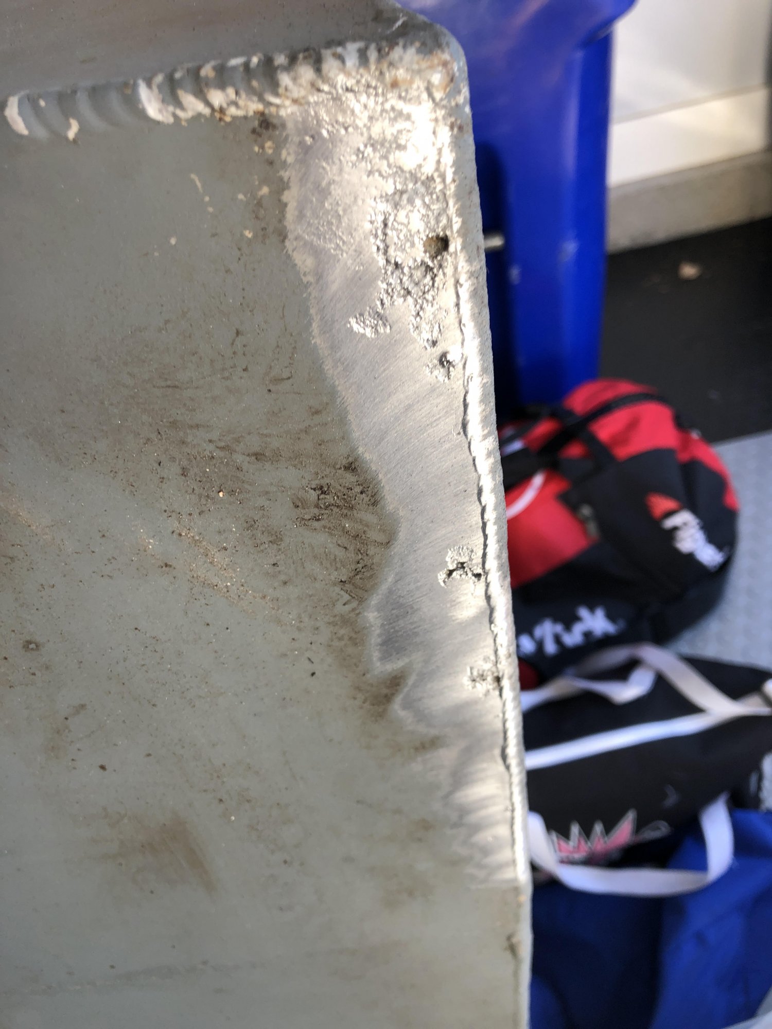

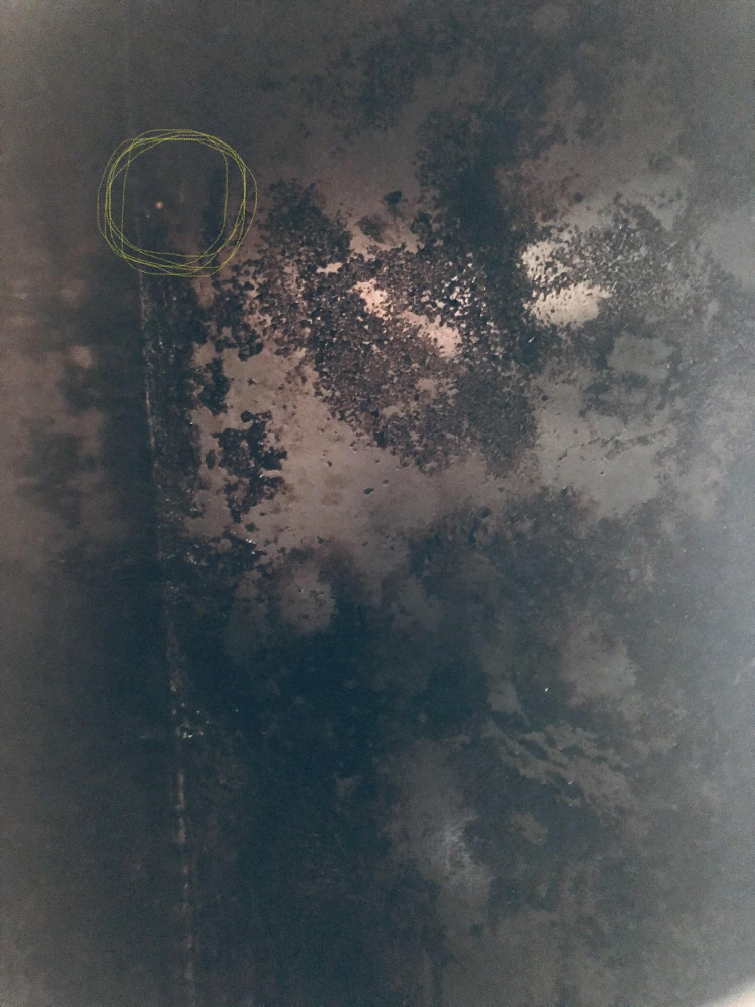

The discovery continues! got down to the boat on Saturday to do some cleaning and the cabin smelled like the inside of a diesel tank! a little poking and i found that the source was the tank itself! So Sunday i went back and pumped out the tank and removed it.. (4 hour job, 2 of which was removing silicone around the propane tank insert so i could lift it up to get the tank out.. SILICONE ARG!).. Got the tank home and here's what i found after wire wheeling off the dirt and paint.
interior shot where you can see the actual pin hole
Repair or Replace???
I think I would replace the tank. The pinhole could be repaired, but that amount of corrosion would indicate the possibility of more leaks in the future. Shortly after I bought my C310, I discovered a leak in the fuel tank, and it was a pinhole in a weld at the seam. I took the tank to a shop that specializes in aluminum welding, and they repaired it, but that tank was only two years old, and had no corrosion. I did talk to Frank Butler about the possibility of warranty coverage, since it was obviously a manufacturing defect, but he pointed out that the warranty had expired. Oh, well.
dmax
Jul 29, 2018
1,272
Telstar 28 Buzzards Bay
You can have a new, thicker bottom welded onto to that tank for much less than a new one.
Oct 19, 2017
8,047
We are reading through and discussing Everett Collier's book, 'The Boatowner's Guide to Corrosion". Sailboat Owner's Guide to Corrosion - Basic Theories (Collier 1-4)
There are descriptions of spot corrosion in fuel tanks and such that result from poor, chipped or worn paint jobs or contact with bilge water and another metal. There is probably an underlying problem that needs to be addressed, not just a fuel tank that needs repair.
I think most of the other participants in the corrosion thread feel aluminum is a poor choice for fuel tanks.
