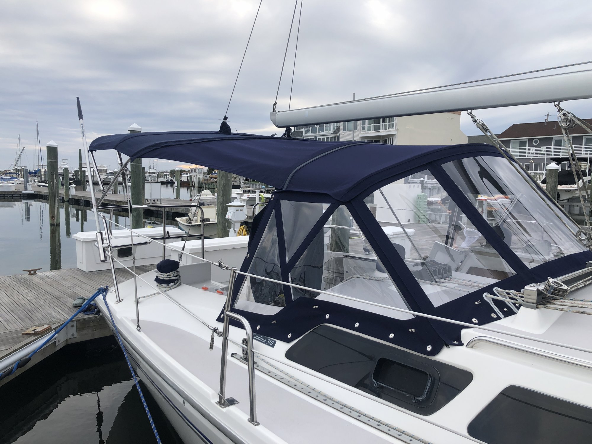

The new dodger and Bimini has been installed..
also the new Zarcor Doors are on as well

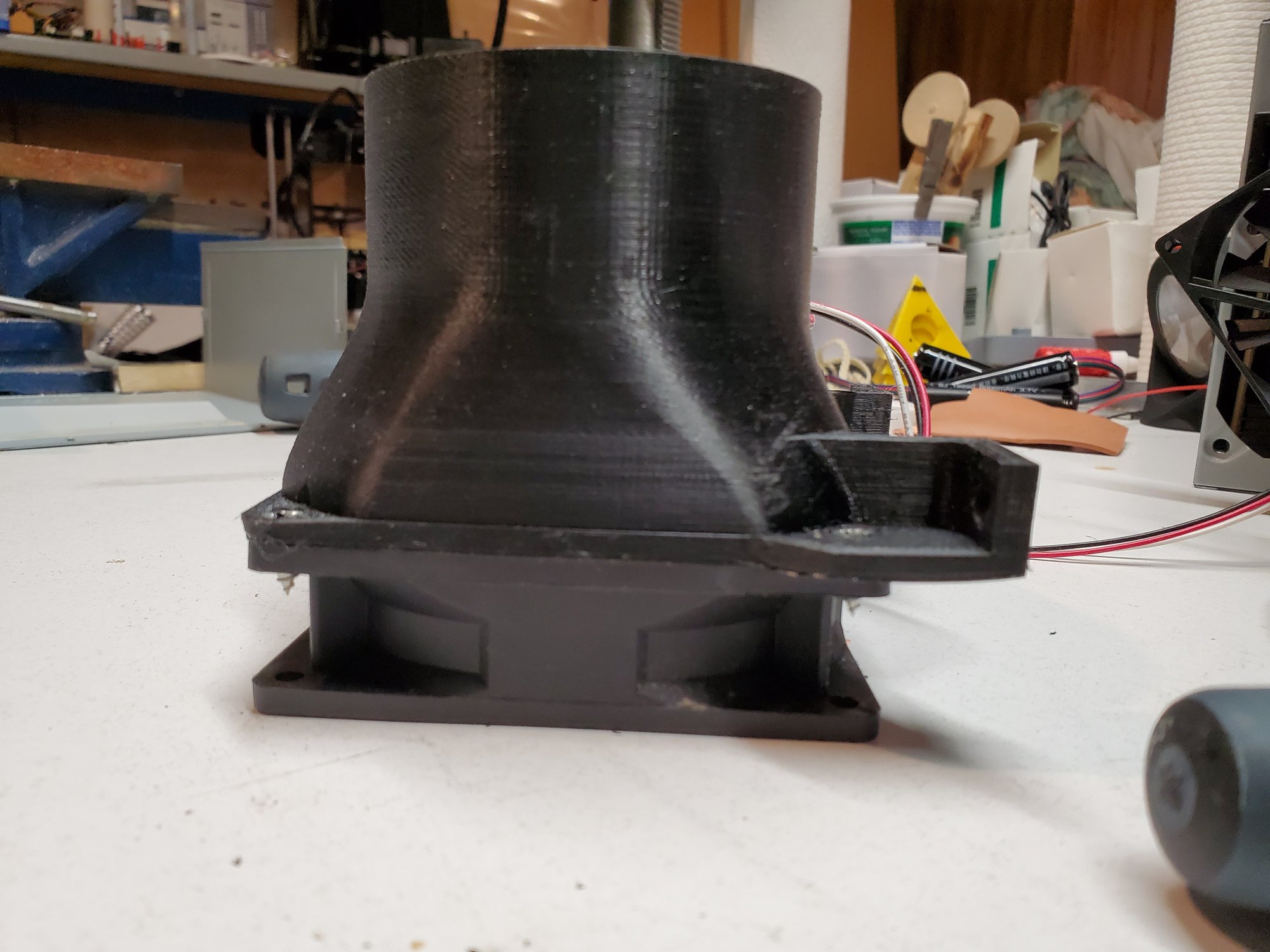

What will go in next is my constant bilge vent. It's an IP67 ignition protected Fan sandwiched between two 3D printed adapters i designed.. on my prior boat i had a similar setup. i run it at around 100-150 CFM year round pulling the air out of the bilge around midship. This gets rid of just about all bilge/holding tank smell inside the boat.

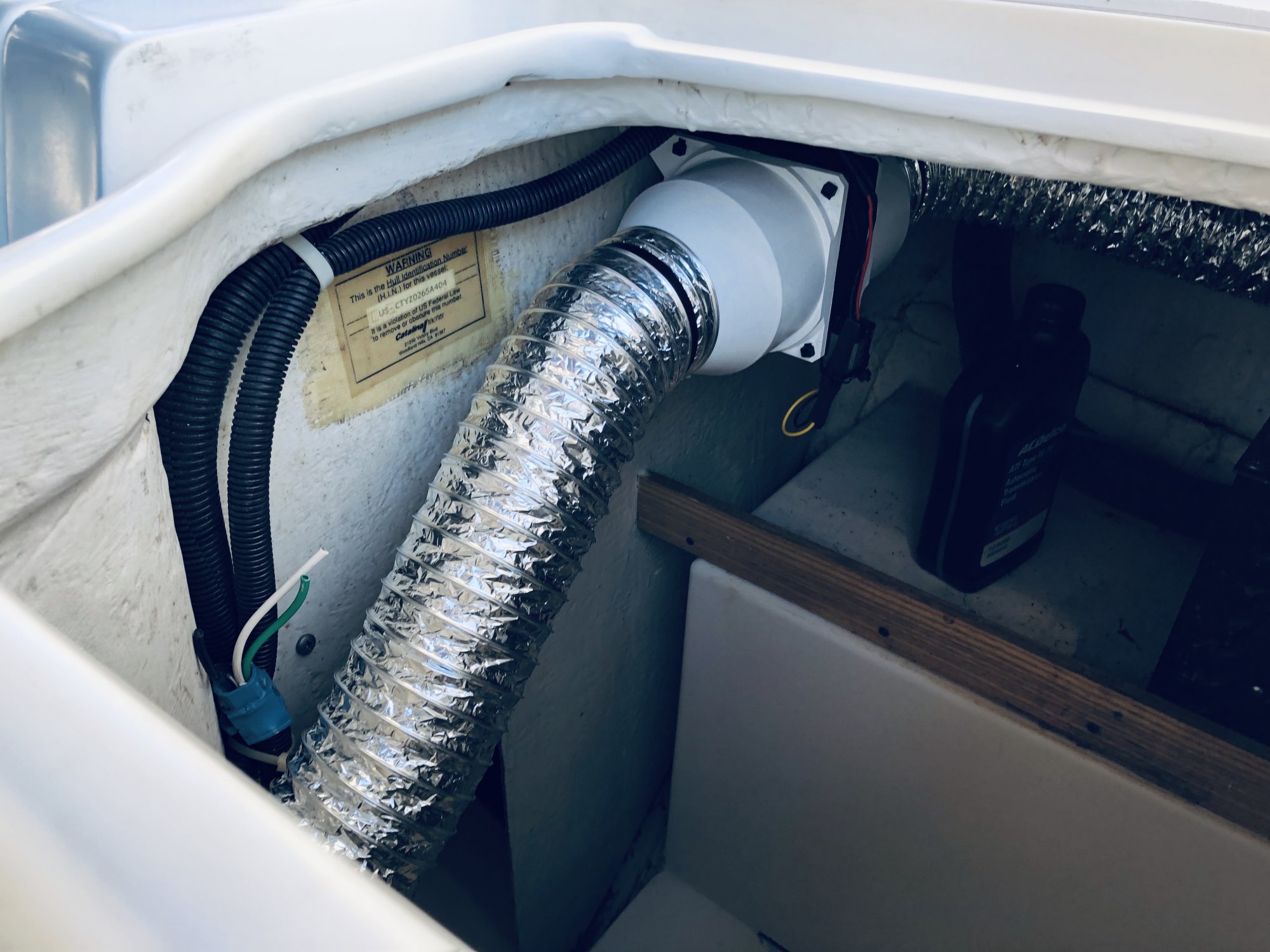

12V but i have a sealed DC step down converter bringing it down to 9V, it pulls a half an amp. in my prior boat i just left it on all the time. Last night i installed the vent on the aft starboard side bulkhead in the rear compartment and wired it to an unused breaker. I'm having it exhaust out of the starboard side stern vent and i'm pulling air from the port side just under the head.
i really don't like that the engine blower uses the port side stern vent while the engine exhaust is coming out of the starboard side of the boat.. to me, with the blower running, i would think it could create a slight draw into the starboard side aft vent and bring fumes into the boat.. either way, this new setup will prevent that.
everyone always says that ventilation is the key to a good smelling boat... this is my way of forcing that.. my thought is that if i can create a lower pressure in the overall bilge than is in the cabin, the bilge air will never make its way into the cabin to stink it up.. and the movement of air from drawing it out constantly should reduce mold and other stink buildup.

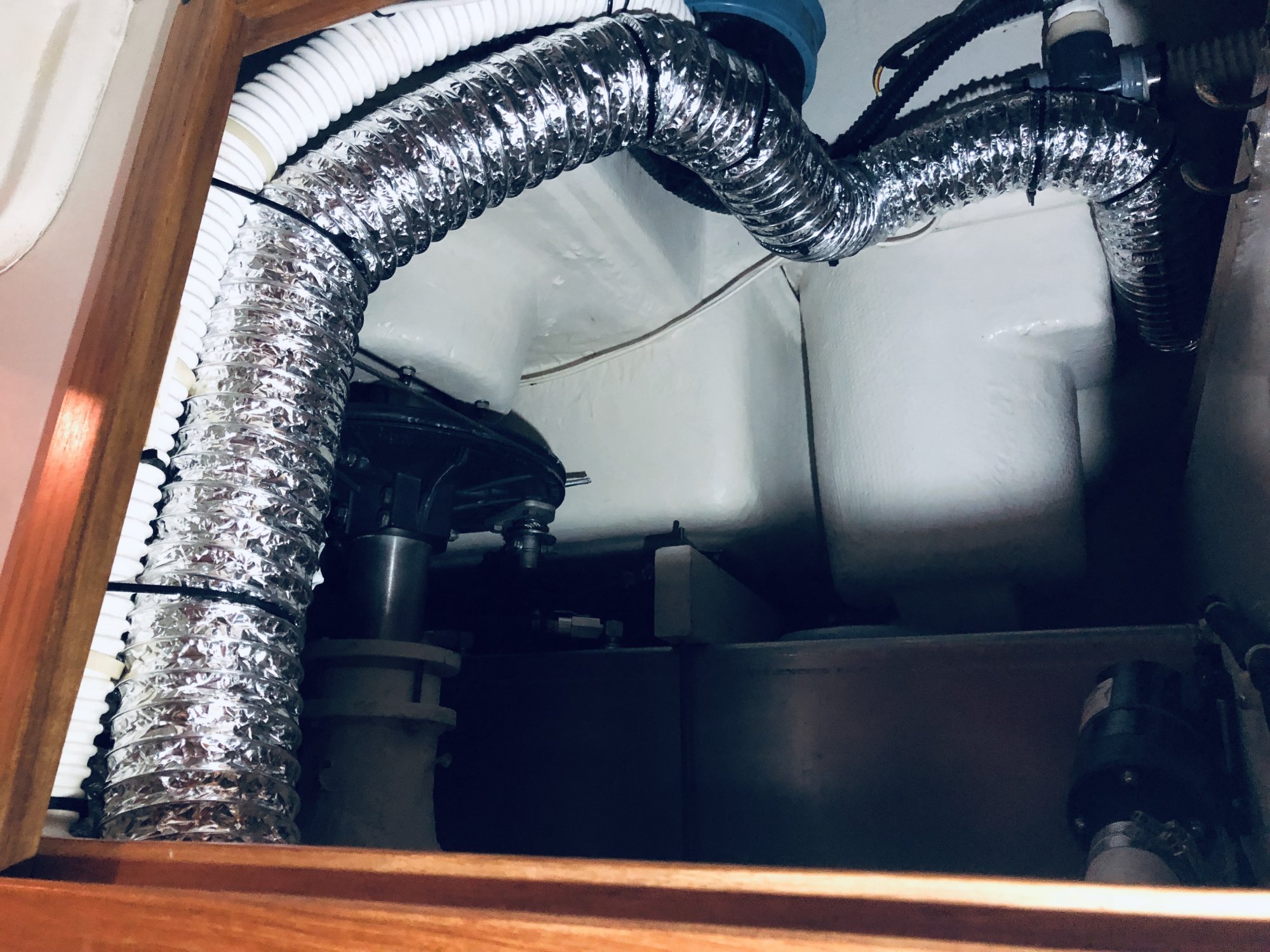

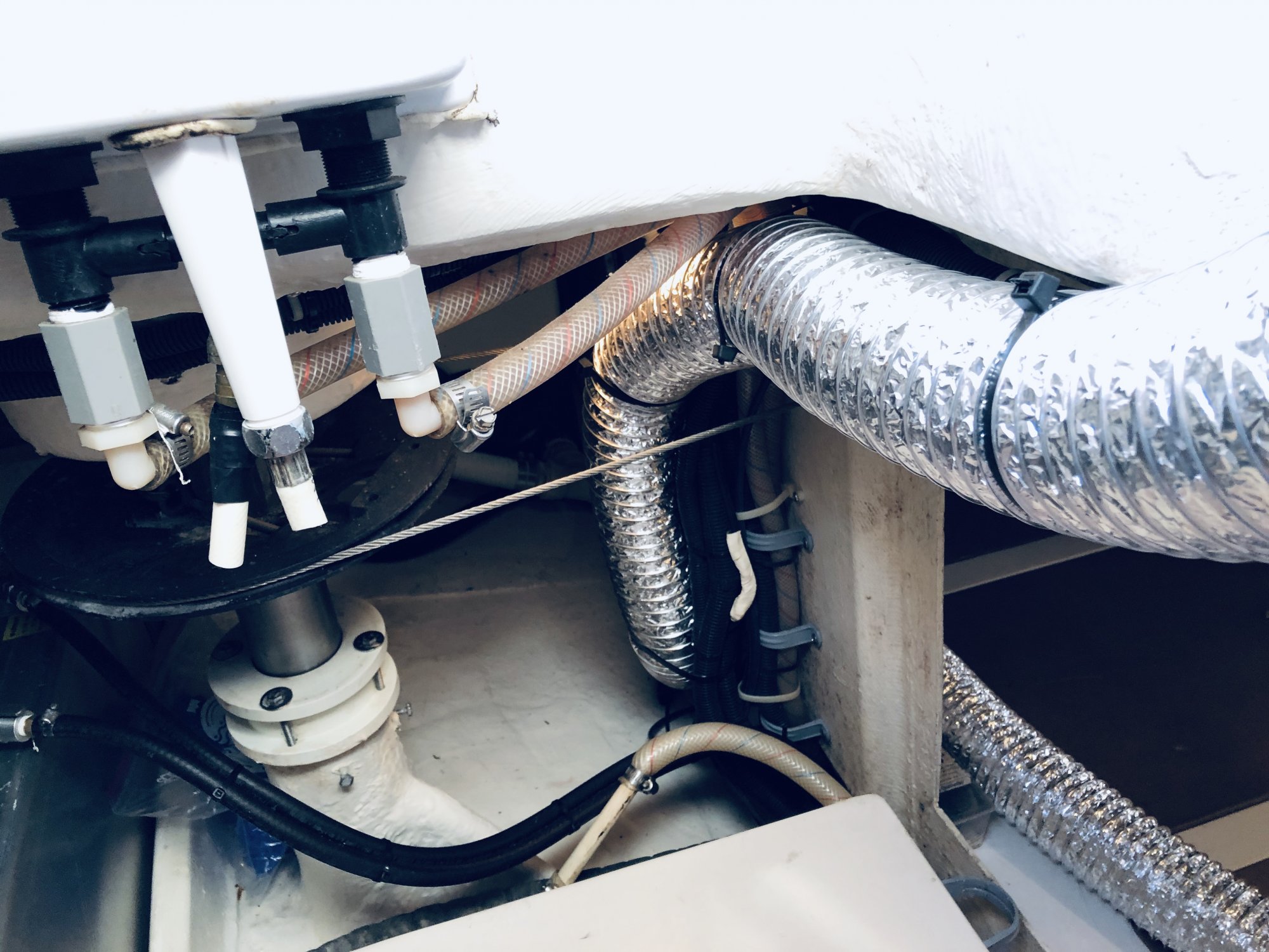

bilge de-stink blower installed and running..
i've run the vent hose up to just under the head to draw from as close to midship as possible. when i lift the hatch in the forward birth floor slightly i can hear the air being drawn in.. so it is effectively pulling air from the entire bilge. i'm expecting a very clean smelling boat when i return to it next.

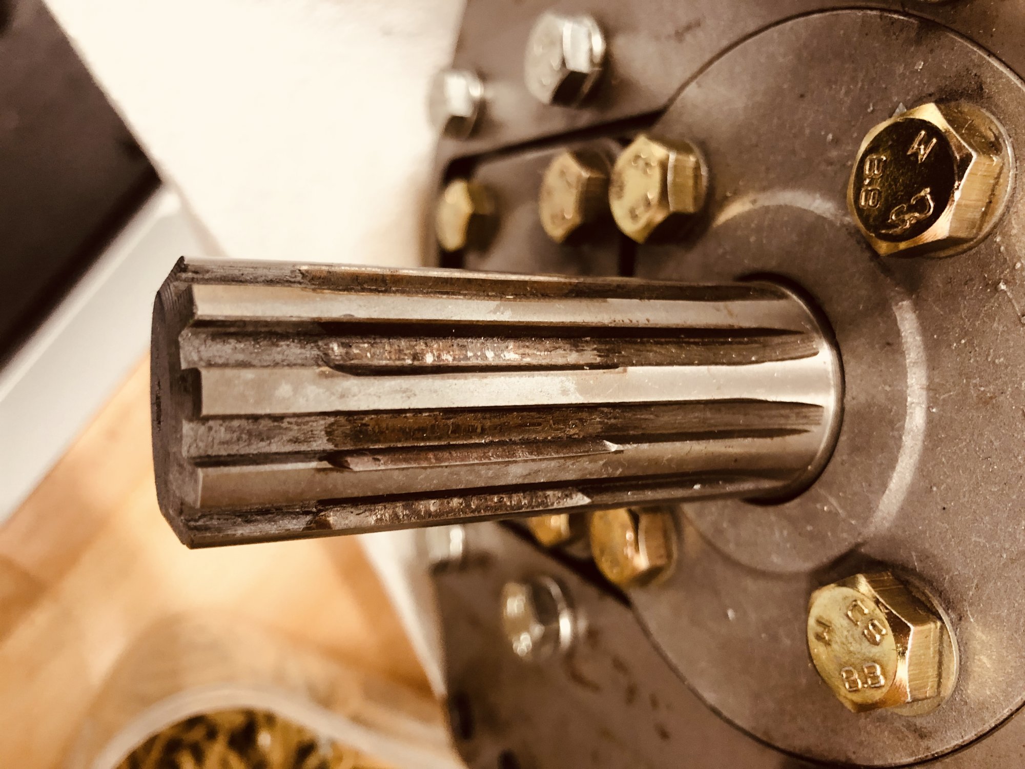

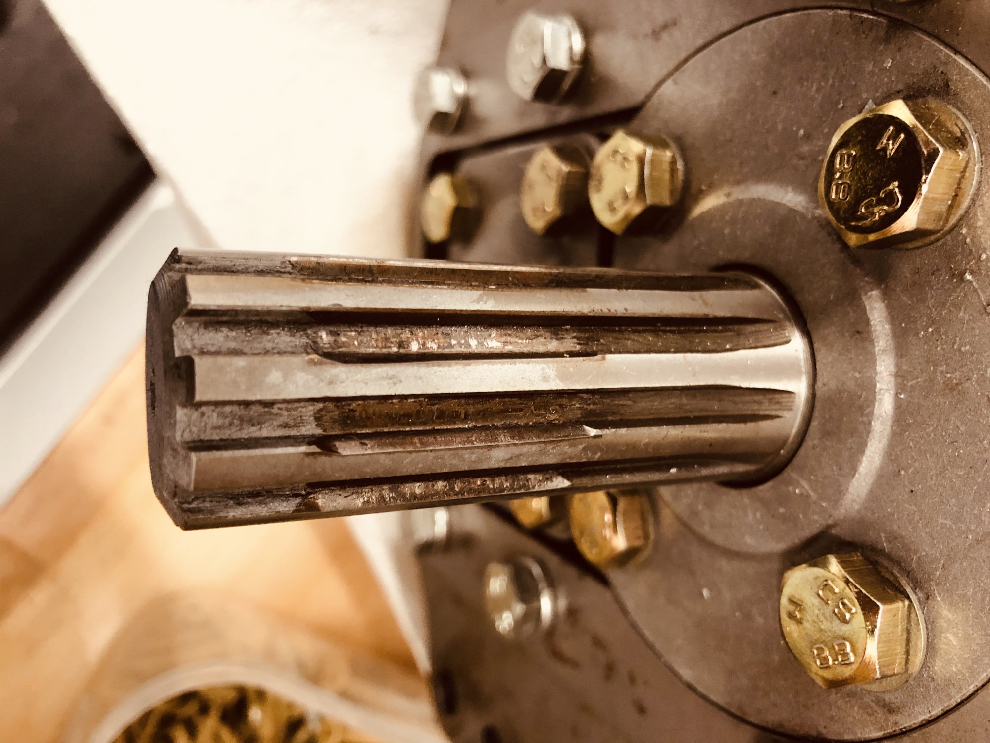

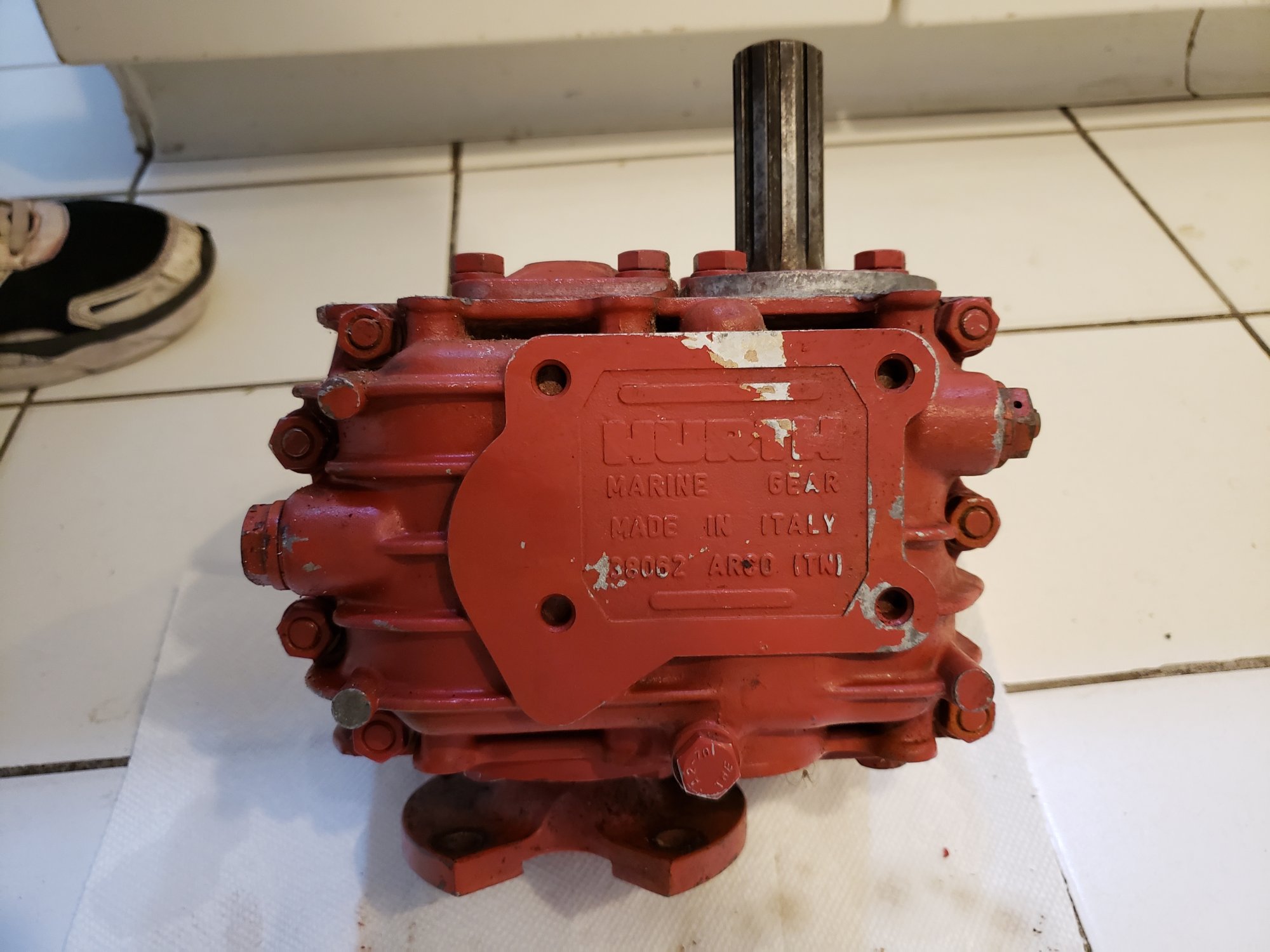

I had to replace the input shaft on the trans.. luckily there was a bloke on the boards here that had a trans that he no longer needed and sold it to me. So the trans got rebuilt with the new input shaft and a box of spare trans parts in the basement now.
Bad shaft
Good shaft

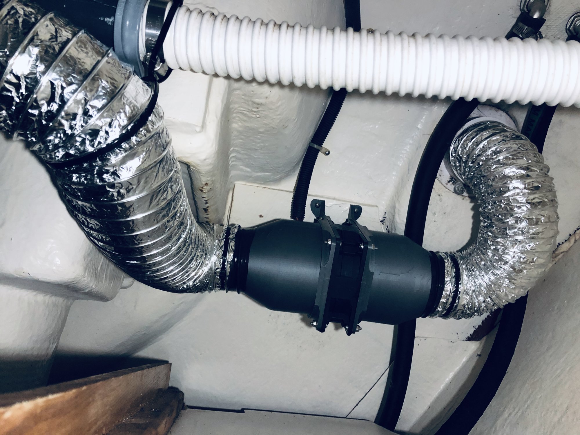

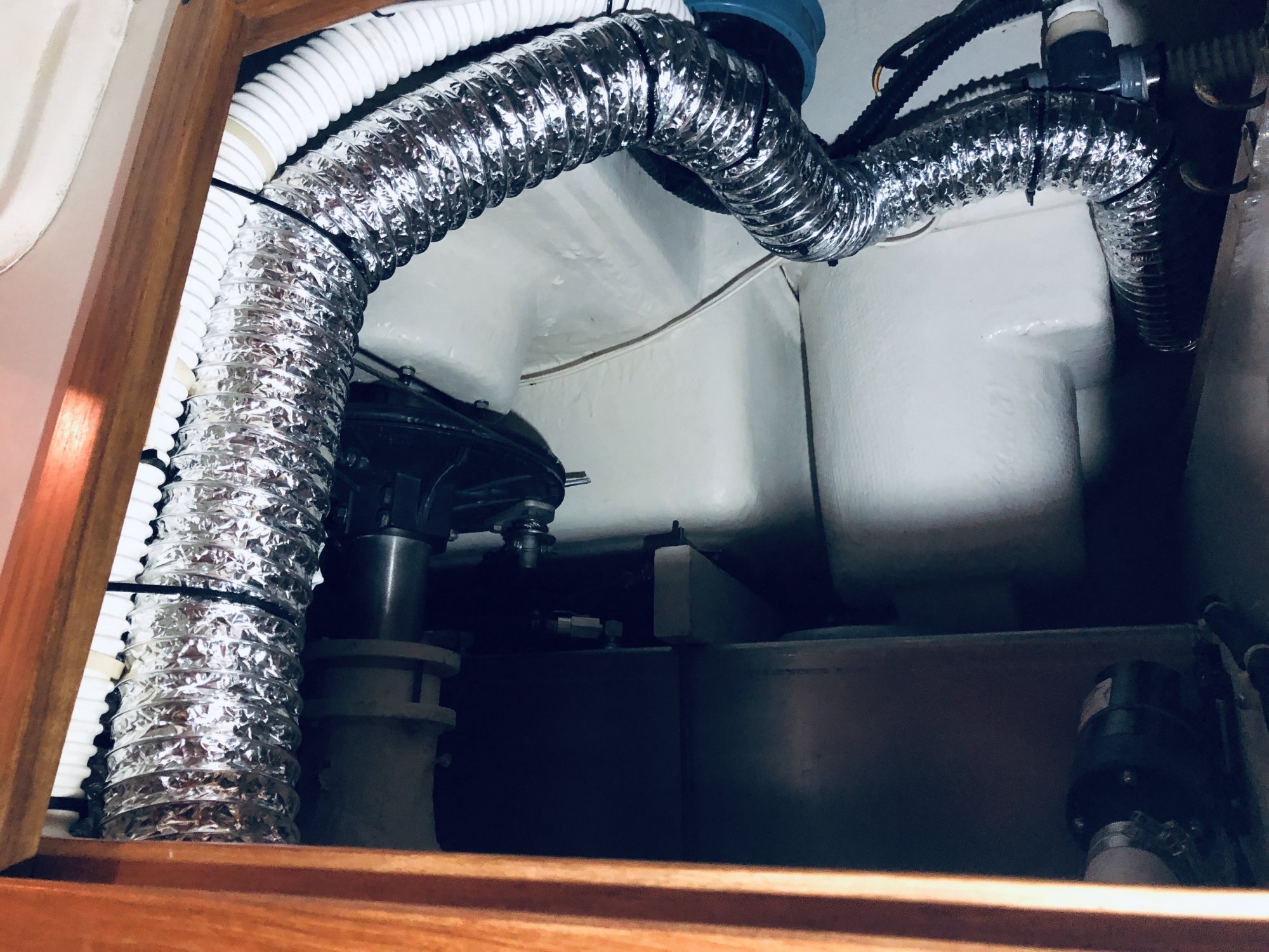

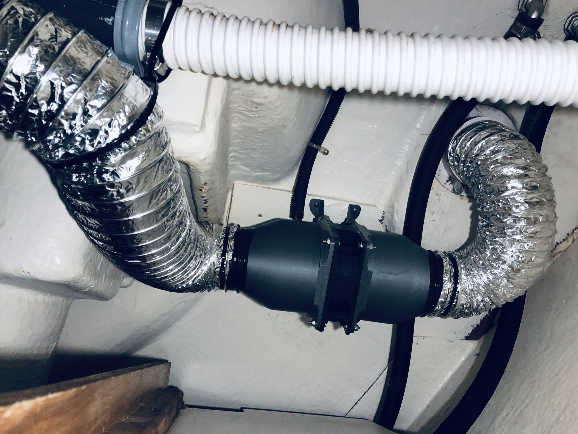

Last night i pulled out the loud and low powered engine blower and installed the new system i designed.. this fan moves 300 CFM. Also installed new vent hoses as well. This blower is essentially silent aside from the sound of the air coming out of the vent.

What a nice install @BillyK I haven't really ever understood the need for the blower, no funky smells and we just day sail for a few hours.
I've never run the blower with the engine running. Turn on the blower for a minute or so before cranking the engine, then shut the blower off. Yes, it's noisy, but it doesn't run very long.
View attachment 179434View attachment 179435
I hope you vented that out the transom. Give yourself a little extra push on calm days. Of course, no race committee would allow its use during a race.
-Will (Dragonfly)

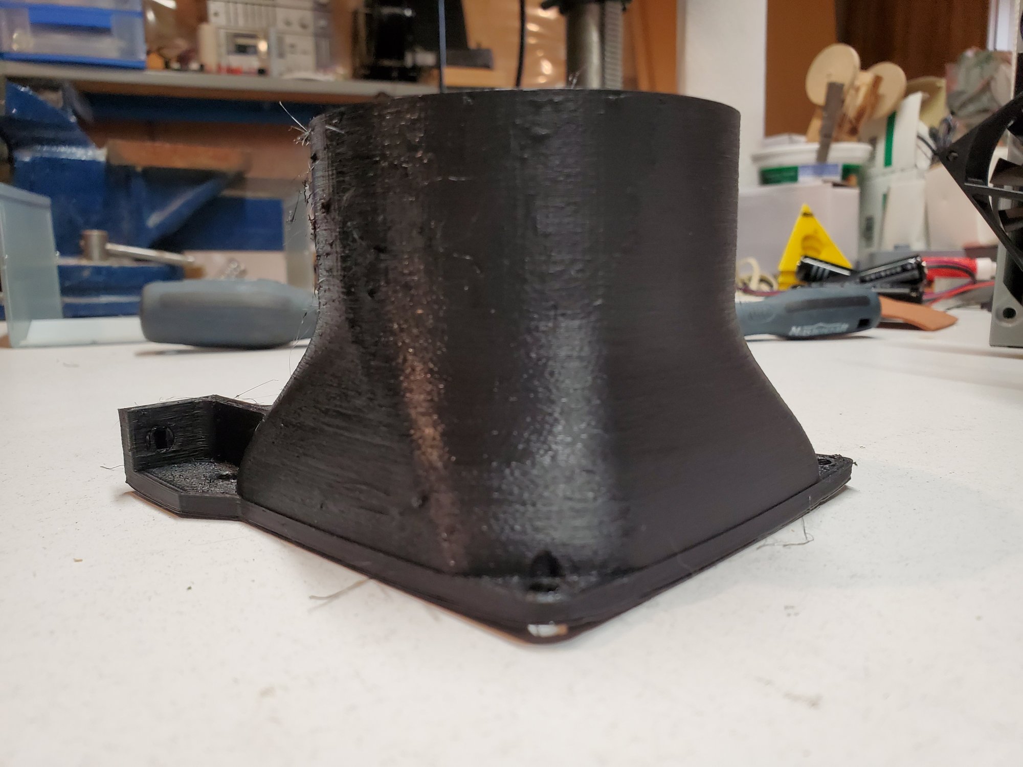

@BillyK what material did you print the fan to hose adapters with?
I bought some PETG for printing boat parts but I'm having some challenges with bed adhesion. I have one fan adapter printing now so we will see how it turns out. I have mostly printed in PLA which is pretty straight forward. I do have some ABS but I haven't put on a glass bed yet so haven't tried it.
i printed these two with PETG and i'm not going to use it again. I just have a few rolls that i want to use up at this point and be done with the stuff. its too hard to keep it from warping if you dont have a heated enclosure for the printer overall. i've had a lot of good luck just using plain ole PLA. Our prior boat had several large parts printed that lived in the bilge for 5-6 years just fine before i sold it. i even had a bracket for the oil drain tube bolted to the block that was printed out of HT PLA that was fine for years also.

I can see what you mean about warping. I'm also having some trouble with stringing.
But it cleaned up ok so I'll try the other side in PETG. I found some tips which might help.
