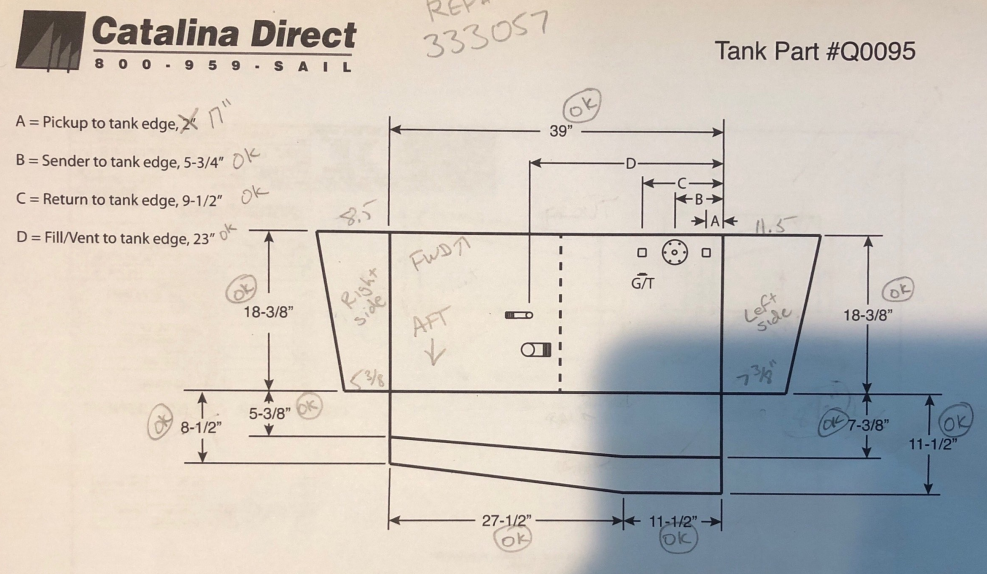

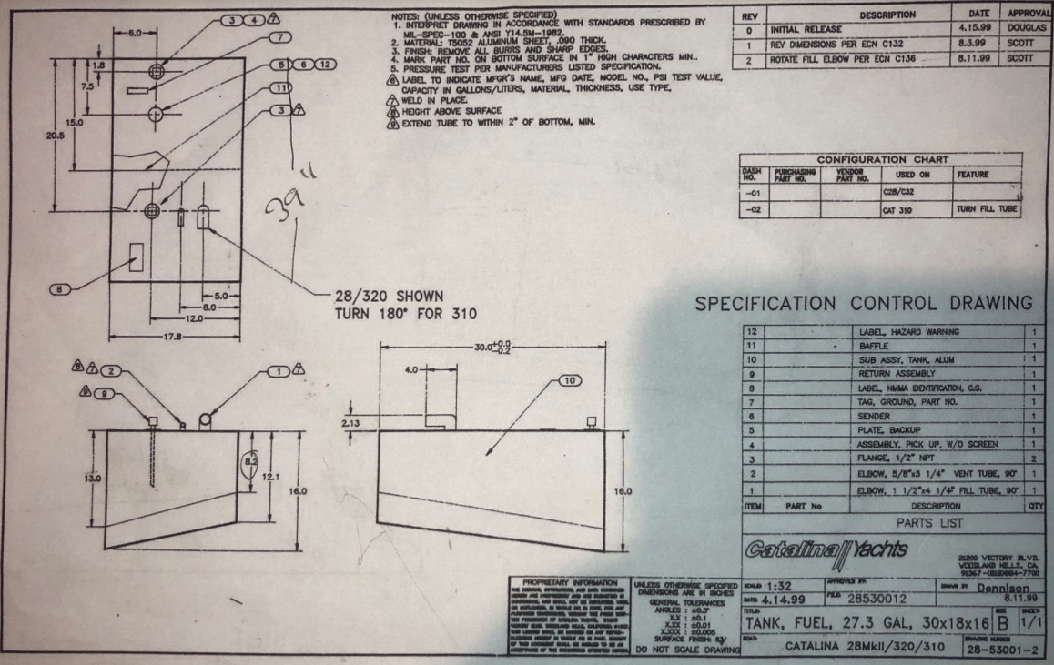

Ordered the tank today. 5 week turnaround.. close to cutting into the season but it is what it is. oddly the schematics that Catalina Yachts sent me were completely different than the tank i have. The schematics on catalina direct's website matched perfectly other than the fuel pickup needing to be moved towards the center of the tank.
Here's the two to compare..
Its odd to me that Catalina Yachts would have the wrong specs for what seems like the correct tank for my boat.

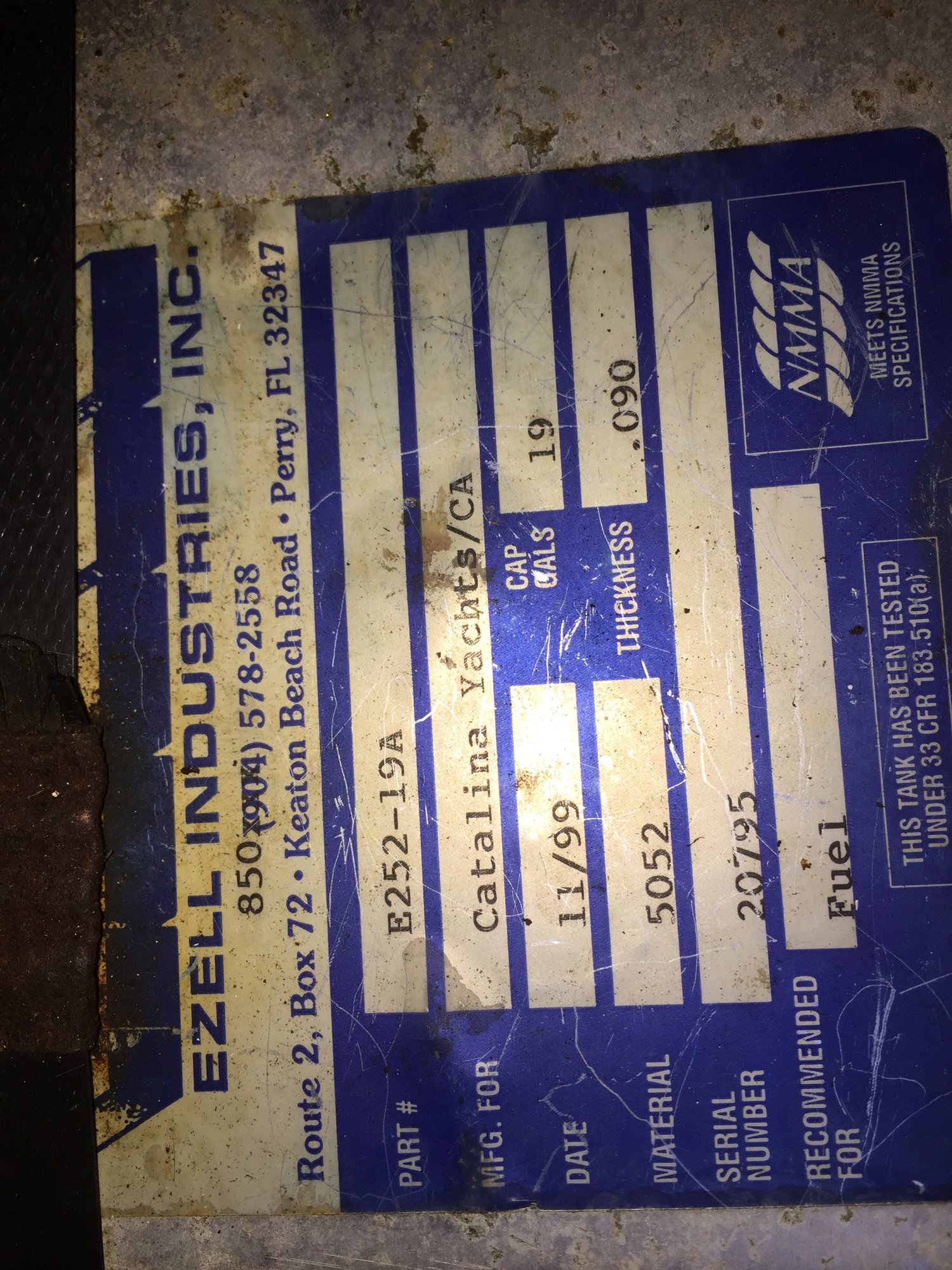

I know Catalina used at least two different tanks, with different fitting locations, for the C310. Here’s a picture of the label on ours, Hull #31.
I like that your fuel pickup will be near the center of the tank. Mine is way over to starboard, a real pain when motorsailing on starboard tack.
Hull #65 has the top tank pictured. Make sure you add inspection ports on both sides of the baffle or one over the baffle so both sides can be accessed for cleaning. When I eventually get a tank made I also plan to have a second set of pickup and return installed for a polisher.
