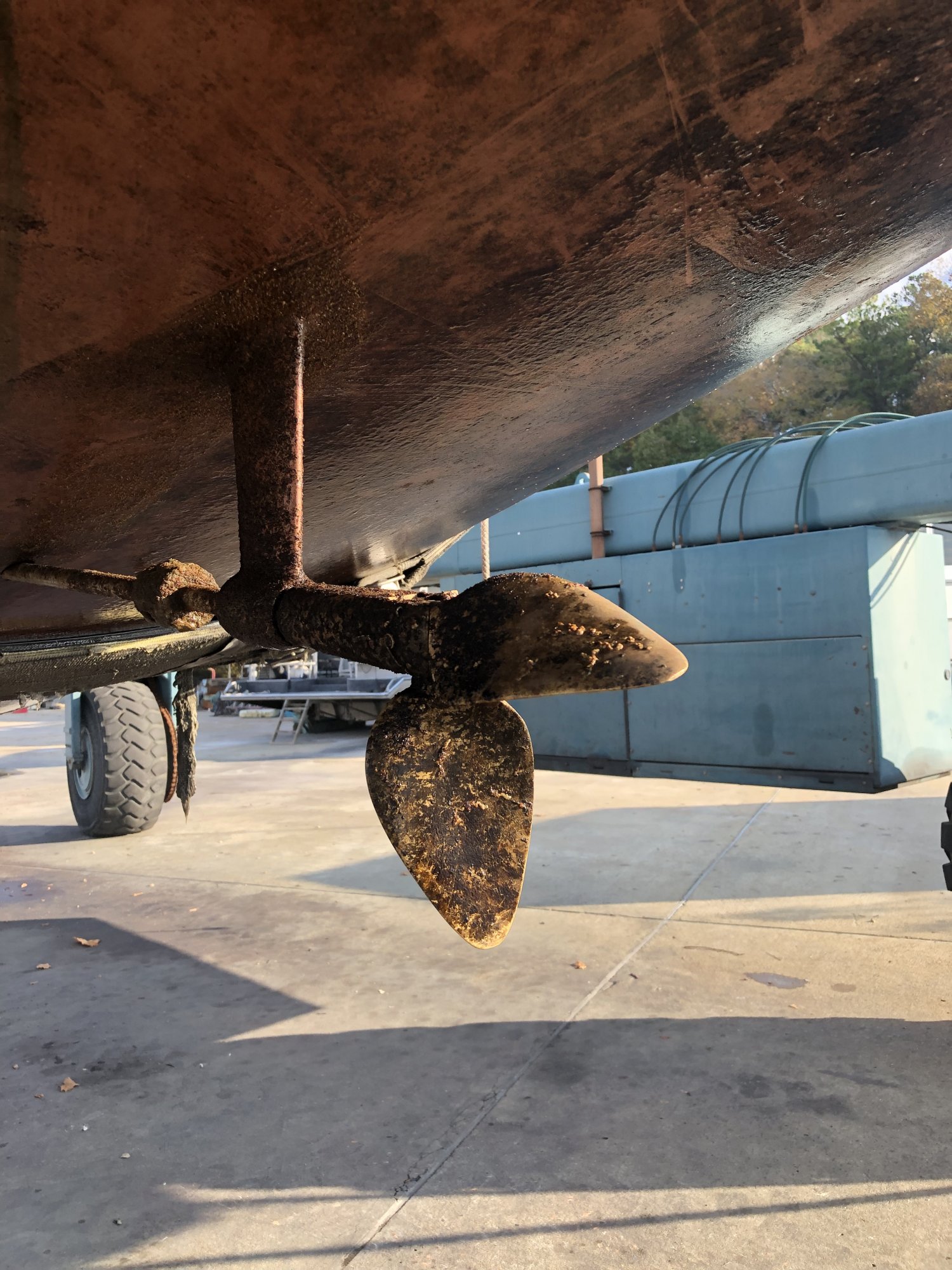

hat's your point?
We were talking about how herbicides are removed from paint because of its affect on the environment. But copper is still the main ingredient. And it certainly doesn’t work where I sail.
