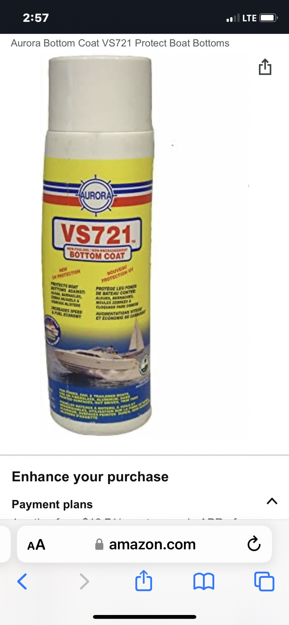

Anyone ever heard of using VS721 instead of bottom paint? Its supposed to prevent marine growth from sticking to the bottom.
I have heard of this product, I have not heard of anyone using it.
Reading the Amazon reviews, the gist seems to be it makes it easier to clean the bottom as the algae doesn't stick to the hull. The reviews all seemed to be from powerboats.
It is usually helpful to look at the SDS, it can be found here:
Note there are no hazardous materials listed on the SDS, this is in contrast to SDSs for antifouling paints which always list the pesticides and herbicides in the paint and warn of dangers associated with them.
My guess, this is just a wax of some kind that sort of works on powerboats because water pressure from going fast washes the growth off the bottom.
  • Helpful
Likes: rgranger
13,011
They also claim it will get "impossible" stains out of gel coat. This has the same active ingredient hypexine (BTW: not a real chemical name)
Some of the vendor's I've seen call it a bottom wax ... so I think @dlochner nailed it.
