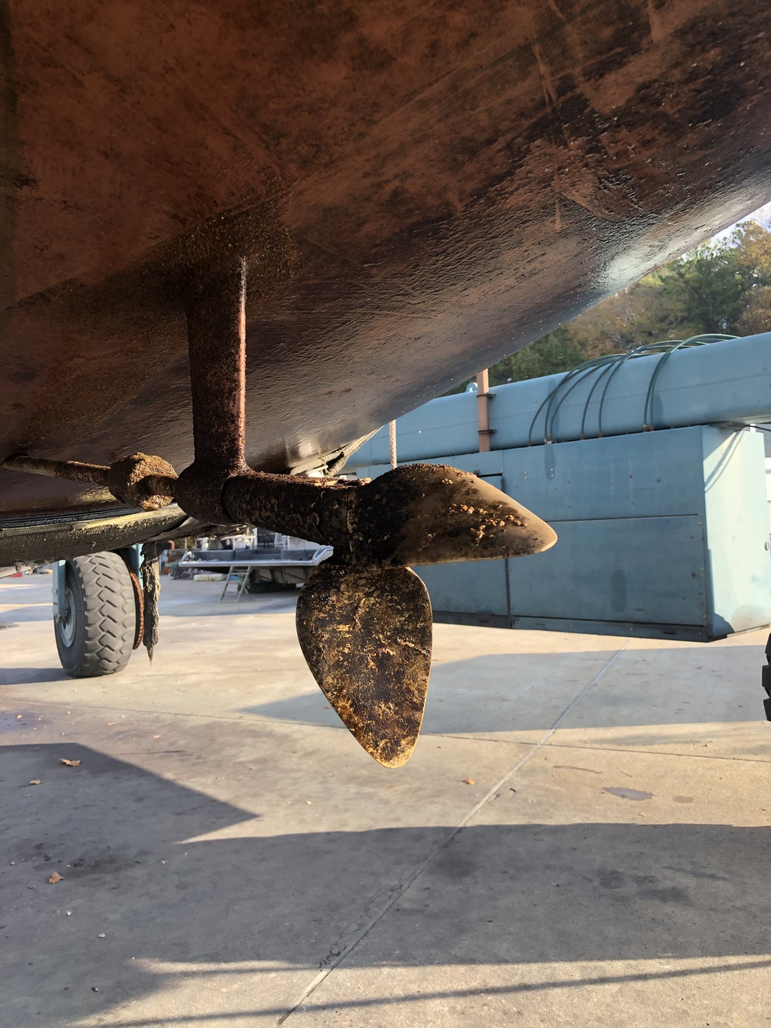

Yeah, pretty much. The hull didn’t have the hard wormy things tho. The prop did. Otherwise it was the same.

So in other words, the cuprous oxide in your anti fouling paint completely retarded the shelled animal growth while the bronze prop (actually naval brass) did not. Does that answer your question?

Didn’t protect against slime, but protected against shells? The hull was brushed from the dock every 2 weeks. Tuff to brush the prop. So, inconclusive.

Not inconclusive at all. Copper is excellent at retarding higher forms like shelled animals and plants. The slime is algae and copper is less effective against that. Which is why paint manufacturers use secondary ingredients that interrupt the algae life cycle and disrupt photosynthesis. Naval brass is less effective than copper as far as anti fouling goes and of course, does not leach its constituent ingredients like copper or zinc-based anti fouling paints do. Therefore your prop had tube worm and barnacle fouling while your hull did not.
13,427
So, my bronze prop was heavily fouled. Does that prove copper don’t work? So why is it so popular in bottom paint?
The slime on your bronze prop is not what I would be concerned with. The "wormy things" on the prop are a concern and I don't think they are biological. A better photo would help and a good photos of the through hulls and the sacrificial anode would be helpful would also be helpful.
What kind of anode do you have on the shaft, zinc, aluminum or magnesium? What do the other bronze below the waterline fittings look like?
Given what I can see in the photo the "wormy things" are the result of galvanic corrosion in which the zinc in the prop is leaching out of the prop. This can be caused by a several issues, including poor wiring on the boat and poor wiring in the marina. The consequences of not dealing with this can result in very expensive damage, i.e, replacing the prop, replacing the strut, and replacing the thru-hulls. If you are uncertain about how to remediate this issue, I suggest you find a ABYC certified marine electrician or corrosion specialist to properly advise you.

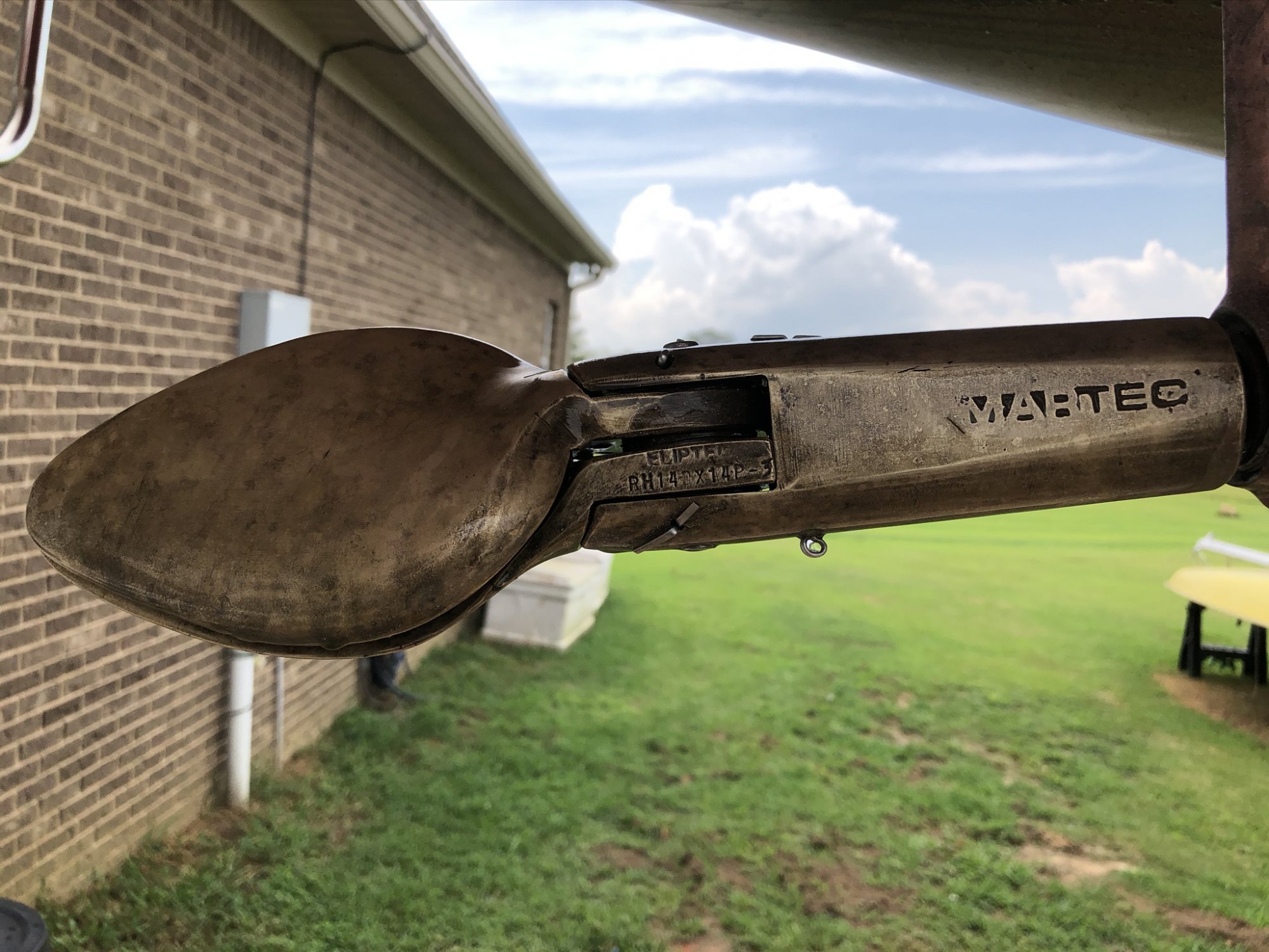

You can zoom in to the photo of the prop to see the Anode. Not sure what it had, but replaced it with magnesium. It the boat still has factory wiring. Its in pretty good shape. There is definitely current in the marina water. Not allowed to swim. The thru hulls are faired into the hull, so all you can see is a hole. Those wormy things were material additions. After I sanded those off, the prop looked really good. No pits. Same with the shaft. The after photo is closest one I have to the prop.
Look for reddish pink areas on the prop, they are a sign of the zinc being leached out.
