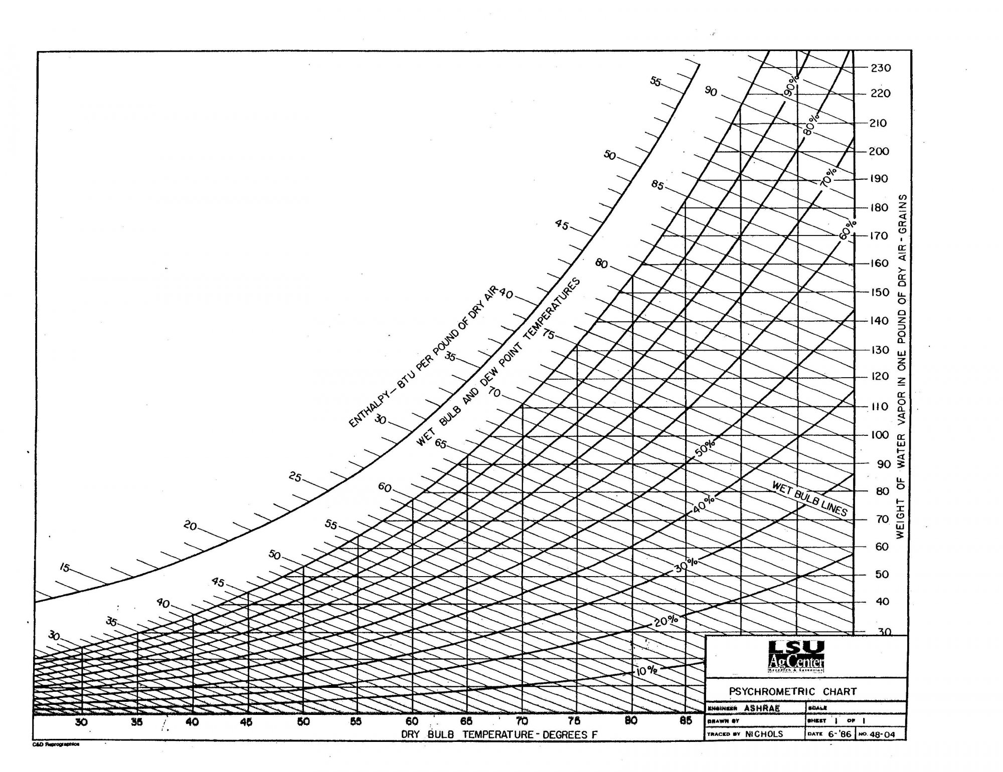

The absorbed heat would go towards increasing the temperature of the liquid, which would in turn increase the vapour pressure of the liquid. This would increase the overall pressure in the cylinder. However, there would be no cooling of the liquid as the boiling could only occur at an increased temperature due to the higher pressure.
Something like this:

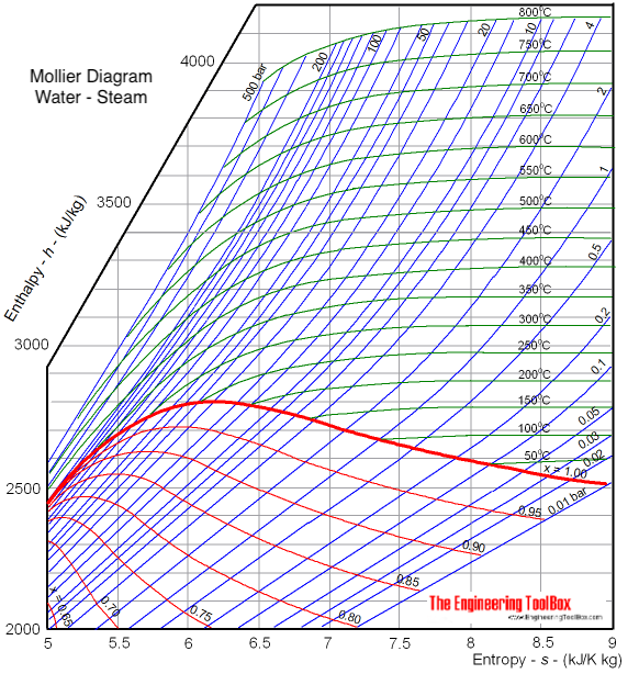

In my equation, instead of "thermal conductivity" I should have said "heat transfer coefficient most closely associated with the thermal conductivity of the metal of the tank
As would a Nuclear Engineer from the USNA top award winner.
But remember the Steam side too.;)
Jim
