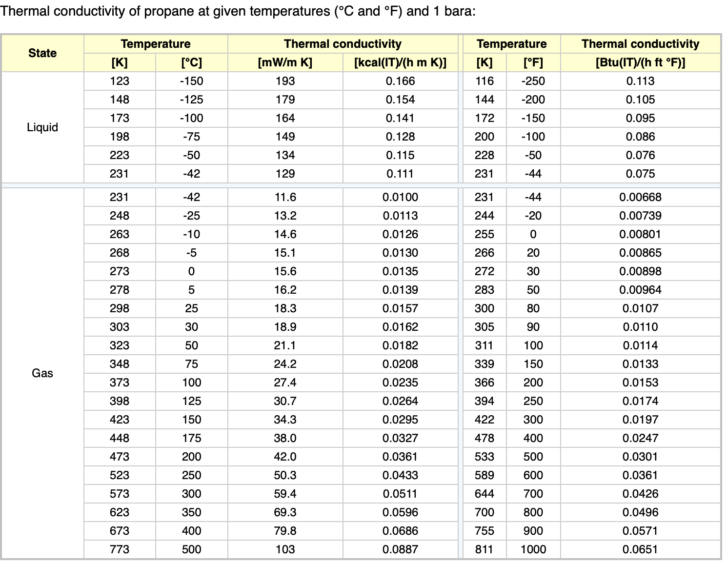

I may be totally wrong, but as I recall, the "amount of liquid propane" can be deduced from observing the "temperature" at the tank surface. At the point of liquid level the temperature of the tank surface will be slightly below the temperature of the tank surface where the gas exists. (conductivity of the liquid is more than the gas) An old tank I used to have for my home grill had a strip of temperature sensitive material on the outside of the metal tank. At the level of the liquid propane the strip changed color if you doused it with a little water. Could you not use a non-contact temperature gun to see where the temperature changes on the surface of the tank. Just asking?
Correct but only while the gas is being used.

The "hot water trick" on the outside of the tank will work too. It is taking advantage of the roughly 5 to 10 times greater "thermal conductivity" (depends on pressure in the tank compressing the gas, not so much the liquid) of the liquid propane in the bottom of the tank compared to conductivity of the gas in the top of the tank so the tanks surface cools faster where there is liquid. Of course a completely full tank or a completely empty tank might be hard to tell, but then weight should be a dead giveaway.
The stickers I have seen are not sensitive enough to show the contrast in temps between the liquid and vapor space of a static tank when not flowing but if dumping hot water in it gets it to work then fine. Burning some gas off to get there seems pretty easy…….
