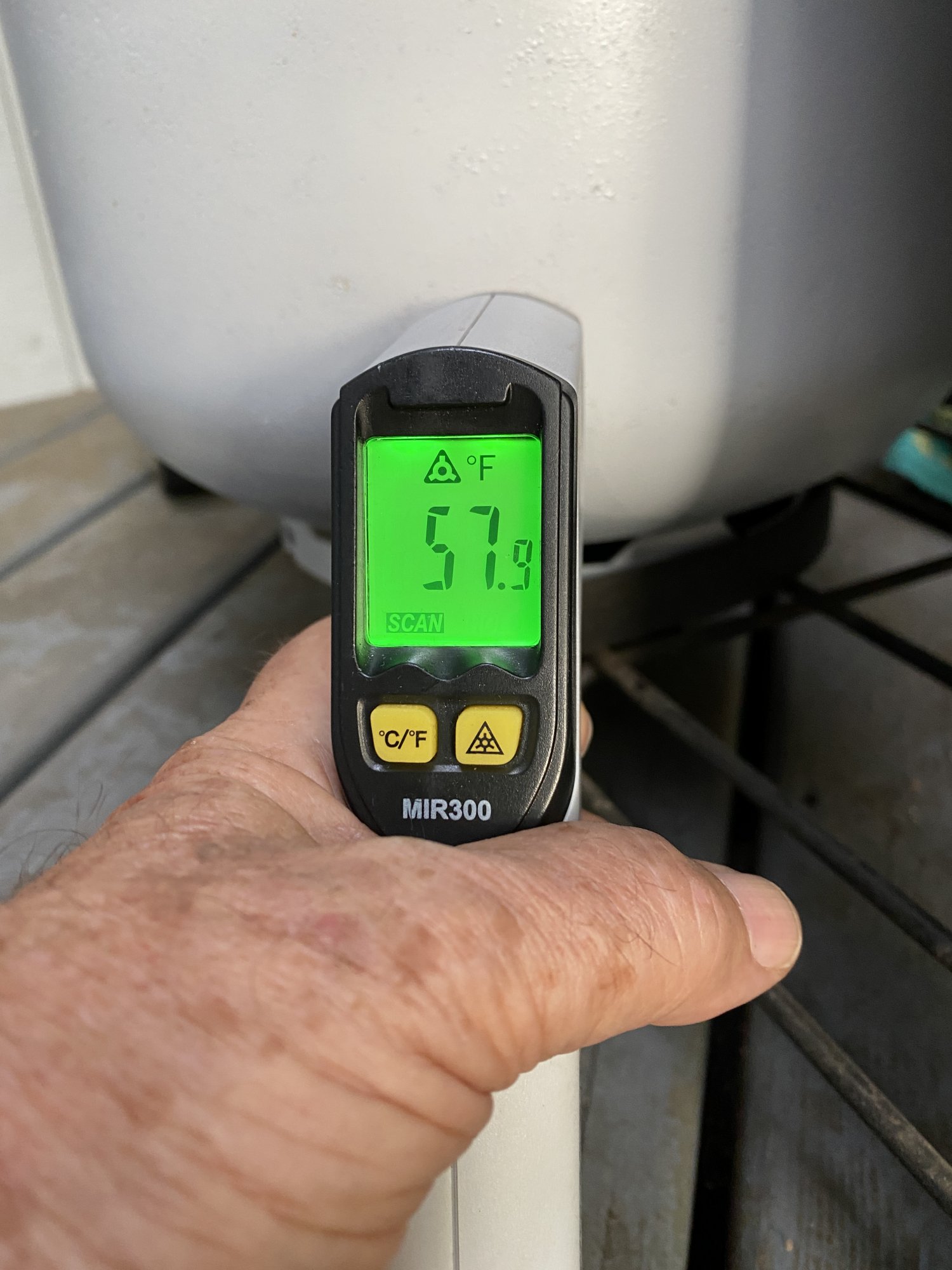

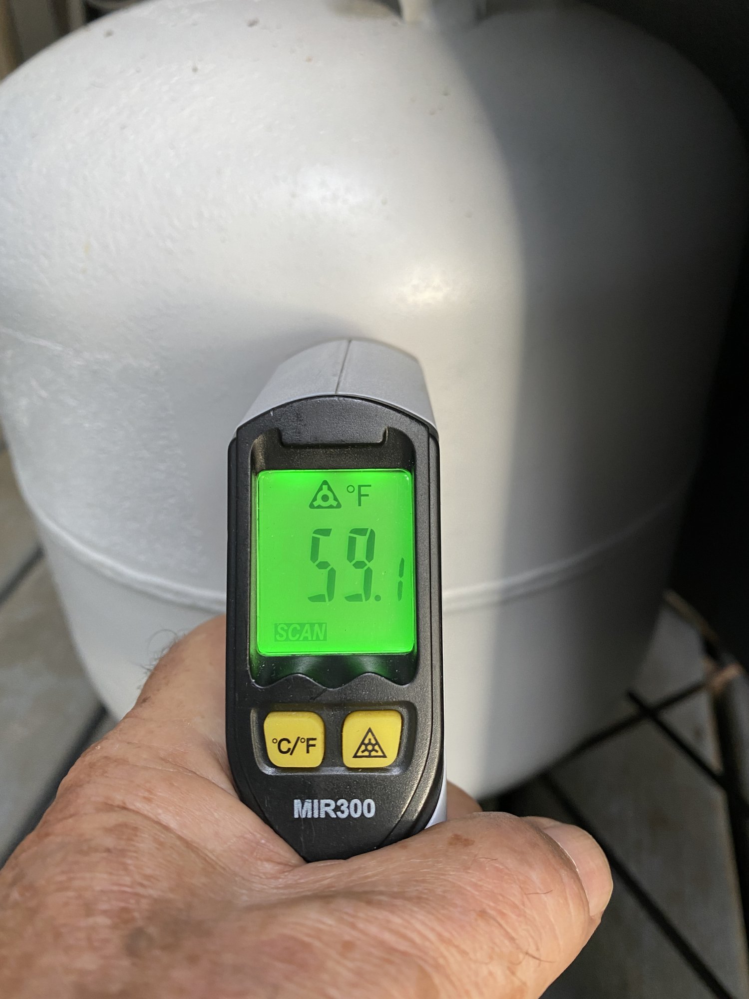

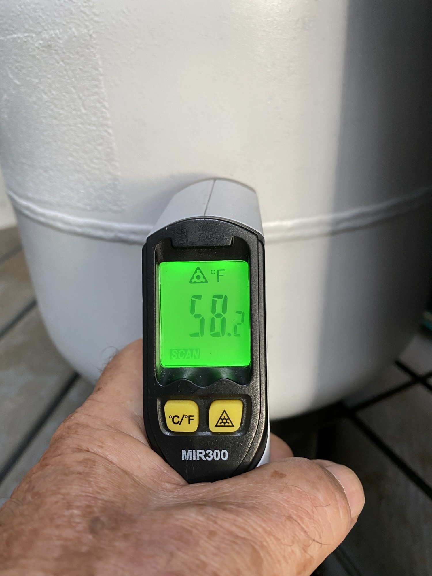

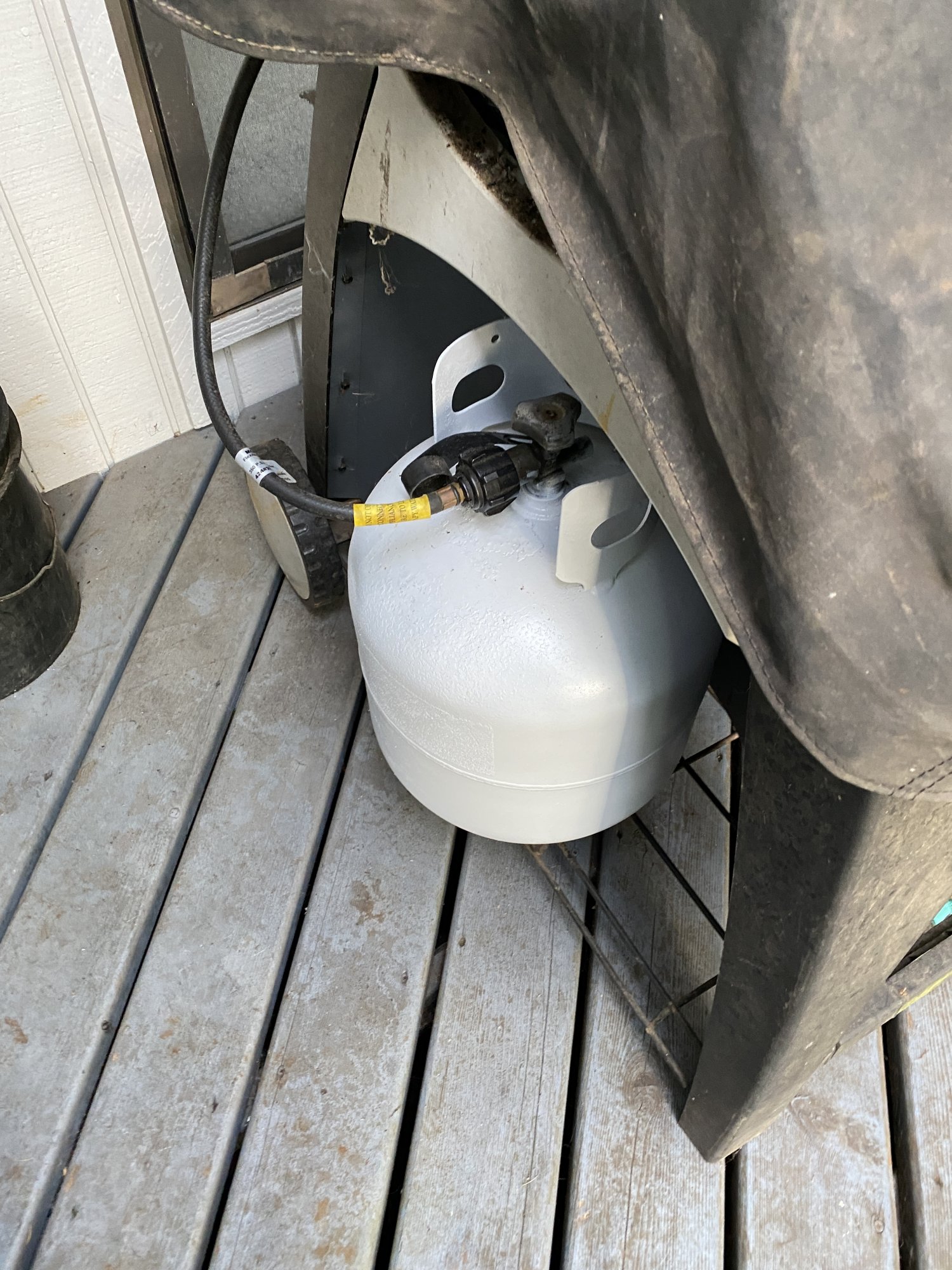

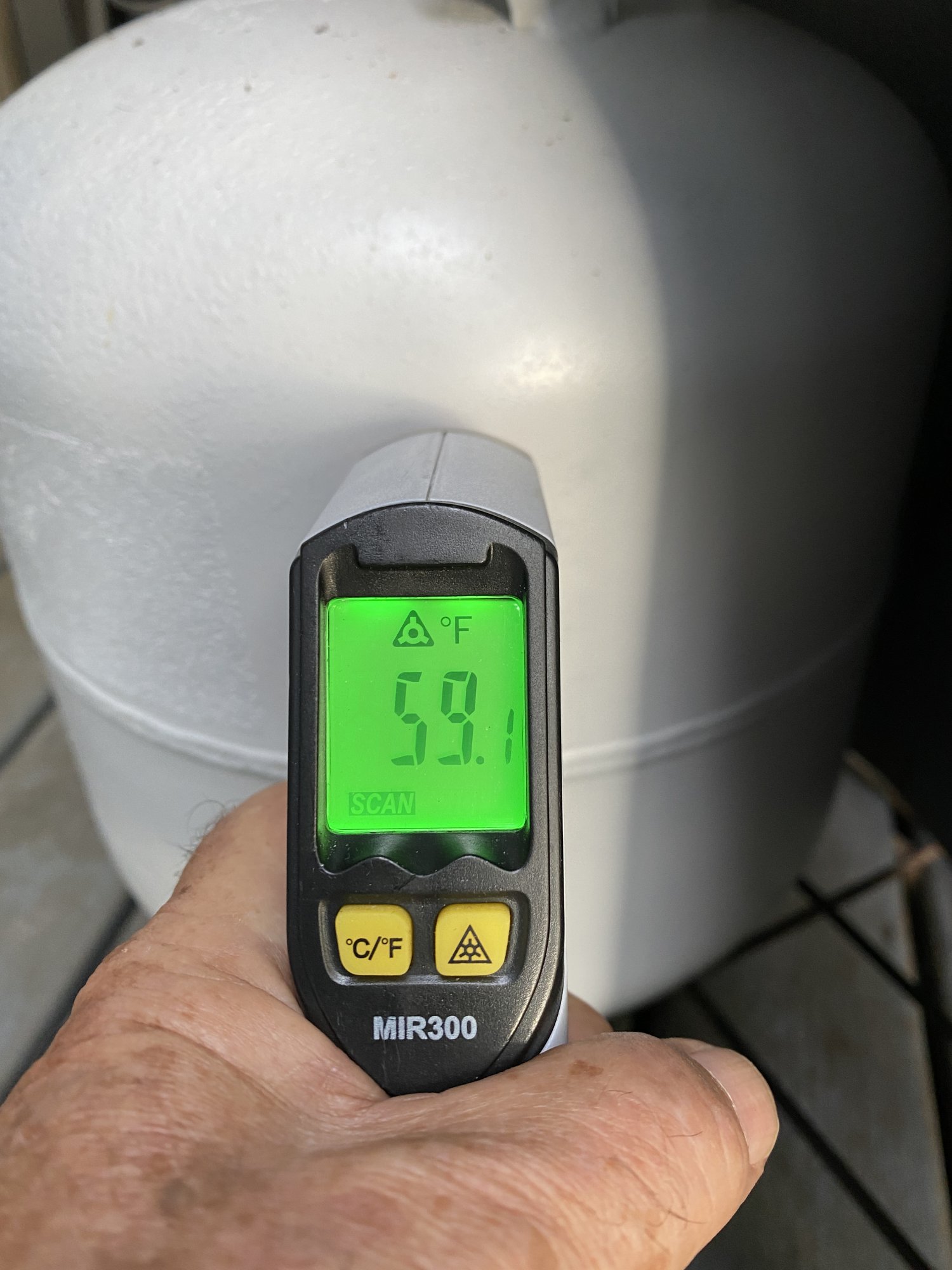

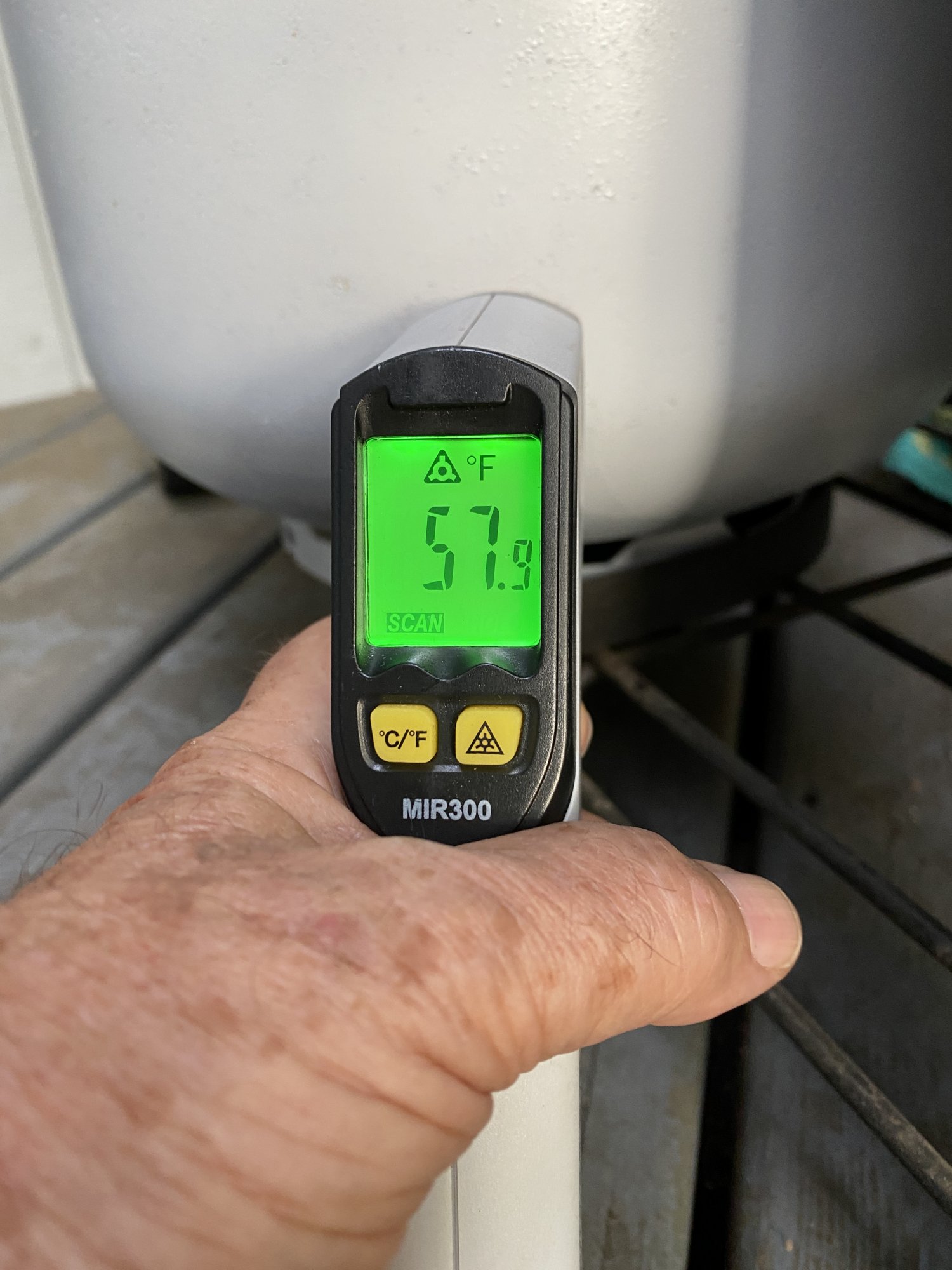

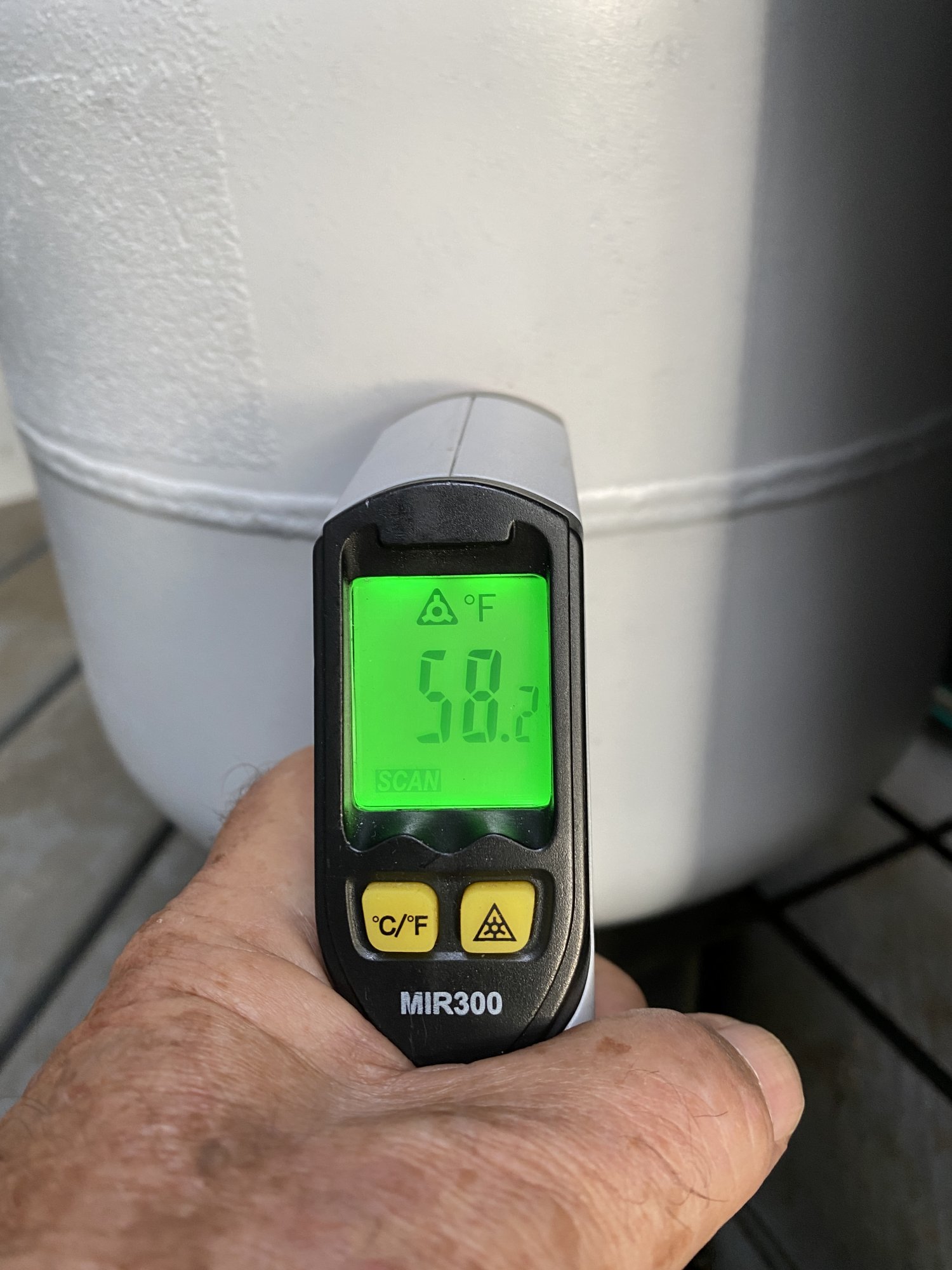

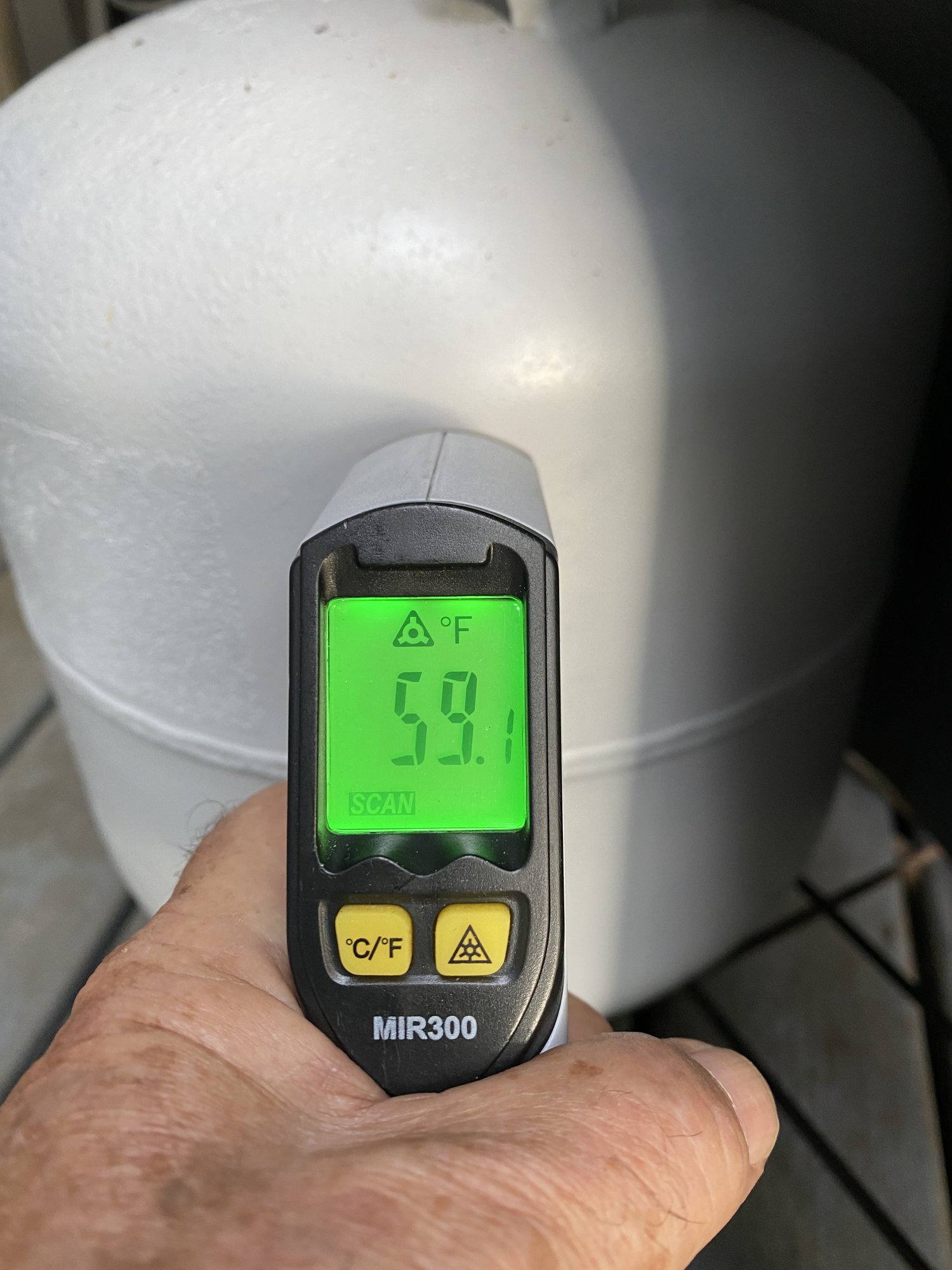

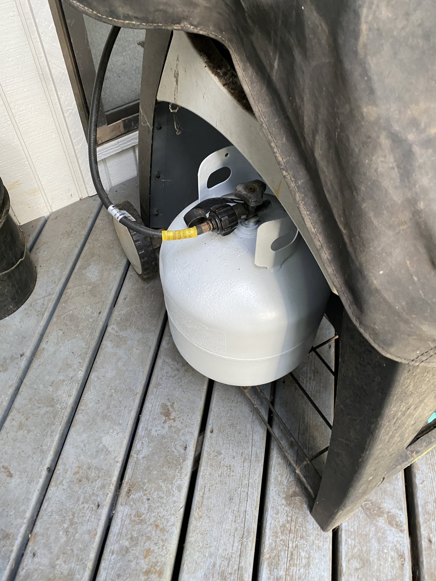

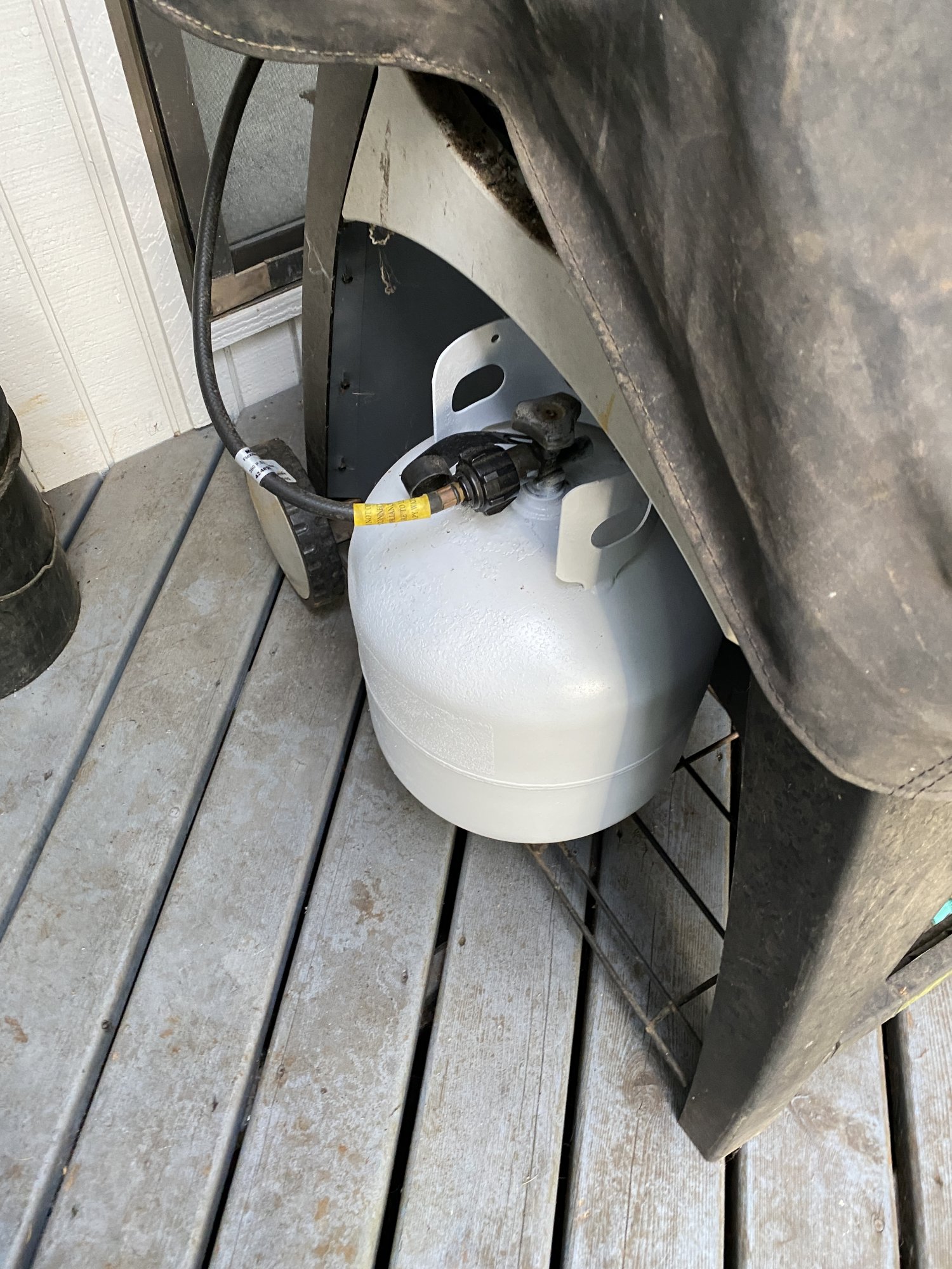

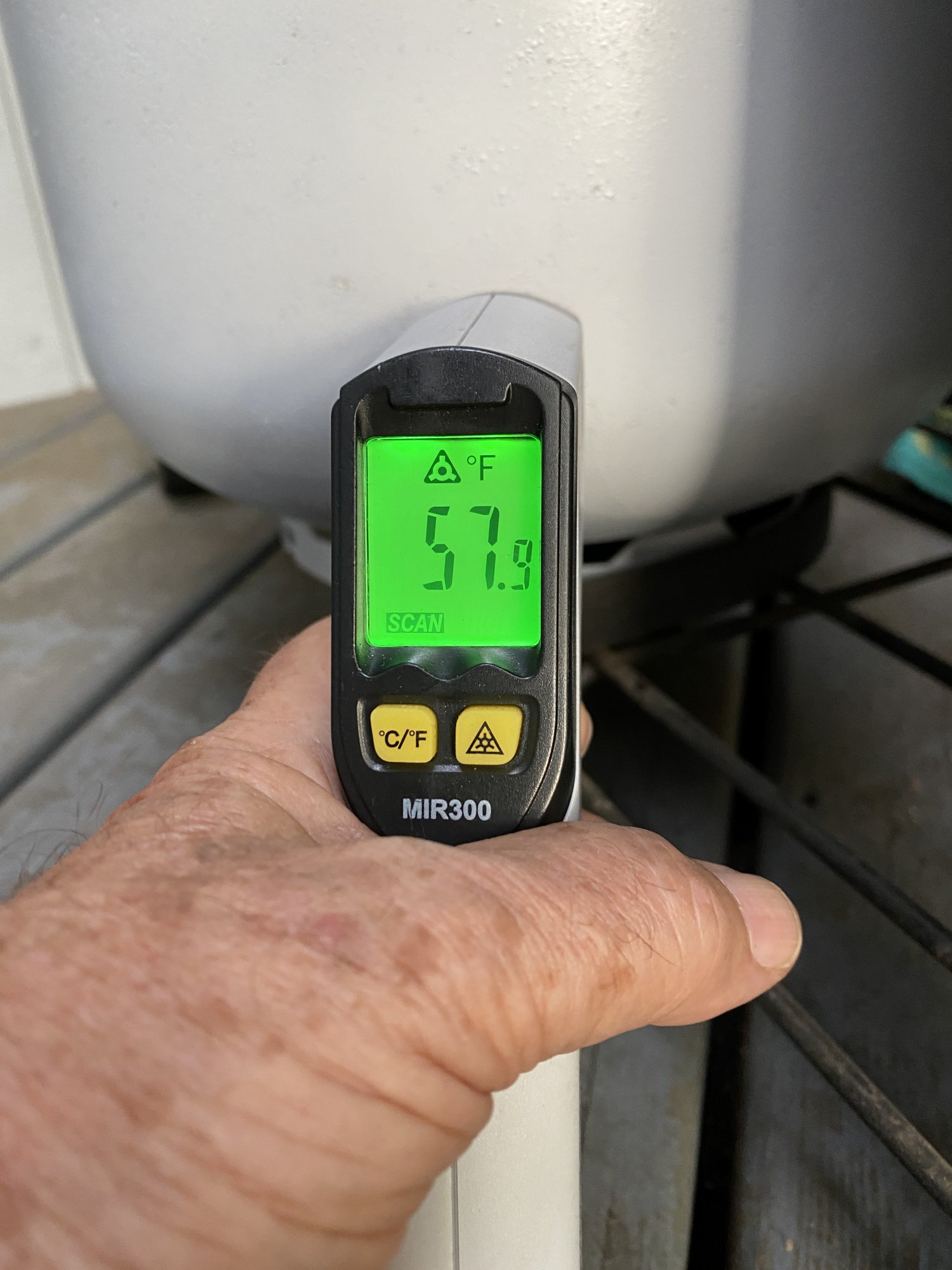

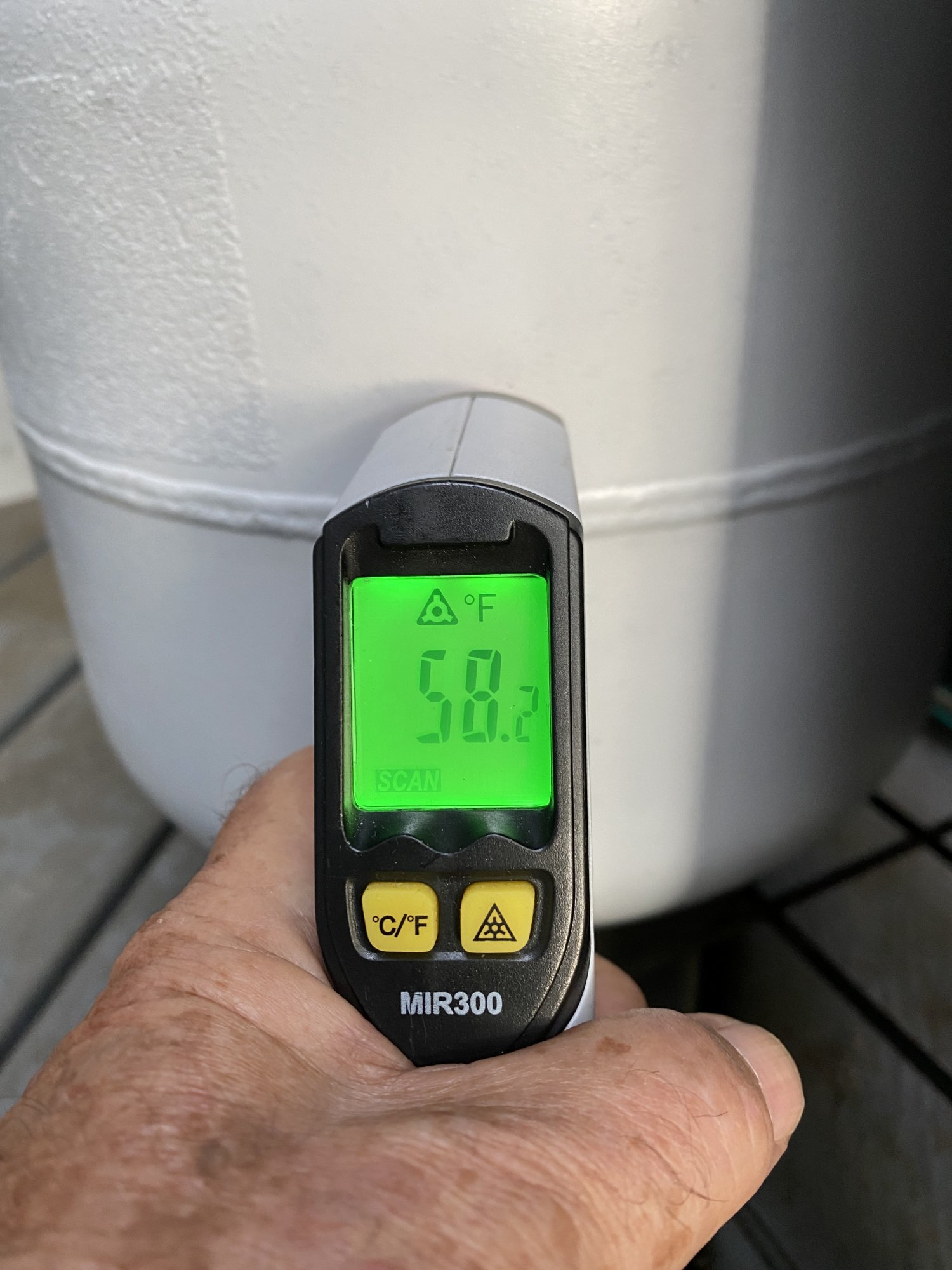

Ok... You picked my interest.
Grill Propane tank. Stored outside over night. Has not been used in several days. Tank has been closed so should be stable. Ambient air temp 54.
Not sure what this demonstrates. I believe the tank is about 50% full.
23,840
NO. All was stable in an resting condition for at least 3 days.
May 17, 2004
5,911
Gas needs to be flowing to show the temperature difference. The slight differences you saw are probably just from the ambient air and suns heating the tank unevenly.
23,840
No sun David. The tank had been covered all night and the sunrise 06:37. Sun still below the level of the treees and hidden behind the corner of the house so not a factor at 07:49 when I took the images
@JamesG161 , rise and shine. Time to resume the fray :poke:.
I say the small temperature rise from the bottom to the top of the tank was due to the rise in ambient air temperature from the night time low. The liquid propane has more thermal conductivity plus greater specific heat than the gas propane so will hold its lower temperature longer. The upper section of the tank which only contacts the gaseous propane warms more quickly due to the opposite thermal conditions.
View attachment 208932 View attachment 208931 View attachment 208929 View attachment 208930
When things are stable as in no gas being demanded by a load, there is little driver for the heat transfer thus little measurable cooling effect. Realistically, without any latent heat transfer (boiling of the liquid into gas) you won't see much temperature difference. You need to apply something to cause the "heat to flow"
Try the temperature guage once you have run some hot water along the side of the tank. Where there is liquid the temperature should lower more quickly than where there is gas since the thermal conductivity of the liquid is higher than that of the gas
Heat Transfer Equation: Q=UA delta T Where Q is the transfer of energy (in the form of heat transfer), U is the thermal conductivity, A is the surface area, and delta T is the temperature difference.
Simplified theory - When you pour the hot water on the tank you set the Delta T (in the short term). The A is about the same, so the only difference is the thermal conductivity (U) of the gas and the liquid. Therefore, more heat will be transferred from the warm tank surface to the liquid than the warm tank surface to the gas and the area exposed to the liquid will cool down more quickly. Ain't it wonderful how Thermodynamics works and you thought you'd never use that equation again.
