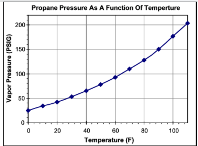

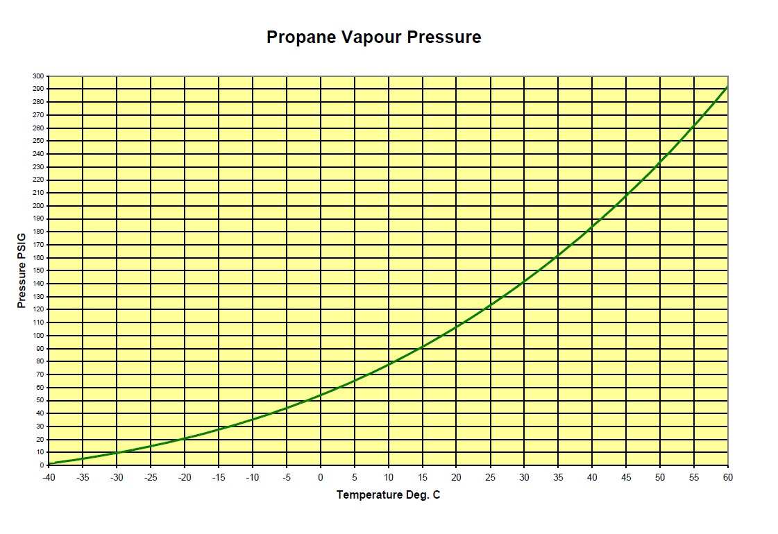

It is also interesting to watch the pressure as it changes with ambient temperature. On really cold days the gauge would read much lower than the next really hot days.
I guess this post will tell most info on Propane.:pimp:
Next I could post the Latent Heat of Vaporization so you can see if there is enough Ambient heat to cook too.:facepalm:
Jim... aka Chemical Engineer
14,149
That graph pretty much reflects my real world observations. Around 100 PSI cooler days and around 150 psi on hot days.

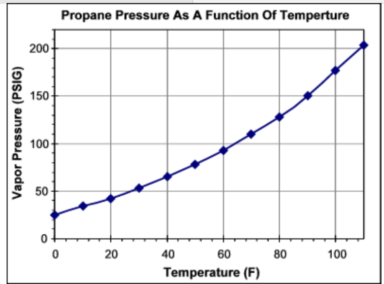

Have fun cooking..
Jim...

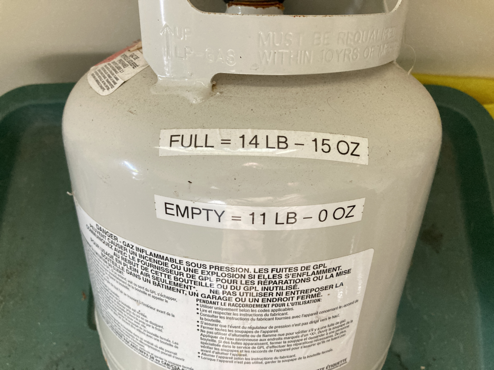

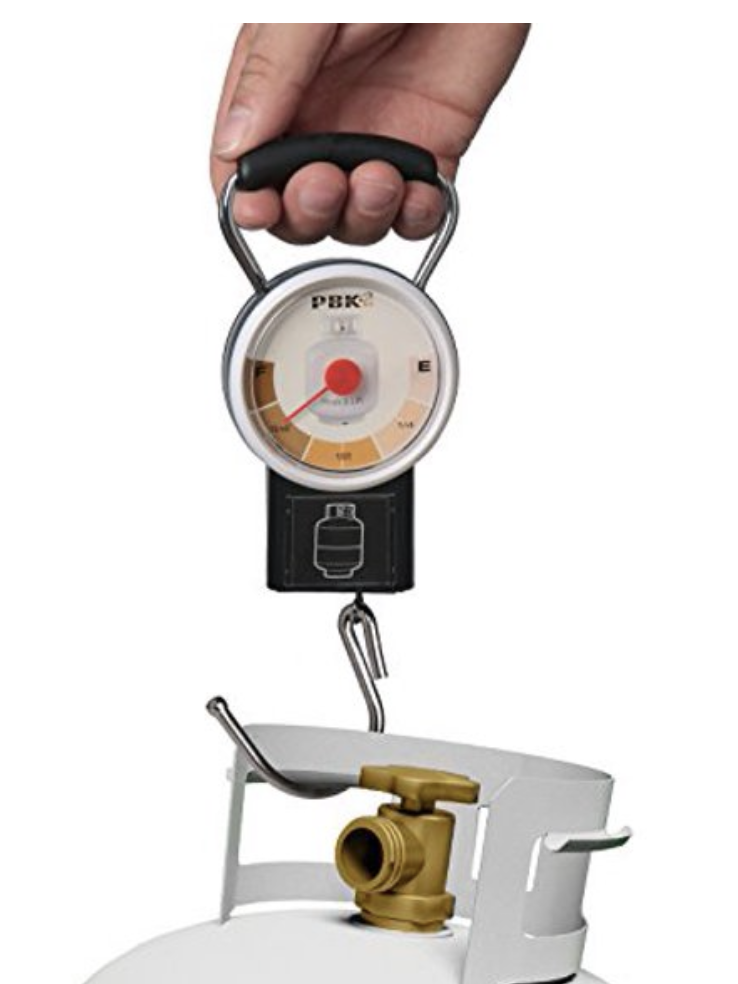

All tanks are labelled with their MT and full weights. The odd units are the result of my using an old electronic fish scale when I check my tanks. I grab the handle of the tank using the old fish scale hook and just lift.
If the weight is now eg. 14 lb - 0 oz, I know I have three (3) pounds of propane (liquid and gas) remaining in the tank. I don't care how much liquid, I don't care how much gas, all I want to know is the total mass of propane. Any time I want to know what's in the tank, I can. Quick as that. Slam the propane locker lid and it's done. What are those two tanks laying over there ? A quick lift tells me either MT or full.
Both Stable Temperatures must be about the same or you have to use a correction calculation.
I don't care what the temperature of the tanks and their contents are, hot, cold, freezing, middling, the total mass never changes. Mass is neither added or subtracted by heating or cooling. Energy content does not change the mass.
And for the endless question, "what the #%$^%&* difference does it make if the tank is in use or not ? " Whether the tank is hot from the ambient or cold from a heavy load, my only quest in life is the weight of the propane mass (liquid and gas) at that precise moment in time.
