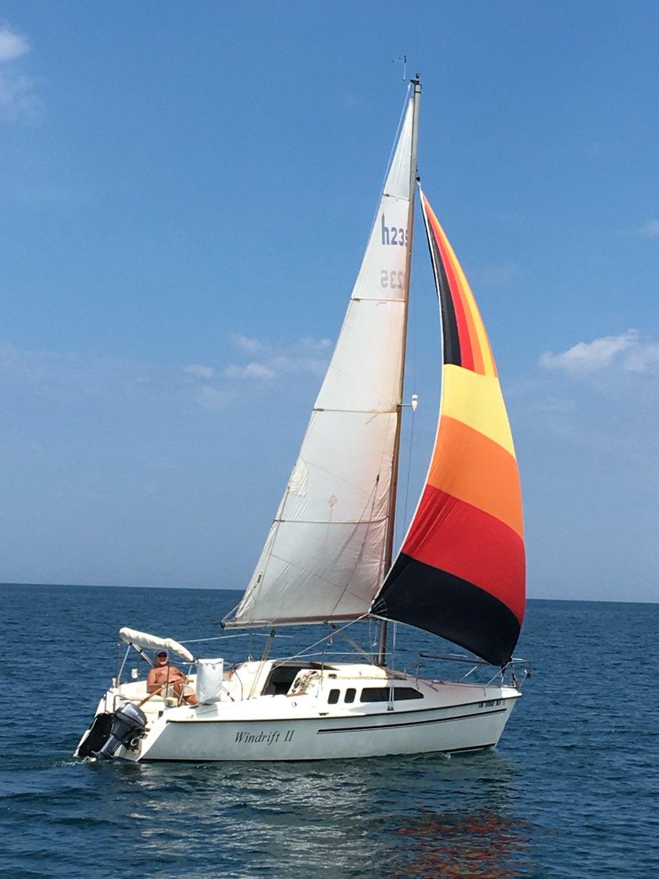

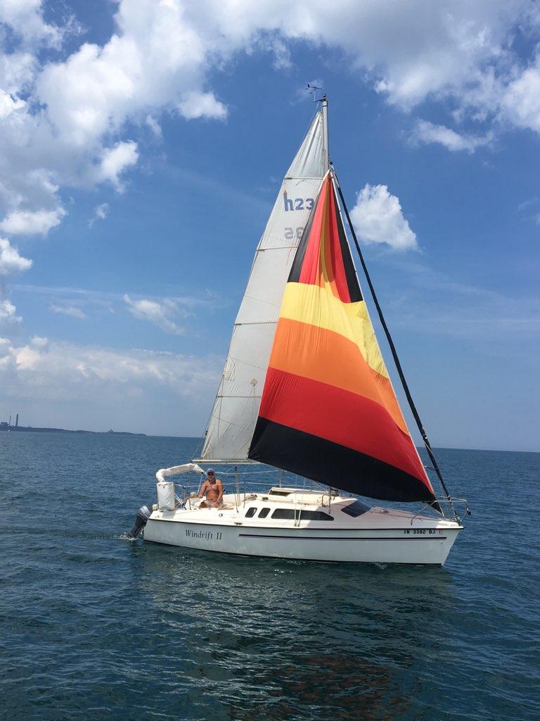

Been flying a drifter on my 23.5 for years.Was hanked on sail,removed hangs added grommets ran 3/16 cable t at head and foot works great.Tack run as any headsail
