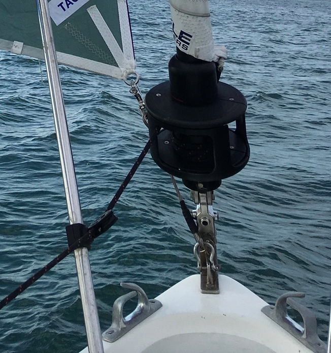

I too am on the fence. My concern is more about the tack attach point. I too have a furler that attaches to the eye for the forestay. We have a unused eye further forward that we can attach the tack to but I can see it being a crowded mess attaching to that point. I can't attach the tack to that point outside of the bow pulpit because it prevents the luff from being a straight line. This brings us to some sort of sprit. That obviously would be ideal but that's opens up another can of worms.

I lifted this pic from the Peaksails website. It shows the tack attached to the same point as the forestay, it looks like. That is the same type of setup I have. Although in the full size view of this pic I dont see how one would change tack (tac?) with the tack attached through the life lines. Maybe they dont plan on doing that. And, I probably dont know what Im talking about.

I saw that pic to Granger. I am thinking that tacking this sail is not a planned on operation. I can just see the tangled up mess that we, me, would be dealing with on the bow.
Not sure this will work for us as our runs tend to be fairly short due to the layout of the lake and prevailing wind direction. If we can't tack it easily there is no point in spending the money.

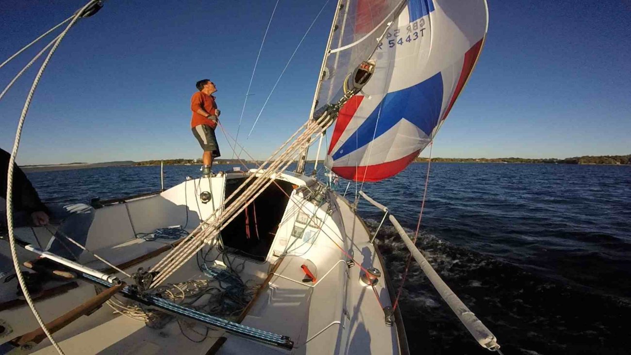

We have a reaching sail (kinda a Code 0.5) that we tack on short strop of dyneema to a hard point just ahead of our furler. The strop holds the tack at about lifeline level (20 inches), and it runs UNDER and out of the pulpit. The luff is never ever pulled wire tight, and you never really have to jibe or tack these things. So it works fine.
Here is @cb32863 and I out for a beer run. Six knots in six knots true wind. It looks and feels like you're going upwind, but the True Wind is on the beam.
The obvious perfect solution is a small fixed prod. I have the design for one done, just have not pulled the trigger on it!
