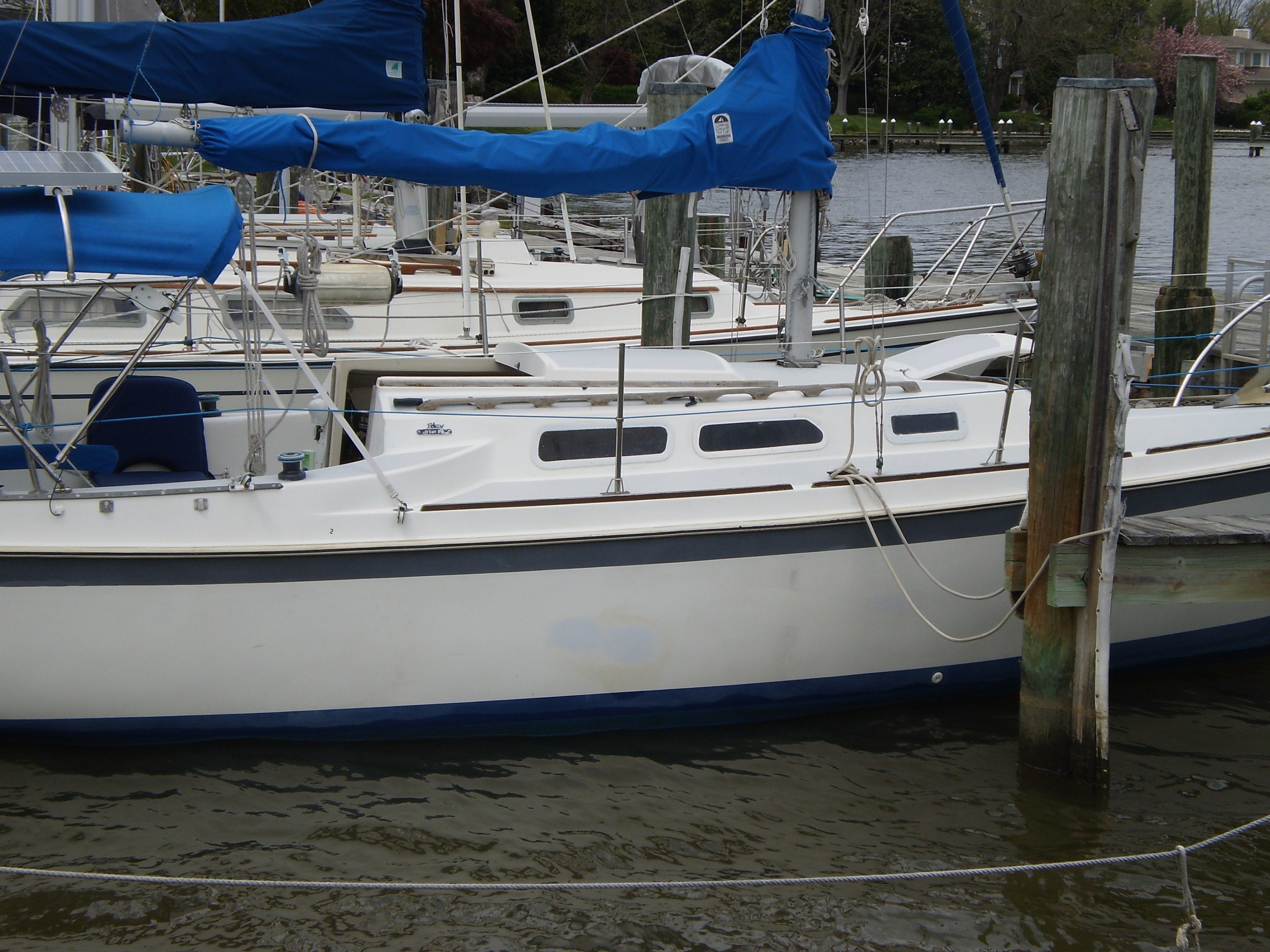

My oday 25 boom has a fitting at the top of the aft end of the boom. That fitting has two holes. I added a length of line to the topping lift and two snaps from the hardware store. The 1st snap is always engaged to one hole in the fitting. The 1st snap is used to hold the boom right above the bimini when the mainsail is being raised. The 2nd snap is used to raise the boom up to a point used to store the mainsail on the boom when the mainsail is down. To raise the mainsail the 2nd snap is released allowing the boom to rest right above the bimini. When lowering the mainsail the 2nd snap is engaged. My first time to upload an image, hope it is helpful.

SV very nice and simple setup, I have line and unused snaps already on the boat too so this looks like a winner for right now and to get ride of the messed up loop of half donkey tied line of questionable age and strength.
The next important question is detail on that sweet solar panel / bimini setup! Seriously is that a custom job and can you sail with it up and not interfere with boom / traveler / moving forward?

The bimini and solar panel setup was a custom job. There is no need to change anything on the solar setup to sail the boat. I put a lot of time and money into the boat. Took it down the icw from Md to Fl and over to Long Island in the Bahamas via Abacos, Eleuthera and Exuma in 2015-2016.
