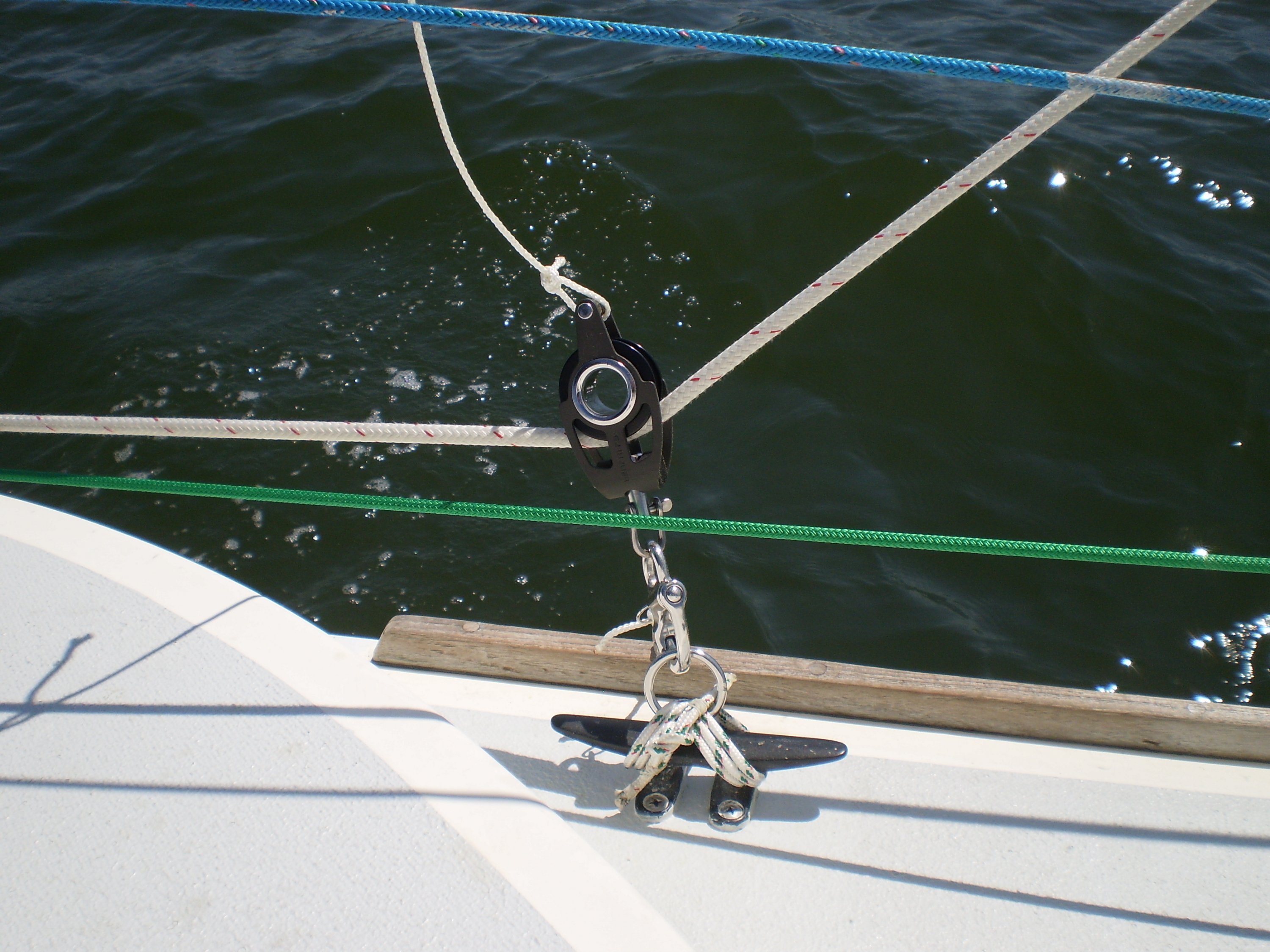

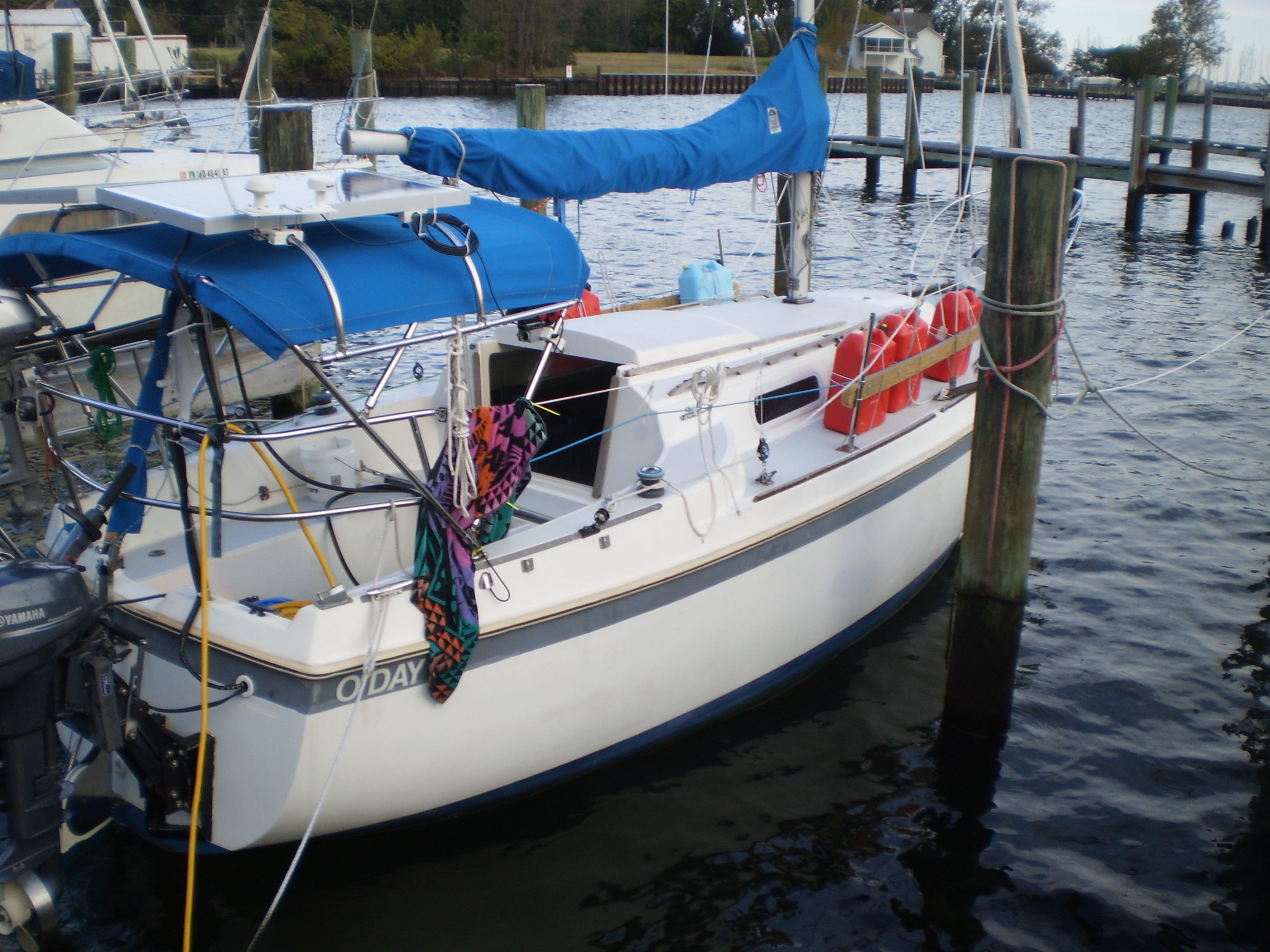

I removed all hardware on the side decks to free up the space for dinghy, fuel, etc for the trip to the Bahamas. I prefer to run my jib sheets outside the shrouds. Two sets of midship cleats were added. One set is just forward of the shrouds and the 2nd set is just forward of the coaming. Both sets are as far outboard as allowed and still have backing plates. One set of blocks is used and I have to move the blocks based on the point of sail.PA100874.JPG

Thanks @svchickadee . I like how you adapted the cleats to hold your jib blocks. I've been wanting to install a horn cleat for a spring line. Putting one in front of the combing like you did would work.

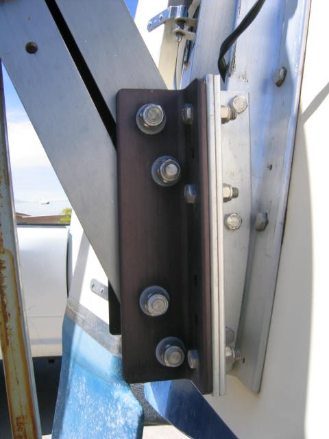

Also I recall you have a custom motor mount, where did you get it made or did you make it. I like how you get it low and high out of the water.

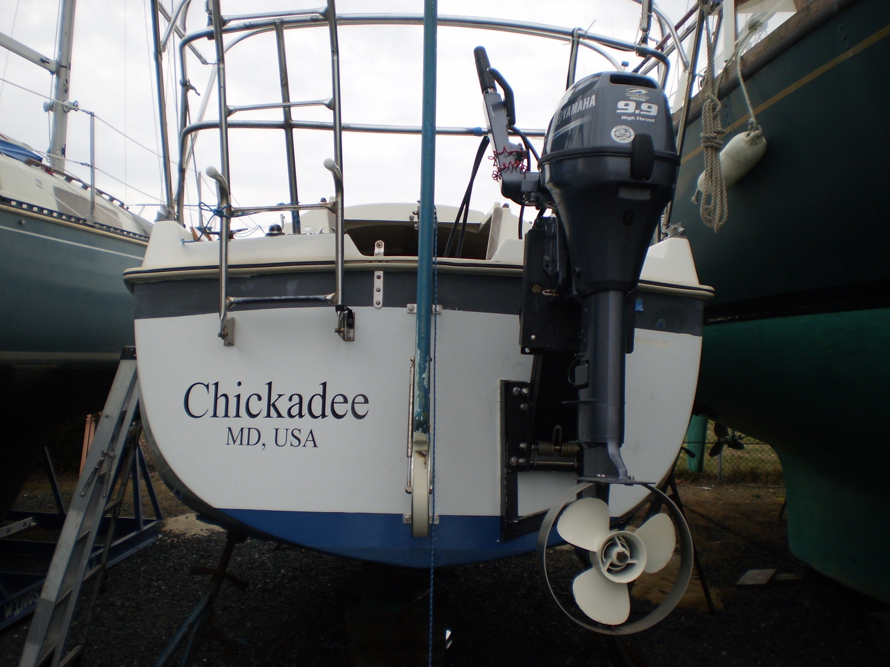

I had the motor mount built by a welder on the Maryland eastern shore where I lived at the time. It is made of 3/16 inch aluminum and cost a few hundred dollars. It has held up well in some extreme conditions in the Bahamas. The mount is extended down so the pressure is on the hull stringer rather than the transom when under power. I built a model of the bracket out of wood to get the transom angles, etal correct and the welder built the bracket from that model. No bolts used beyond the 4 that hold the mount.

Ah I see, very nice. My mount has a wood wedge between the transom and swing mount, yours looks like it doesn't have that.

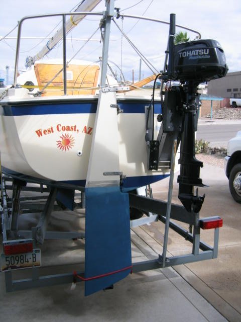

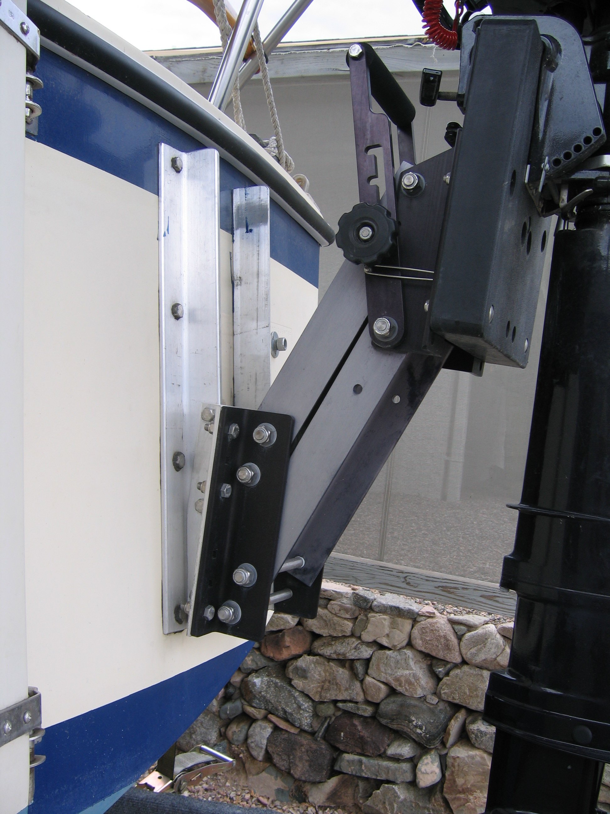

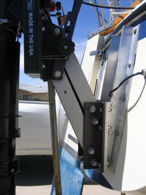

This is the no weld option. There is 2" angle on the inside as backing plates that run deck to hull. We trailer with the engine mounted with the extra bar support extending from the trailer.

That looks like a very simple approach. What is the angle material?

On Chickadee the four mounting bolts go thru the factory mount, the add on mount and the transom. I have 3/16 aluminum angle on the inside of the transom. My outboard weights 100 lbs and the boat displaces 5000 lbs.

Cool, I'm a bit surprised by the aluminum to be honest. I'm fresh water lake only so if the strength is there then I can see that has a good solution.
