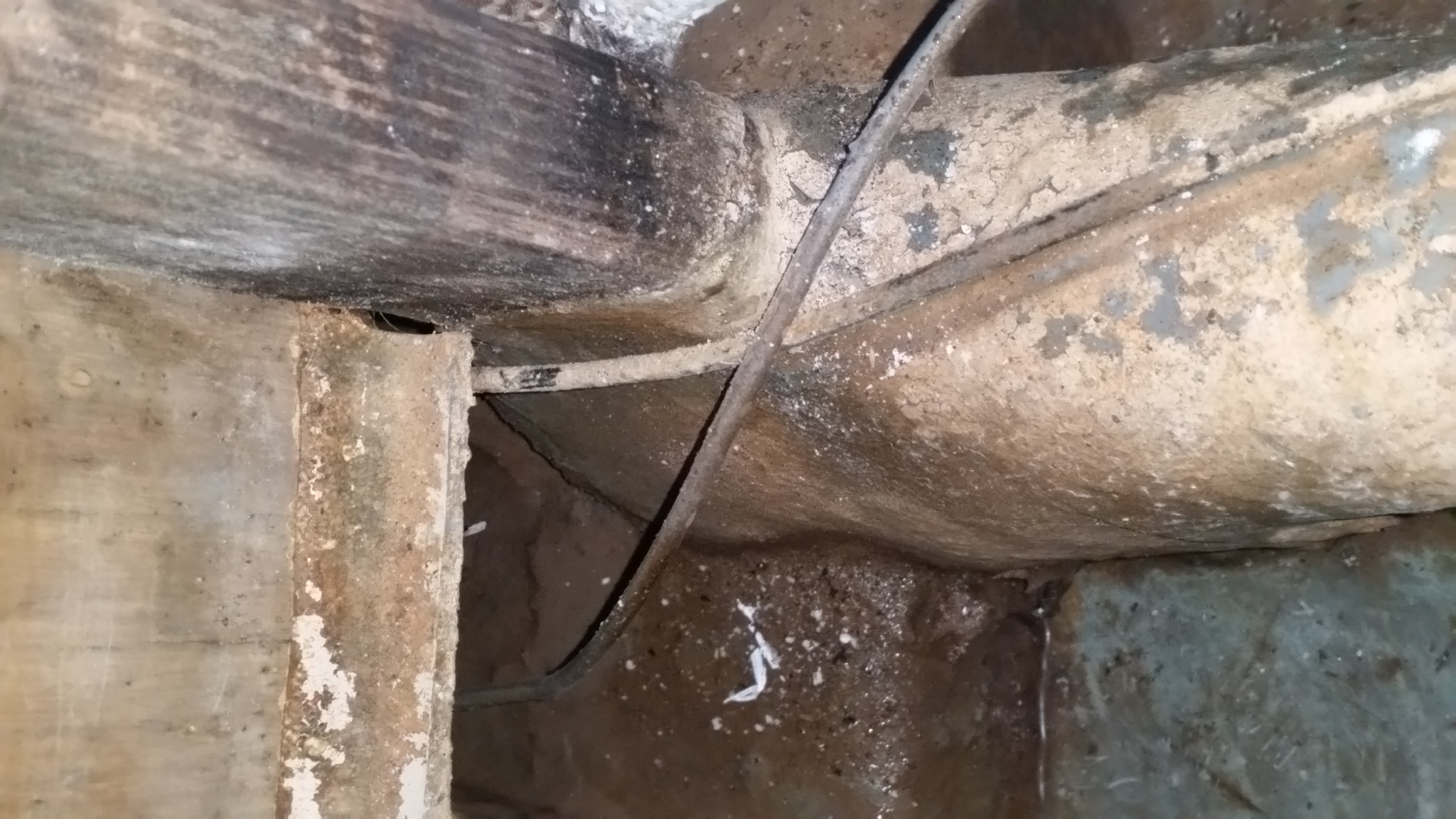

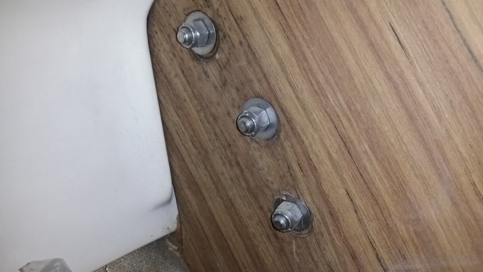

Owner was great and arranged for us to check her out on our own, time. The main issue he noted was a leaking knot meter transducer in the bow. I did note the compression spar was black at the bottom, about 3/4", but still reasonably firm. Port chain plate bulkhead was solid, starboard was a bit crushed at the top 2 bolts, but dry. Paint was still very good, a fresh polish will make her shine great. Sails are crisp, and neatly stored and careed for, vs is seeing others crumple up and not clean. Everything was as clean in person as the photos. Called the owner back that night and we aggreed on a price and will do a demo sail to check everything out in 2 weeks on the water.

I would have a real good look at the compression post and especially that bulkhead. I owned a 25 a few years ago, they are notorious for leaking at the chain plate deck penetration. There should not be any deformation of a bulkhead. Having a chain plate tear out and bring down your mast is a sure fire way to ruin a day. What is "reasonably firm" in regards to structural components?
EDIT: Also check the mast deck plate and core there for water intrusion. Another place that leaks a lot. I recored that area on mine before I sold it. I had to redo the bulkheads over the winter I first owned it as well.

So I know that I will need to address the bulkheads and compression post so I've been doing some research online. Obviously the best approach is to tear out everything, replace and seal any leaks. I'm a bit curious because most of the post I have looked at show large post, in the 4x4 size with 3/4" bulkheads (these are not O'Day 25 BTW). As I recall from my inspection the post in the O'Day is a 2x4 and the bulkheards didn't look that thick to me, maybe 1/2". Is the O'Day Fiberglass significantly overbuilt in these areas to allow the smaller post and bulkheads? I honestly saw very little gel coat cracking in the top deck and nothing around the mast or chain plates.
I know there are a couple of thoughts over do it and add more because that has to be "better", but if this boat is in as good of shape it is in right now and the wood is 40+ years old, I really can't see why not just replace with what was there instead. Our plans are very much limited to learning and sailing on the Lake Guntersville / TN River area. No intentions of any long journeys or significant sailing in bad weather.

These O'days lasted this long as built so no need to over engineer it now. Just replace with same size. Much easer to do I'm sure.

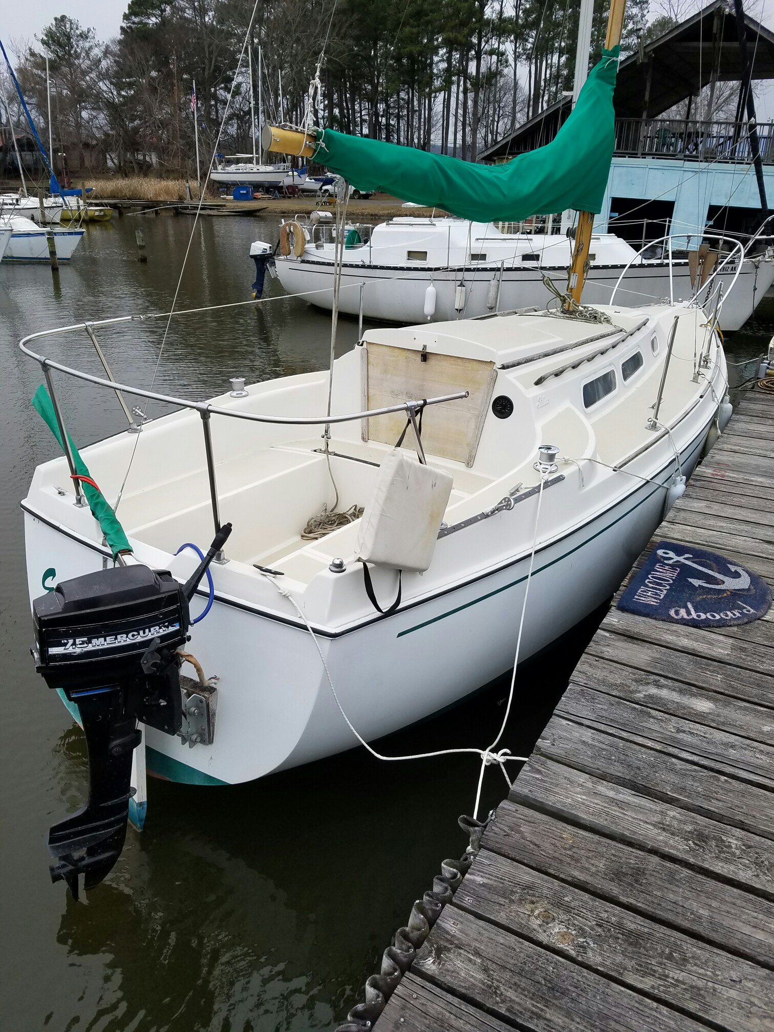

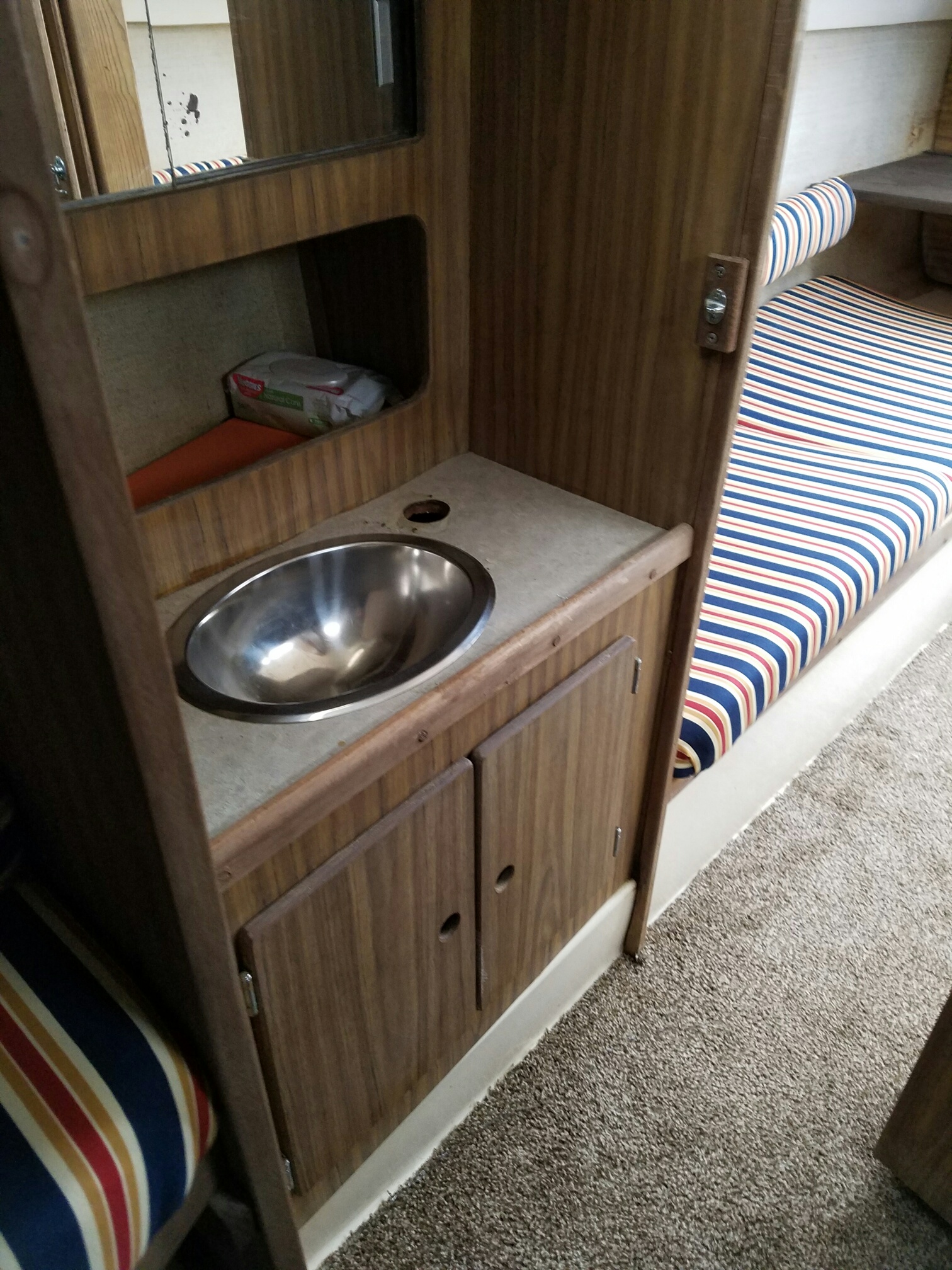

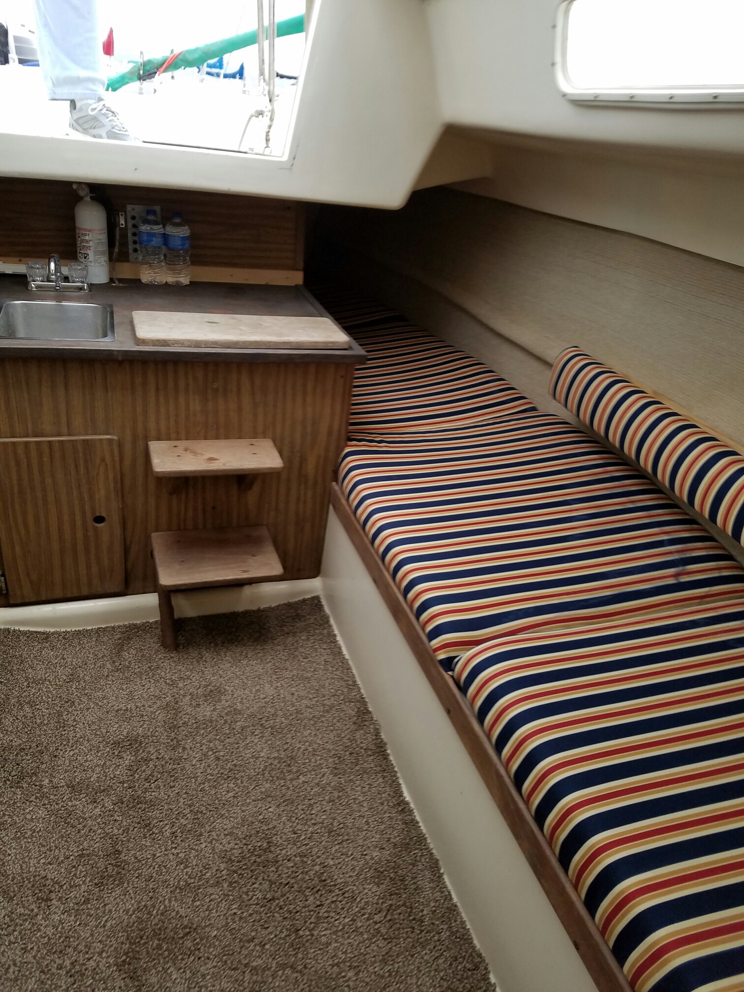

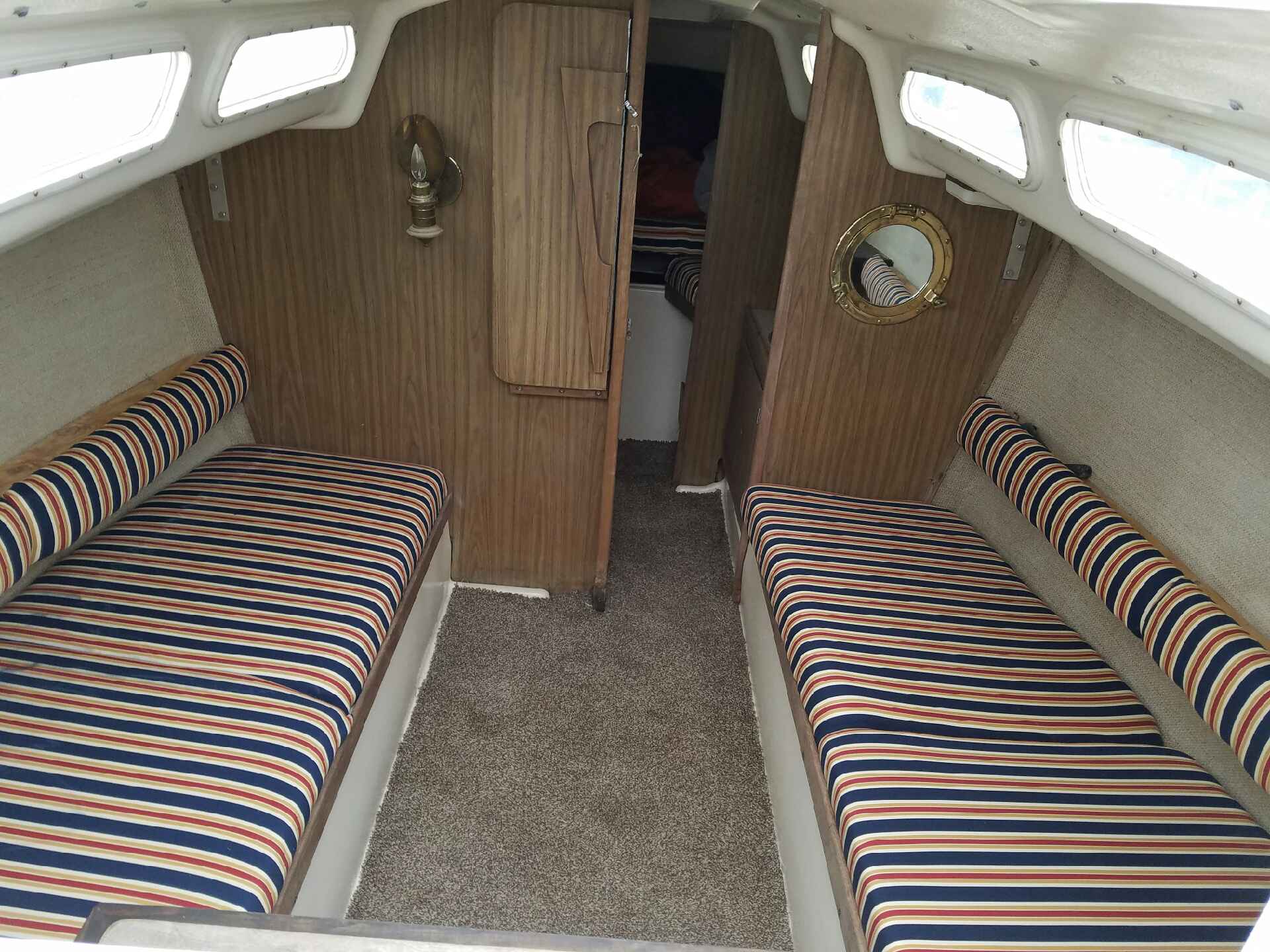

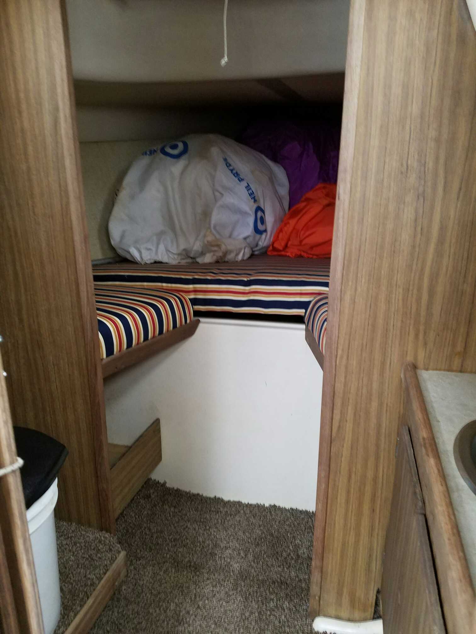

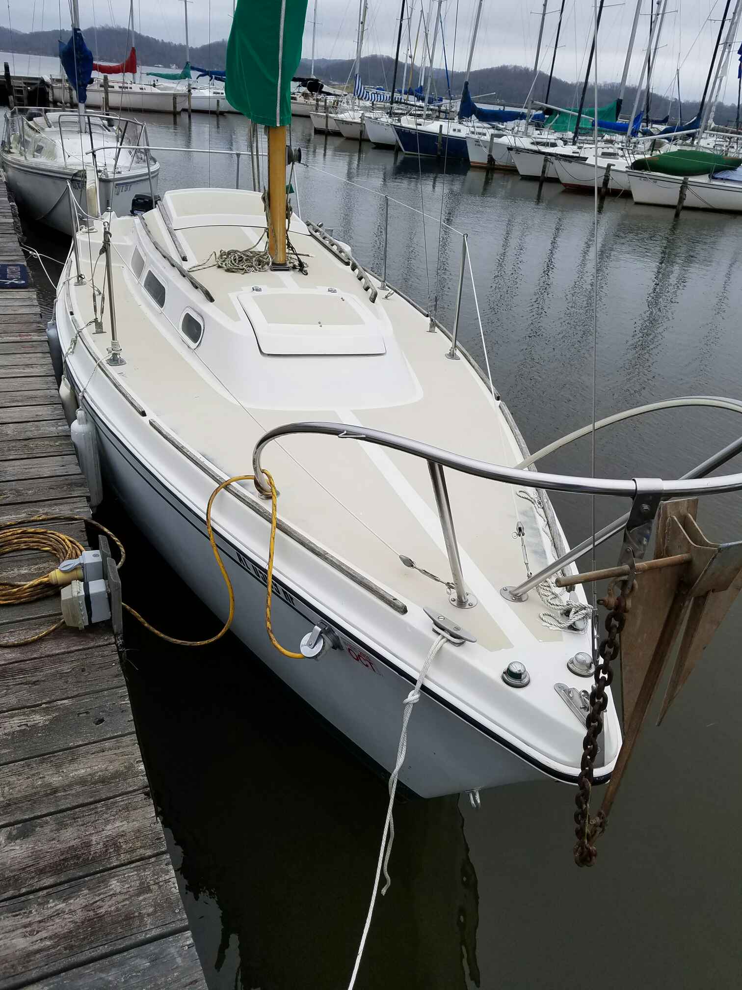

A few pictures, taking a test sail on Saturday.

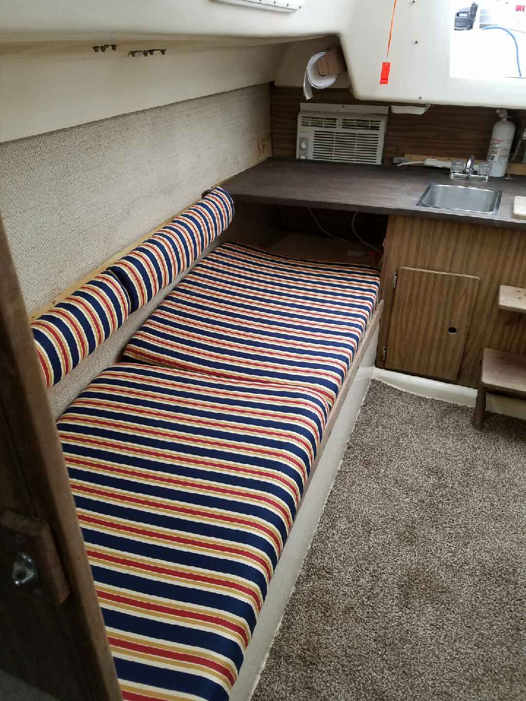

Yep, same boat as I. Glad I was in great shape with all that chain plate and compression post stuff. Seen the window AC in wall over where stove area but I don't see it sticking out the other side, where does the exhaust go, to hot for me to run it underneath here in Florida. 6 foot draft I'm guessing. Looks good, she will fly and you can do Jib, Genoa and a spinnaker. ⚓

It vents to the outside under the seat in the cockpit, drains to a bucket to be emptied overboard. Kind of creative install and only used with shore power. I'll probably keep it for now. I also got additional items from the seller last night that include, battery charger, fish/depth finder, Raymarine auto tiller, VHF radio (Uniden) and four new life vests. Sail inventory is 2 mains, a jib, a genoa and spinnaker.

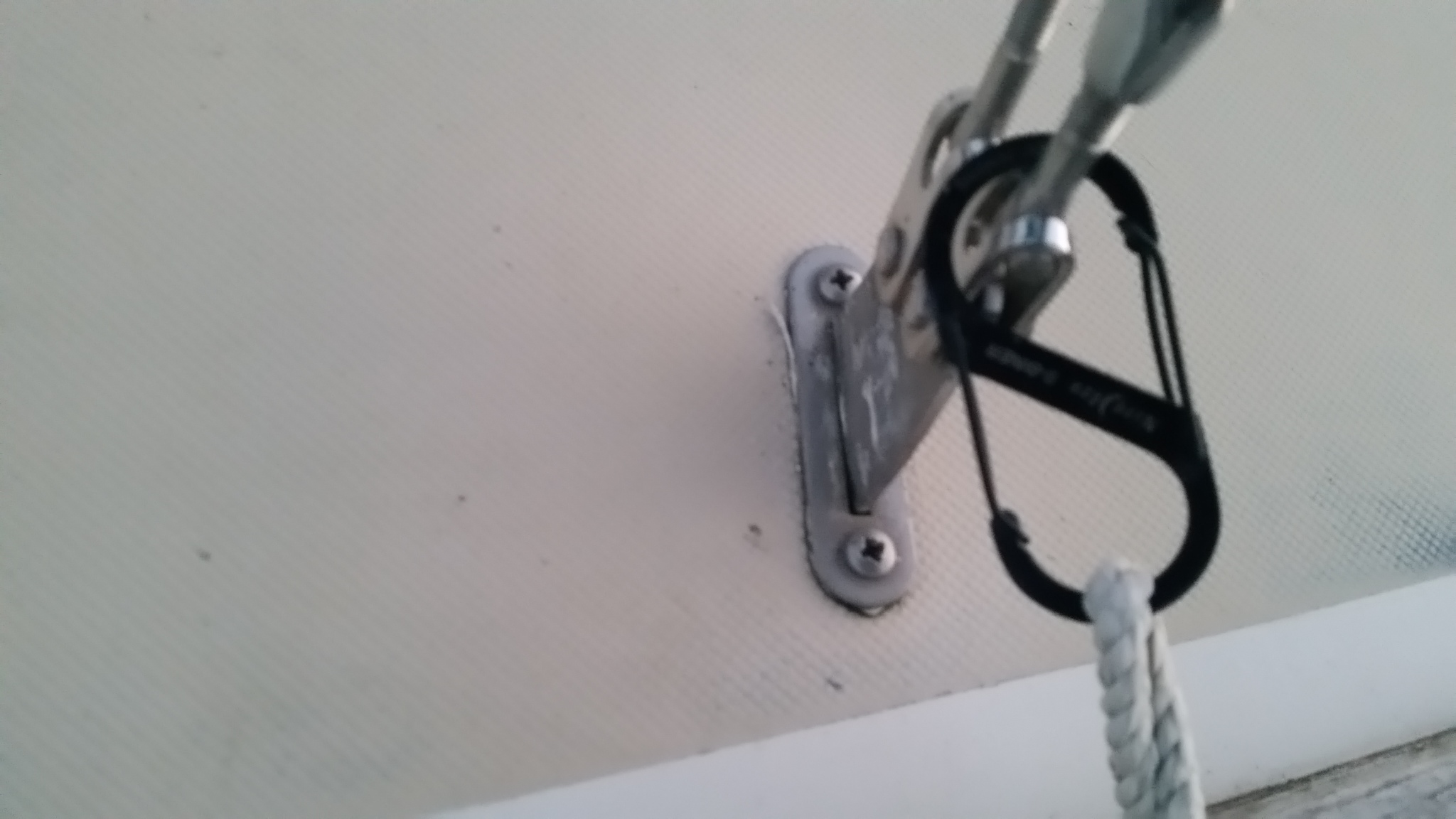

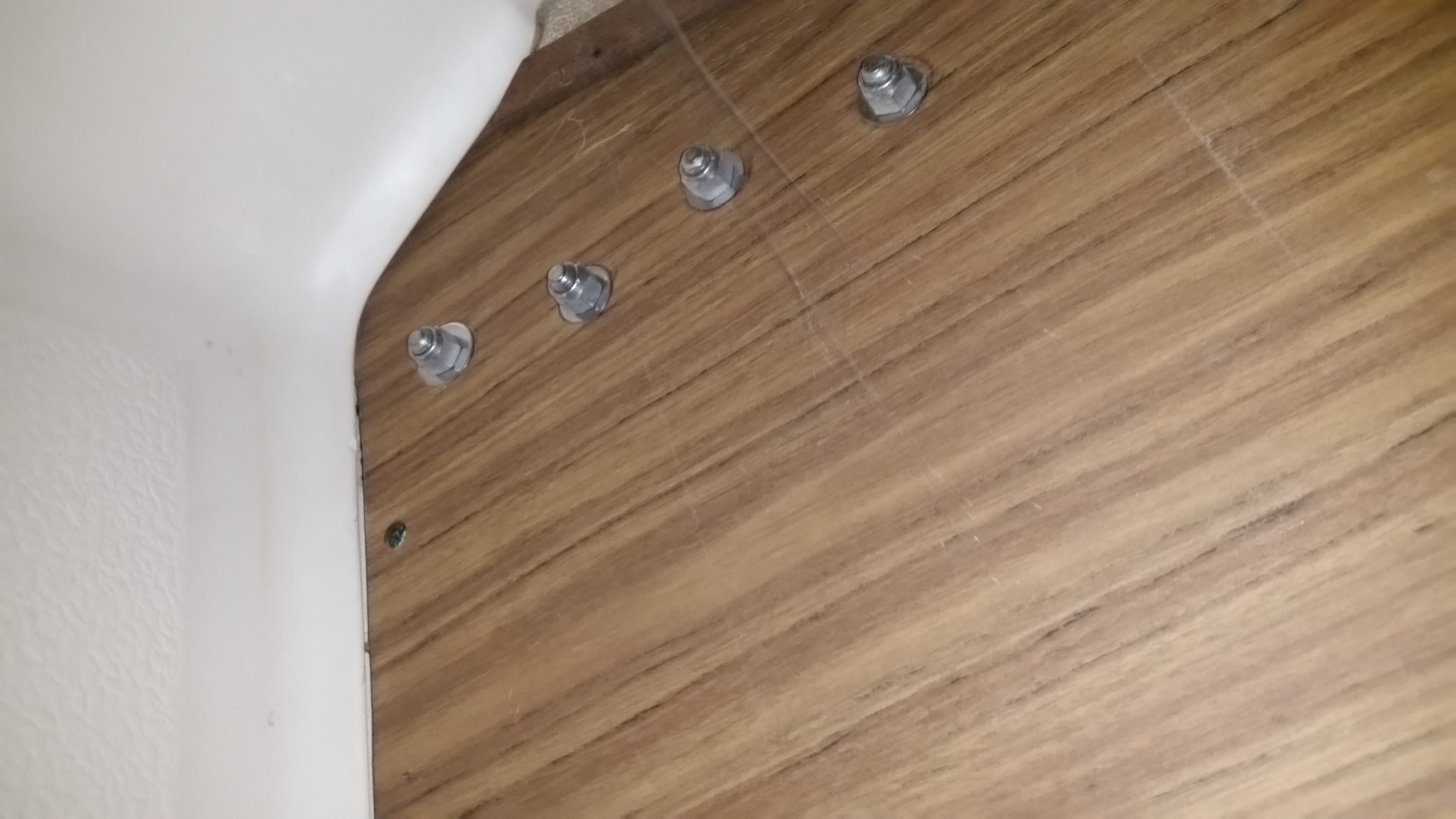

These are close up of the areas of concern.

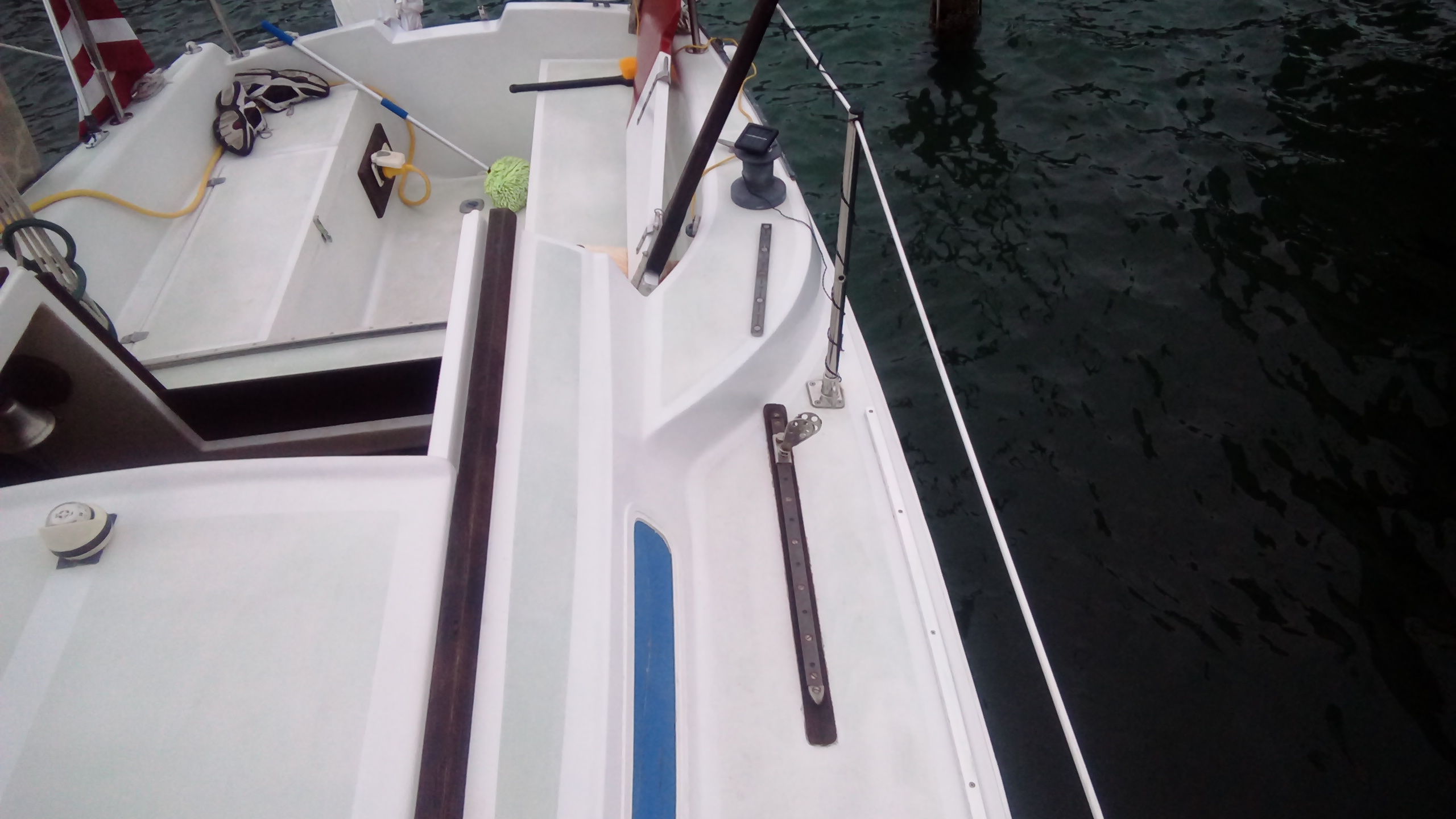

I noticed I have three front sail sliders on each side of my boat, front one for jib, middle for Genoa and the big long one in the back that you have for spinnaker. Just happened to notice.

Oliver, pretty sure those front two sliders were added on. All the 25s I've seen are like John's with a single standup block for the jib sheets. It works OK but for fine trimming of the jib a slider track works better.
John, looks good. I like where the AC is mounted. I have a cabinet there but we have wanted a way to install a small AC for those hot nights. I'm going to think about that.

Thanks Ward, I've been reading too much on chain plates coming out so that has me a bit concern.
