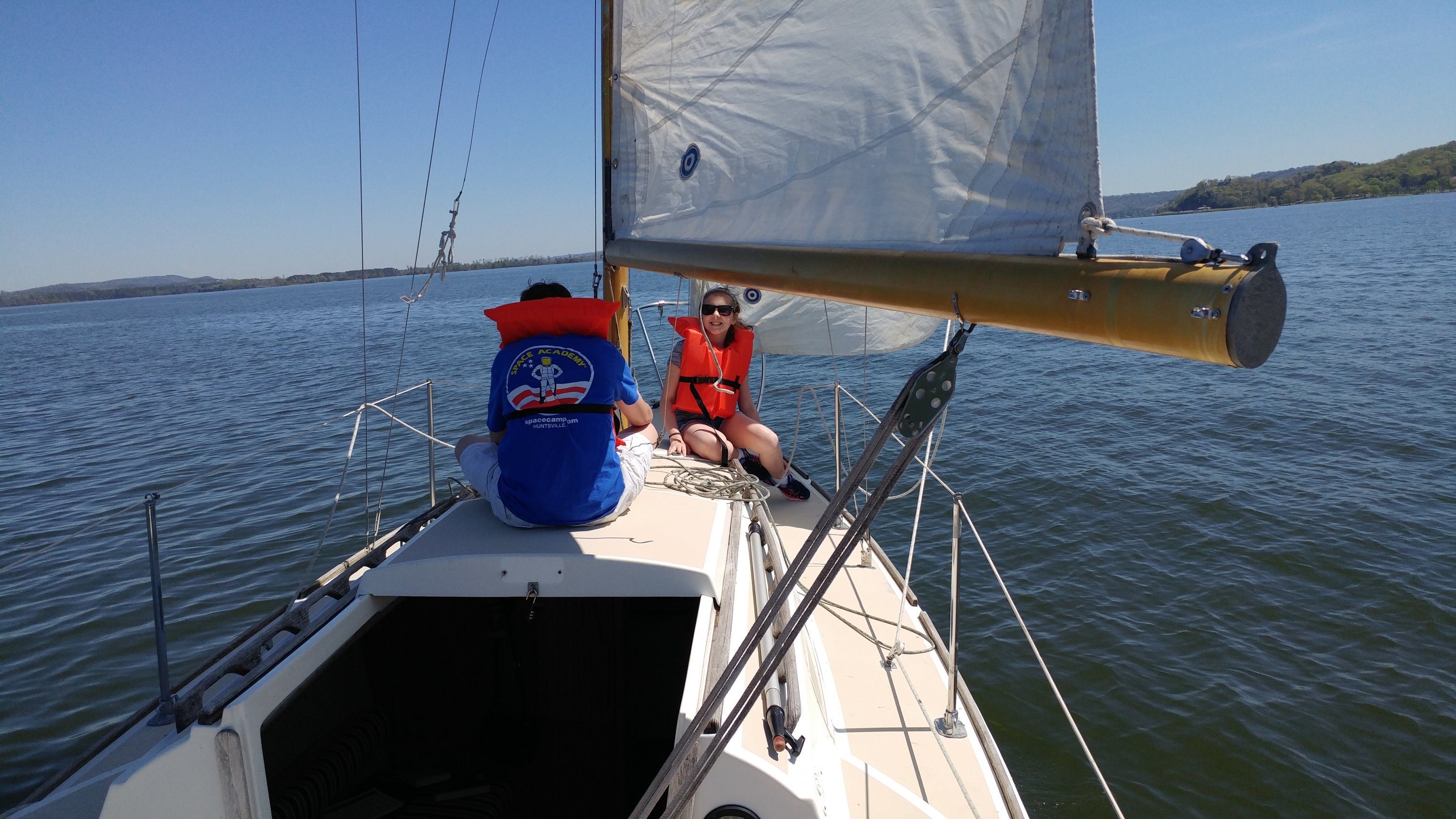

Thanks, it went great and everyone had fun today. Wind was very lite today, so not exciting but good to learn on with my wife and kids. Everyone did a little and it was great. Hope next weekend is a good one too.

Only issue I notes today was the outside side stays rub the life line and the jib sheets. Any recommendations?

Looks like the kids are having fun. Glad it went well.
If the outside shroud (side stay) is rubbing the lifeline "hard" try running the lifeline to the other side of the shroud.
Are you saying the working jib sheet also rubs the shroud? If the sheet is also rubbing the life line, try loosening the life line a little. I leave my life lines a little slack.

Two things:
Your boat has a wide shroud base for a boat that's designed to fly Genoas. Ideally it would be much narrower. So there's always going to be some interference. The fixed sheeting point does not help that.
If you want your kids to keep coming, let them pick out their own PFDs. Those orange things are really designed for emergency abandon ship situations, and not to be worn all the time on an active boat. Take them to someplace like West Marine or Cabellas, and let them pick out their own comfortable one.

Thanks Ward, I will move the life lines between the stays. We spent a lot of the day close-hauled so I was really noticing it. the port jib sheet had some visible wear I hadn't noticed before. I only had the jib with me, in hindsight I should have sailed the 150 genoa, or as my family calls it the salami sail.
Yup Jackdaw that is on the list before the next trip. We had them on if they are going forward during the sail.
These shroud protectors work, Davis Instruments Rigging Covers, 5/32 inch.
http://www.defender.com/product3.jsp?path=-1|118|2358491|2358503&id=210726
Those look great, placing my order now!

So my jib on the head has a stainless wire extension attached with shackles that the previous owner attached the halyard. The Tack attaches to the shackle on the deck. I noted the bottom of the jib sail hits the bow railings and sort of looks weird to me. I'm wondering if this stainless wire extension should be on the tack end to get the jib foot up and over the metal bow railings.
I'm probably doing a lot wrong, but we at least got up to 3.5-4 knots having fun under sail.

Your picture show the tack high above the deck???

No it is just the distance the shackle extends from the deck to the tack on the jib. On that picture over my daughters shoulder you can see the sail hitting the bow top railing. Maybe this ok, I just never noticed it much on other boats before, then again this is mine so now I pay attention to a lot more then I ever did before.
