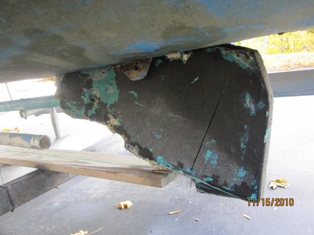

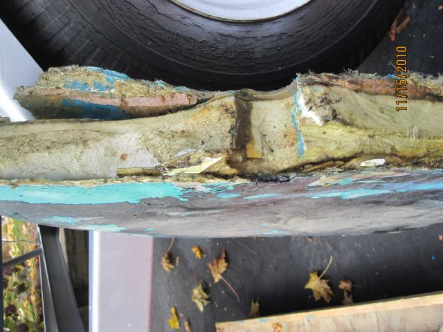

OK, so its the end of the season up here in New England, so I hauled out the H22 boat only to find that the swing keel had failed COMPLETELY, and I was just sailing her last week. It must have been low-low tide and that submerged pipe at my mooring that led to the ultimate failure. Good thing that the ballast (1300#) is in the bilge and not in the swing keel or I would have gotten a big surprise last week sailing !! I guess the PO's repair work on the keel wasn't up to the task of 20-30 kts winds on the mooring; now I'm left to do a complete replacement using Foss Foam !!
It'll wait 'til next spring...have one last daughter to put through the last year of college and a new swing keel is not real high on the list these days. I know some of you have used Foss for swing keel replacements....any "yeas" or "nays" on the quality of their work ??

....apparently they are the wrong "Foss" as they replied for me to contact Hunter for swing keel replacements (no 'Bob' either).
A search of the internet yielded another "Foss" in Fla (NewRudders.com)
...(inarathree, I should have been reading your reply more thoroughly...i.e., I-75):
Foss Foam Products of Florida, Inc.
7060 Highway 41 North,
Williston, FL 32696
I'm awaiting their reply. Thanks for your input!
Attached are pix of the failed swing keel.​
Jun 16, 2010
495
In search of my next boat Palm Harbor, FL
Funny (or not so funny), but that is exactly how my keel looked.
