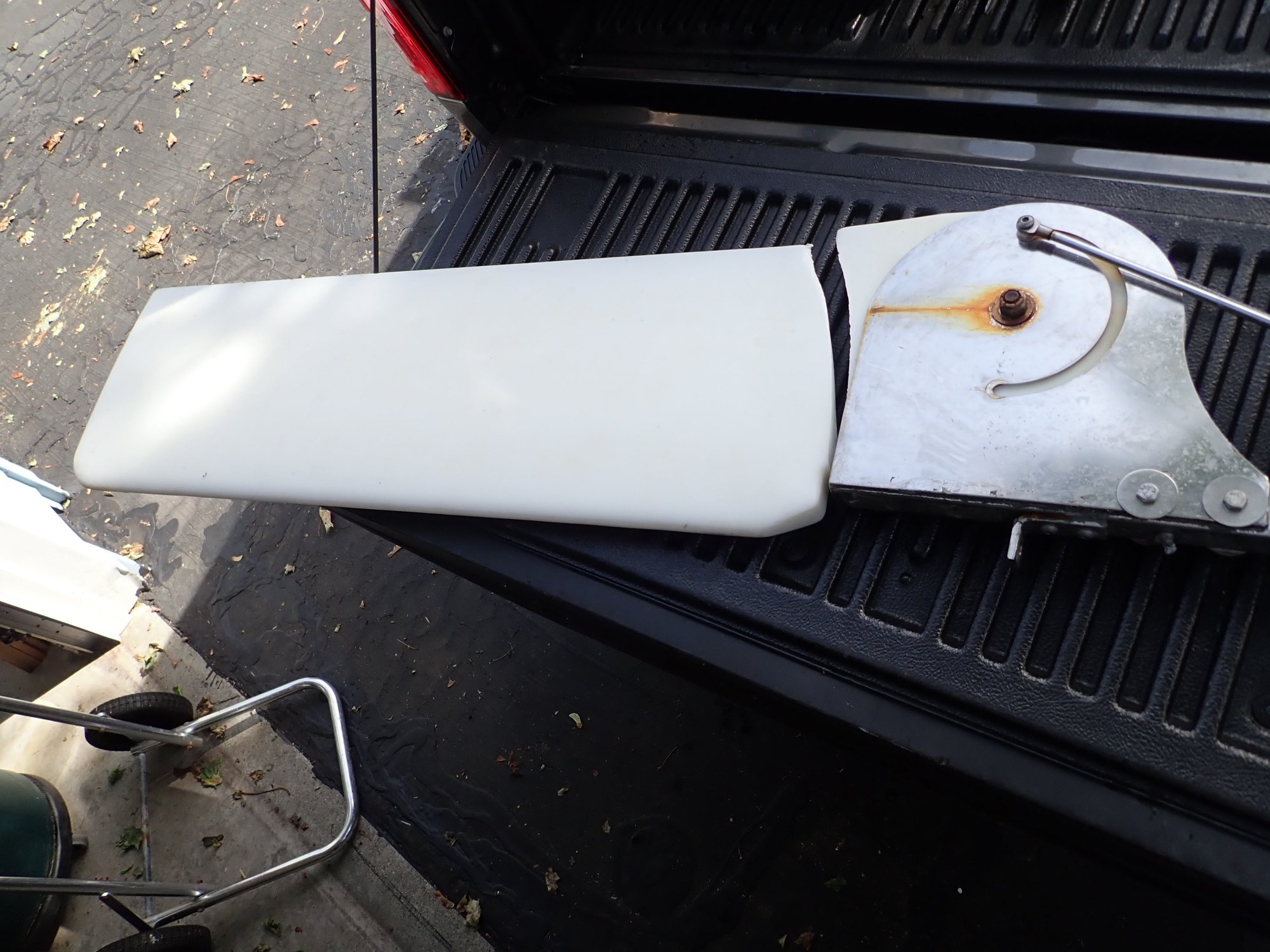

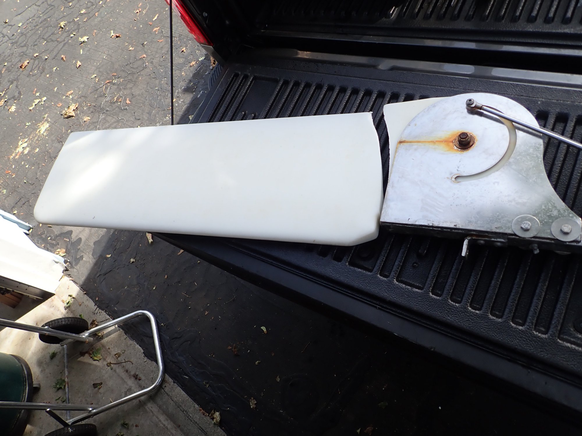

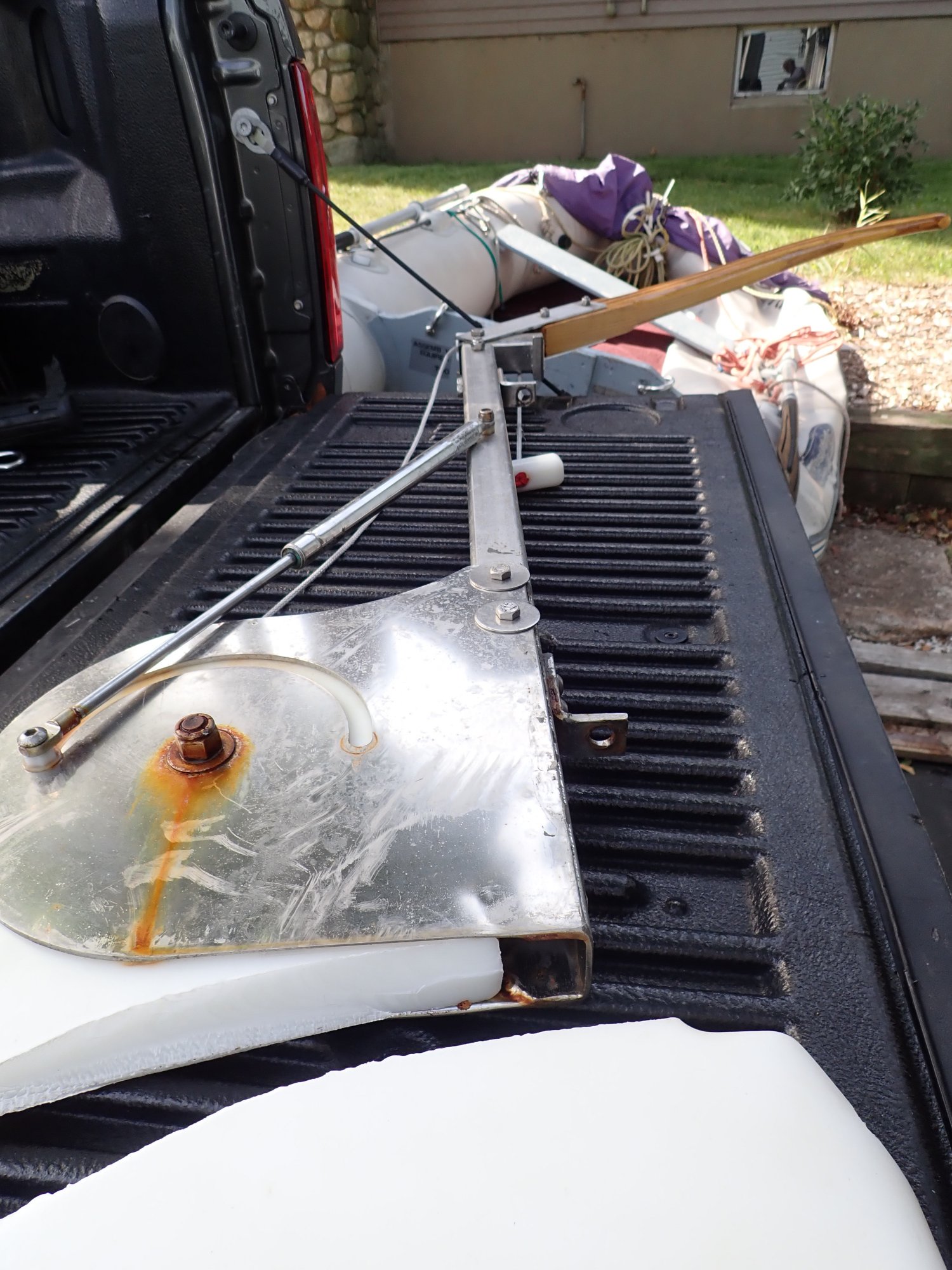

The saga continues....my rudder failed late last fall and I'm not sure if I'll go with the previous manufacturer. When I say "failed" I mean the HDPE blade nearly completely sheared just below the pivot point (see attached pix). It was made by Rudder Craft, Garden City, ID and in service for 10 yrs. I don't sail her too hard, no races and winds <20 knots. I don't know if this is unexpected for the in-service duration, or not. But I want to know of the alternatives / your recommendations.
Does anyone have any rudder / blade recommendations other than this configuration?
Thanks bunches.

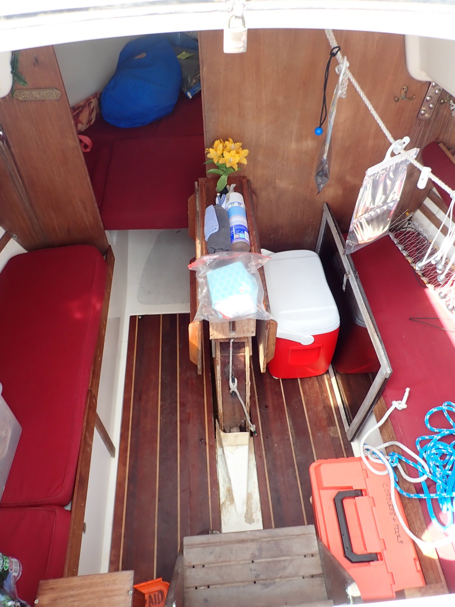

No, the up haul line is mounted on the swing keel housing / trunk (under the drop leaf table) inside the cabin. The 'down haul' is gravity.
