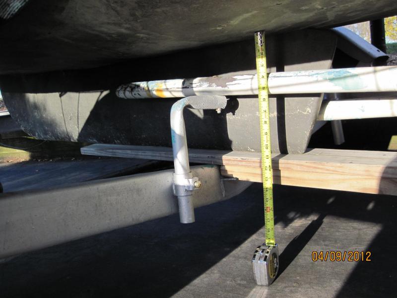

armesy1954, RE: difficulty with your H22 swing keel...see the attached pix of my 1981 H22 swing keel configuration with some measured dimensions shown (hopefully enough info for you, if not, let me know what additional measurements you need). I bought from Foss Foam (FL) & installed it last year, and am quite satisfied so far.
If you have dimensions / pix of your swing keel available, maybe I or someone else on the forum may be able to give suggestions for your self-made swing keel fit.
Charlie
Charlie
Well, what do you know, that looks just like mine! I didn't have any pics of the swing keel installed. Looks like I'm off to the welders to raise the bunk boards a bit.
