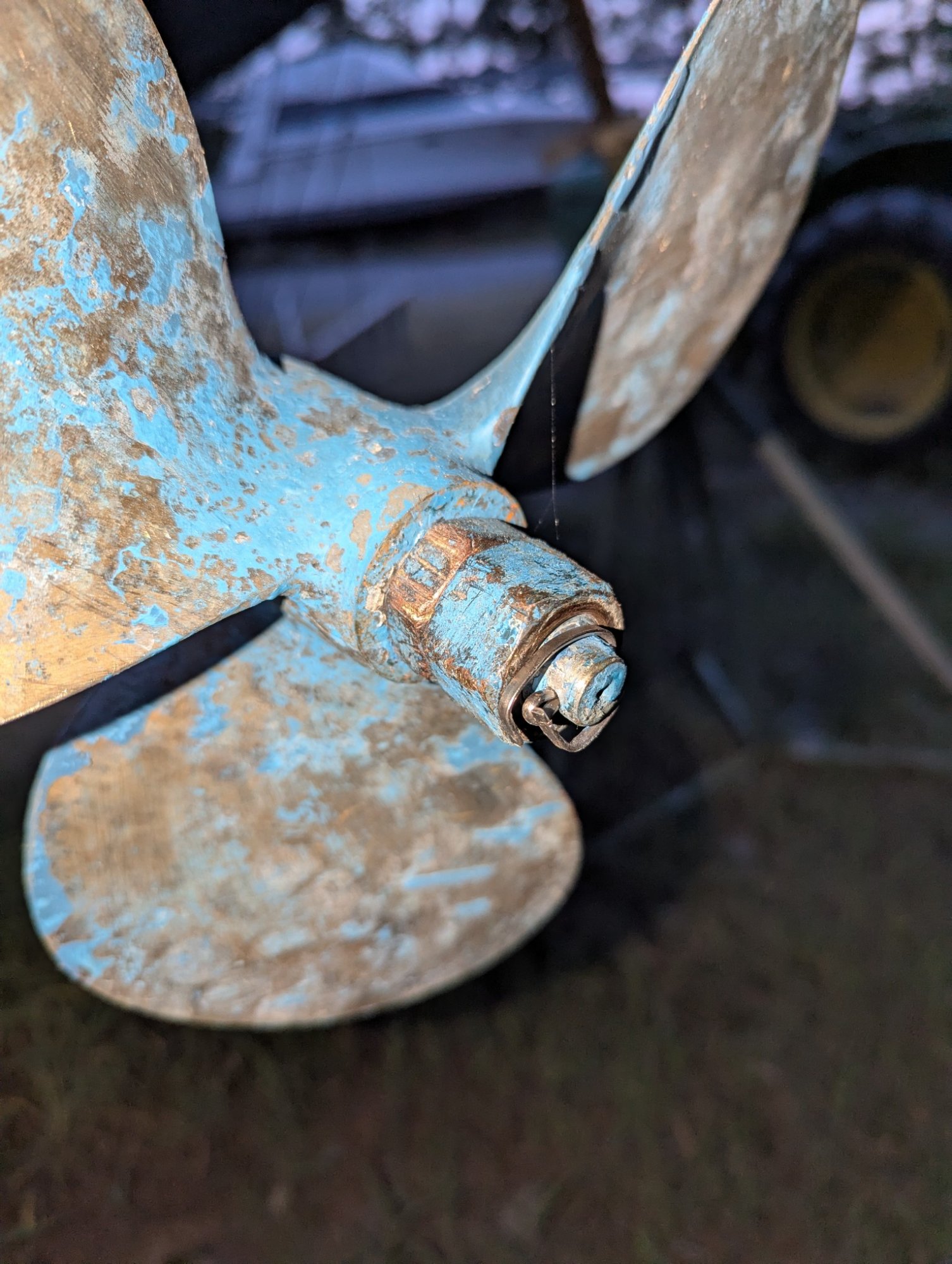

AS far as I know the propeller and shaft are functional and seem in decent condition. Is there any reason to do further work while the nuts are off and it's out of the water? Looking for ideas.
Jan 7, 2011
5,906
Oday 322 East Chicago, IN
You may want to check the cutlass bearing, and the shaft and coupling, and the stuffing box.

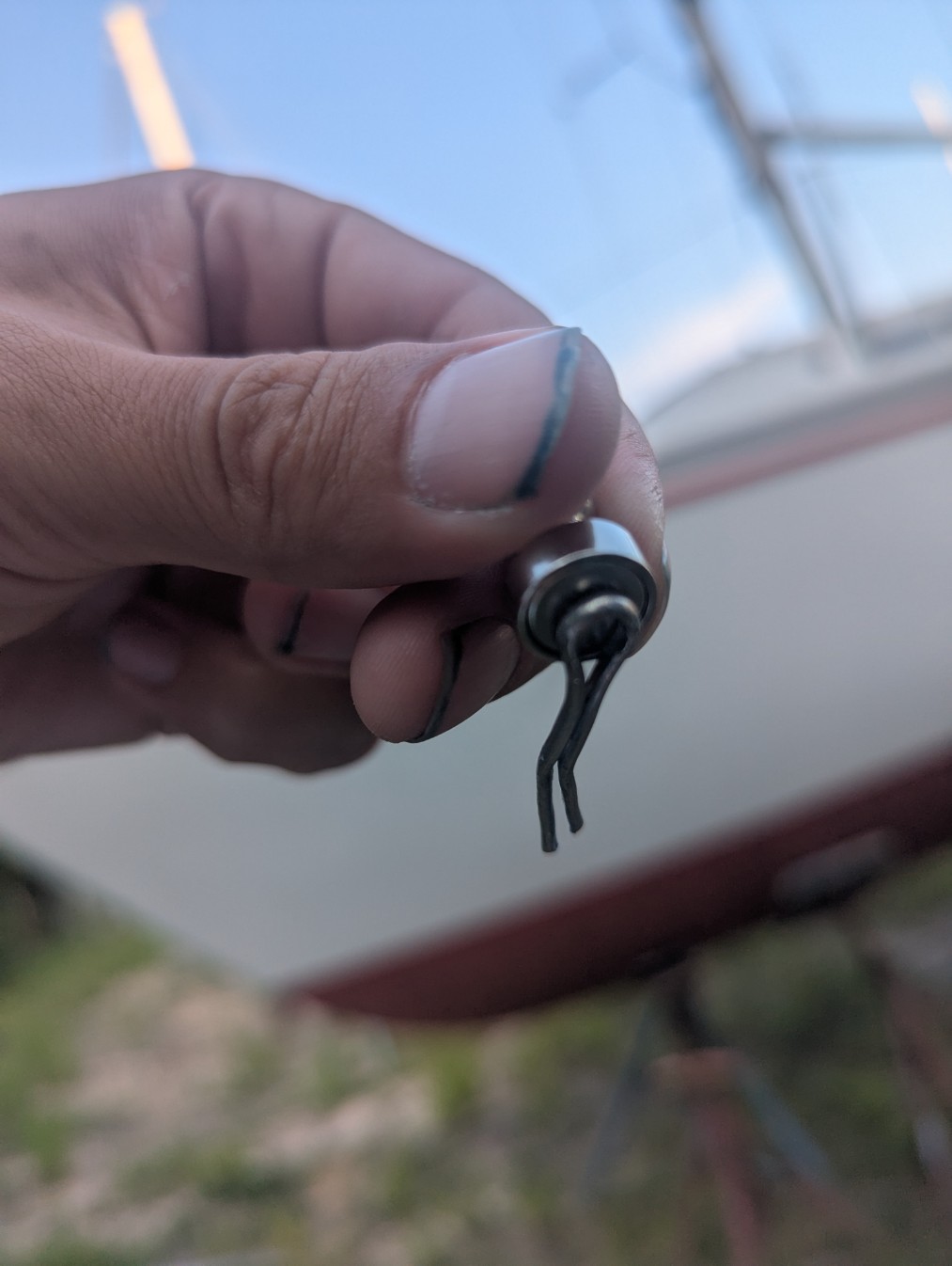

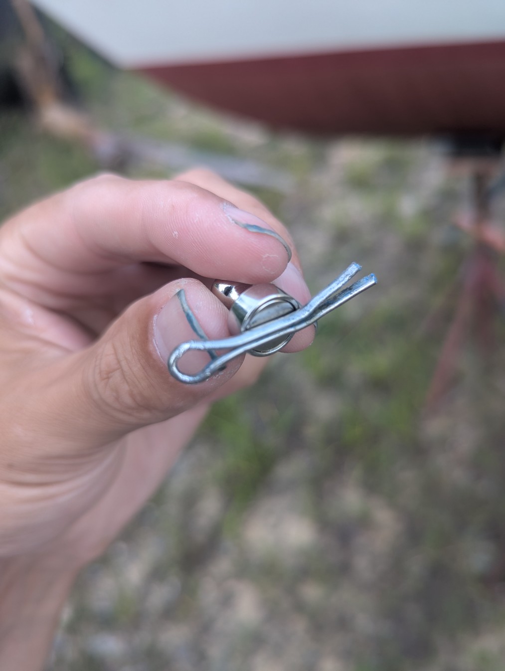

Hey folks,
Just got a new pack of cotter pins in the mail today. I was feeling curious, so I hit them with a magnet—and to my surprise, they’re very magnetic.
That got me wondering, so I went and tested the old cotter pin that had been in my prop shaft for who knows how long. Sure enough, it sticks to the magnet like it's glued. (Pics attached.)
Now I’m scratching my head:
Is this normal?
Is it a bad sign?
Is magnetic-ness a red flag for poor-quality stainless?
Should I reuse the old one, trust the new ones, or start hunting for a truly non-magnetic option?
Would love to hear what you all think.
Thanks in advance!
dLj
Mar 23, 2017
5,034
I've posted about this numerous times. If i could remember exactly which threads I'd post a link but I don't remember.
What material are the cotter pins made from? Is it 316 stainless steel? if the packaging says it's 316;stainless, they are likey fine.stainless steel becoming magnetic when cold worked. It's normal.
