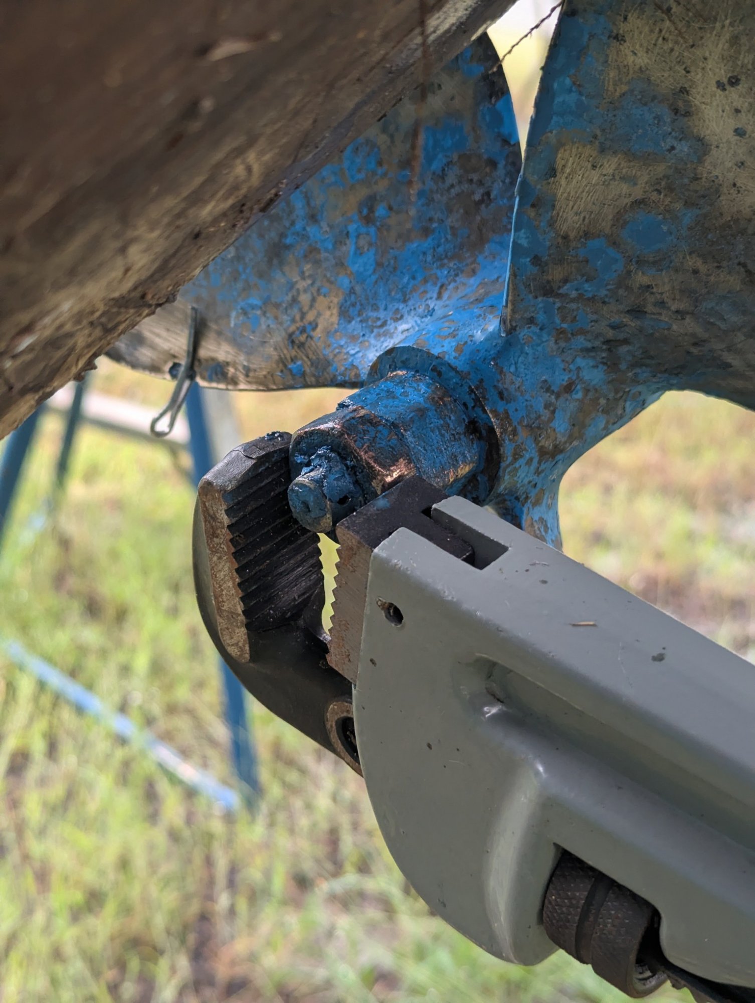

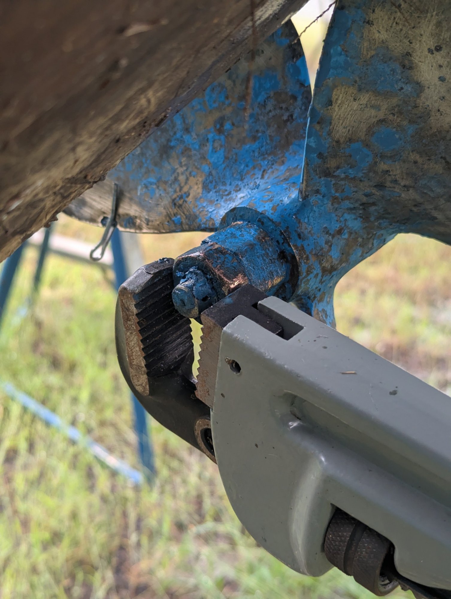

A pipe wrench is not a good tool for this job. A pipe wrench grips pipes with the teeth on the jaws, this will severely damage the soft bronze prop nuts. There are "pipe wrenches" with flat jaws which will work.
It already damaged mine a bit until I realized how much damage was being done.
I also definitely do not recommend a pipe wrench.

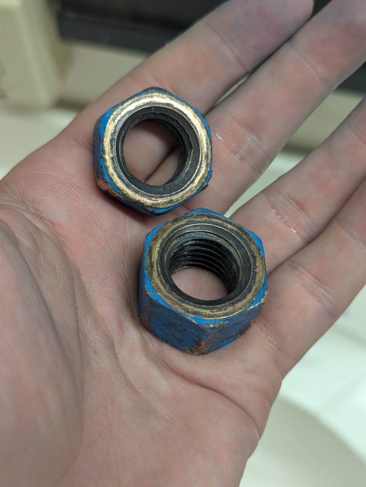

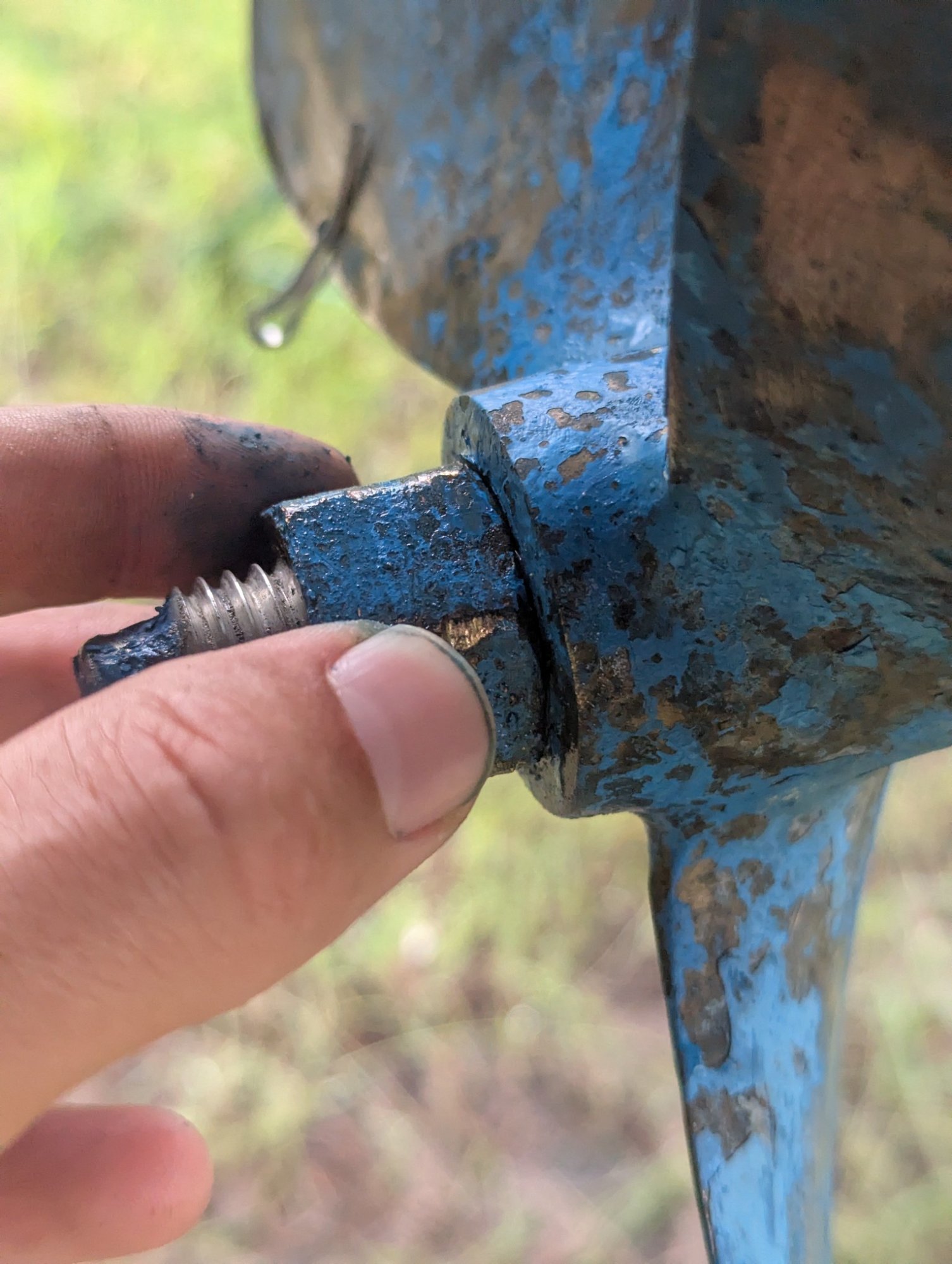

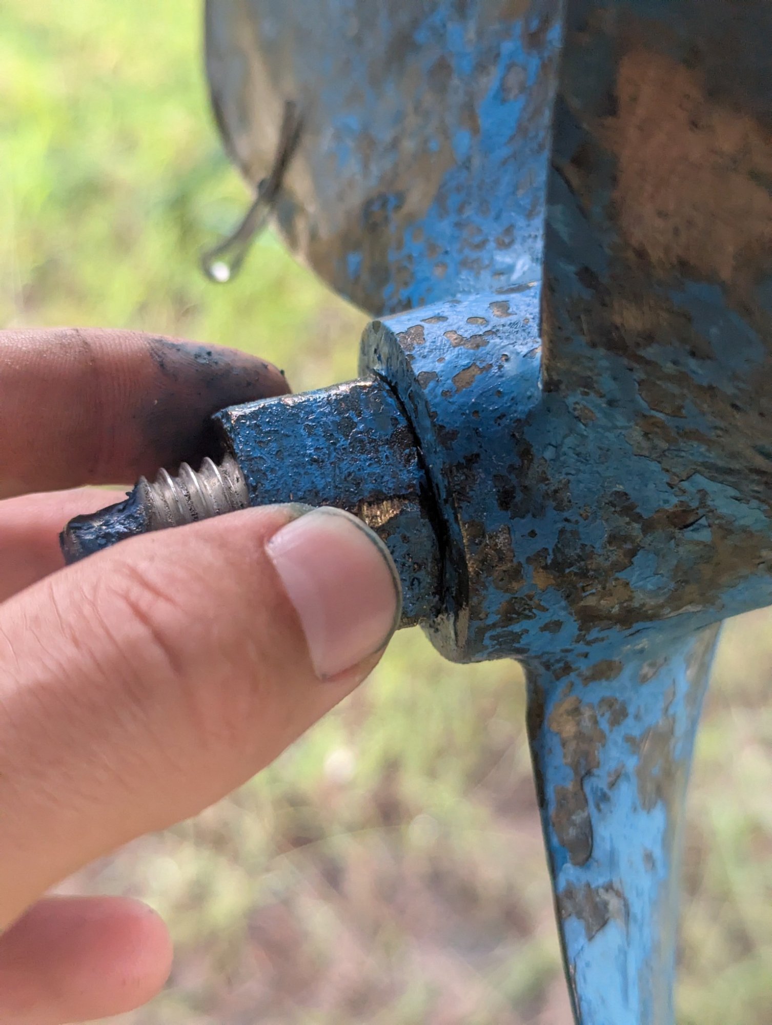

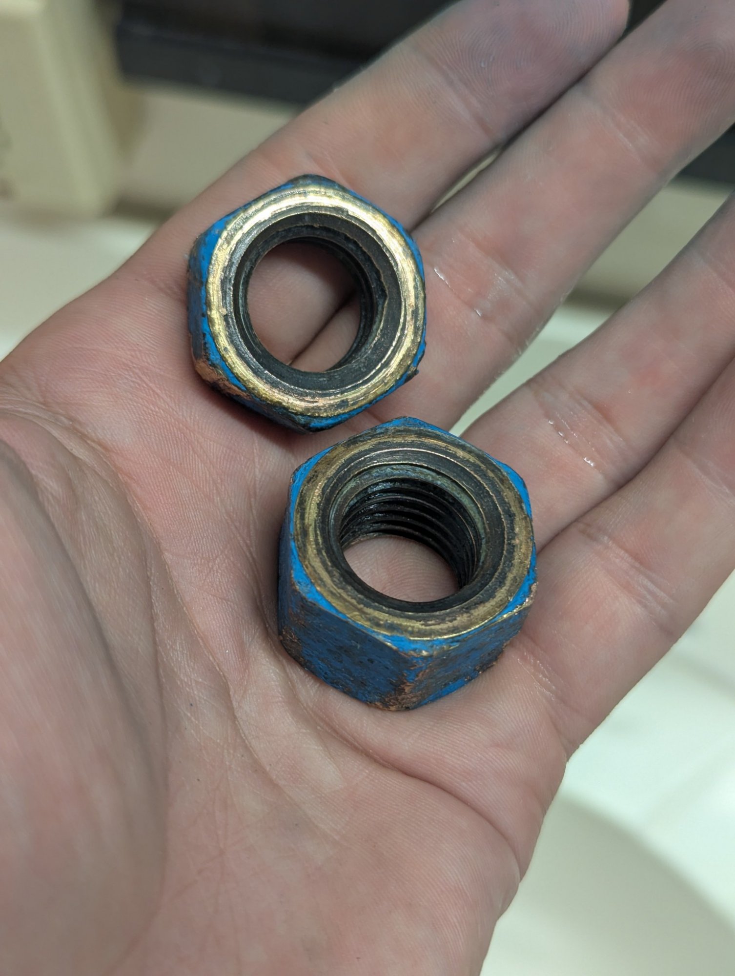

Hey folks, just wanted to share an update and a little lesson learned while pulling the prop nuts off my shaft. I ended up using the woodblock method and, yes, a pipe wrench. Not ideal—I’d definitely recommend using the proper-sized hex socket if you have it—but in a pinch, the pipe wrench and woodblock got the job done.
Once I broke the tension on the jam nut, it backed off without much drama. But what surprised me most was the taller, wrongly placed nut. The moment the jam nut came off, I reached for the larger nut and found it completely loose—I could literally spin it off with two fingers. I expected both nuts to be tight, but evidently vibration over time can break that tension or walk the larger nut back.
You can see the vibration pattern in the chart above; it's possible that’s what contributed to it. Either way, lesson learned: don't assume both nuts are secure just because one is.
I’ll be reinstalling them the correct way—jam nut first, taller nut second, then locking everything down with a fresh cotter pin.
Photos attached in case anyone’s walking through the same job. Hope this helps someone else out there.
Good! Now clean up the scarred nuts & coat the shaft with Lanocote grease prior to installing the nuts & cotter pin. Buy the specific size box end wrench (single wrench only) from Amazon to reinstall the nuts and for future use. Use the wood block method again to prevent prop / shaft rotation, in the opposing direction, to facilitate tightening.

Jun 14, 2025
188
Hunter 1981 30 Chesapeake

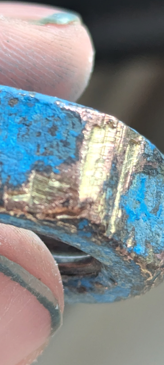

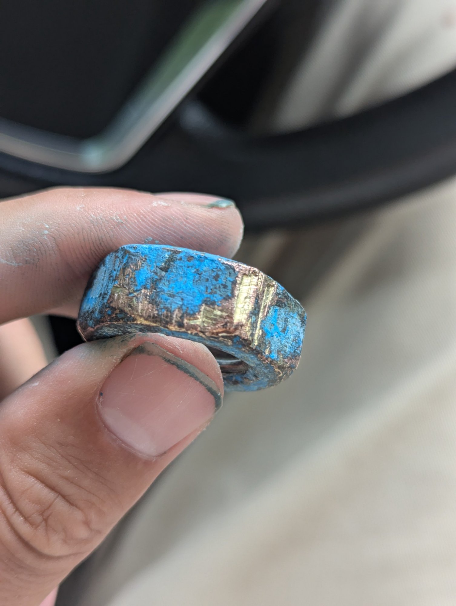

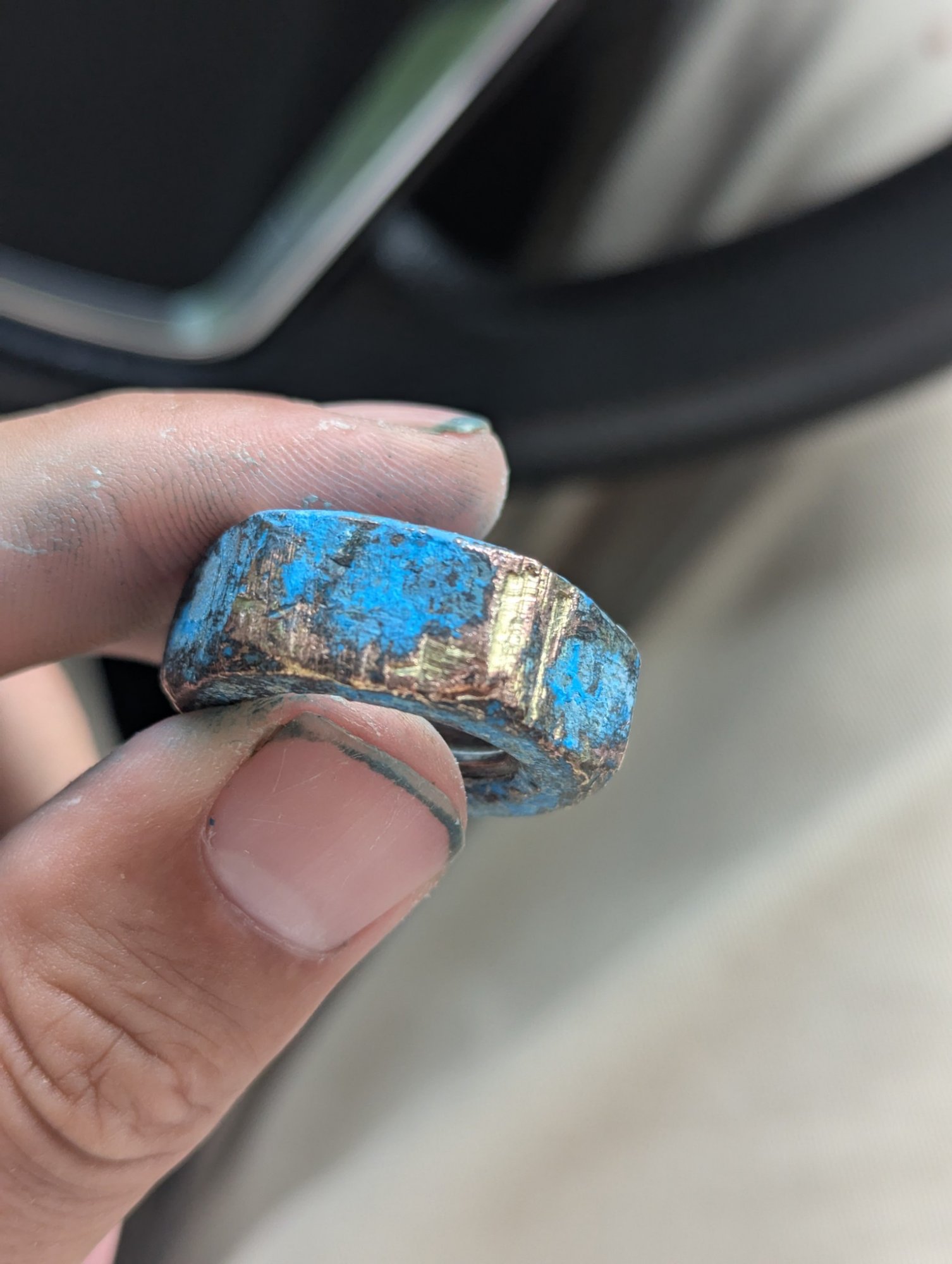

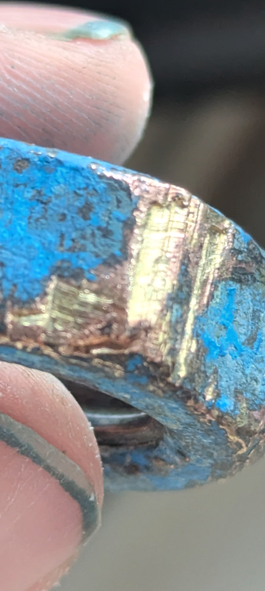

Thank you! I'll do it as you say. The only issue I have now is that I suspect these nuts are brass, and not bronze. When gouged a bit they have a very yellow-golden color as seen in the above photograph.
Thoughts, anyone?
Thoughts, anyone?
It is very unlikely that the nuts are brass. They are most likely bronze. And, do not lubricate the shaft or the threads. The nuts work because of friction and tension on the threads. Lubrication will reduce the friction making it easier for the nuts to loosen, which is what you do not want to happen.
24,926
That pink color on the nut suggest there has been some galvanic corrosion occurring.
Brass has higher malleability than bronze or zinc. The relatively low melting point of brass and its fluidity make it a relatively easy material to cast. Brass can range in surface color from red to yellow to gold to silver depending on the zinc content.
Brass nuts would have malformed with your first attempt to remove the nuts.

It may have worked in my favor as now I can identify these as potentially brass.
Silicon bronze, NOT brass. If someone has been using brass instead of the more expensive silicon bronze, on a boat I was looking at, my offer would drop 50%. Whichever owner used the inferior, cheaper brass, here, may well have done a lot more corner cutting, elsewhere.
