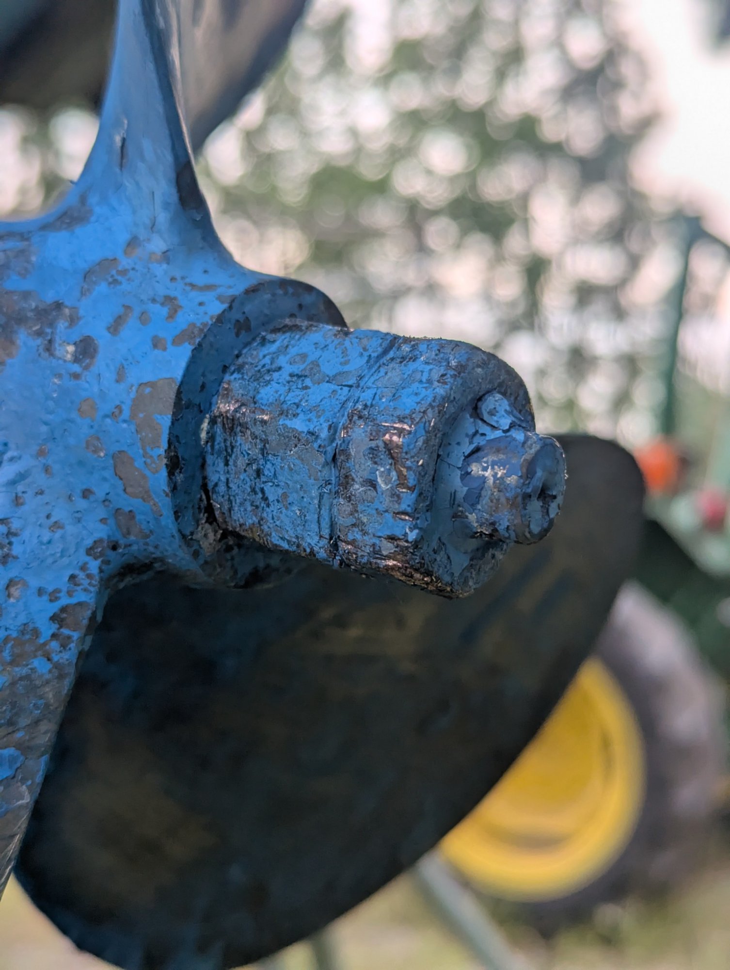

Hey everyone,
I’m working on my 1981 Hunter Cherubini 30 and trying to remove the jam nuts on the prop shaft. I already pulled the cotter pin, and I need to remove the tall nut and the locking nut — but they just won’t move.

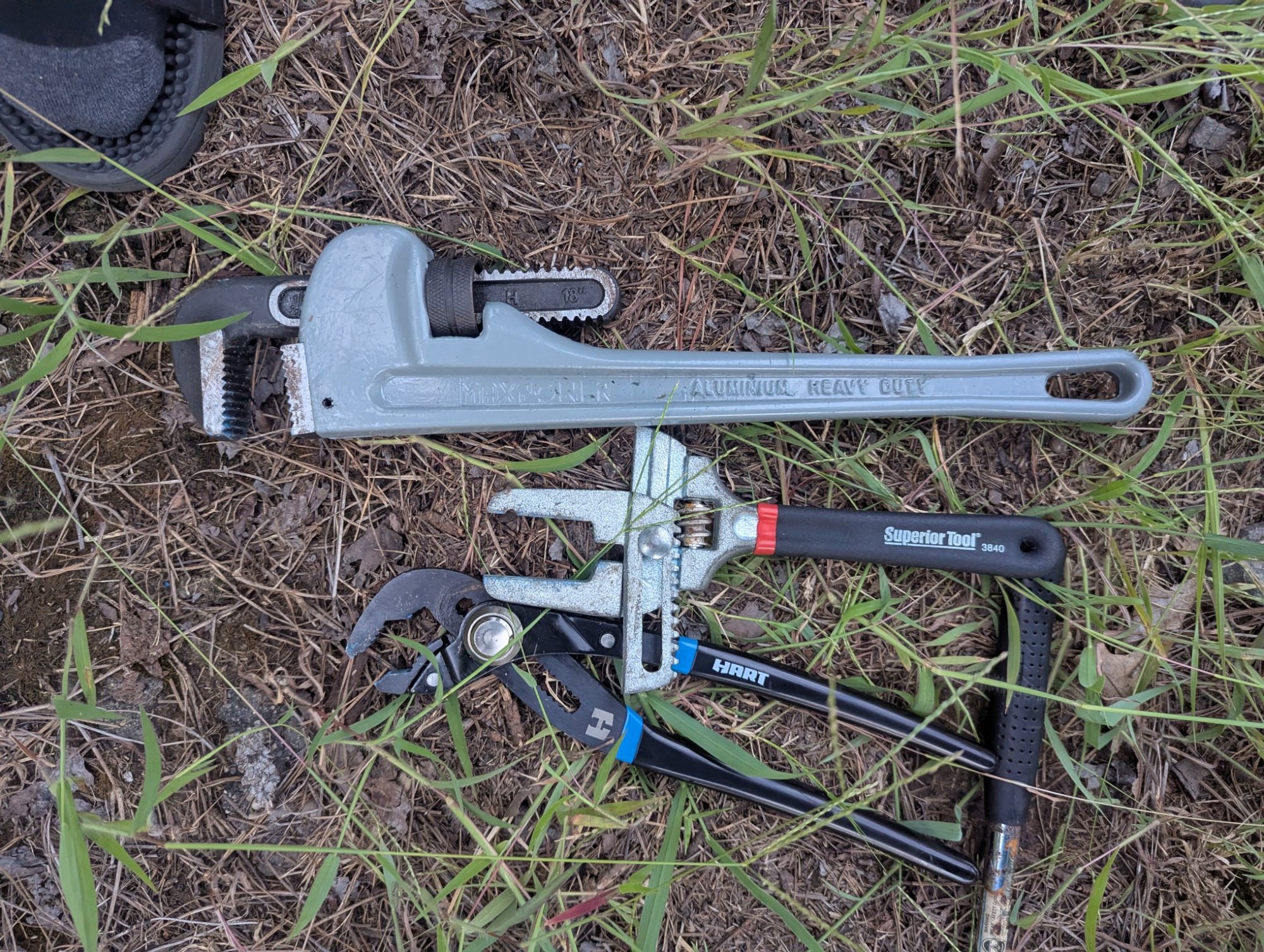

I’ve tried gripping one with a spanner wrench and the other with a pipe wrench, turning counterclockwise, but they won’t budge. I’m starting to damage the flats and don’t want to ruin anything.
Any advice? Heat? Penetrating oil? Am I missing something obvious? Appreciate any help from those who’ve been through this.
Thanks in advance!

I would first remove all of the old bottom paint from the crevices around the nuts and then try squirting in some penetrating oil like pb blaster.

If PB Blaster doesn’t work, head and some long wrench extensions are your friend. You will also need a gear puller just like as with your wheel problem.
14,051
Remove all the paint, penetrating oil, then heat.
Remove the shaft from the transmission and take the shaft with prop attached to a machine shop and have them work their magic.
Is this a bronze shaft or SS? If it is bronze it should come out and checked for wear in the cutless bearing and at the stuffing box. It may be necessary to cut the shaft to get it out of the boat.

I just wanted to switch the places of the nuts, because I know the jam nut is supposed to be on the inside.
Are all these extra steps necessary?
It's a SS shaft.
Why will I need a gear puller? I thought I would just unscrew the nuts and screw them back on in the correct order.
I think Don is thinking you are pulling the prop off….hence the gear puller.
I would try 2 pipe wrenches if you can get one on the thin nut…and as others have said, try to clean the paint off the treads, and use some penetrating oil. You can certainly try heat as well.
Greg
24,615
The prop may not come off easily once you get the nuts free. Puller makes it easier.
About 4 months ago, I couldn't bust loose a spindle nut on a mower deck I had to repair. All the online instructions said the nut could be difficult but it would release. I notice all of them were using impact sockets with either electric or air impact drills. So I went down to Lowe's and found a battery powered impact drill for $70, and got the appropriate impact socket. It was like magic.
Today I was working to remove the wheels on my sailboat trailer. With the biggest wrench I had I could lift the tire off the ground, but couldn't break the lug nuts loose. Went to Lowe's to get impact sockets to fit (13/16") and again like magic, in less than 10 sec the impact drill had spun the lug nut off. Can't say enough good about impact drills when you really, really need to get a nut off. And this is a low end Sears battery model that was on sale. Air powered impact drills are much more powerful.
I do use PB Blaster liberally twice in 24 hours, and try to get the nuts with regular wrenches. But when nothing else works, the impact drill does.
