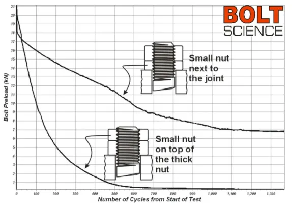

I found the following information, which supports the idea of using the thin nut first and the large nut as a locking nut.
Thanks for helping me rethink the stuff I have always heard that appears to be WRONG:yikes:.
Check out this graph of the bolt preload kN when exposed to vibration cycle fatigue testing.
:wow3:

You got more going on than the tests show on new bolts and nuts.
There is saltwater corrosion. There is likely fastener galling of the nuts and shaft.
You may break the current nuts loose only to replace the prop shaft and locate new nuts to fasten the prop more correctly.
That is something to consider.
If you want to replace the prop and prop shaft, then it is a no-brainer. Rip off the old and start with new and better.
If you want to leave them for a season and check on them next year, then you at least have a base point for comparison. Perhaps 80% is good enough.
