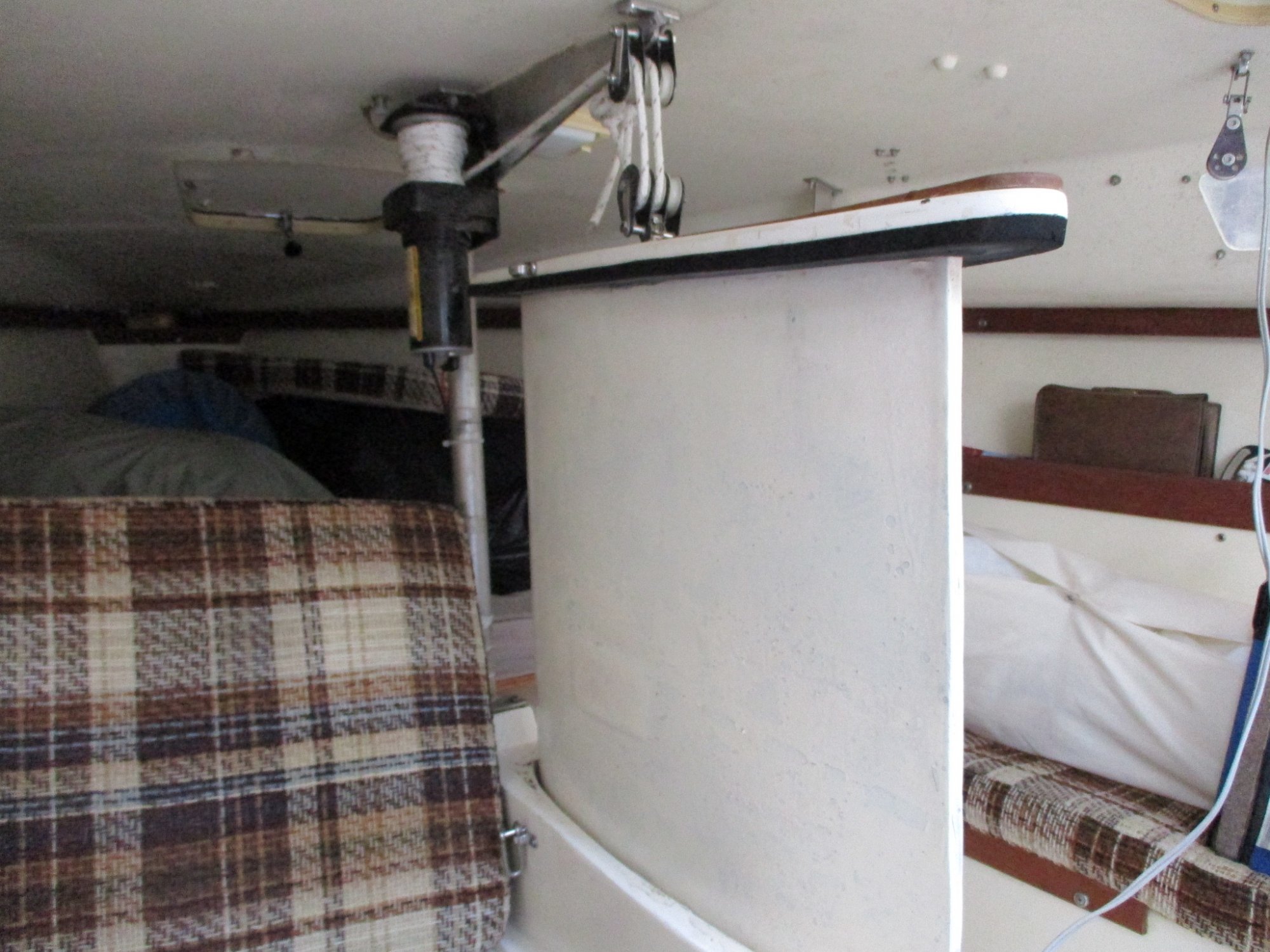

Water does tend to come up the trunk whenever you're moving and the keel is even slightly raised. I made a gasket out of thick neoprene and glued it under the keel cap to cure that.

RussC: Lots of ideas in this one pic. 1. That gasket is much thicker than my 1/8" Tk gasket. TY for the idea. my keel bumps around so much that it easily leaks. 2. I also like the electric winch setup. very tight. Why not run it through the third pulley set to lighten the tension? It would go slower, but I think I would want that. 3. Is the hanging block so you can use the portside winch to raise and lower it? 4. I like the white bags on the seat that is too small to be useful as a seat anyway. 5. I see the shackle next to the forward facing seat on the trunk to lock the keel down. Mine has a hold drilled through the top of the trunk. I had to break out the previous owner's fiberglass job that closed off the hole in the keel to make this work. 6. the cushions are dated. My wife used watered down latex paint to paint over the pastel flower pattern on our cushions. It came out good for us, but I don't see how it would work with yours due to the loose texture. aaaand 7. I like the solid hatch cover. I put a cut up political sign over mine to keep the sun out but this looks better. What did you use? THANKS for sharing this!

1: the top of the trunk is so irregular mine wouldn't seal with the thin gasket. 2: winch is a cheep Harbor Freight atv winch and works great. I had it in the third pulley but it was too slow and the winch has plenty of power on its own. 3: I just never got around to removing the hanging block. figure if the winch or battery ever died....... 4: the "white bag" is my main sail in the cover bag and on the boom ;) 5: are you sure the hole in the top of your trunk isn't where it leaks?? 6: my cushions were in such good shape I just kept them. I like the retro look lol 7: Hatch cover is factory fiberglass.
BTW. you're not missing much by not having a manual. it's about as useful as the directions on a shampoo bottle LOL.

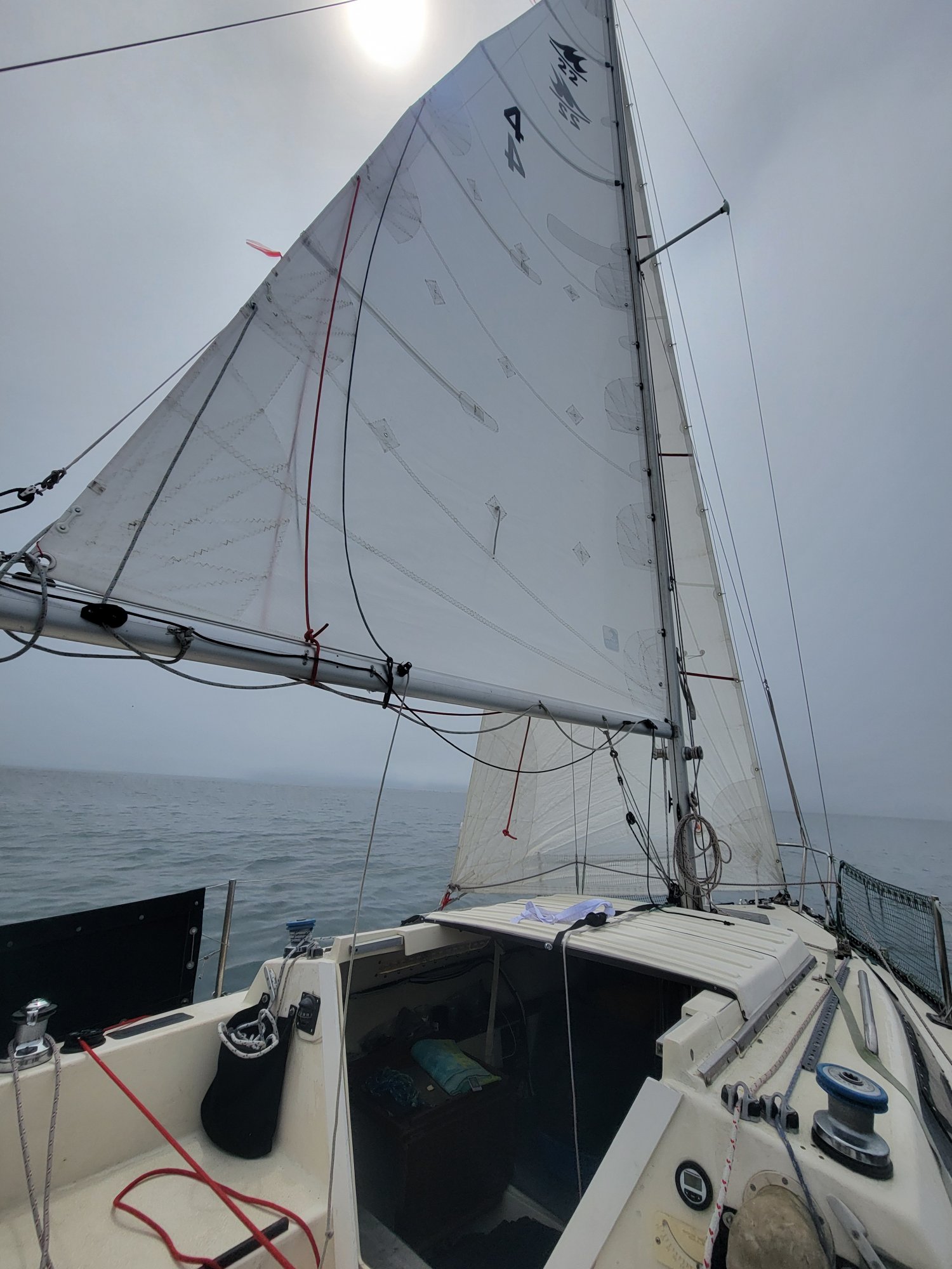

That mainsail needs moar roach. WAY moar roach.......(and foot) ;)
perhaps you missed that it's a factory sail for this boat ;). the Merit 22 has a masthead rig and the jib is actually bigger than the main.

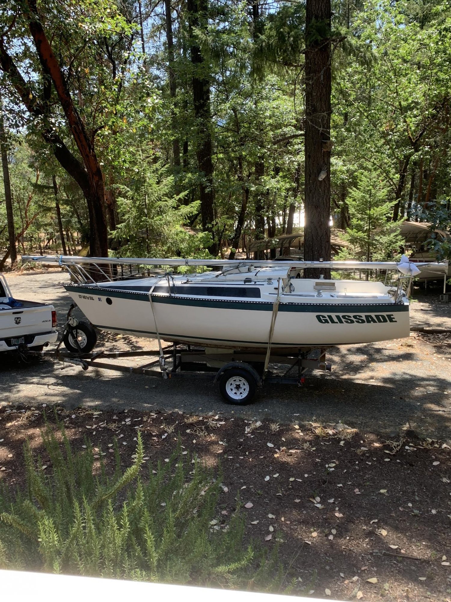

After a four year search I'm finally back in the game!! I've continued to sail my Mac25 for the past 10 years but I've regretted selling my Merit22 from the day it went out the driveway 4 years ago, which is about when I started searching for another one to replace it. The Mac is a comfortable camper, but it's loaded down and not really equipped to race. after entering my first sanctioned race two weeks ago I really got motivated to get something a bit more competitive again. as fate would have it, one just happened to come along that I could work a deal for. needs lots of work, as most boats of this vintage do, but the important stuff is there. came with 6 headsails from 100% - a massive mylar 150?, two mains, three spinnakers and one reacher (think assm spinnaker). all sails are in good to excellent condition. also came with a nice 5hp Merc (Tohatsu) 4 stroke motor and an assortment of goodies common to used sailboats. Russ is a hAppy, hAppy boy:). might take a month to get her back in shape to sail after sitting since 2013 but that's ok.

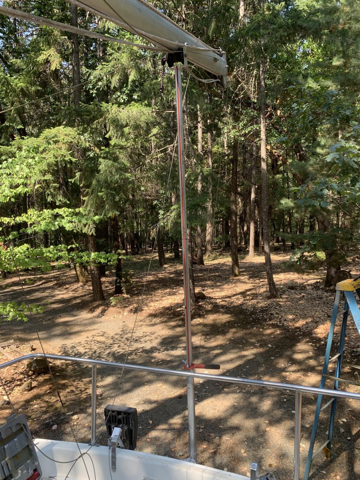

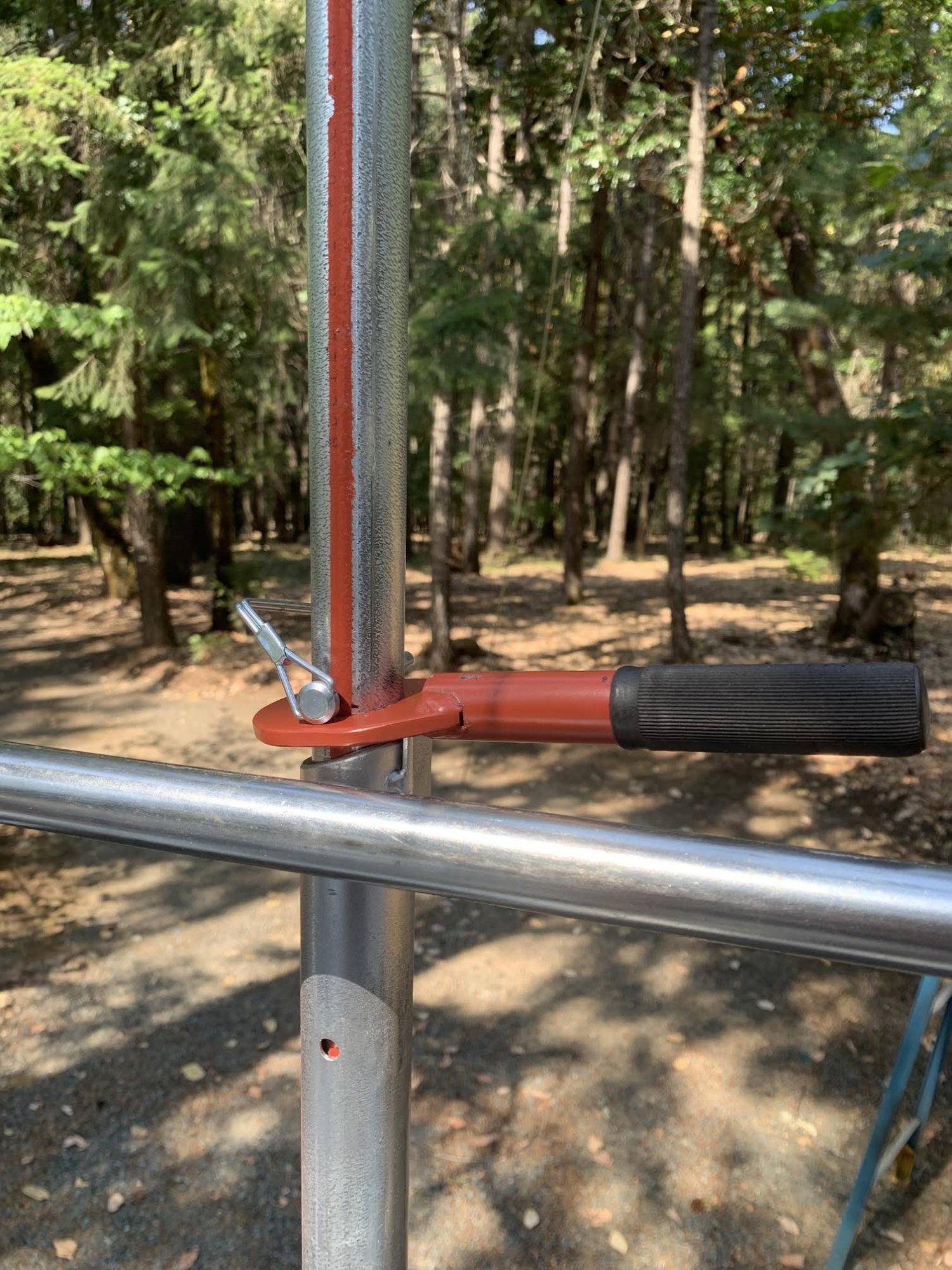

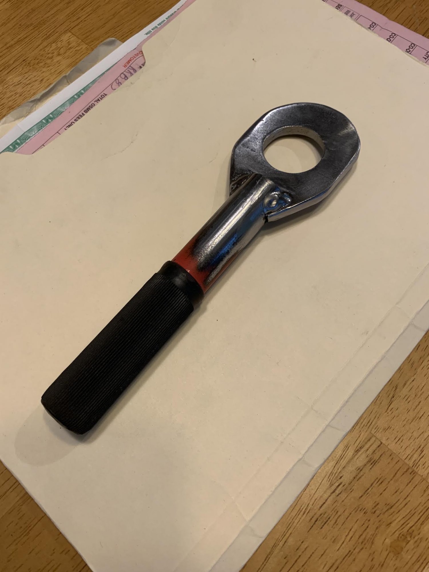

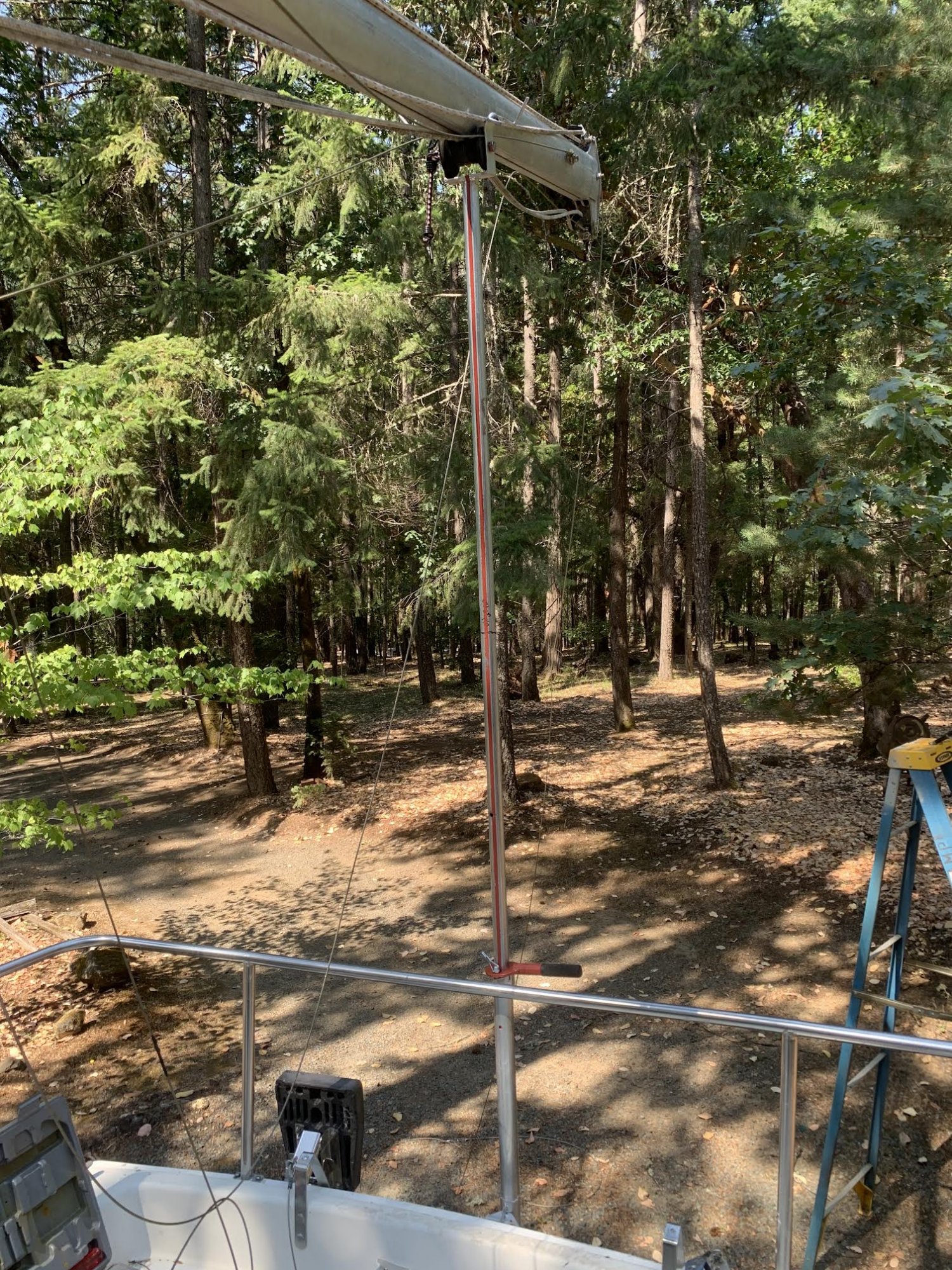

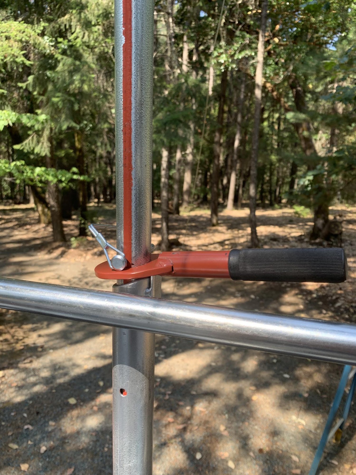

I've always been a trailer sailer so anything that makes my life easier/faster regarding setup and breakdown.. I'm in. today I fabricated a devise to get the mast raised higher in the crutch, which makes raising the mast that much easier. the past 4 years, since my wife passed, I sail solo so this will be a big help.
