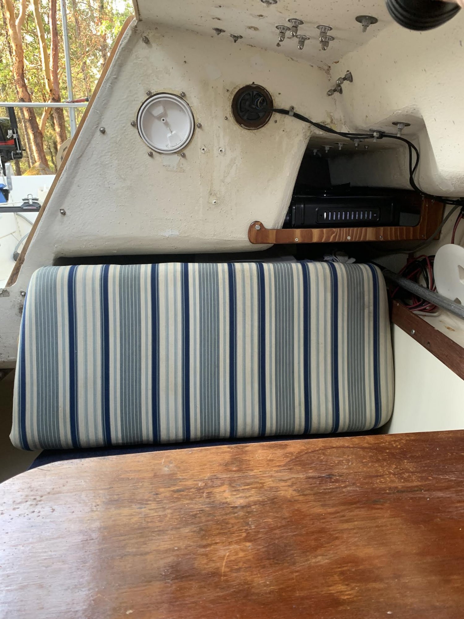

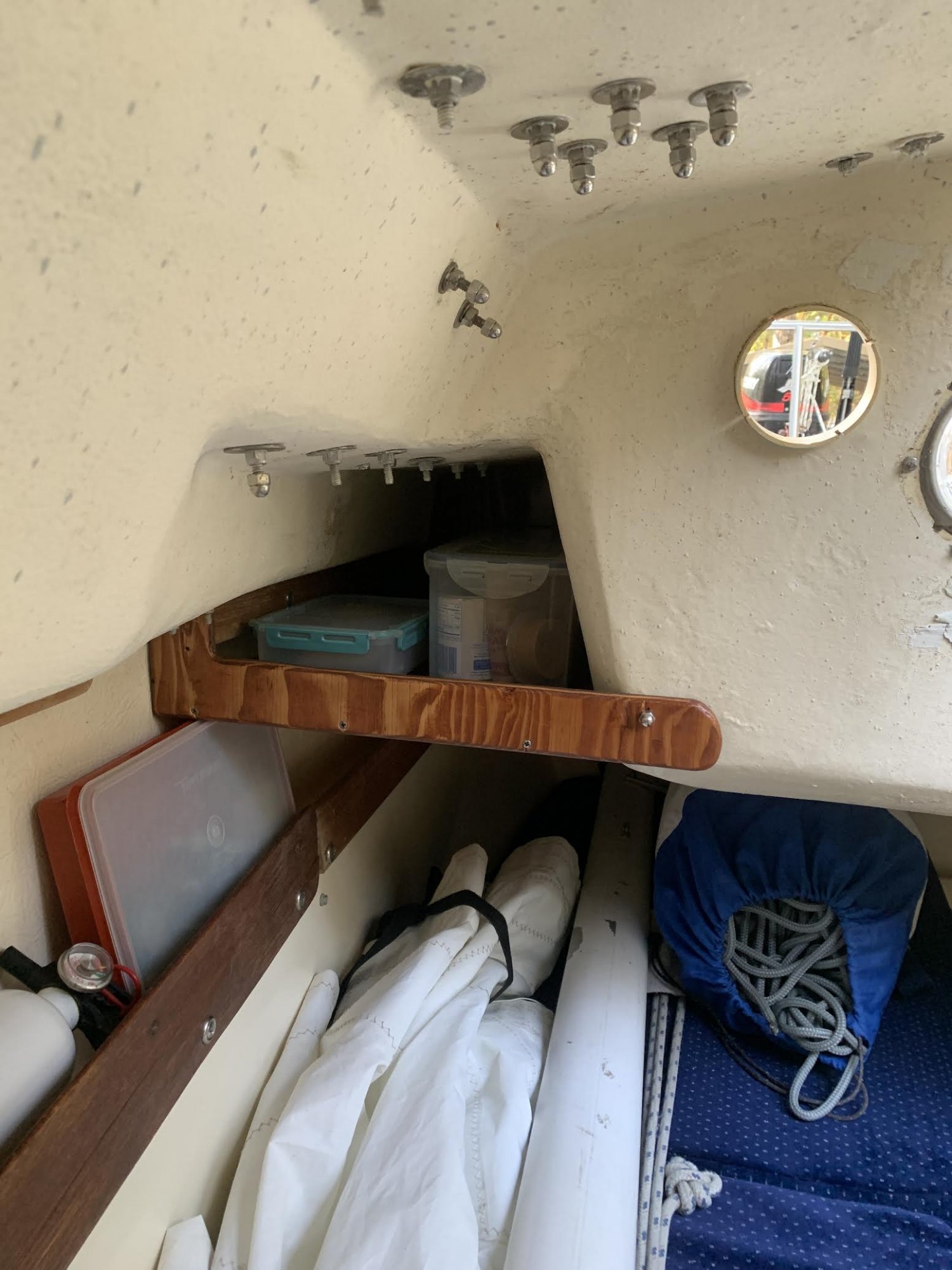

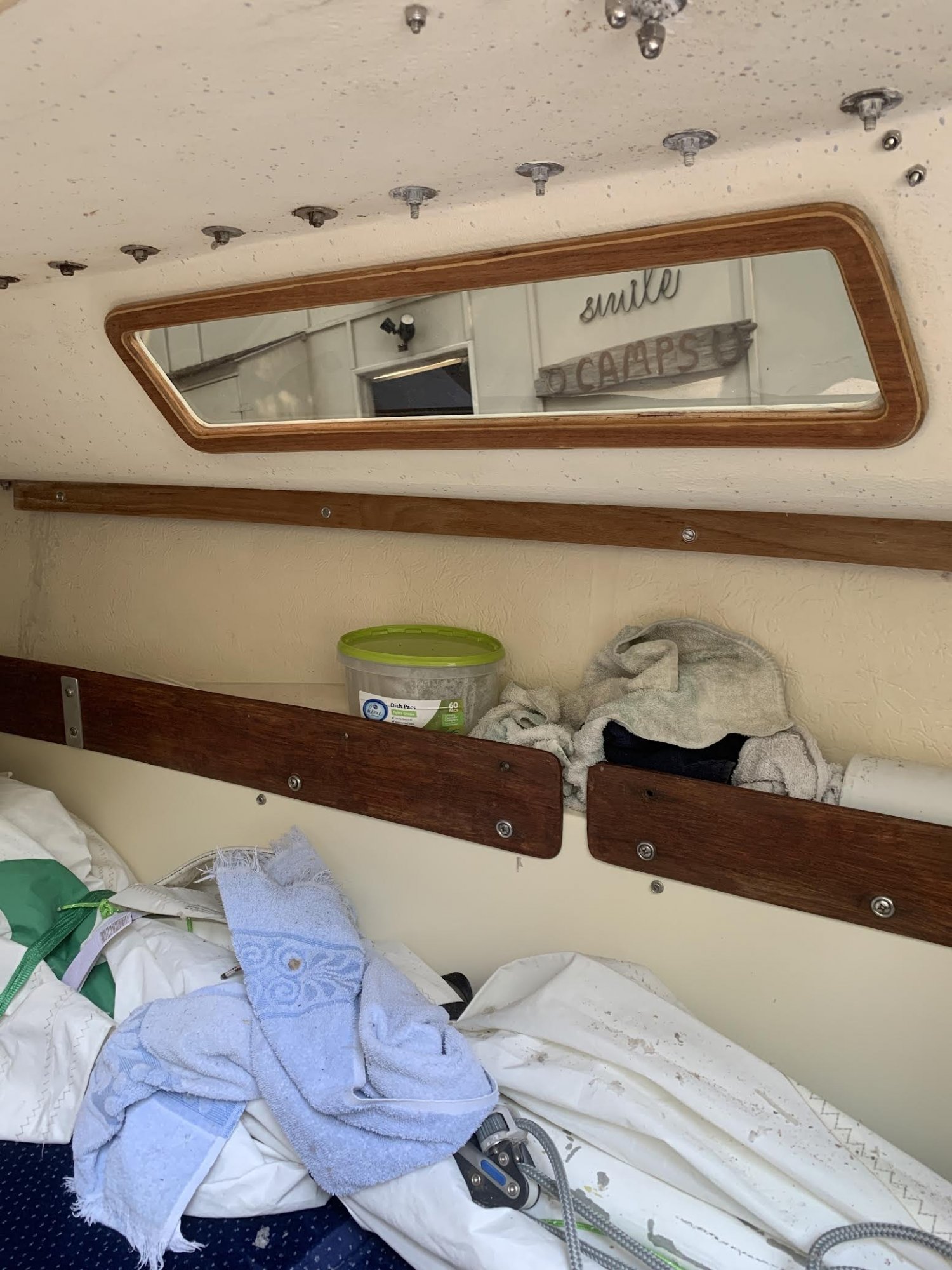

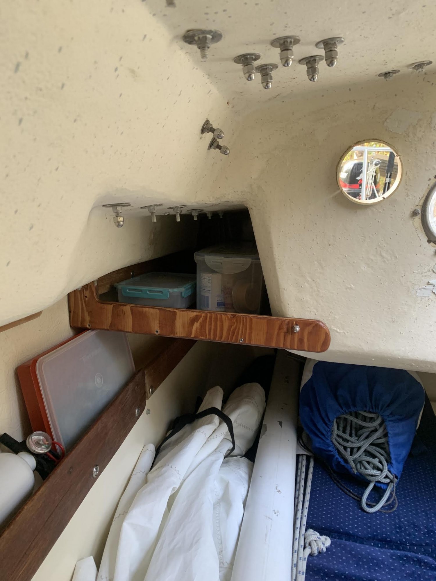

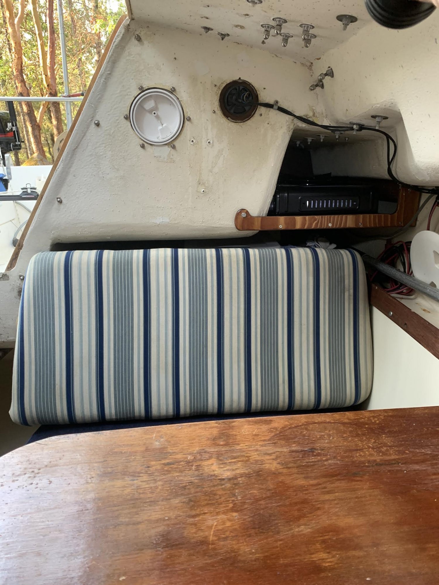

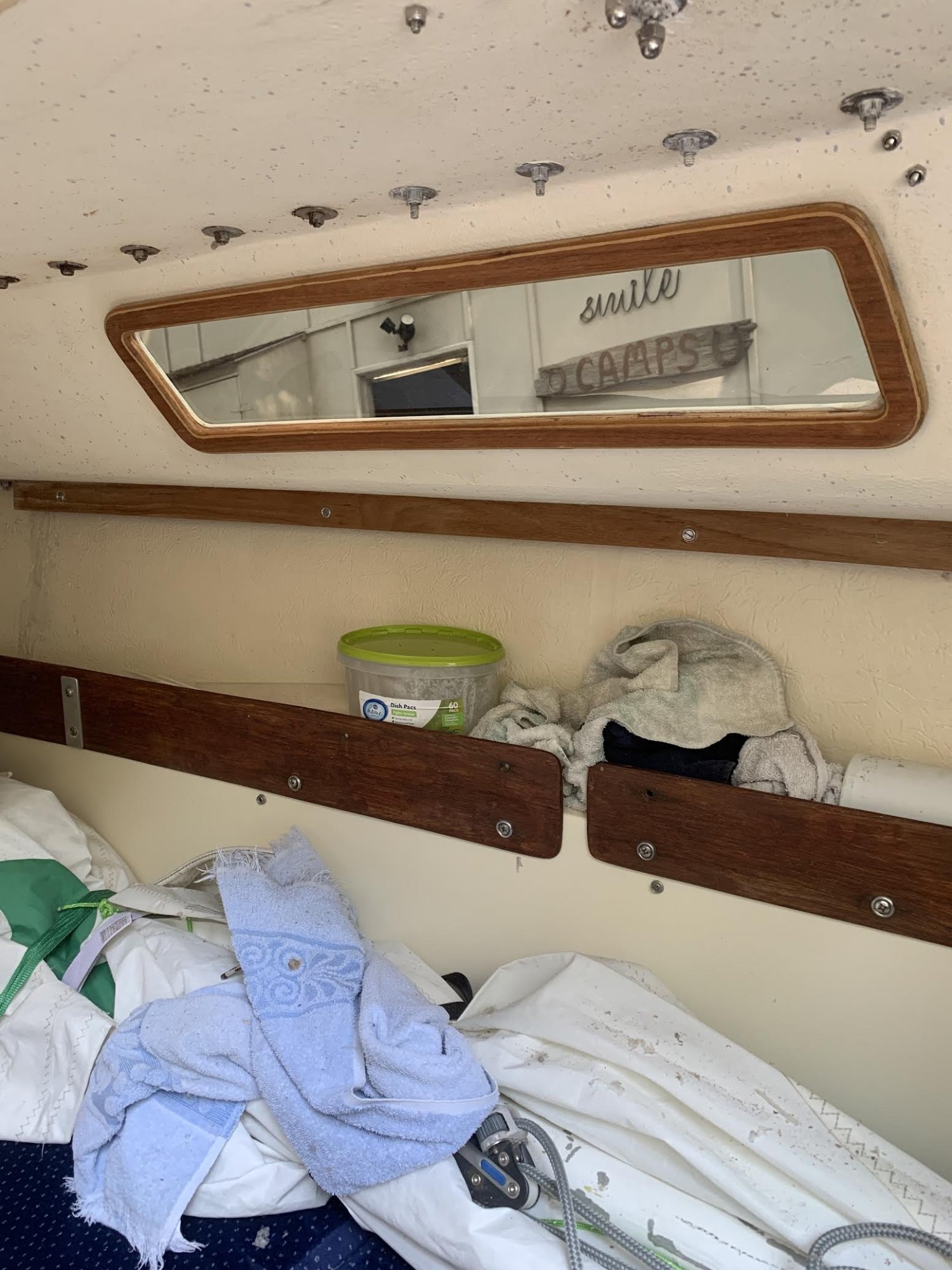

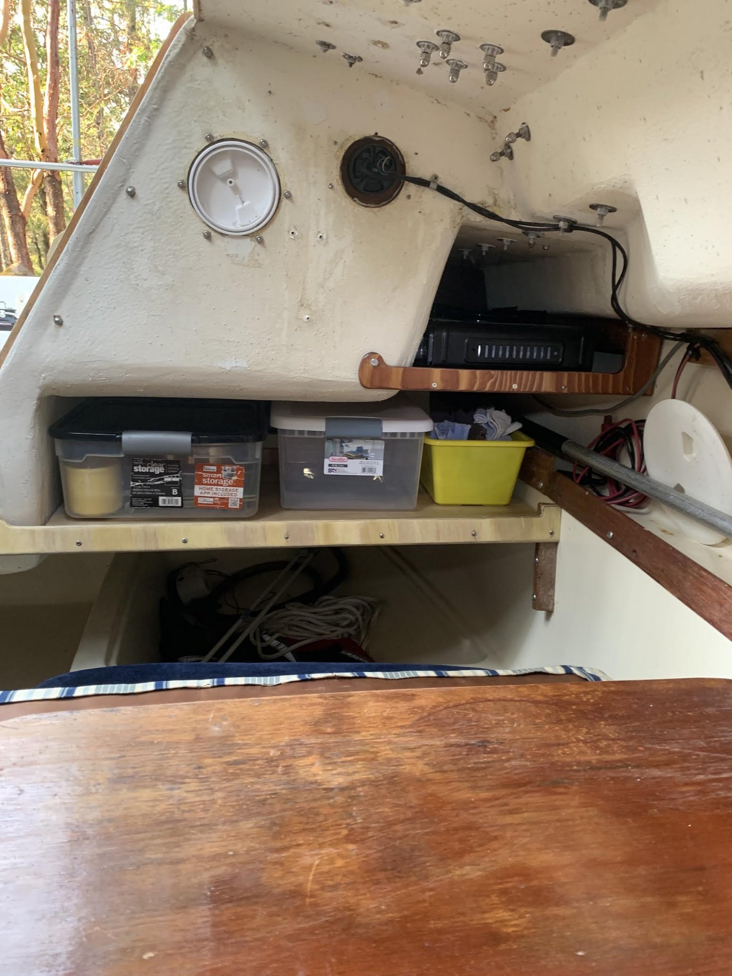

project for the day (or two). I love the clean and dry storage Merit provided under the cabin cushions but it seems like there's always sails or other stuff on the cushions that makes access more difficult. time for some shelves and cubby holes to stash often used items. plastic tubs keep everything dry, clean, organized and accessible. :thumbup:

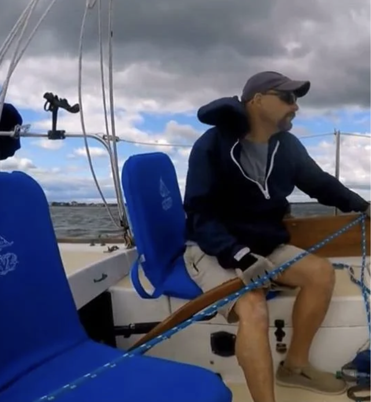

Russ. I like the "Sport-a-Seat"
View attachment 233821 View attachment 233820
Comfortable, movable, lightweight.
WM sells a cheaper version of this seat.
I bought the original from Sport-a-Seat in 2016. It is still working flawlessly.
I have a couple of these that were on Papillon when I bought her in 1998 and have provided comfort ever since. In fact, john, I think your bum has benefited from them.

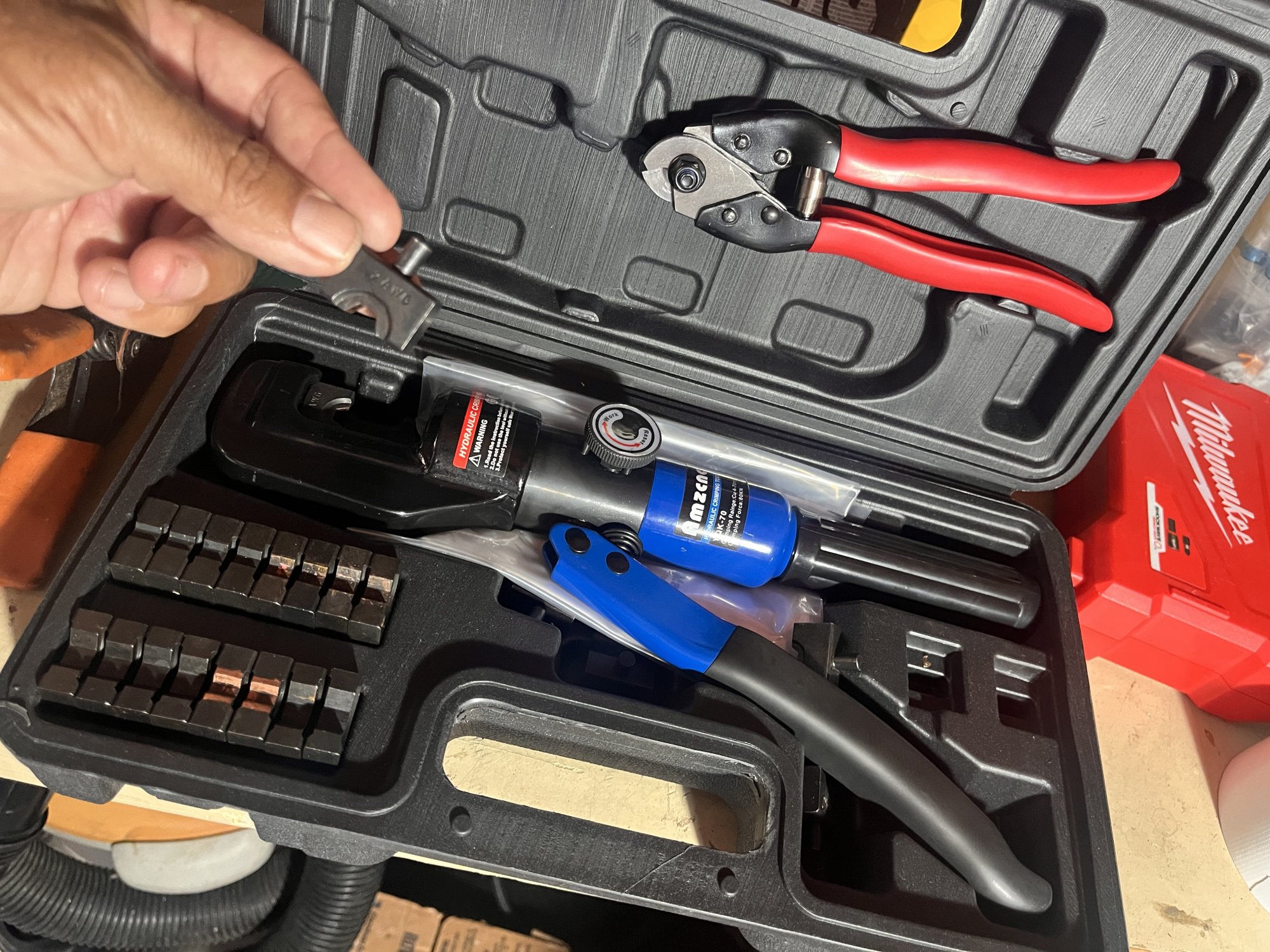

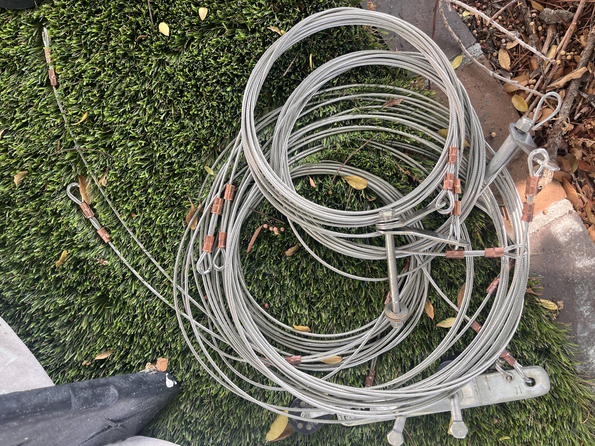

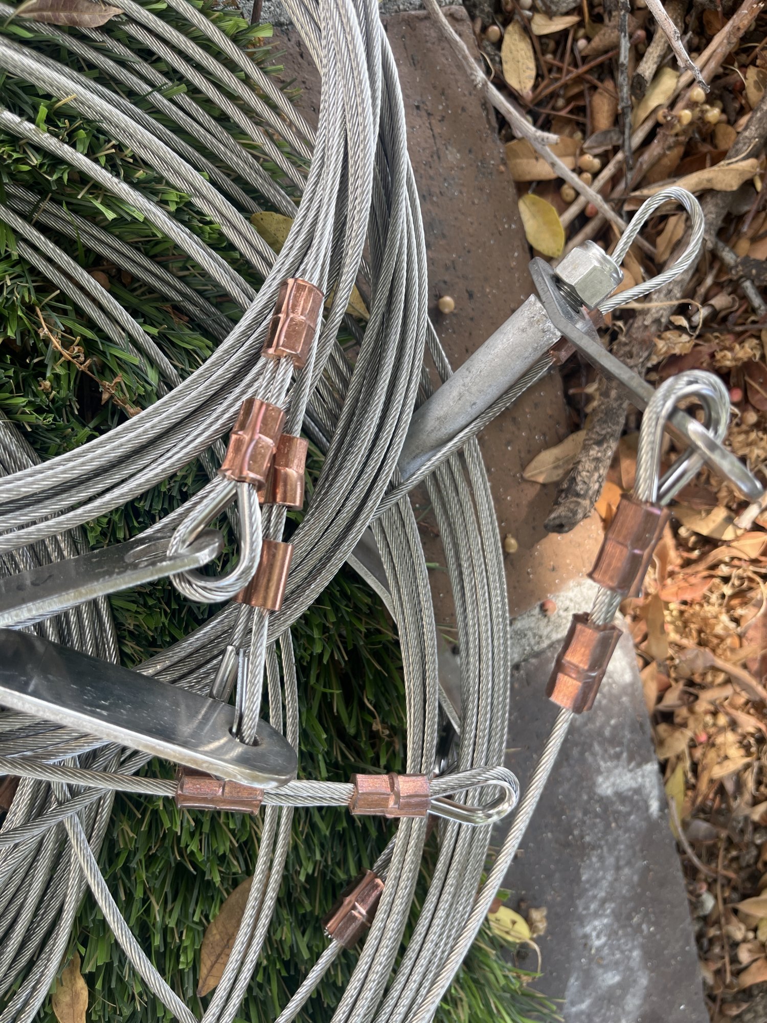

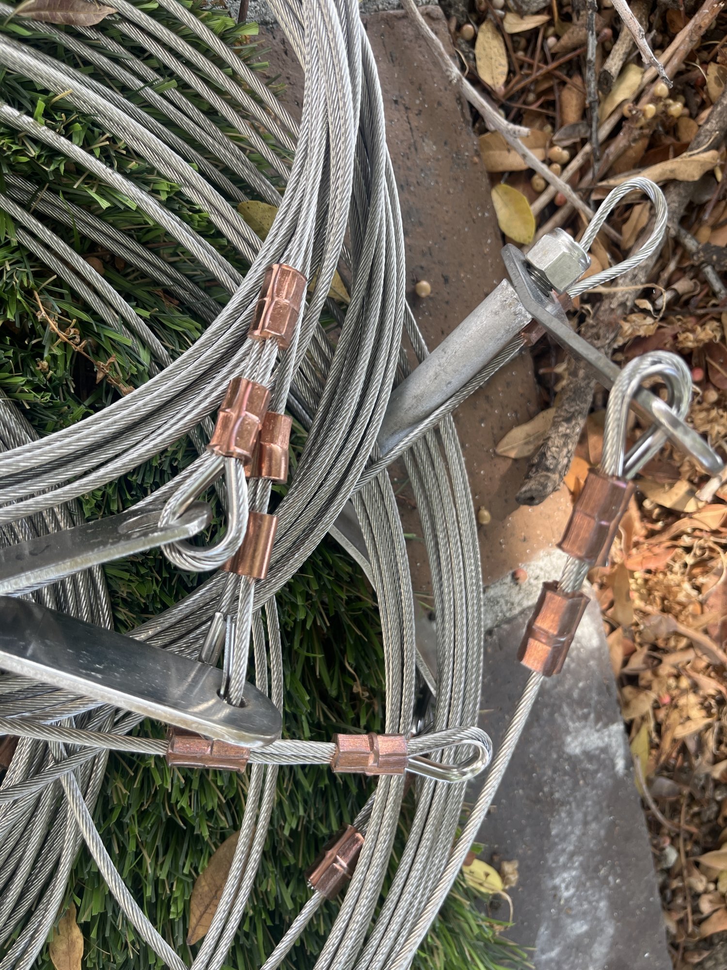

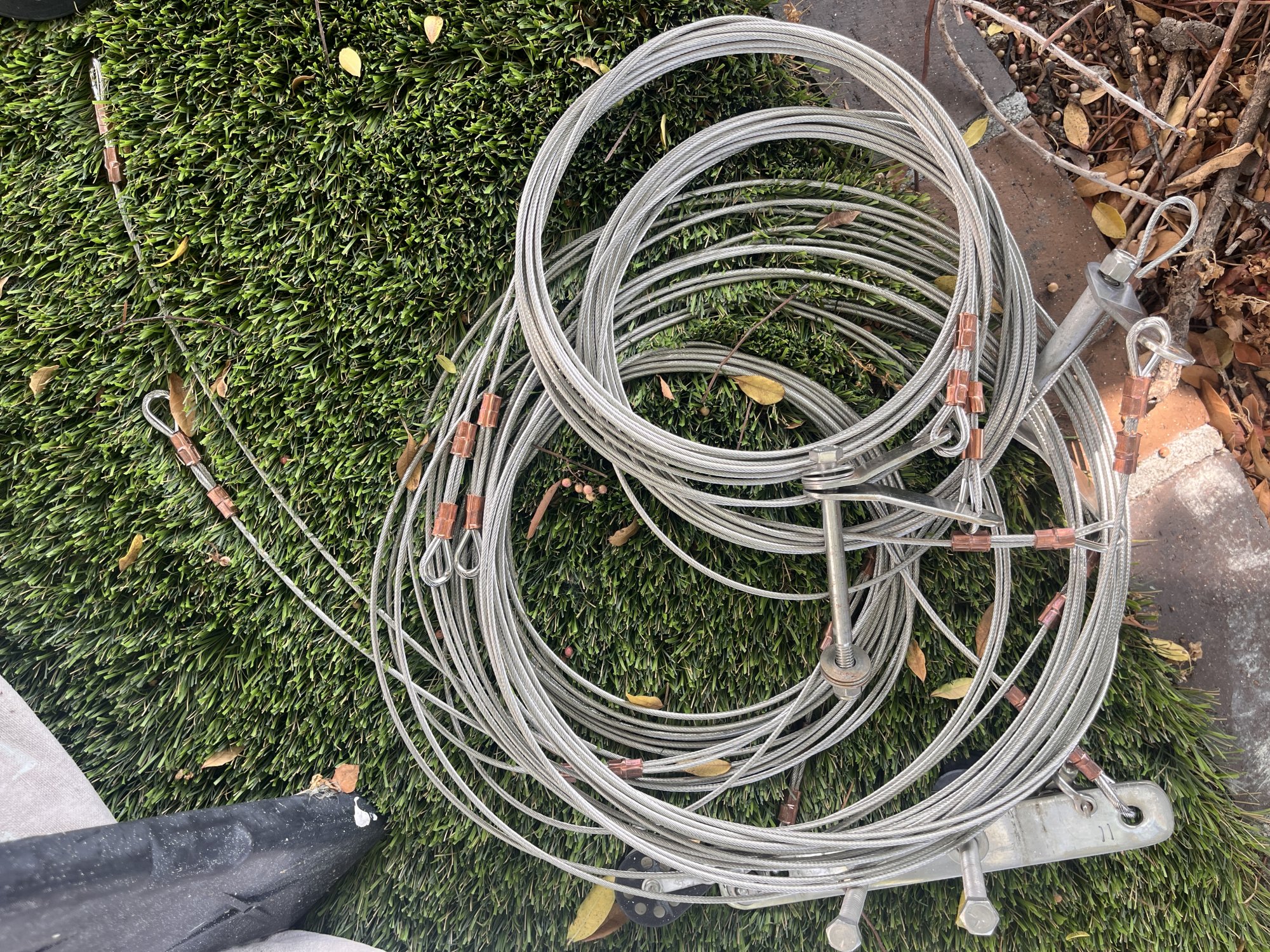

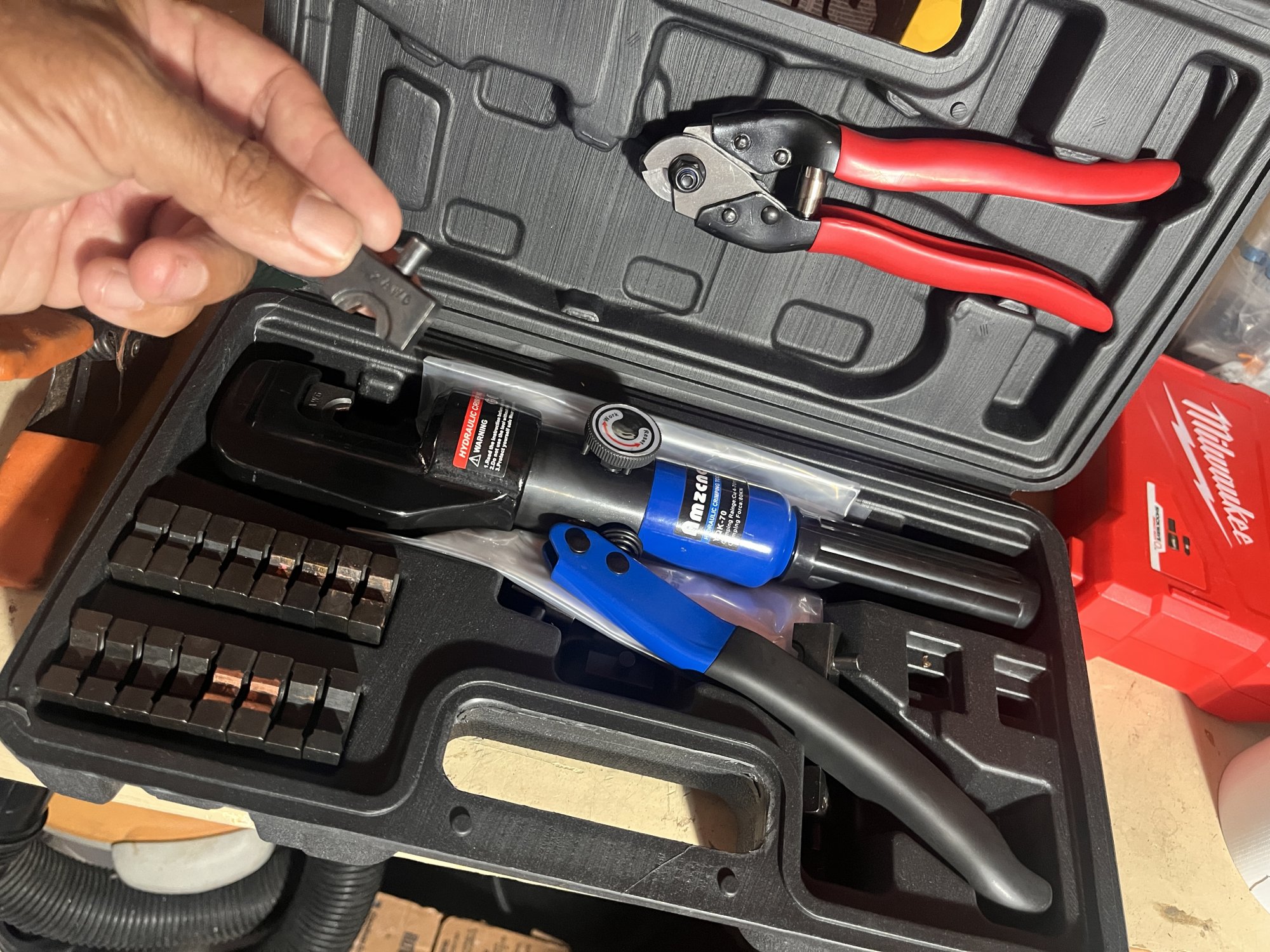

Here are some pictures of my cramps and cramping tool. I used the two AWG die and got two cramps per copper crimp. I screwed up twice and had to remove for copper crimps, using a metal grinder and a screwdriver and a chisel and confirming no damaged strands. It was a little challenging getting the crimps off, but I saved the wire that way.

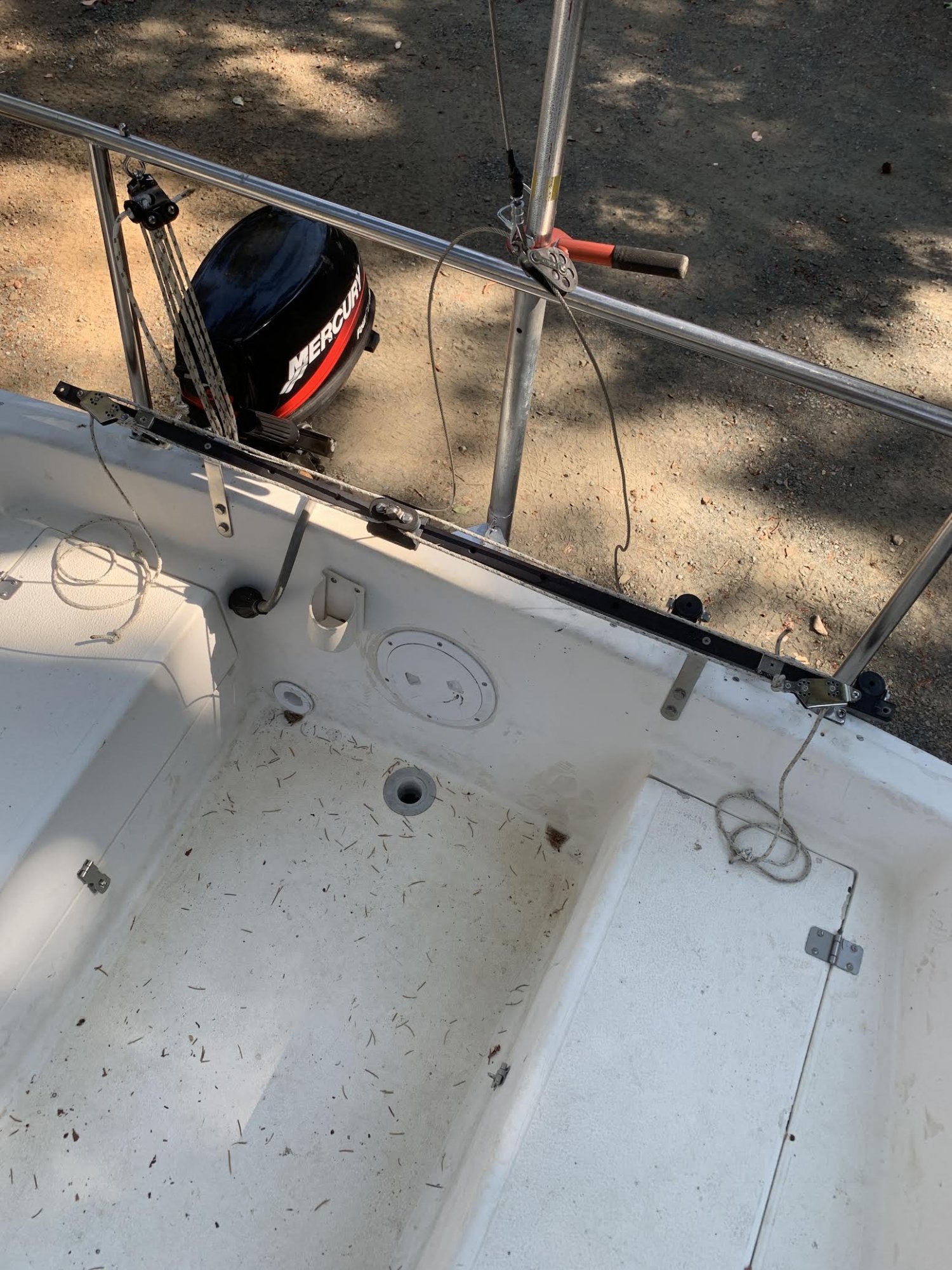

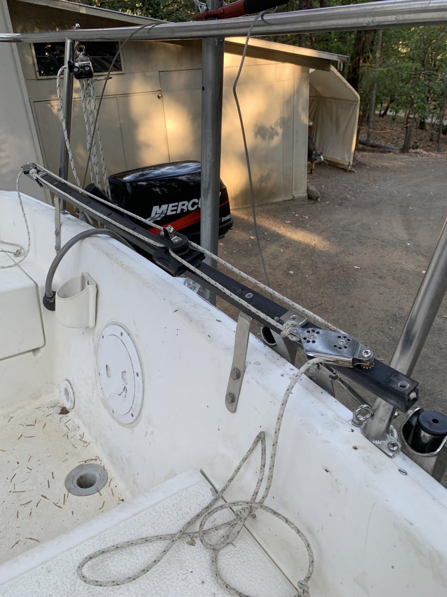

Well I've gotten in five very full days of sailing Glissade so far and I seriously put in the effort to work in unison with the mid cockpit traveler setup. nope... ain't gona happen. PITA. as fortune would have it however, this boat must have come from the factory with the transom mounted short traveler and converted somewhere along the line later in life, as the brackets were still on the transom also. after some daytime head scratching, and a few nightmares, I concocted a way to use the mid mount traveler bar and existing hardware on the transom mount brackets. If for some reason I'm not happy with it, there was no cutting or major alterations that would keep me from moving it back to mid mount but by just taking it for a spin around the driveway I'm pretty sure this new configuration is gonna make me a lot happier sailor. after placing the cleats on the bar ends, along with the new traveler stops, it reduced the travel somewhat but 32" of travel still remain so I'm happy with that. Now I'm just waiting for a good weather forecast day below 100* to test it out. fingers crossed. :)

Russ how does the tiller to the rudder work. Does it come in beneath the traveler?
Yes. but I did have to add a 1" spacer between the bar and the brackets, to allow clearance for the tiller tamer knob when installing the tiller.;)
24,943
It looked tight in the image. I loved the tiller tamer.
It looks like a great solution if you can feel comfortable with the controls. However, it will require pulling the control lines blind while you look at the sail, or a lot of head turning.

Merit 22- Oregon lakes
Time will tell but it can't be any worse than straddling that dang bar mid cockpit all the time. plus the traveler won't be in constant use for my typical sailing. I figure it's worth a try anyway.

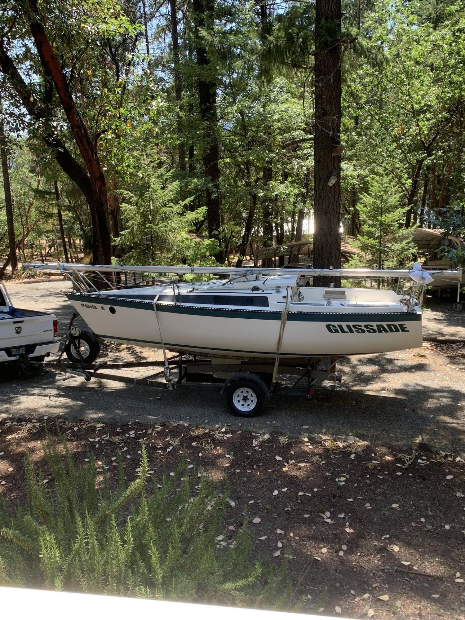

After a four year search I'm finally back in the game!! I've continued to sail my Mac25 for the past 10 years but I've regretted selling my Merit22 from the day it went out the driveway 4 years ago, which is about when I started searching for another one to replace it. The Mac is a comfortable camper, but it's loaded down and not really equipped to race. after entering my first sanctioned race two weeks ago I really got motivated to get something a bit more competitive again. as fate would have it, one just happened to come along that I could work a deal for. needs lots of work, as most boats of this vintage do, but the important stuff is there. came with 6 headsails from 100% - a massive mylar 150?, two mains, three spinnakers and one reacher (think assm spinnaker). all sails are in good to excellent condition. also came with a nice 5hp Merc (Tohatsu) 4 stroke motor and an assortment of goodies common to used sailboats. Russ is a hAppy, hAppy boy:). might take a month to get her back in shape to sail after sitting since 2013 but that's ok. View attachment 232840View attachment 232841View attachment 232842

Finally got a decent wind and weather forcast to try out the new traveler location. WOW. It feels like a whole nother animal now. SO much easier to sail solo now that I have the freedom to quickly mover about in the cockpit. I did loose some vertical boom control on the downwinds but that just means I’ll have to dust off my extra boom vang. No biggie. Even without a vang on my test voyage I easily held my own (aka passed them) against other boats I encountered during the day. Ya… I’m falling in love with this boat again. Now if my crisp new jib sail would just get here before its time to pack it in for the summer……………

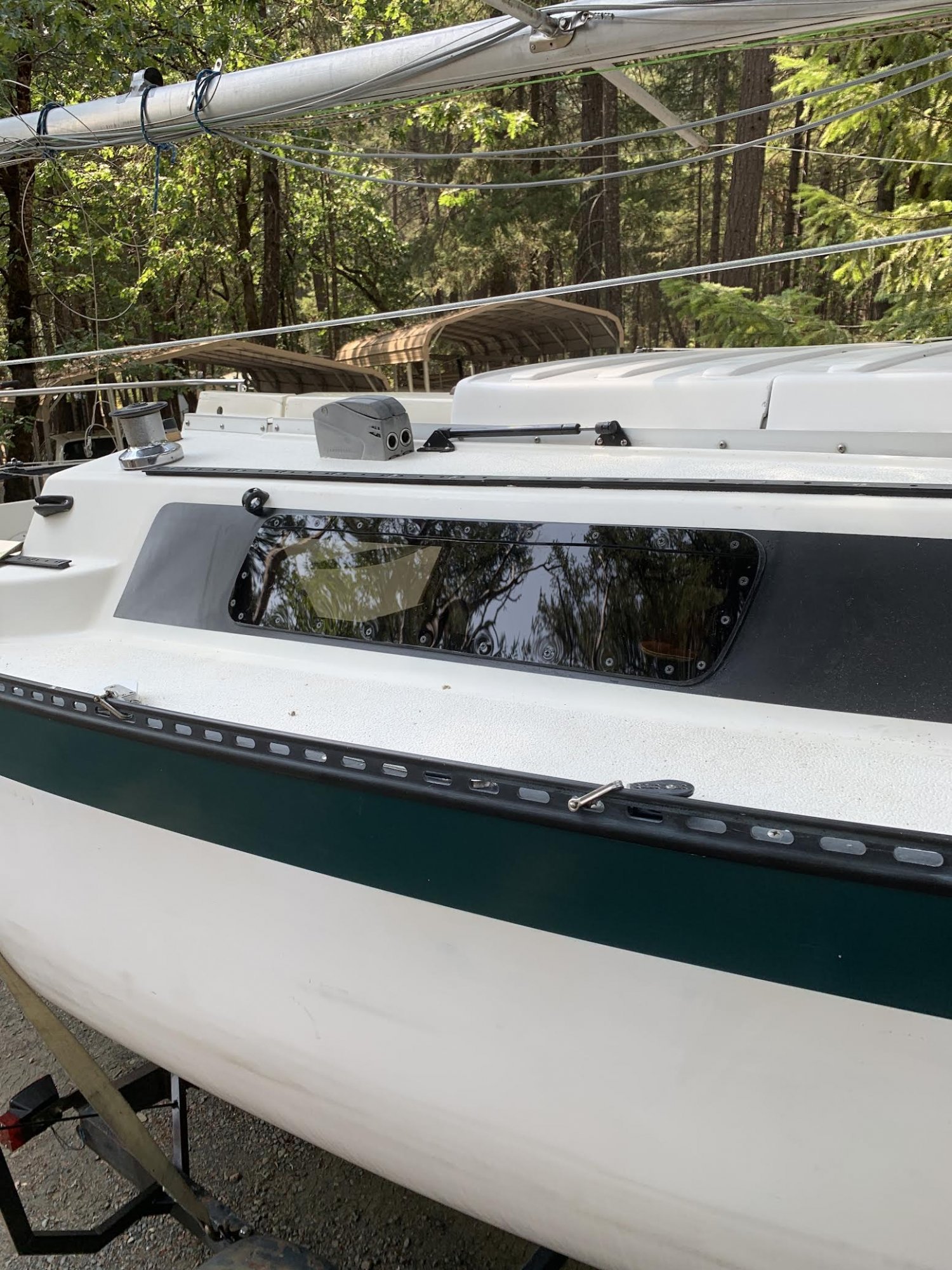

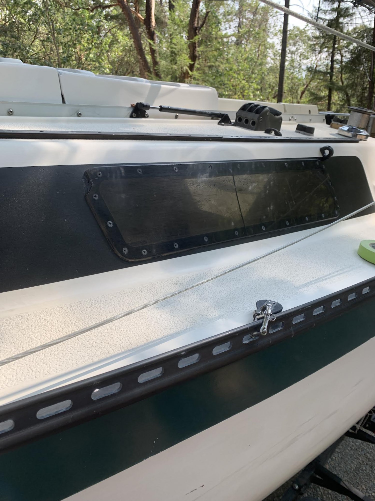

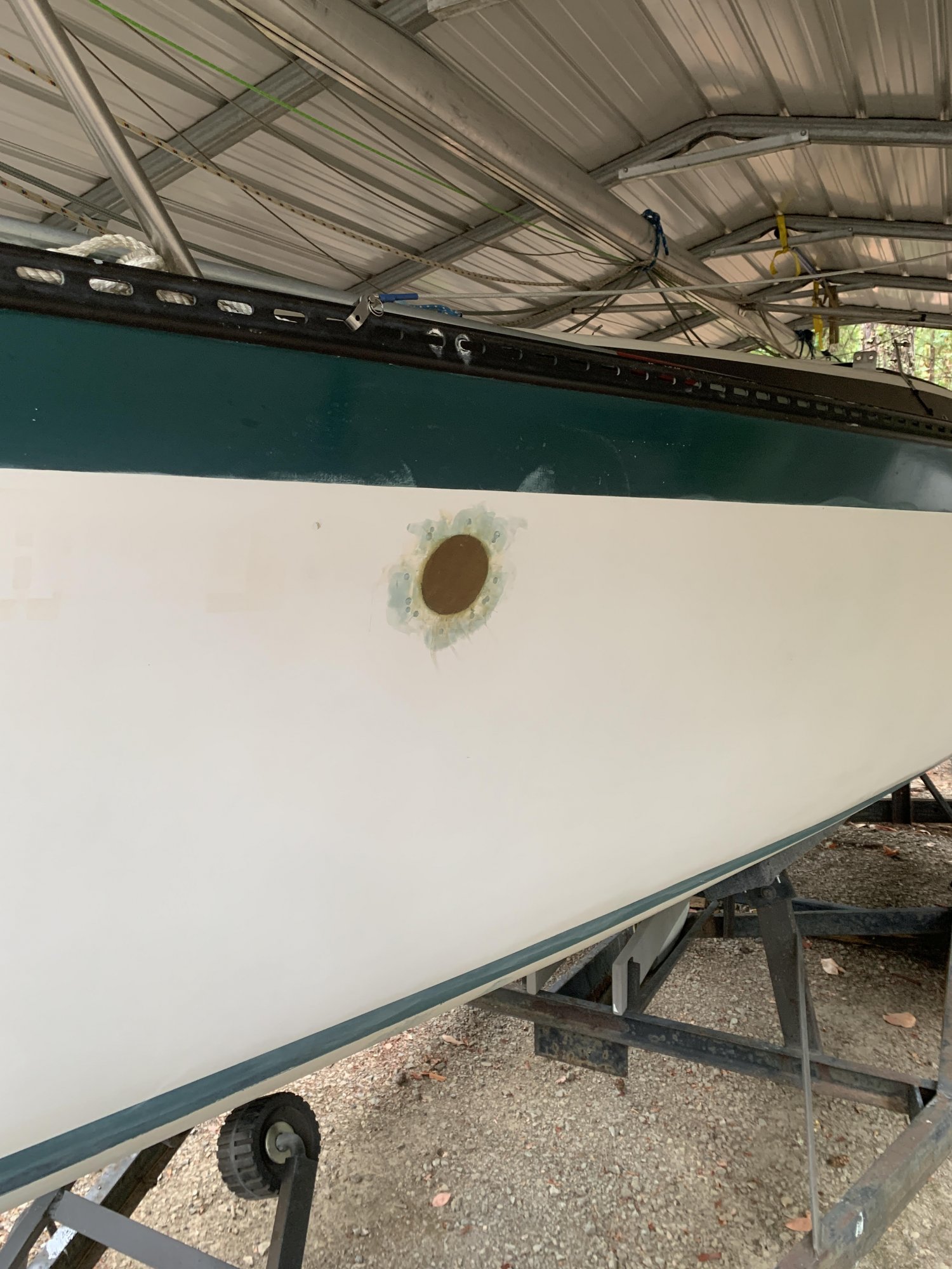

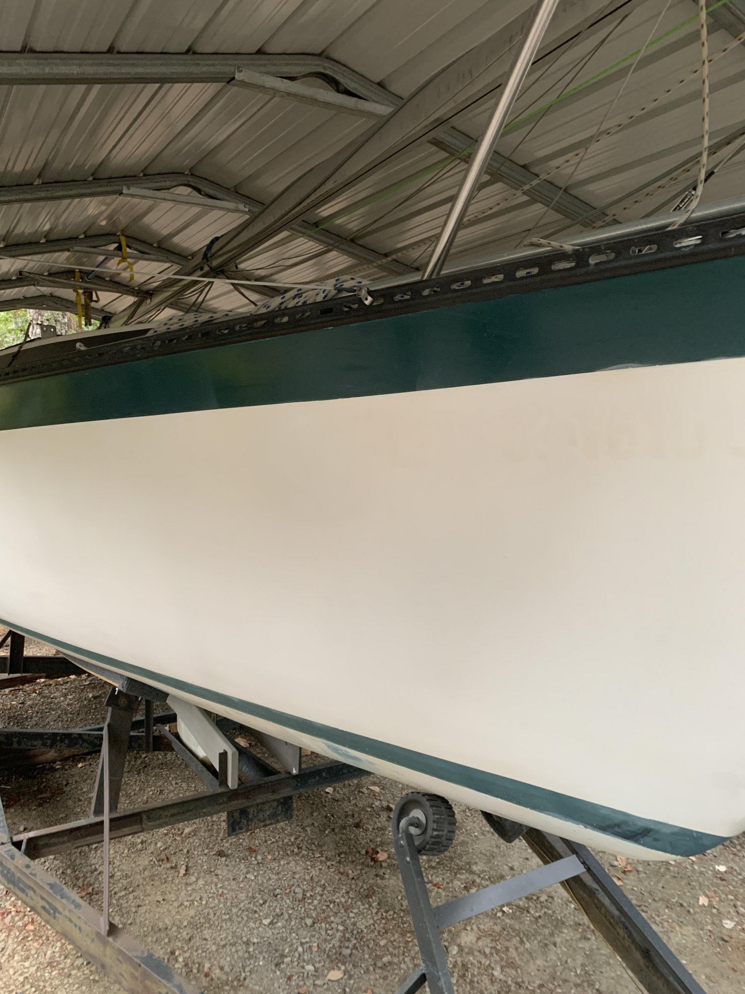

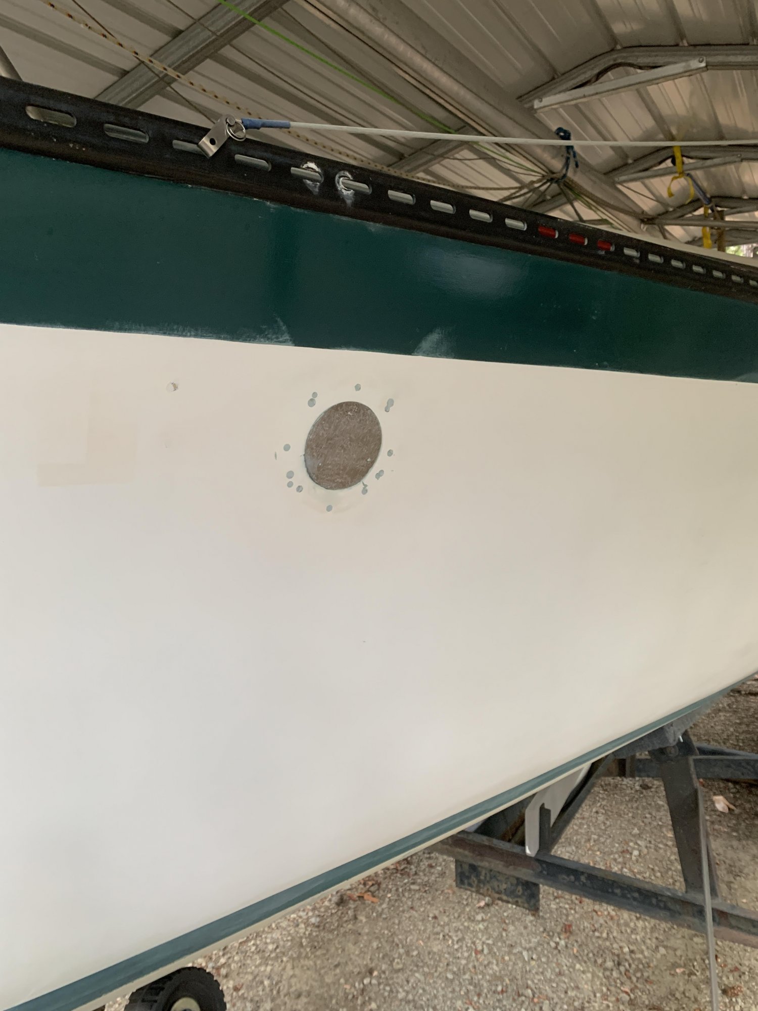

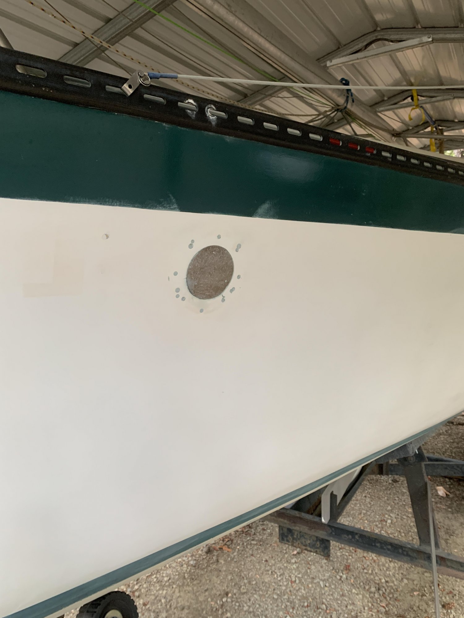

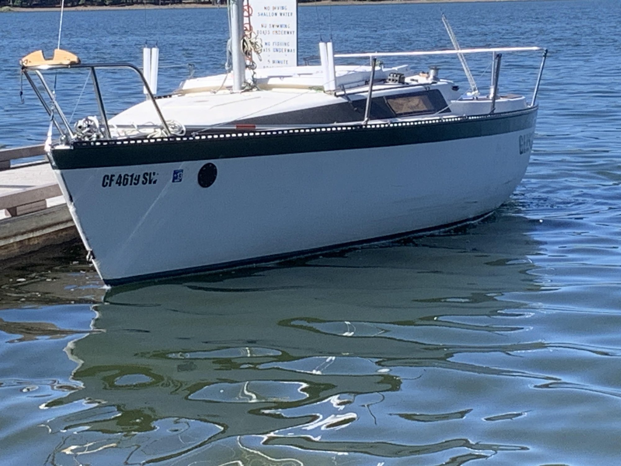

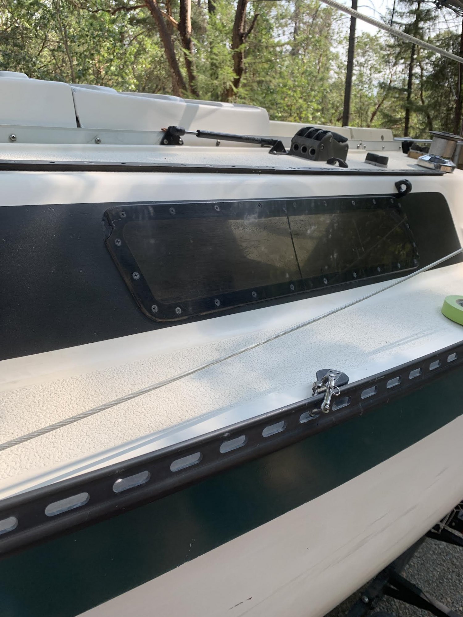

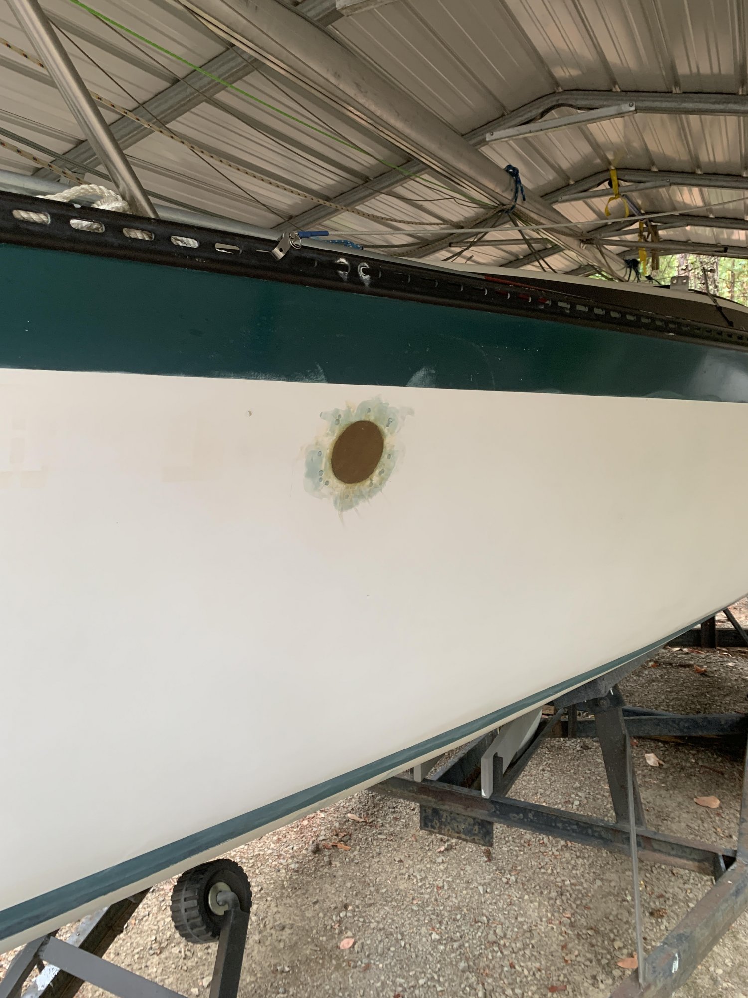

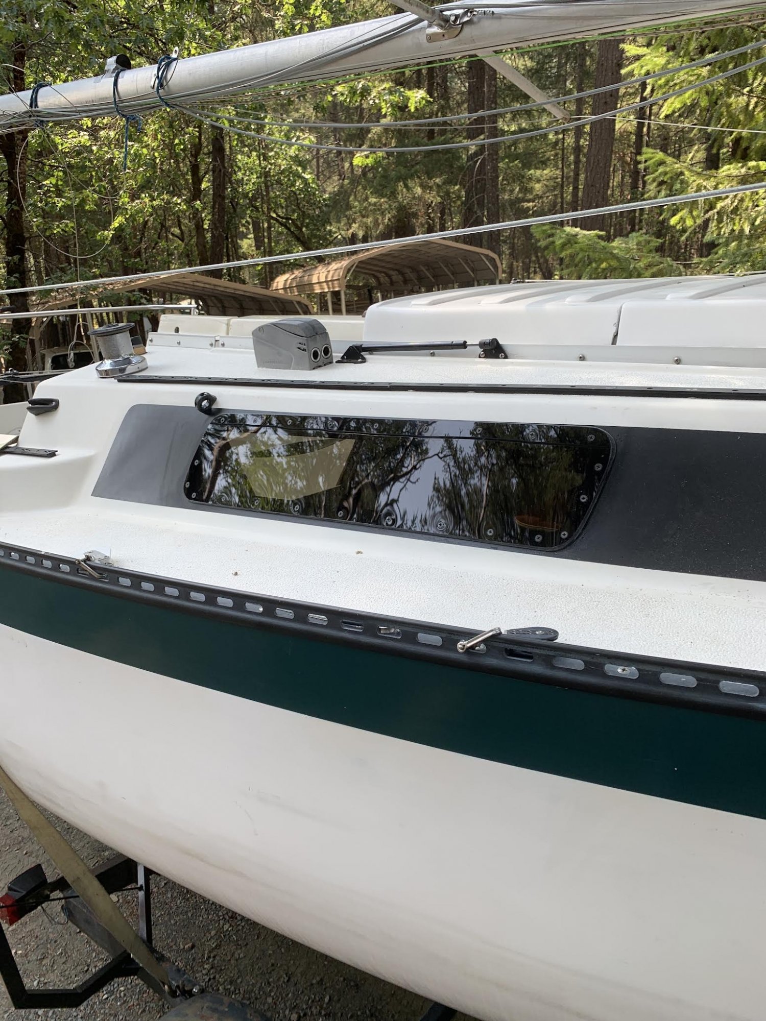

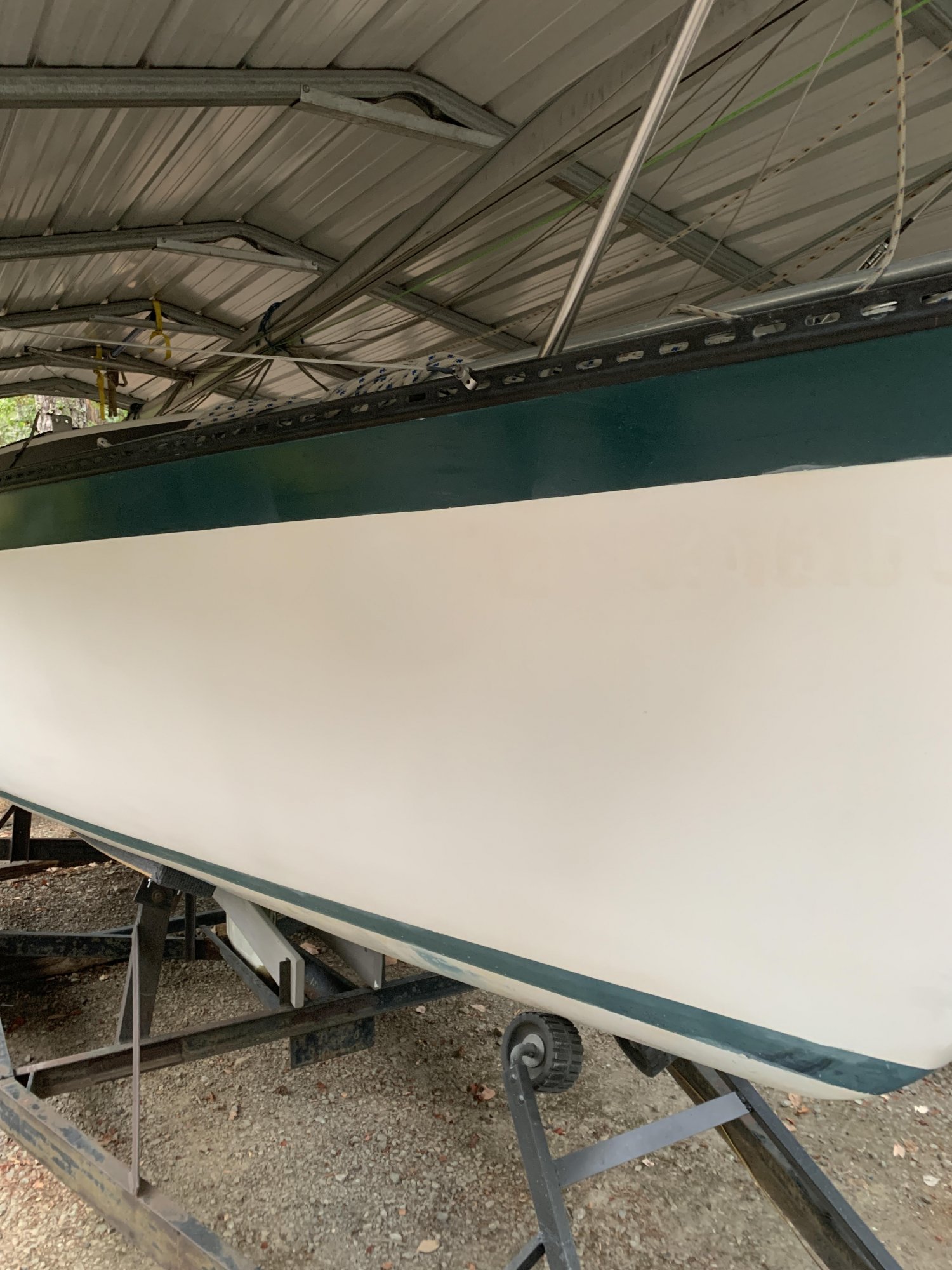

Ya find the strangest head scratchers when you buy a used sailboat :rolleyes:. a po had drilled a 3 1/2" hole in either side of the bow and screwed on a plexiglass "window" over it. not sure of the true purpose but I wanted it to go away so it got glassed in today, screw holes filled, sanded and painted. it's now disappeared :cool:.

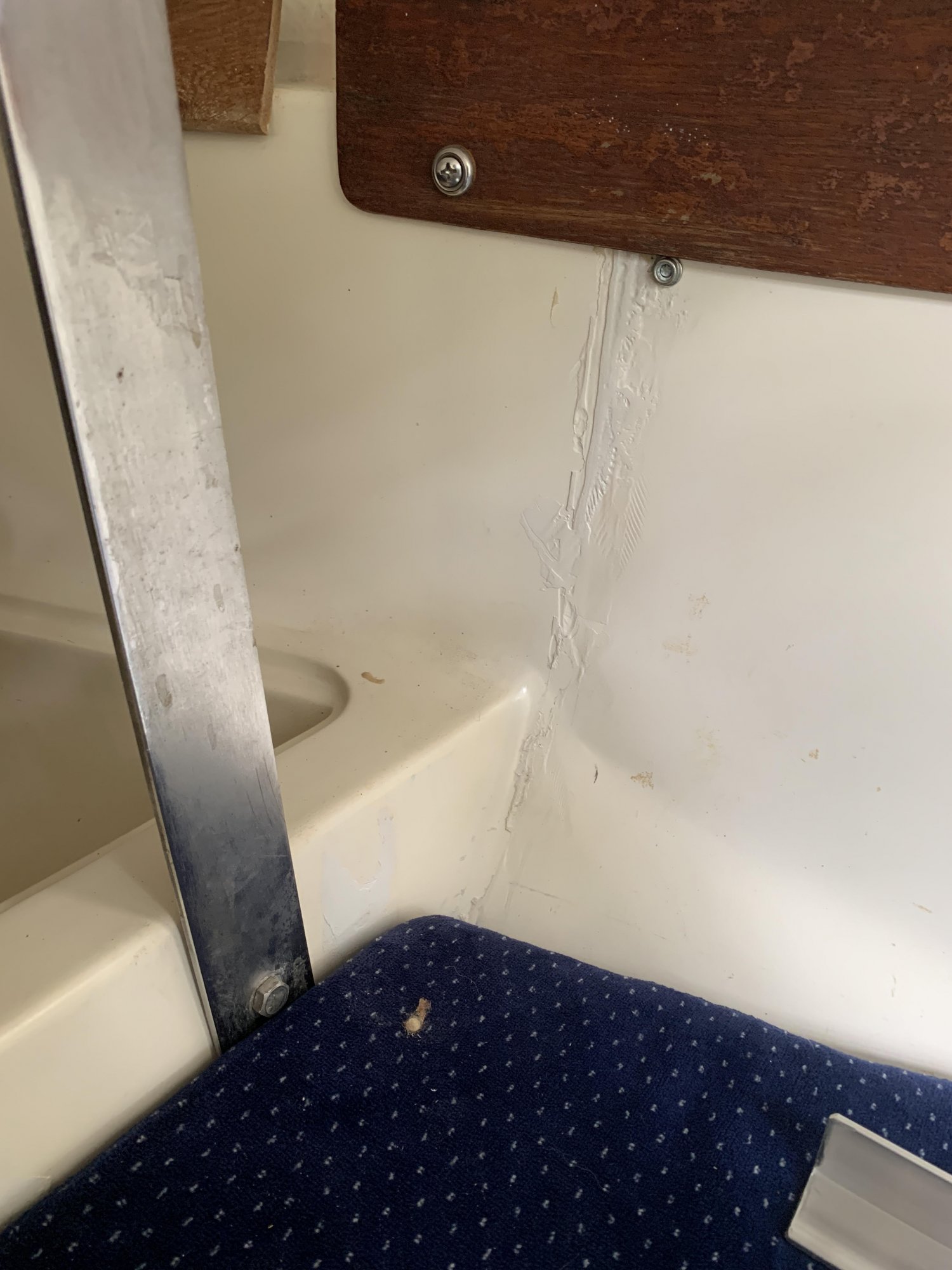

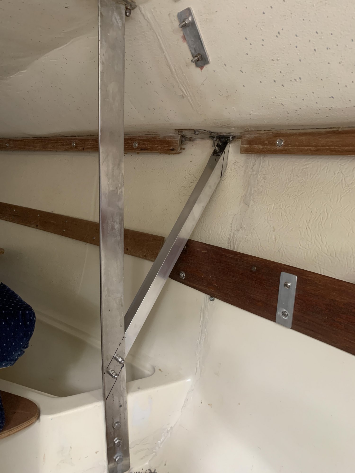

Someone do me a huge favor and see if your Merit 22 has this rough "seam" in the inner liner alongside the chainplates. it doesn't really look "factory" to me, but I could be wrong.
what I'm wrestling with is that the lee side shrouds tend to go slack when healed over hard. the owners manual says "if the upper shrouds are at optimum tension, when at about 15 to 20 degrees of heal, the leeward shroud should begin to look slack. this is quite natural and should never be tightened". uhh.... ok. but what I see under those conditions seems a bit more that "just begins to look slack" and more like a wet noodle so I began some more intense investigation today. the first thing that got my attention :oops: is that the chainplates are anchored not directly to the hull, but rather to the inner liner. huummmmm. it's not possible to investigate behind the liner in that area without surgery so I'm wondering if the PO overstressed the glass and it broke loose from the main hull. instigating the "repair" seen there. I do know this boat was raced hard in the SF bay area (high winds) with large genoas and spinnakers. regardless if it's a case of previous damage, or just typical flex due to the design, I want less slack in the shrouds to feel comfortable pushing it so I'm fabricating struts on both sides of the boat. these tie into the area under the perforated deck railing so theoretically that should stiffen things up substantially.
14,297
If the shrouds are really slack they need to be tightened. If there is not enough room on the turnbuckle then new shorter shrouds are necessary.
I'm not crazy about the repair you are making. The thinnest and therefore the weakest part of the hull is typically the upper end of the hull. What you are proposing will put more stress on the weakest part of the hull. If there is a proper way of strengthening the hull, it involves cutting away the liner and adding fiberglass to the hull with the fibers following the load path.
Alternatively, the liner could be beefed up with some glass and the the liner's connection to the hull reinforced with additional tabbing. It will be necessary to see how the liner is attached to the hull. Look for tabbing between the hull and the liner, it may be cracked or peeled away from the hull. Also check all the tabbing on the bulkheads for cracking and peeling.
RussC
Sep 11, 2015
1,735
plenty of adjustment on the shrouds but they stand at 180lb tension (10% of breaking strength) and still get loose like a long neck goose when healed over so it's not an initial tension problem. I like my solution just fine, especially from an effort vs results standpoint, but I'd still like to know why I had to resort to it.
BTW the strut is secured at the flange by the same bolts securing the perforated toe rail, which makes it substantially stronger than anywhere else on the upper portion of the hull.
pgandw
Oct 14, 2023
259
Stuart (ODay) Mariner 19 Yeopim Creek
ODay Mariners suffer from the same issue. There is no bulkhead where the shrouds attach. The hull compresses in beam slightly in heavier airs, and the lee shrouds look like wet noodles, even when properly tensioned at the dock.
Racers run a closet rod equivalent across the cabin in heavier air between the 2 chainplates. This has been going on for some 50 years according to the documents I have seen, and no boats busted. Mariners have no cabin liner above the berth level so chainplates are bolted to the hull topsides with large backing plates.
