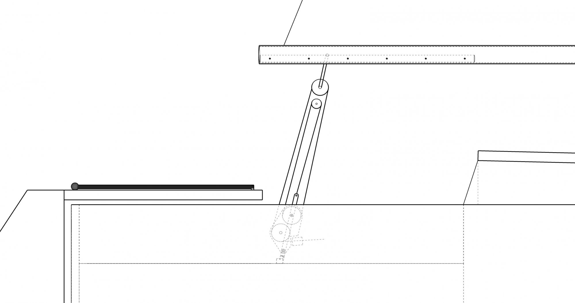

After my brother and I survived our shakedown run, I began researching improvements to sail handling. I'm still pretty new at all of this but my previous boat, a '72 Santana 21 had a mid-cockpit mainsheet that I grew accustomed to.
I bought a longer traveler on daBay I plan to mount about mid-cockpit. I've been advised to reinforce the boom and am working on ideas for that. I also found a heavier bail. This drawing shows the shortened boom I'm thinking about.

I had mid boom sheeting on my M22 and was happy with it. no need to shorten the boom. in fact you need to retain the length to have room for sail haul back hardware.

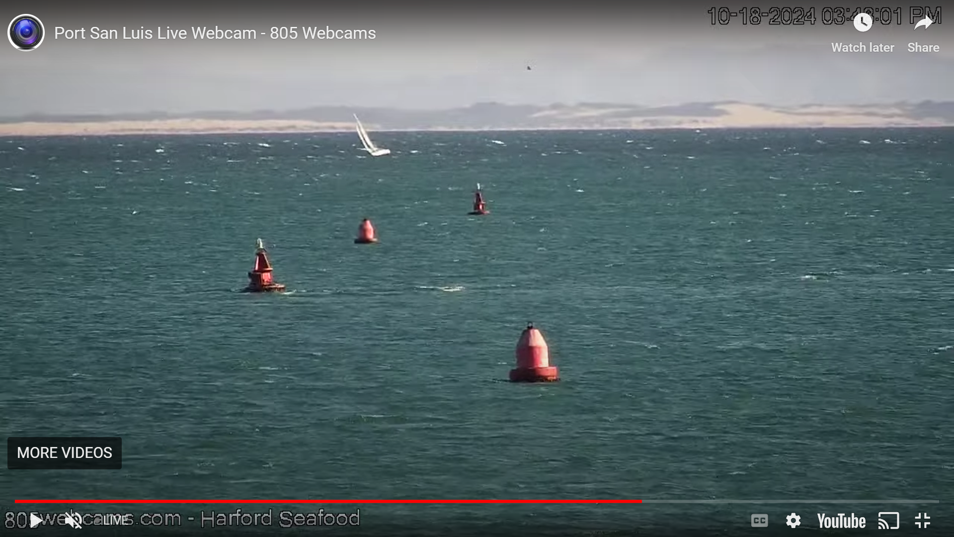

Hi Jeff, can you post a photo of the hole? Sounds like they were gaining access to mount a transponder? You should see lots of foam as I believe that whole area under the v berth is foamed.
Nov 23, 2024
7
Merit 22 Port San Luis
I put a screw out deck plate in that position, forward of the keel, in my Merit 22 for inspection. There was another one near the floor in the aft port settee seat. Both are useful for sponging any water that is trapped by the cabin liner.

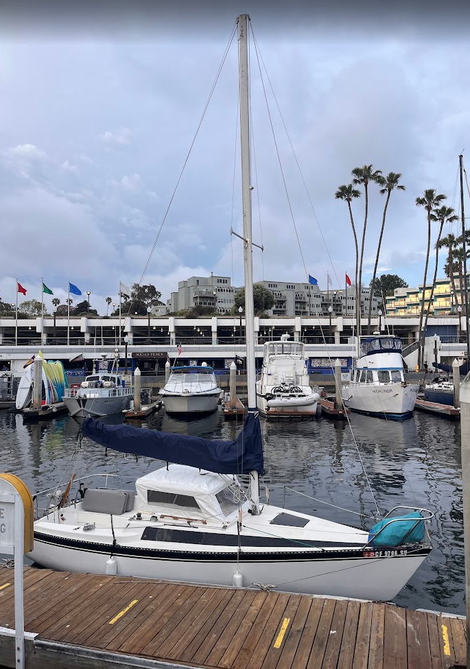

Here is my 1983 Merit 22 (Pressure Drop) My buddy helped me find it. Turns out he sold it new in 1983 to a lake day sailor when he was a dealer in Lake Tahoe. An ocean day sailor owned it in Norwalk for a few years. I bought it and have been cleaning it and the trailer up. Looking for advice.
Wiring: I bought an 8 gang switch and 4x16 mast wire with blade fuses but am having trouble getting the crappy old household wires out. The hatch gasket is leaking as are various places on the chine seal. Not sure if it can be resealed properly without taking the deck off the hull. Keel Winch: I am looking for cord to replace the winch cord. Mine has a hand crank with 5/16 poly rope that only uses 2 of the 3 block pulleys. I would like to replace it with dyneema or at least something longer to use the third pulley. Interested in pulley / cord ideas. Finish: I bought a polisher and am looking for the right product to restore the shine. I am also looking for advice on restoring or re-doing the black accent paint and mast paint - I am thinking sponge roller enamel paint. Also considering foam decking and other interior cleanup ideas. Mast raise: I am also looking for good ideas for single-hand mast raising on the water or trailer. Leak: I have a slow leak in the rear access area letting in about a quart a week that I cannot find to fix. I bought it with cracks in the internal hull near the at the corner of the rear right storage compartment and next to the trunk. I suspect there are microcracks in the trunk. I cannot see cracks by looking up from below or down from above. It looks like you have to completely disassemble the hull to access wherever cracks may be. Anchoring: I do not understand why this boat spins and rocks so much at anchor and on a side tie. She moves WAY more than all the surrounding boats. I don't get it. She's a good boat but I have all kinds of questions as I try to restore her to glory. I would love to find more Merit owners to share experience or meet up in the San Diego area.
