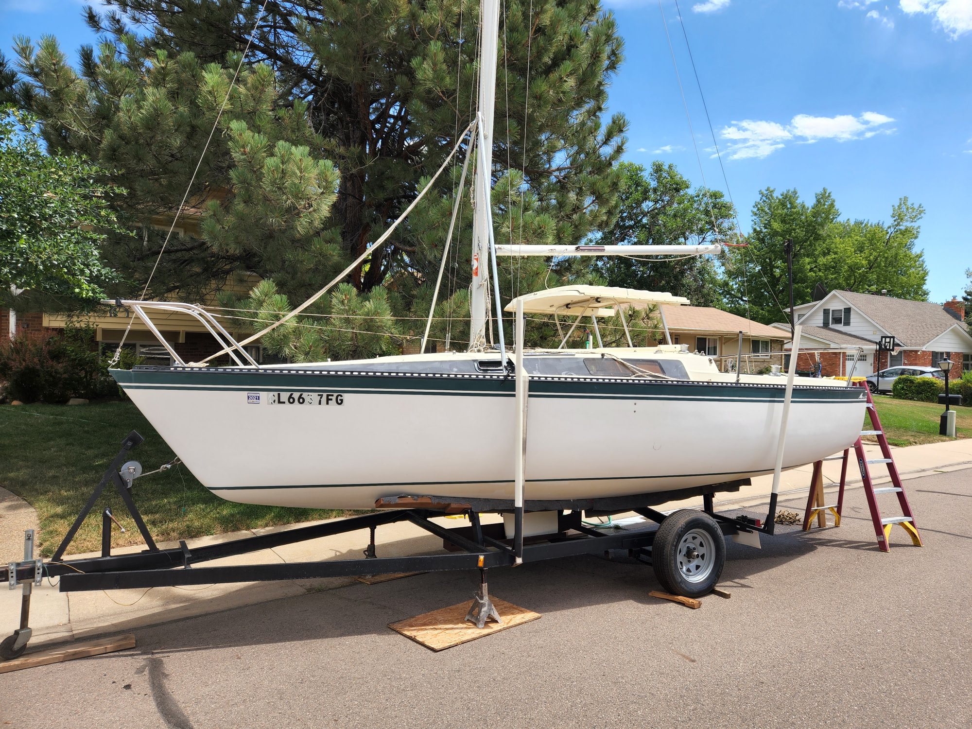

I have to drop the mast on my Merit 22 by myself. Other times I had friends helping and a place to hang a block up high. But not this time.
I have several options for making a gin pole, a 10 foot length of 2inch steel tube or a fir 2x4. But I don't know how to fasten it to the mast. How do you guys do it?

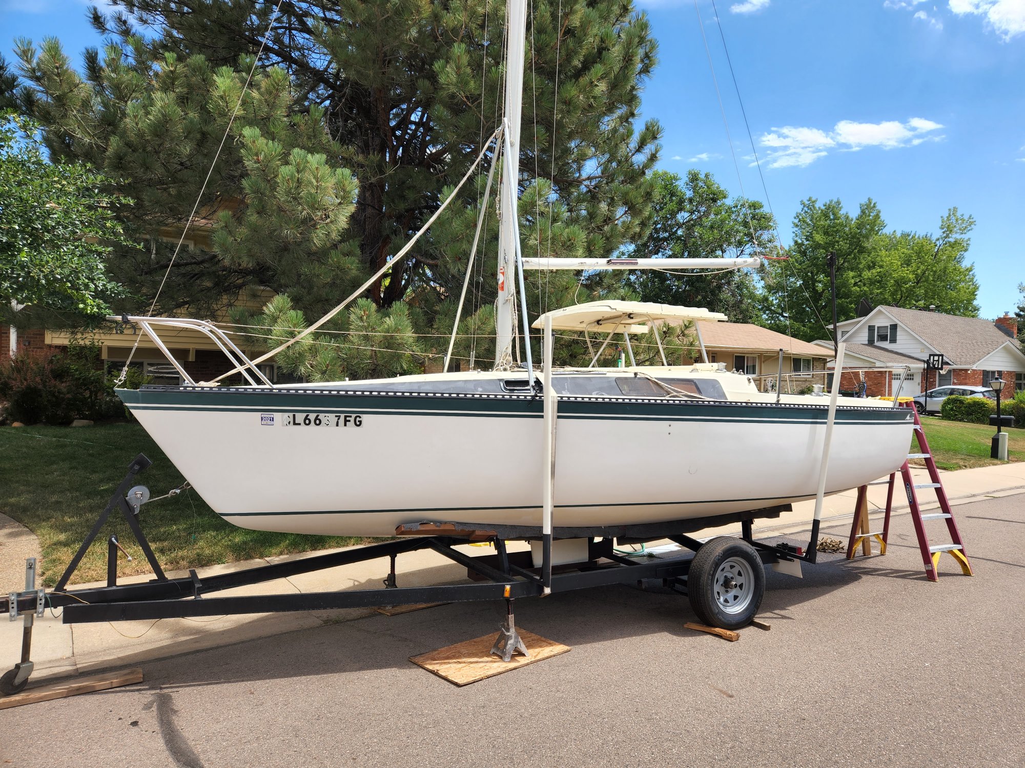

Kind of why I went with the A-Frame setup; I do it alone. Like a one-armed paperhanger with the crabs!! Pole wouldn't have to be 10 foot either; 2x4 might be a stretch!!! Thought about rigging a gin pole to the eye in the tabernacle bolt, much like a spinnaker pole, but the A-frame setup was cheap ($30), efficient and laterally stable. I copied this setup exactly https://buckeyelakeyc.com/library/2022_files/Sailing/Capri 22 A-Frame Mast Raising System.pdf

Thanks a lot, Digger. It looks like this will solve my problem.
Did you find that the stock mast crutch is high enough?
Jul 15, 2022
22
Merit 22 Carter Lake
I have a homemade mast crutch that came with the boat. It stands about four feet above the rear gunnel. It's an adequate height to start.

I would bet the forestay is in there. I've stepped and un-stepped my mast with my furler in place. Mine is an Alado Furler with interlocking 5' aluminum "foils" with forestay running thru the middle. I'm very careful to keep the furling assembly from bending or it will be toast!!! Once the mast is down you lash the furler assembly to it. If yours is one piece pvc, it's probably a CDI and they are much more forgiving; almost designed to bend. Flexible Furlers — Cruising Design International
If you're going to run roller furling you don't need another forestay. I'd bet that sail was just left over from when it was hanked on the forestay. Depending on the size of the furling jib, you can make it any size you want, dependent on the wind. Mine is 135%, which gives me any size I need.
Pulling on the forestay will work, but the mast resting on a fabricated (wood, aluminum, or steel) crutch attached to the rudder gruneons on the transom make things very easy with the A-Frame. Think about how unstable the mast would be without side guides to keep it centered when raising, just pulling on the forestay!

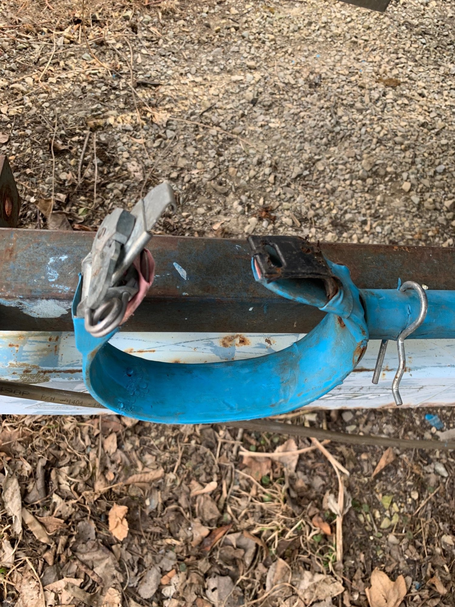

I have several gin poles . The top photo is my preferred version . It softly but firmly clamps the entire circumferance of the mast and wont slip off .It cost me all of $8.00 I think . I'm able to step the mast even if the boat is on the water ,safely and by myself

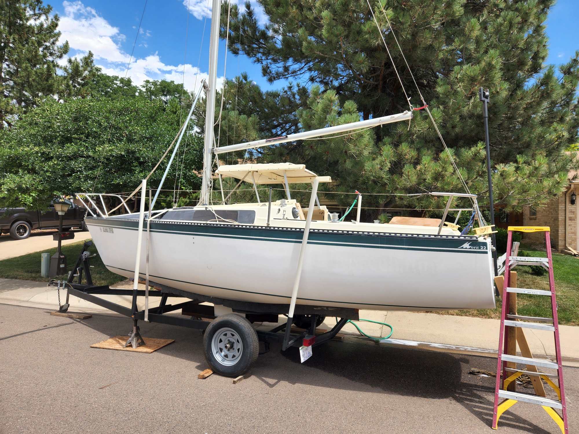

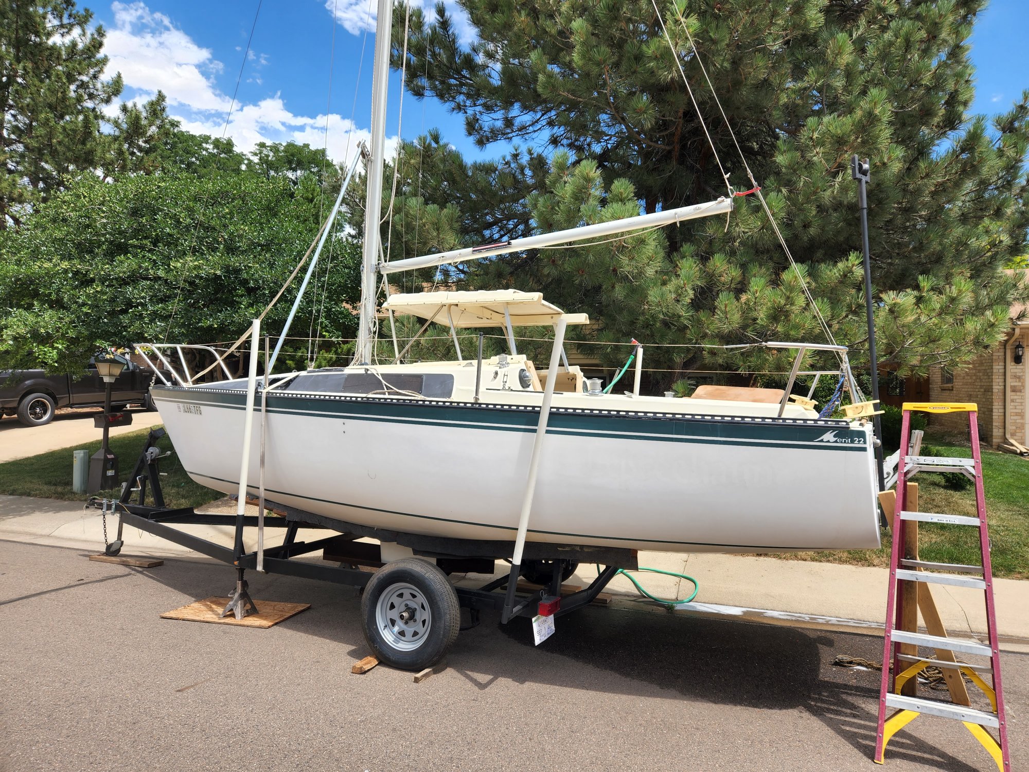

Added a couple of shots with the mast and boom in place and my a-frame setupView attachment 207659View attachment 207660
