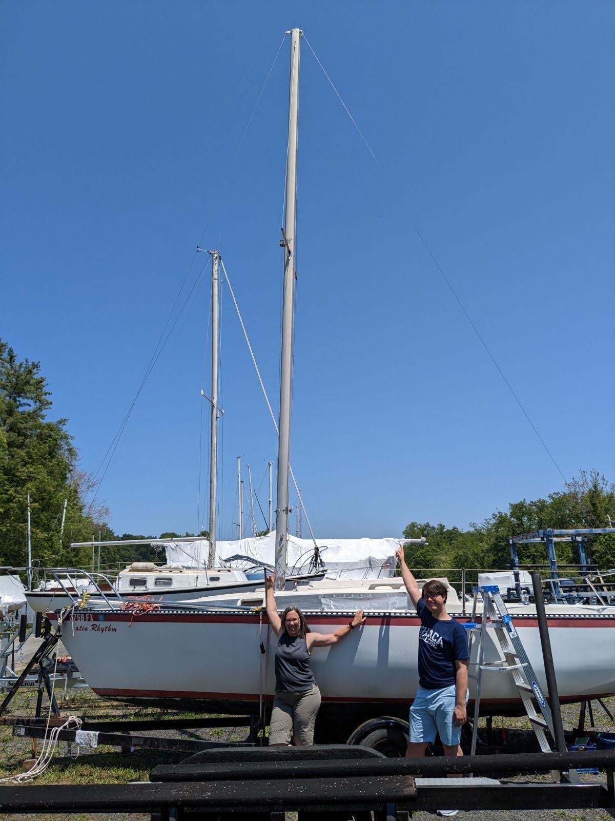

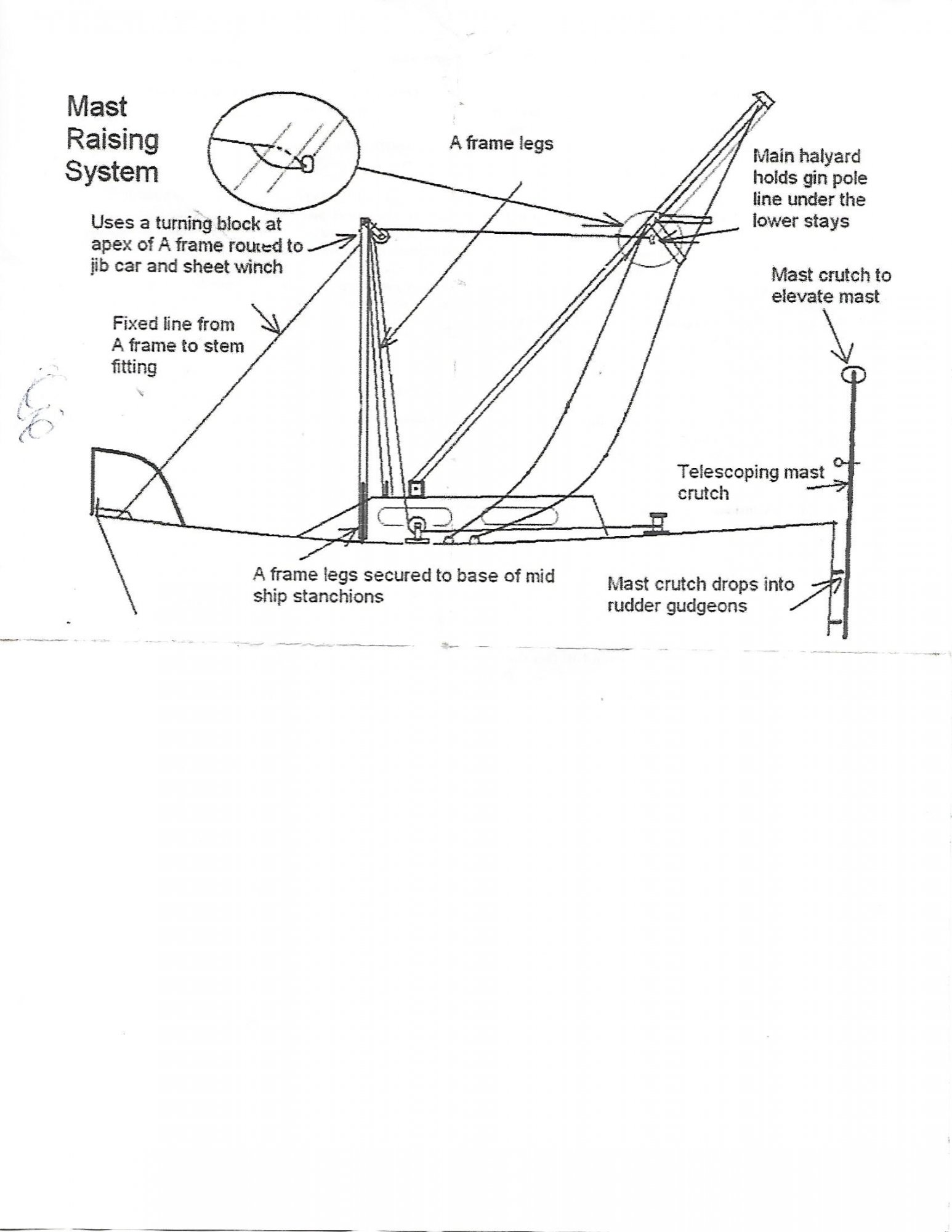

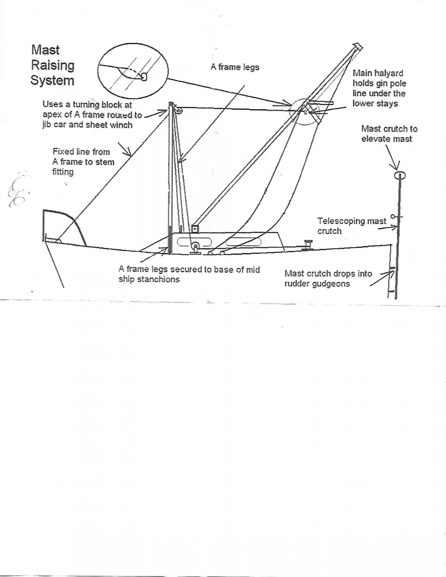

Got the mast up on the Merit 22 this weekend for the first time! We also built an a-frame ginpole system and used the main sheet blocks and forestay. It was much easier than we expected.

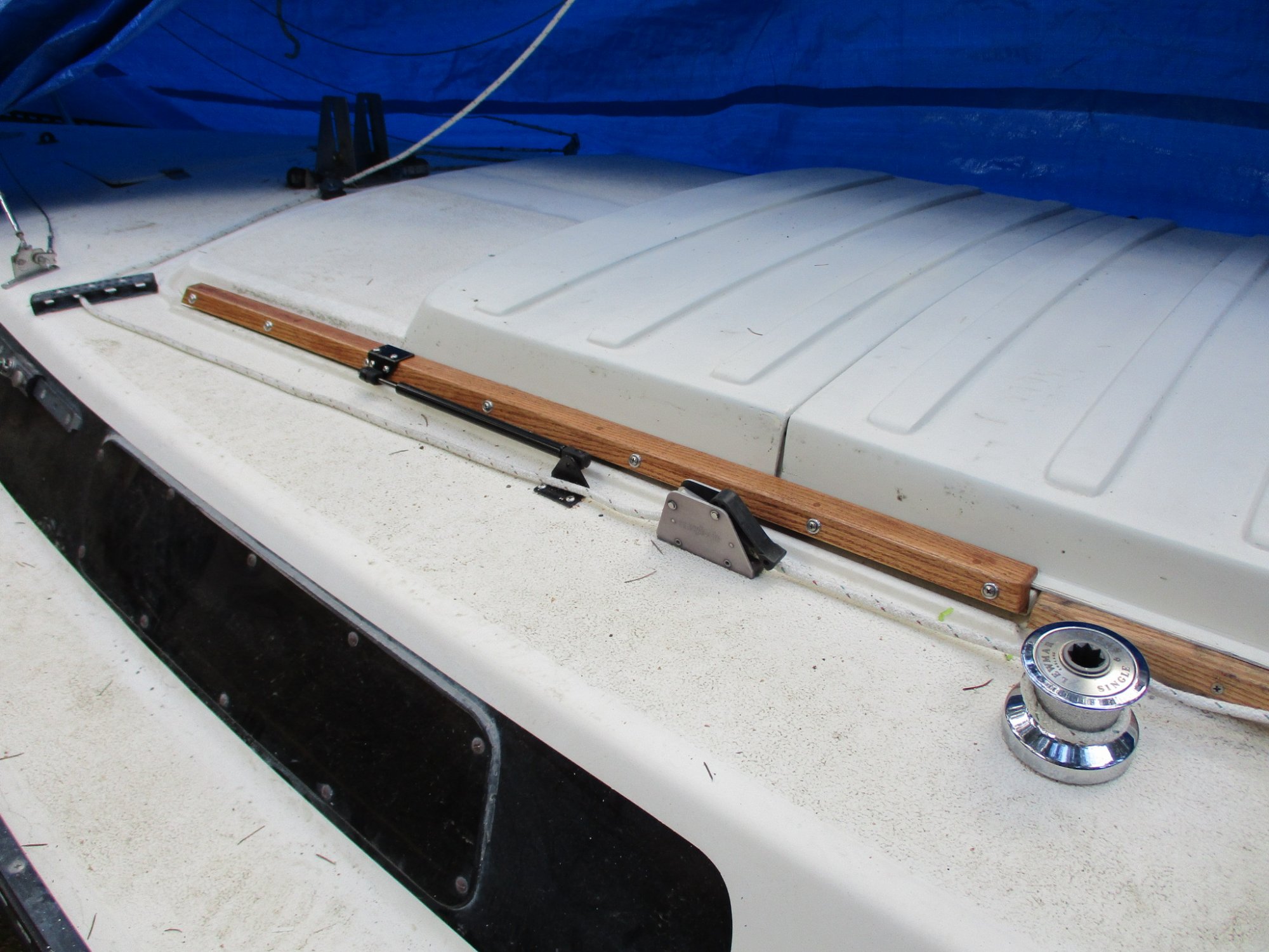

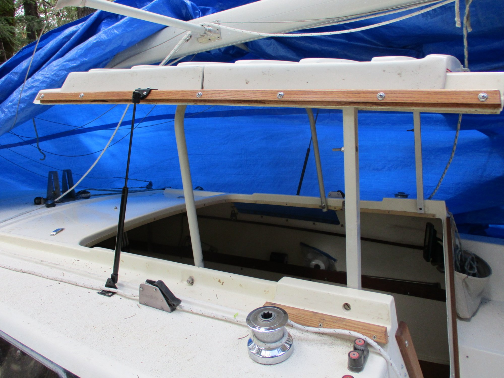

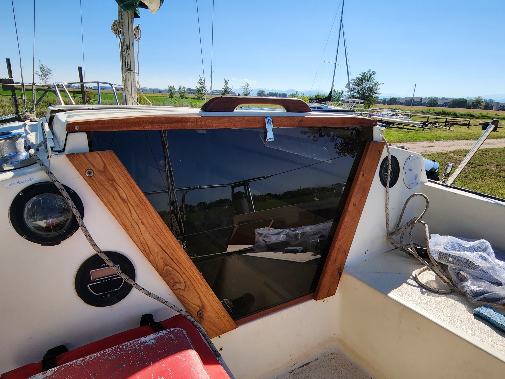

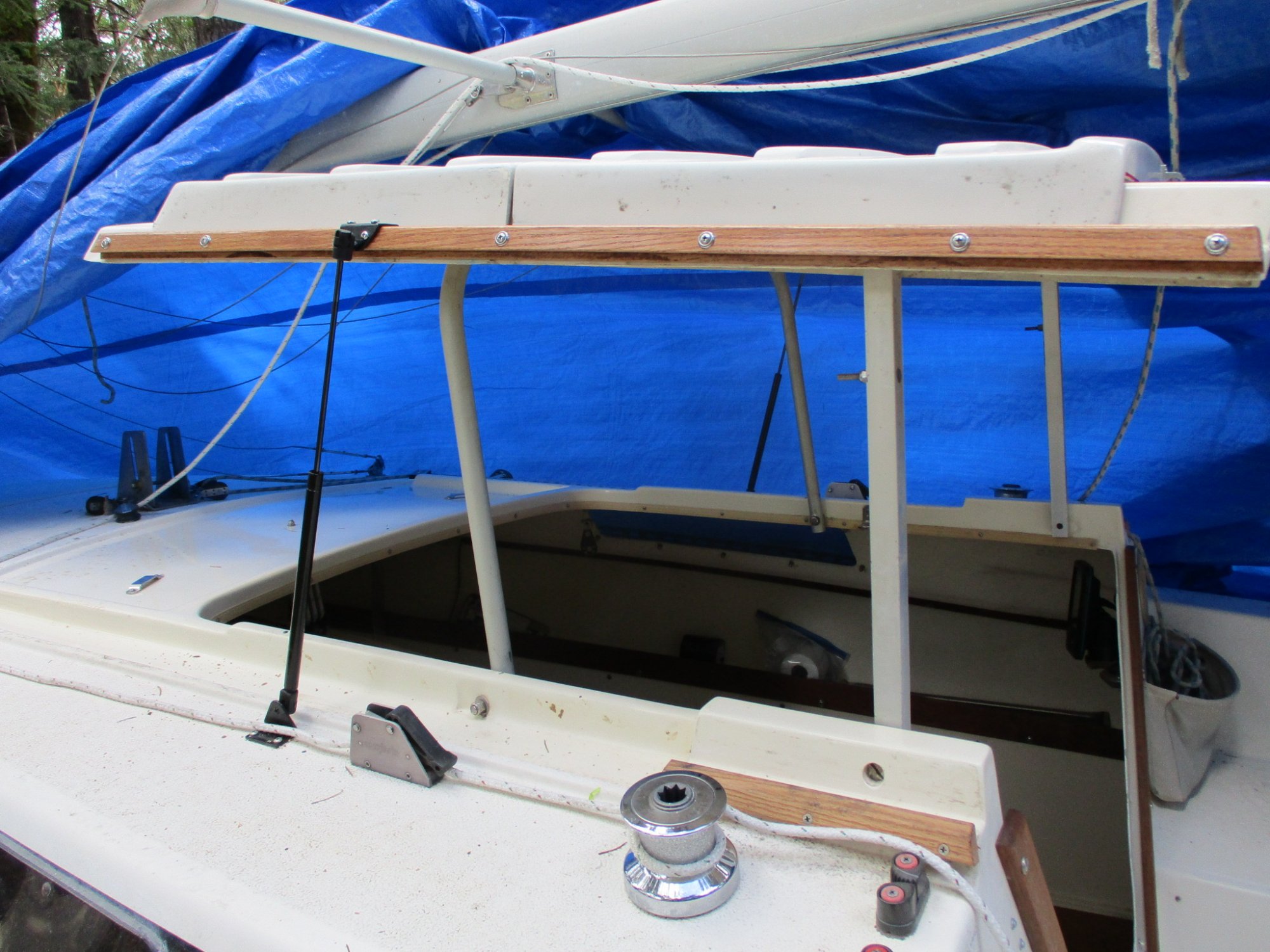

We also got the pop top up. I had wondered why there were two table legs - we discovered that they are also pop top supports. With them in place the pop top was very stable.
