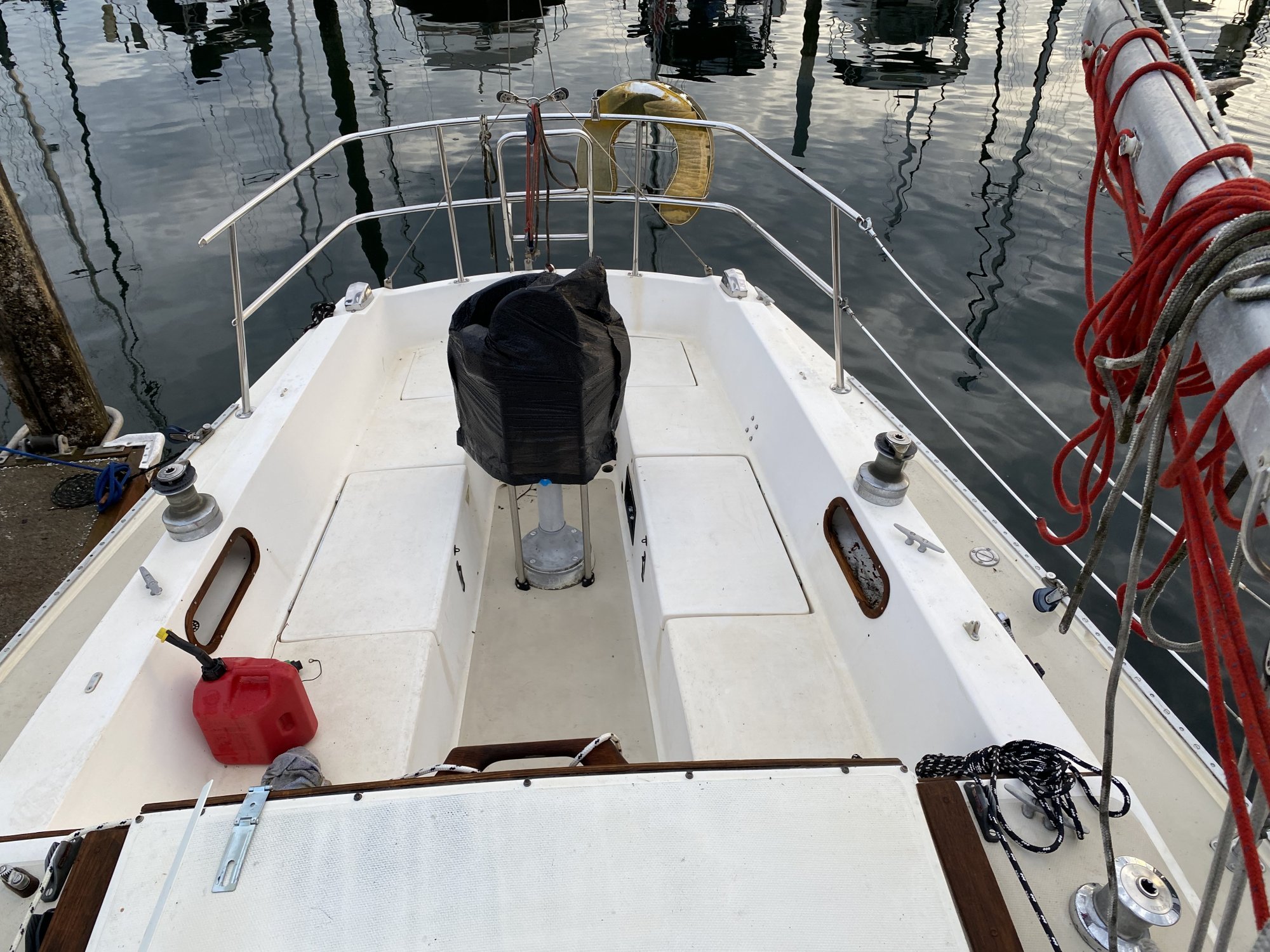

Where are you slipped in Tacoma? I’m at the break water. Your LPG tank caught my attention……could you do me a favor and hook it up to a bbq and burn off the remaining gas and dispose of it? That is a fire/explosion waiting to happen. Please store it outside until you can empty it. I’ve seen several failures of tanks due to corrosion and with the weather warming up, the pressure in the tank will be rising.
It's already outside and away from things that can ignite it. I am planning on burning off the rest of the gas after I get the stove cleaned. I will use it to test the stove, also outside away from things just to be safe. I tested the solenoid and regulator tonight and they are all good and functioning normally. I am going to have a propane shop look it over as a safety precaution have the regulator serviced just in case. Thank you for the concern, I really appreciate it!

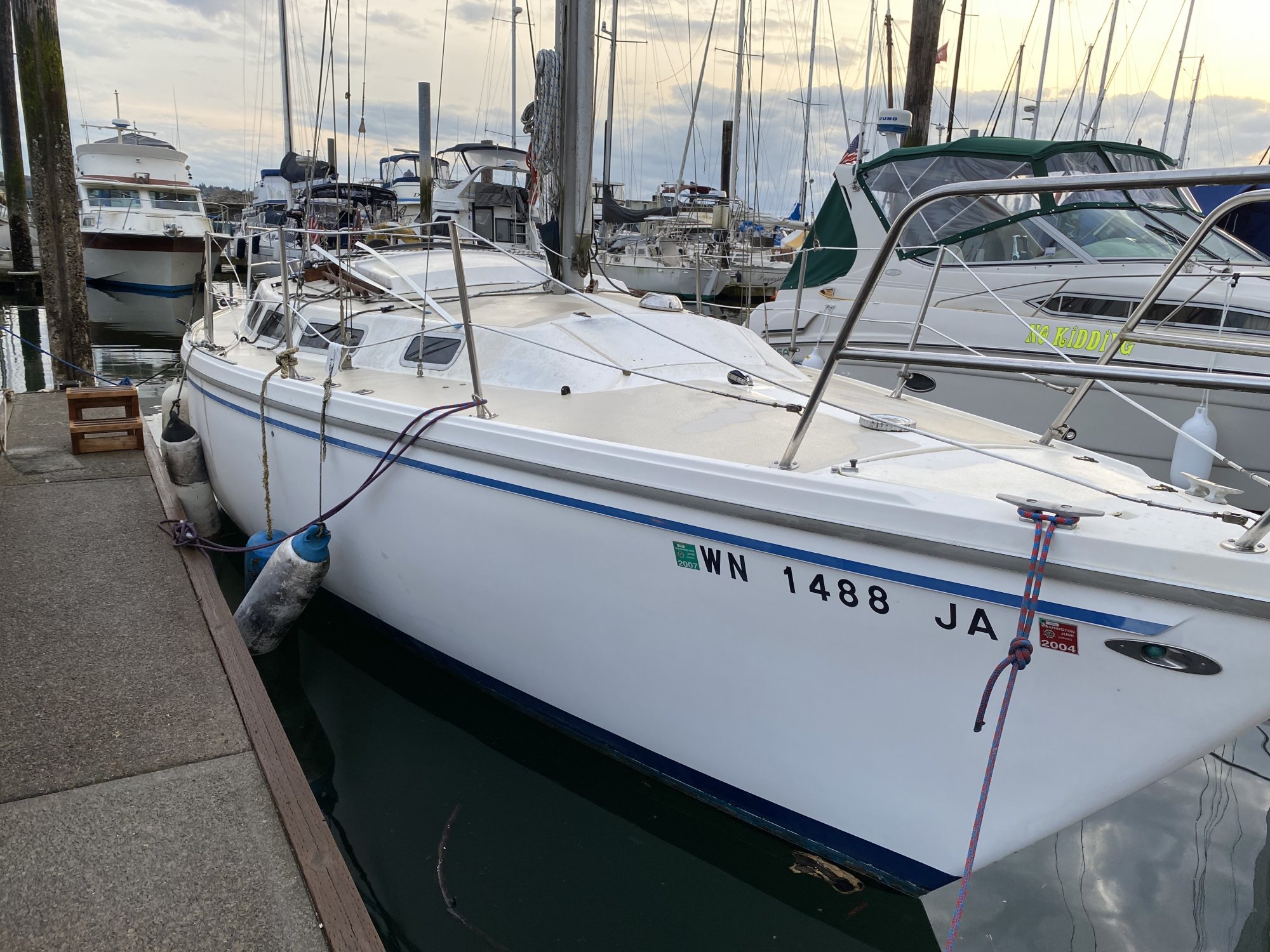

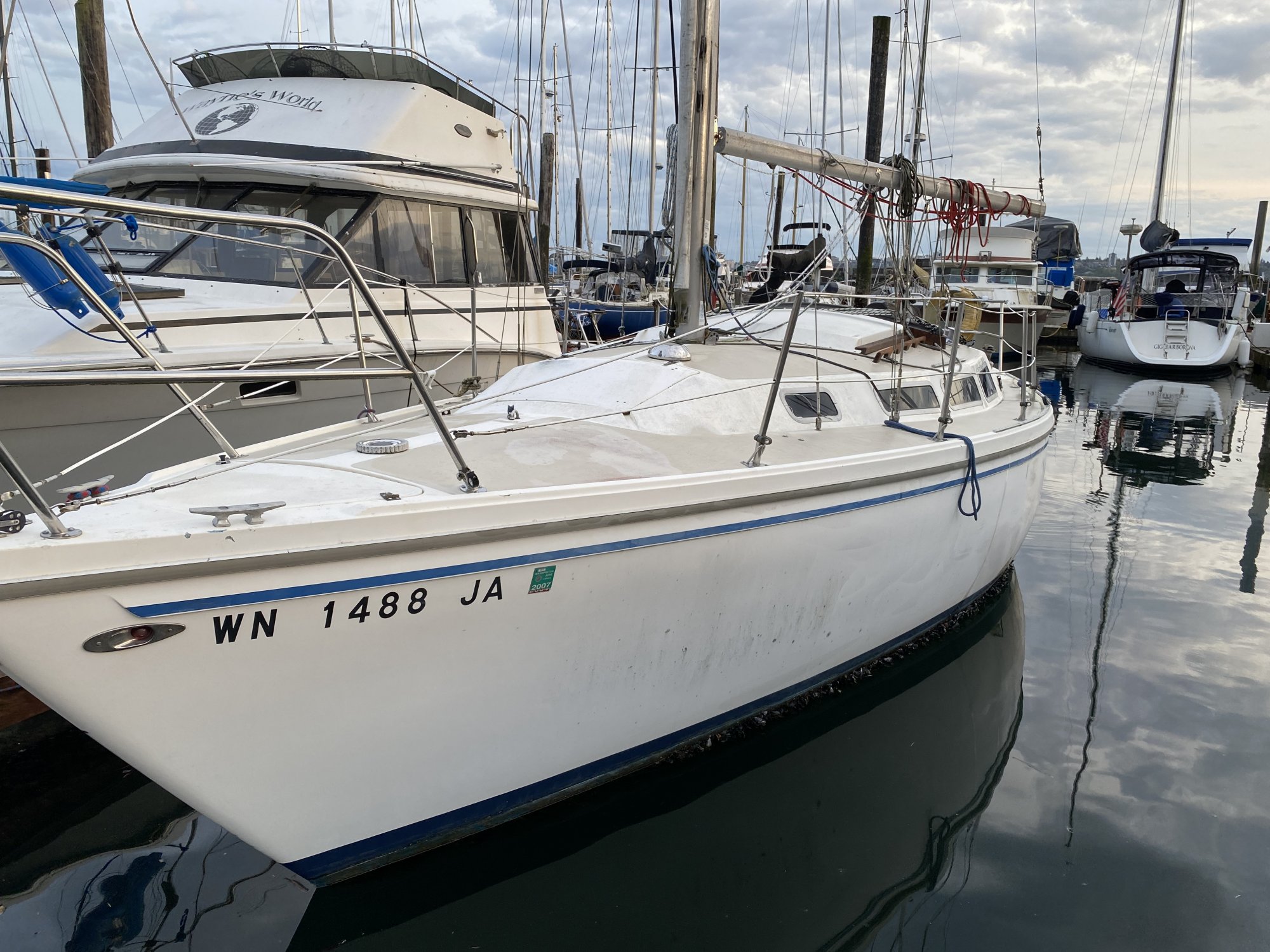

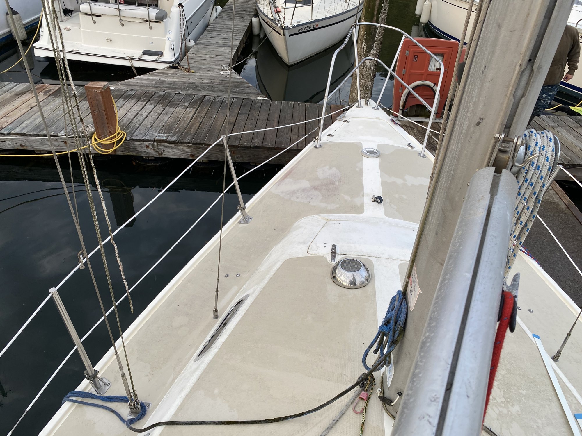

So things are way different with Luna today. Waaaayyy different.
She looks like a boat again! I also found out the water that gets in the boat seems to only come in from the windows. There was no noticeable drips from the stanchions or from the chain plates. I’m still gonna rebed them, but maybe not right away. The windows are a must, and I have the new seal kit but I’m waiting for better weather. I also took the sail off the mast so I can work on the rigging and also check the sail for damage. I did find some dirt in it from either a wasp nest or a birds nest so I most definitely want to check for damage.

And your dock neighbors are so happy!
The neighbor right next to me better… I had to wash his boat too! The wind was blowing all the junk off my boat onto his so I gave his boat a scrub too. It’s now cleaner than before we started on mine.

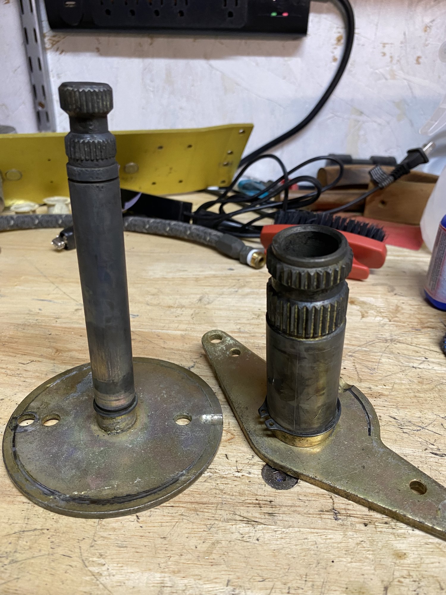

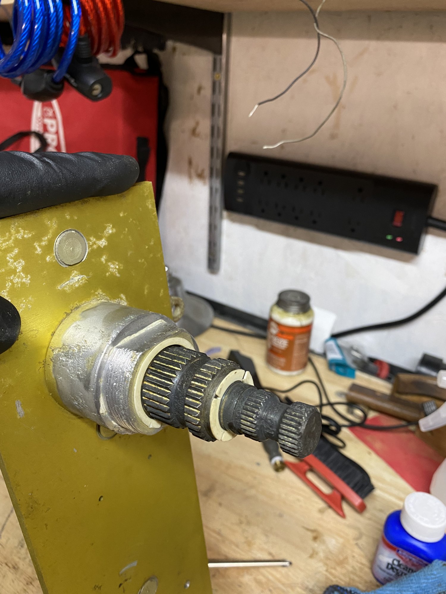

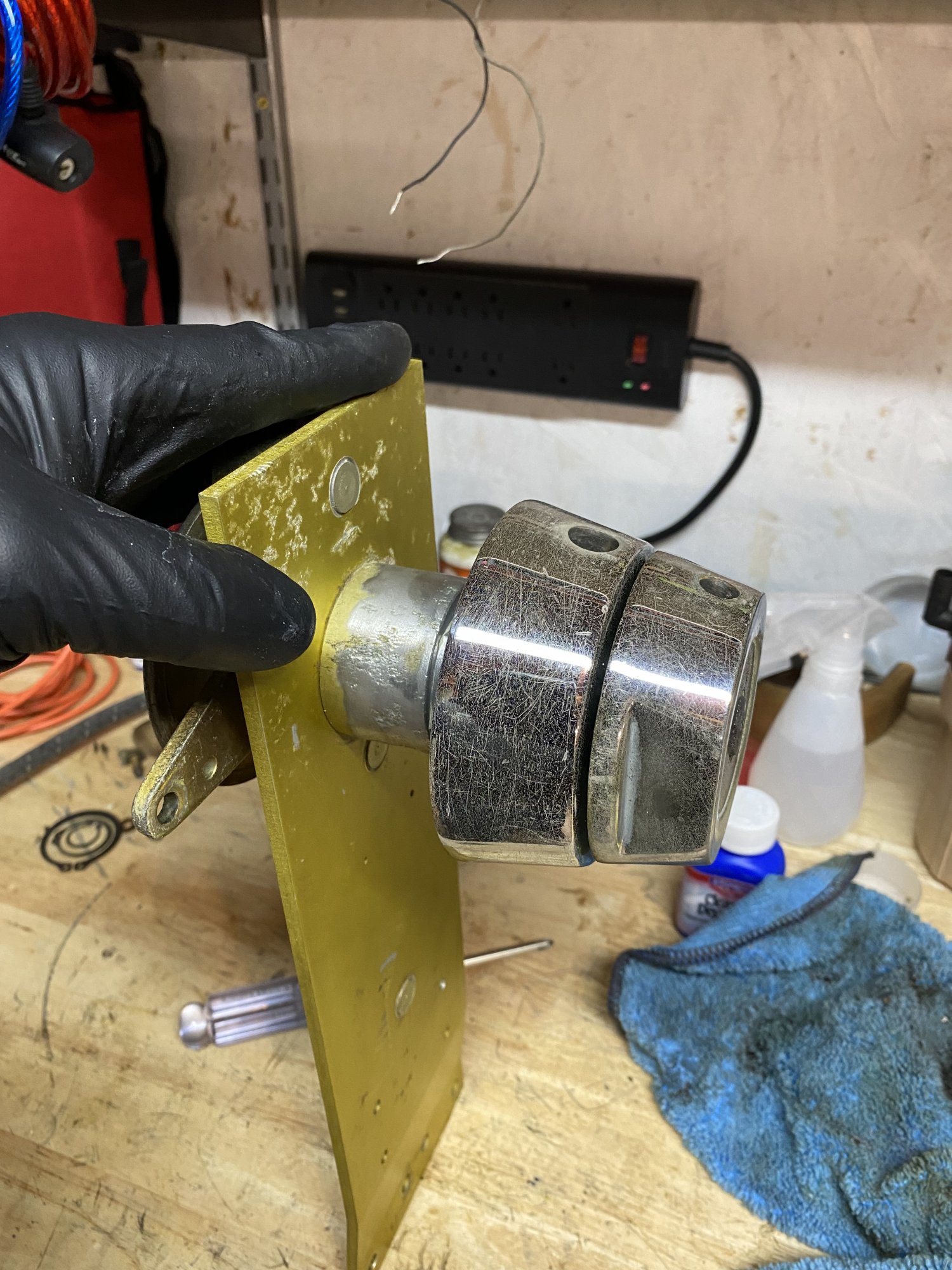

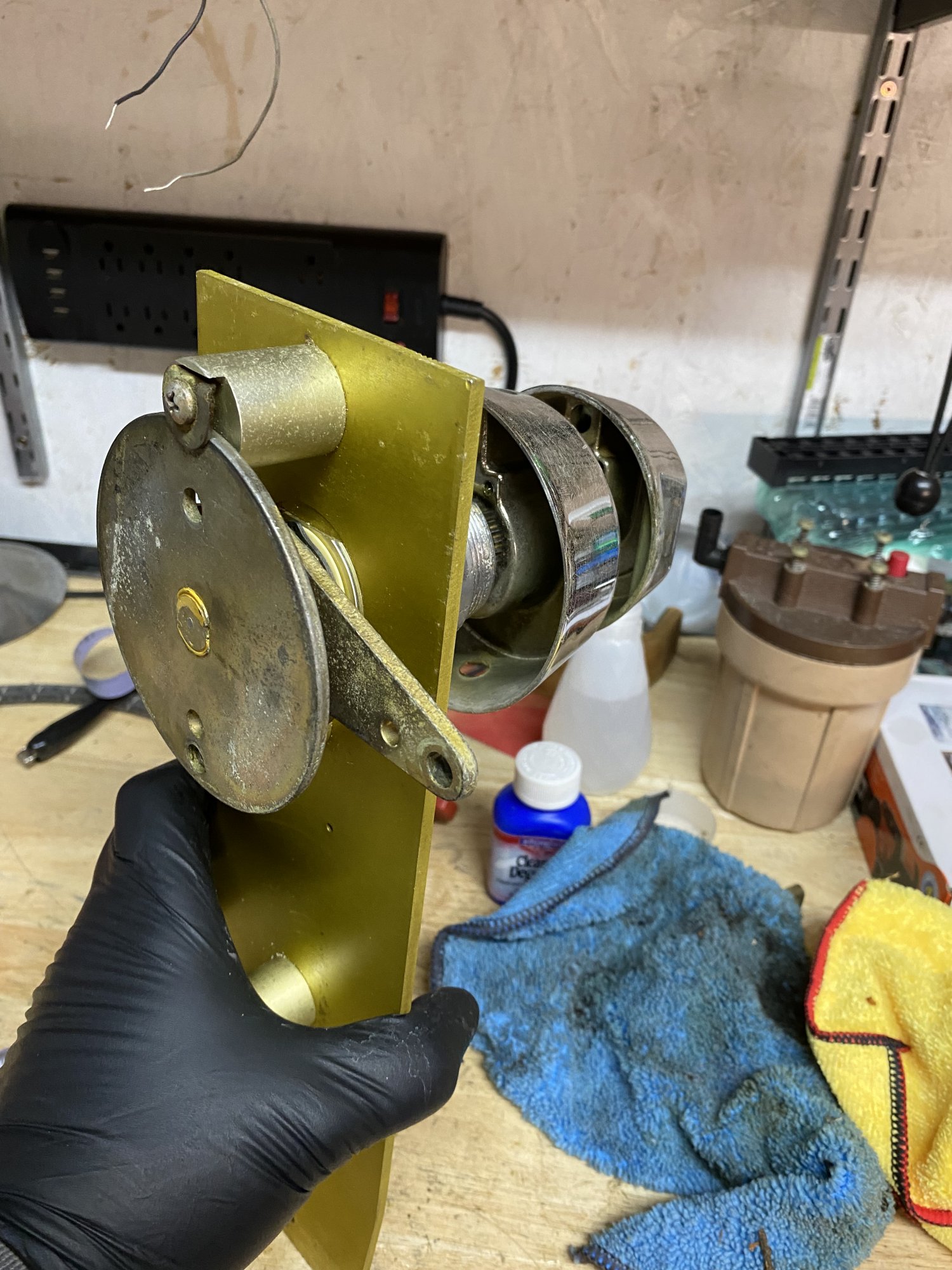

So I would have never thought, at the time I was learning this, that a skill I picked up restoring old rifles would come in handy with my boat. I removed my controls a few weeks ago and after some serious effort I was able to get them apart. There was no lubrication in the bushings and rust had set in to lock the throttle and shift together. Well they sat for a week or so in some EvapoRust and tonight I cleaned them up, and blued the bare steel parts. The anodizing or whatever coating was used to prevent rust was long gone, so I knew something was needed to prevent them from getting locked together again. So for those who don’t know the bluing process will “rust” the steel in a controlled and visually appealing way. It basically oxidizes the iron atoms with an inert chemical (can’t remember which it is) and that will prevent water and oxygen from reacting with the iron. Now this isn’t a perfect process, rust can still happen but it will take much longer than bare metal. Also it has no film like paint would so the parts are the exact same size. Anodizing does the exact same thing.
Below are some pics of the parts by themselves, and also after I dry fitted everything. I plan on assembling the throttle controls with copper based anti seize which will help prevent corrosion, and act as a lubricant at the same time.
I am still missing the mounting nut and I will need to print a base/spacer to mount it to the foot well.

Ok, so I was thinking about my dilemma. I am missing the large nut that would normally be used to attach this unit to the hull. If I can’t find something to use as the nut, I can print a block that would have 4 holes in it, and then drill and tap holes in the aluminum bracket and use that as the mounting method. It would be simple and sweet in the end, and it should be fairly easy to create.
I will keep you all posted on what I decide.

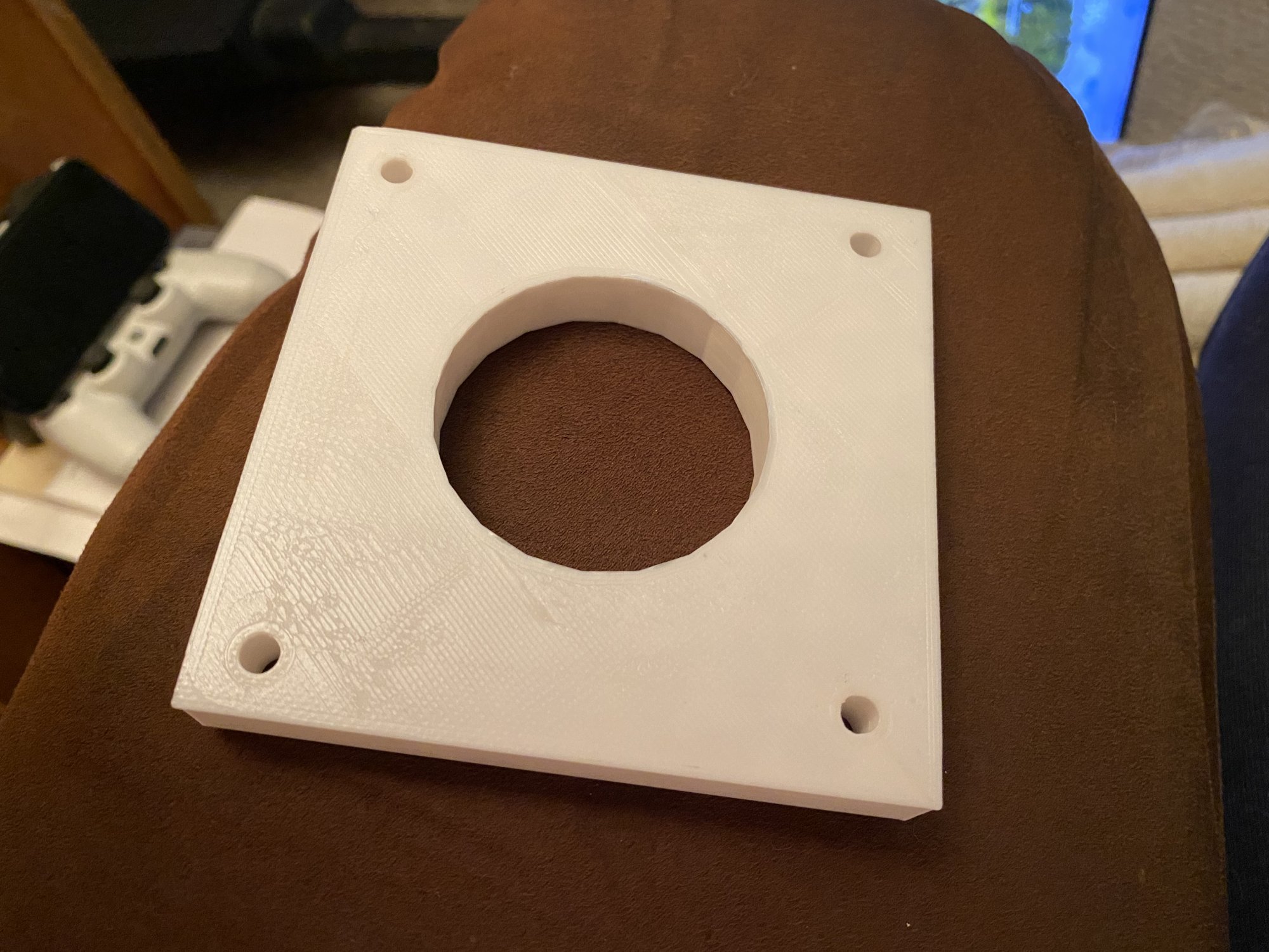

Well I decided to play around in Tinker Cad tonight and print a mounting block for the throttles. I made the file and went to prototype it and my printer wasn’t printing. I did a couple checks and still nothing… then I decided to check the filament and that’s when I discovered the bearing had broken off. Well bugger… So I ordered the upgrade parts and hopefully they will be here in a couple days so I can try again.
So this version of the part is 32mm tall. The same as the shaft the nut would normally mount to. I’m thinking it’s going to be too much, but it’s a test print. I’m going to use this one to figure out the proper and exact height to make it and a companion on the back side for a good and strong mounting. I’m thinking that I will print 2 plates, one at 10mm and the other at around 22mm. The final print will be a solid block. I will post pics of the prototype when I get my printer fixed and make it.

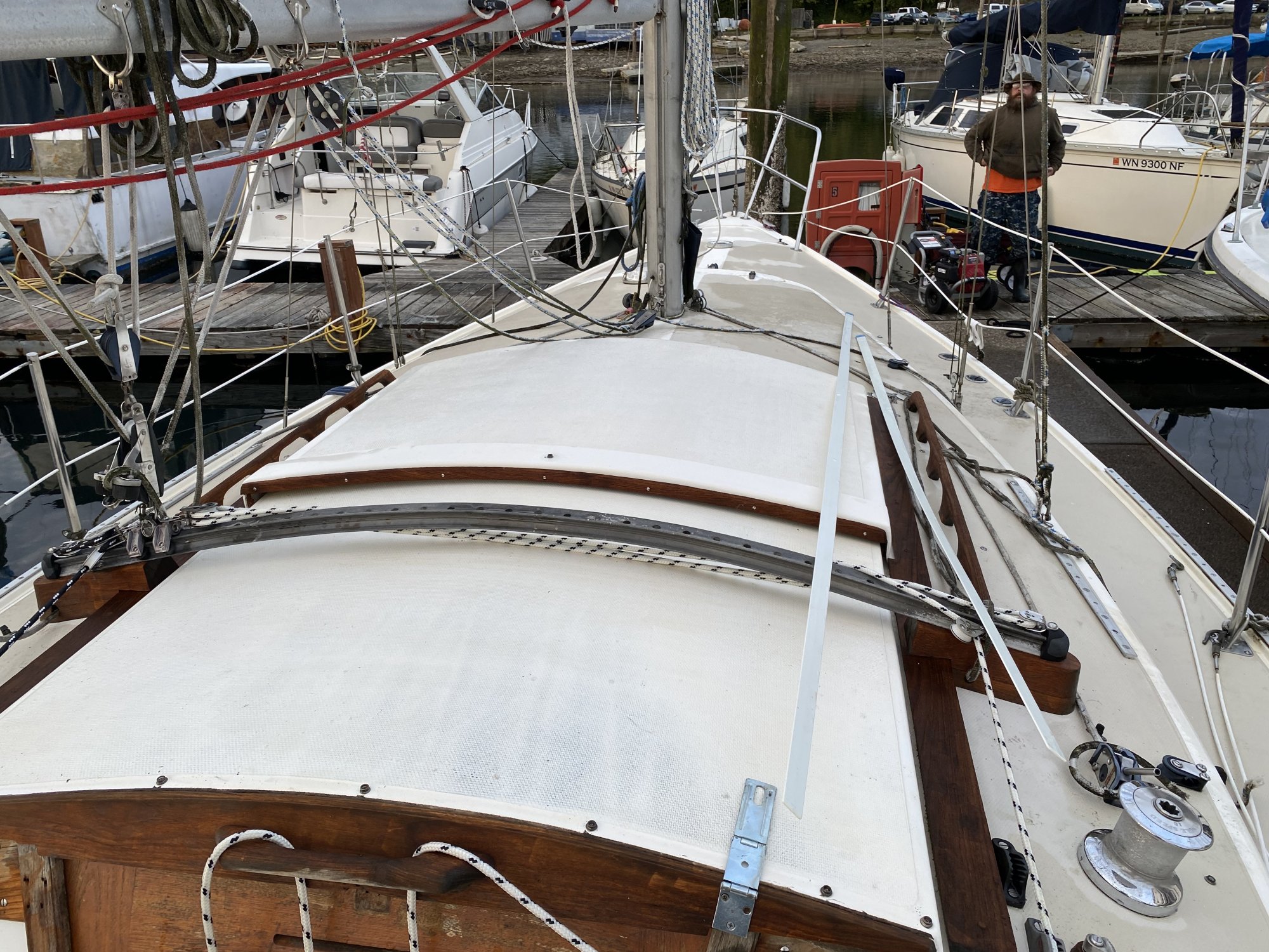

Ok so I decided to go to Luna early this morning. I got a couple donuts and a soda and enjoyed them while lounged out in the cockpit. The morning was beautiful. I replaced one of my traveler lines with a longer rope so now they are both 43’ long. The 25‘ line I had on one side was long enough to do the job, but I only had like 2’ left at the cockpit. Now I have plenty of rope to the helm. The 25’ section replaced the rope from the traveler car to the boom and now that’s all sorts of pretty. I met a couple of my neighbors as well today, and one couple didn’t even realize Luna was the same boat, they thought it was a new boat. Another neighbor 2 boats down just bought his boat to from a guy I met last week while cleaning Luna. He has never owned a sailboat before and bought an Ericsson 32 for less than I paid for Luna. It’s in good condition and ready to sail even! So I helped teach him how to hook up his Genoa and showed him where the lines go. Good day… well while I was at the boat anyway.
I found a length of rope that was spliced to a piece of wire rope in the boat a few weeks ago… today when I was trying to locate all my different rigging and see where it all goes, I found the same setup going into my mast, and coming out the masthead, and it was tied off with a shackle on a safety line. So I’m guessing this is for the spinnaker… any thoughts on that. My gib halyard and main halyard have been found at this point, and they both exit the mast at about 5’ from the deck and stay at the mast, this rope goes all the way back to the cockpit.

Hey guys, so today turned out pretty ok. I fixed my 3d printer and prototype printed the throttle mount. It came out perfect. It’s just the right size and with s similar unit of about 10mm on the back side it will mount the throttle levers perfectly once again. No need for the large nut. I have the printer working on the fully filled version right now, it says it will take 16 hours to print. Here is the prototype piece.
The production piece will have countersunk areas for the screws.
