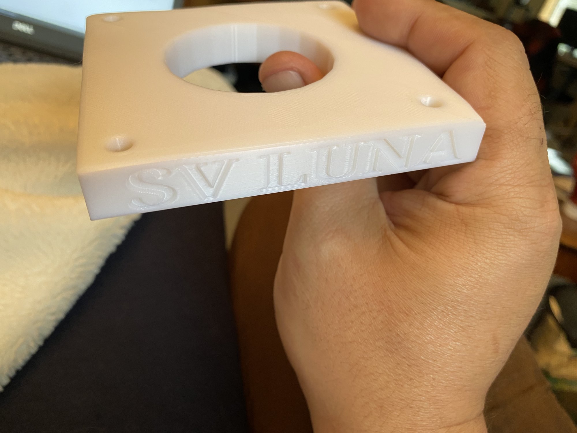

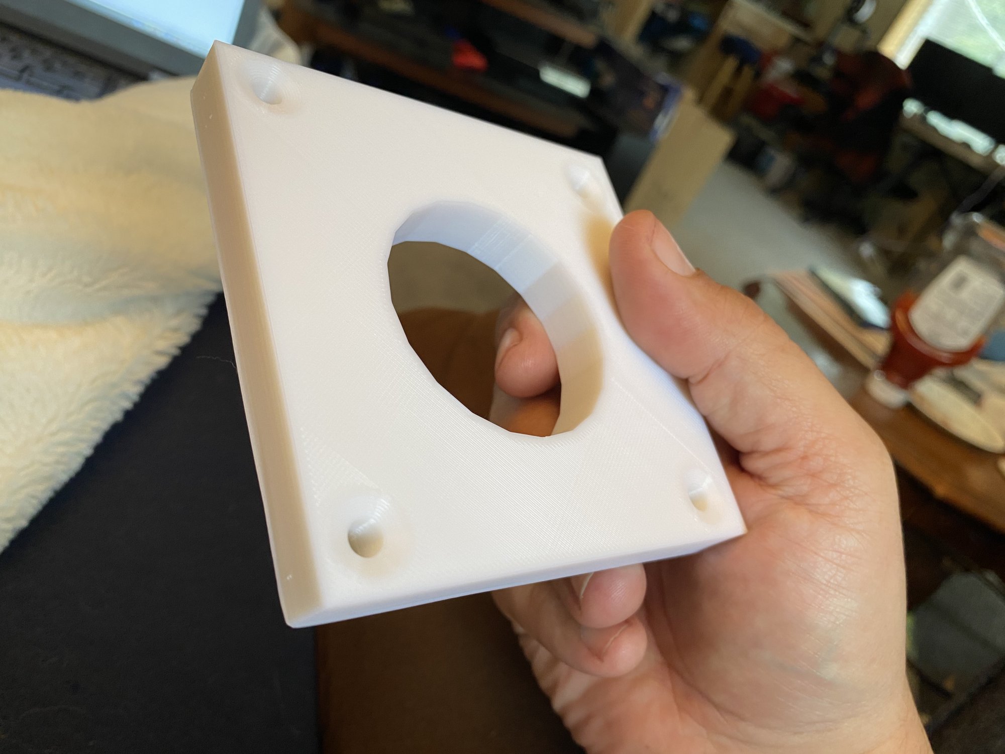

The part finished! 16 hours 25 minutes. If I had to print another one I would change the taper on the countersinks to make them a bit deeper and a slightly steeper angle. This will be close enough for now. I will next work on the drilling and tapping of the holes for the hold down hardware.
DArcy
Feb 11, 2017
1,767
Islander Freeport 36 Ottawa
The name is a nice touch. Since you printed the part with solid fill you can easily drill the countersinks to whatever size you want. I very often print holes undersize then drill them out to full size.

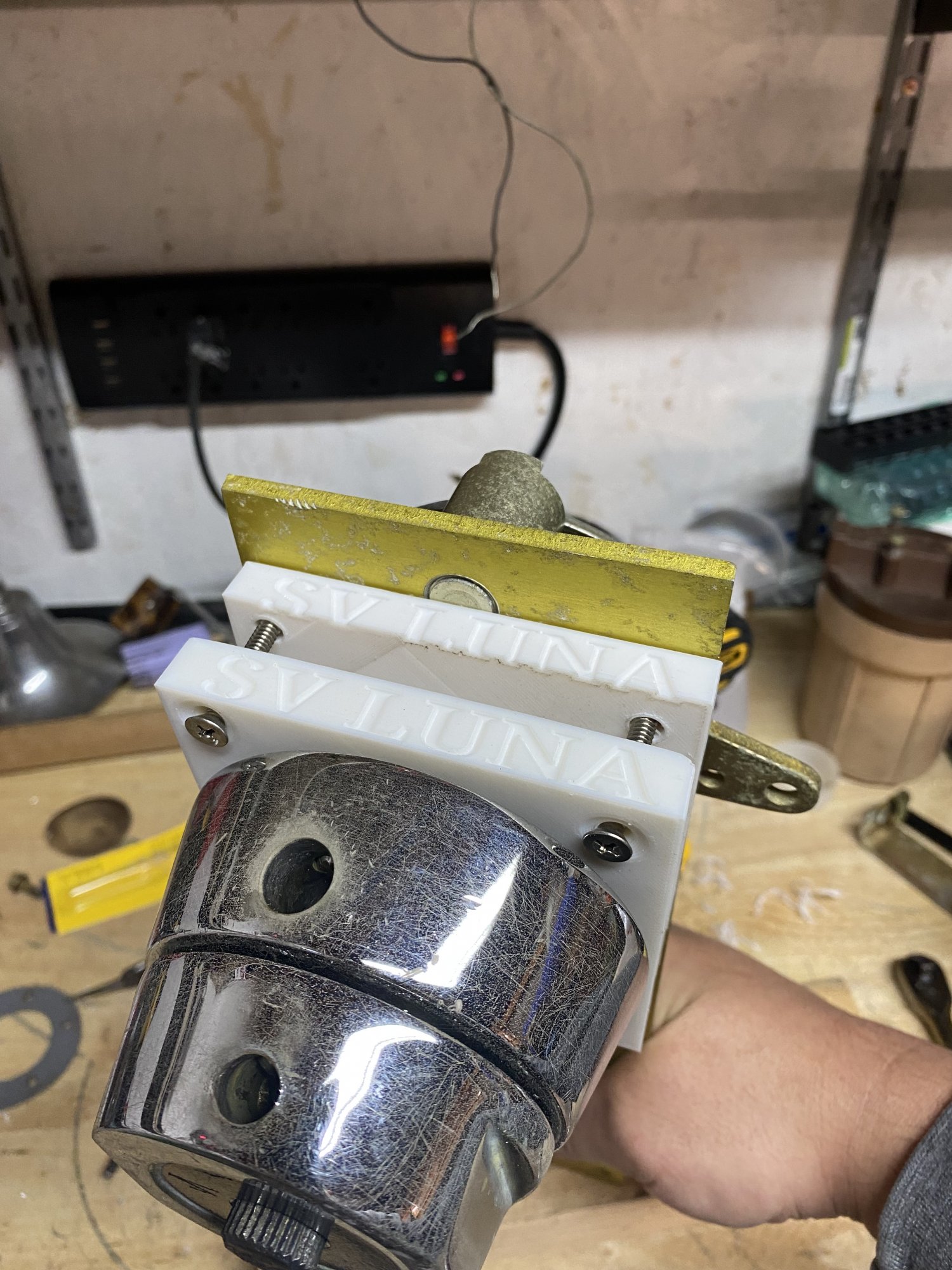

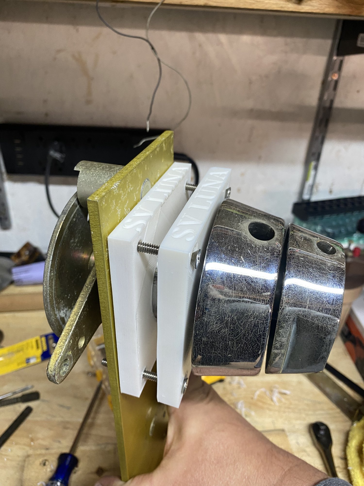

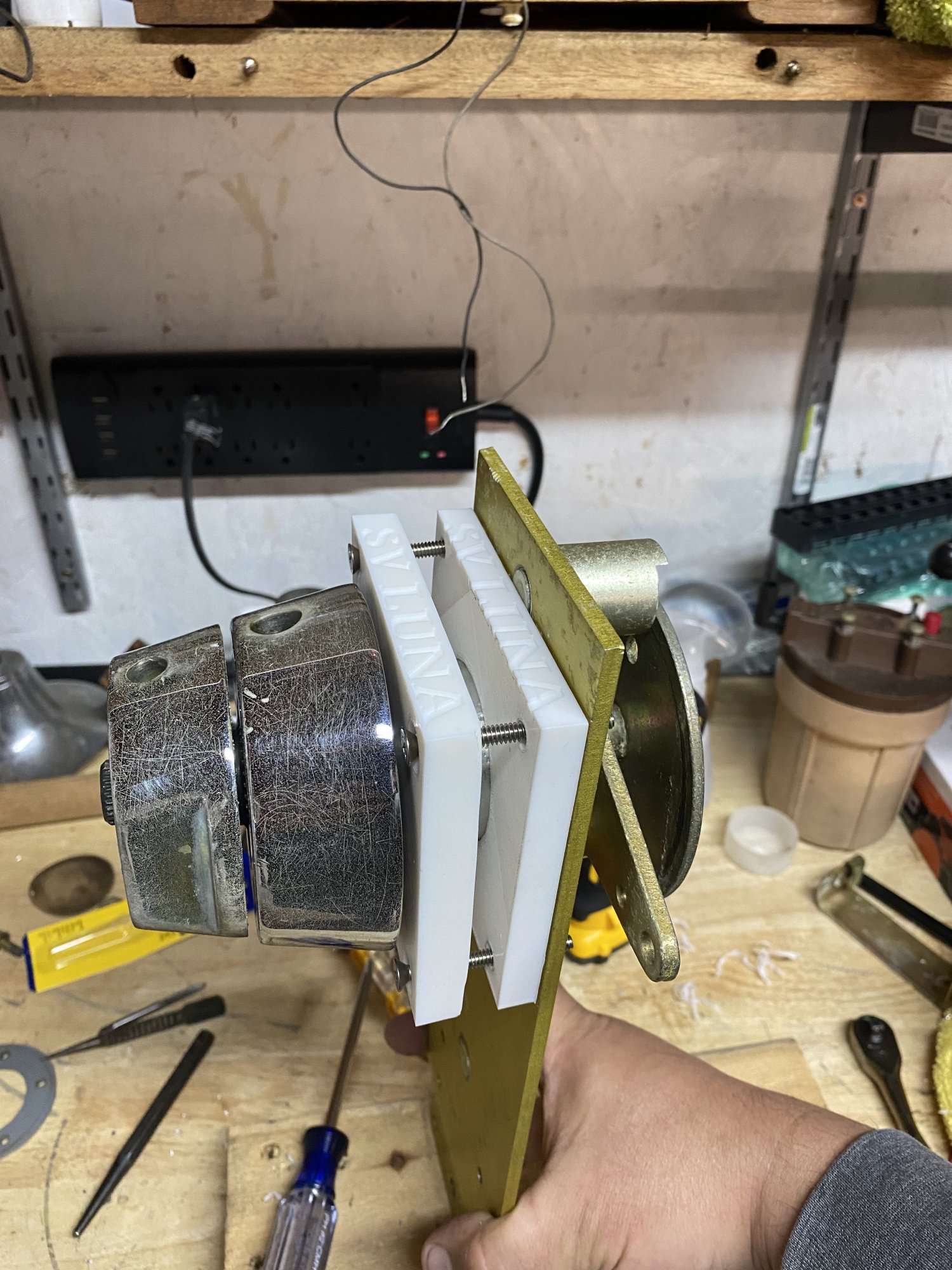

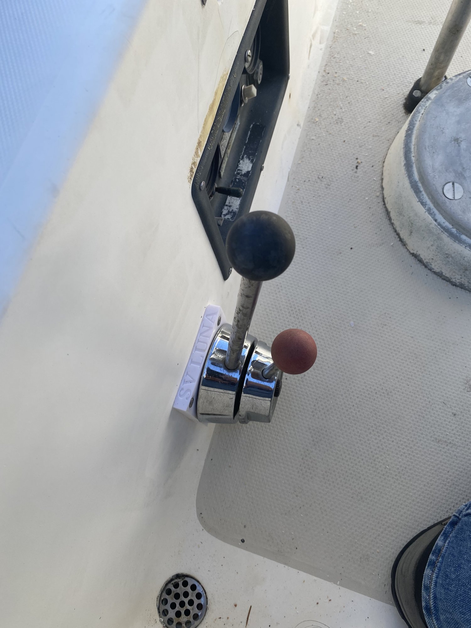

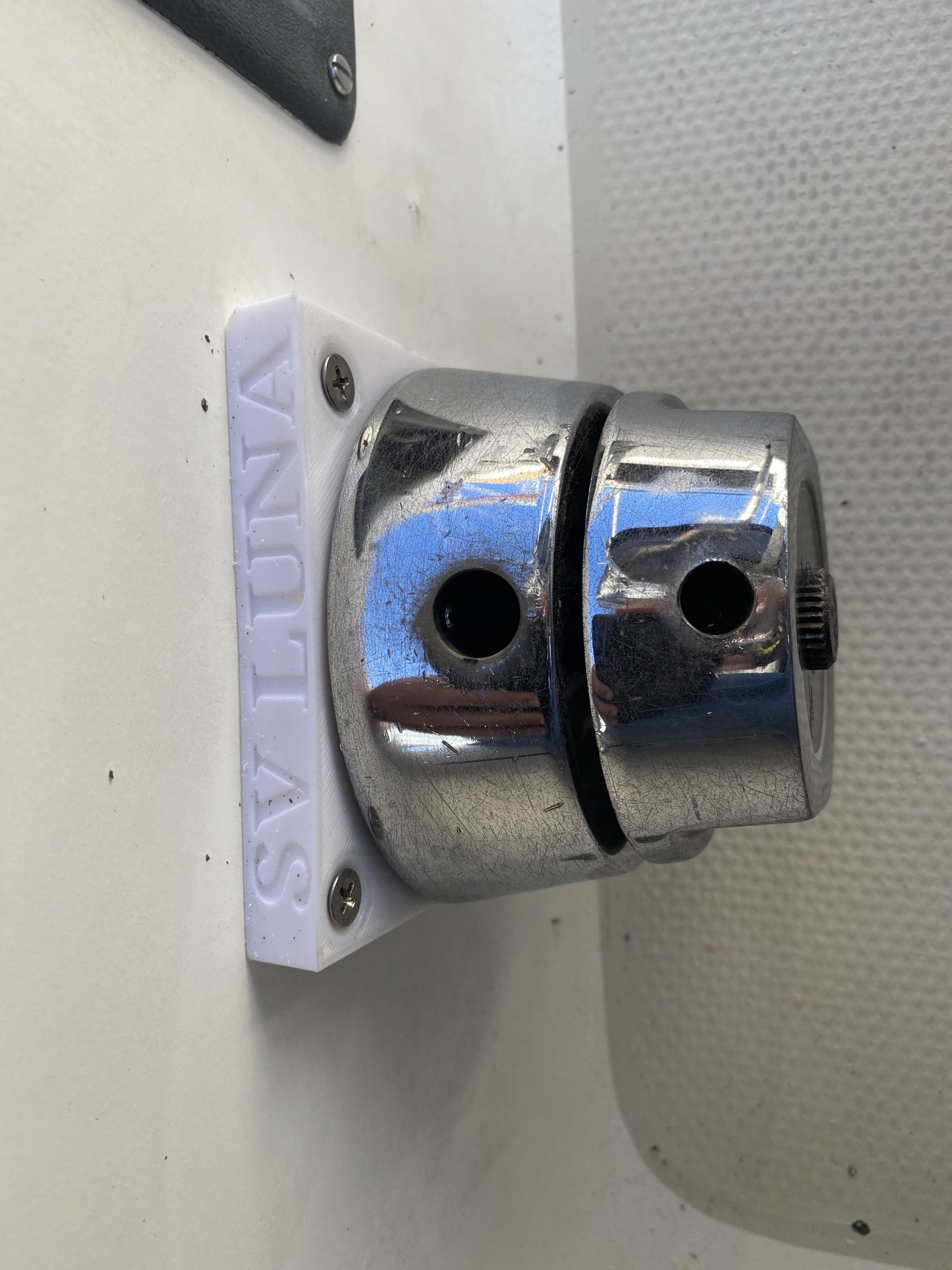

Thanks for the compliments guys, and now to give you a bit of reference on how these 2 parts are to be used. Here is my assembled throttle , and think of boat in the area with the gap.
Very nice. Are you planning some coating to help with UV exposure? My PLA prints have degraded outside significantly. (The boat ones get painted. Backyard stuff doesn't)
Not at first… The other parts I made for my MacGregor seemed to take being outside quite well, and they were the same white filament as these are made with. If there is an issue, I will simply print another and paint it.

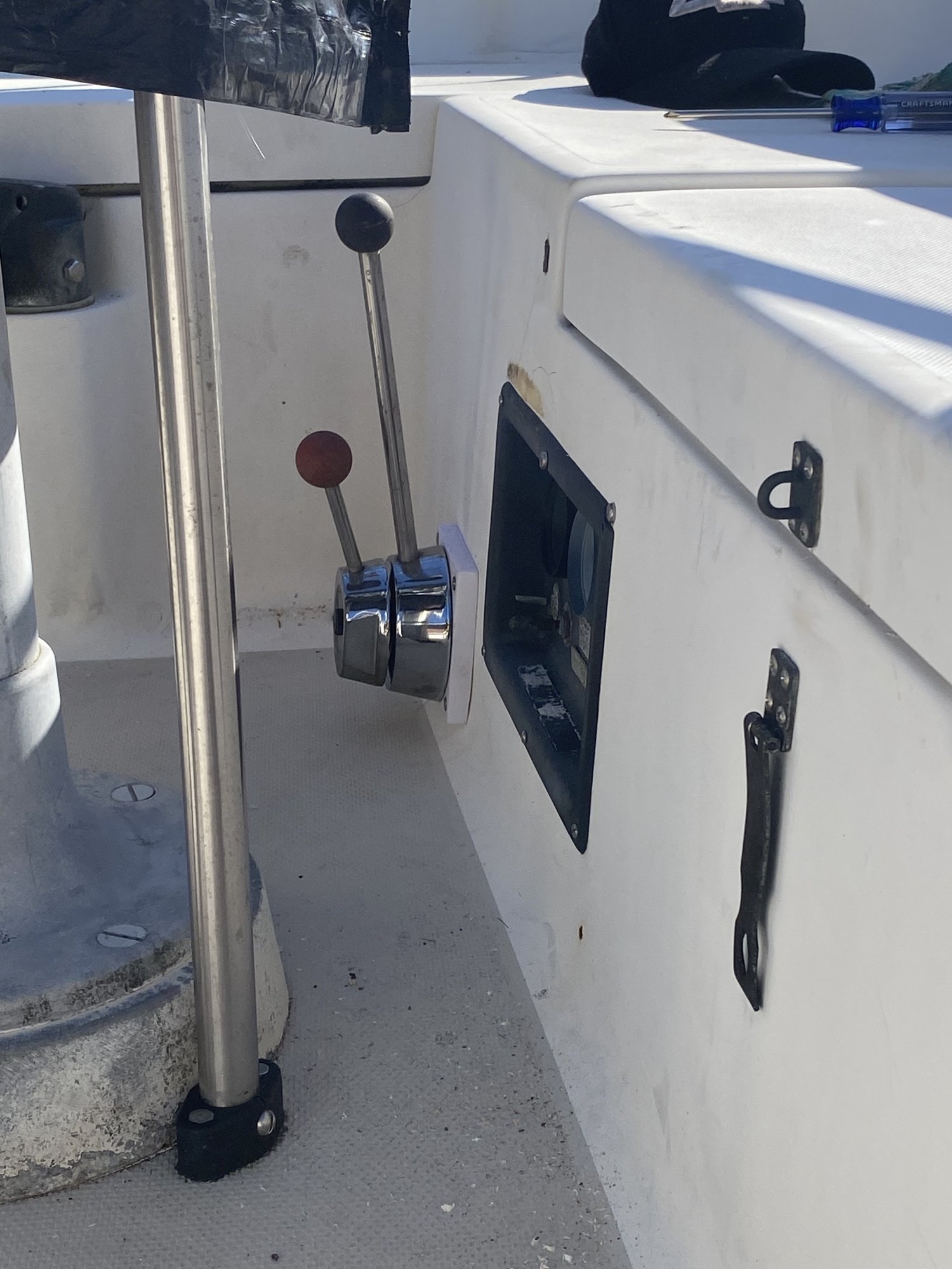

Ok, so today went pretty good. I was able to get the diesel filler hose out of the boat, but I missed WM’s closing time by 1/2 hour… oh well. They will be open again later. The hooks for keeping my ropes nice and neat work perfectly, I got 2 installed. I replaced my rope for the back stay adjustment as well. I ordered my new gauges, and cables for my engine. The cables were 11’ for the transmission and 12’ for the throttle, the original cables had readable numbers on them. I am going to modify my transmission linkage to go with the thin cable instead of the thick stupid expensive unit. And lastly I got my throttle/shifter mounted back in the boat. It fit perfectly and I am very happy with the way everything turned out.
View from the companionway.
View sitting behind the wheel
And with the sticks removed.

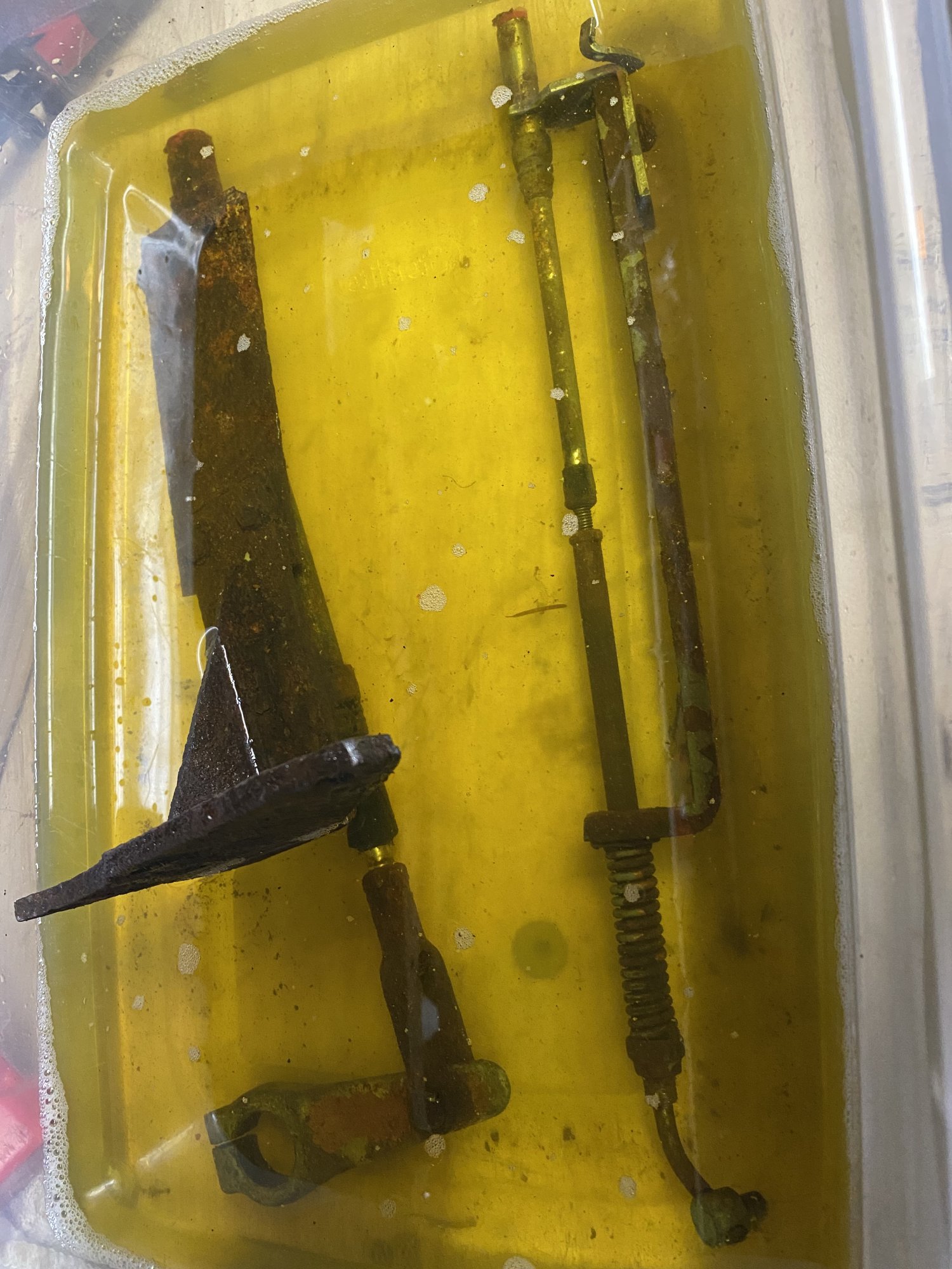

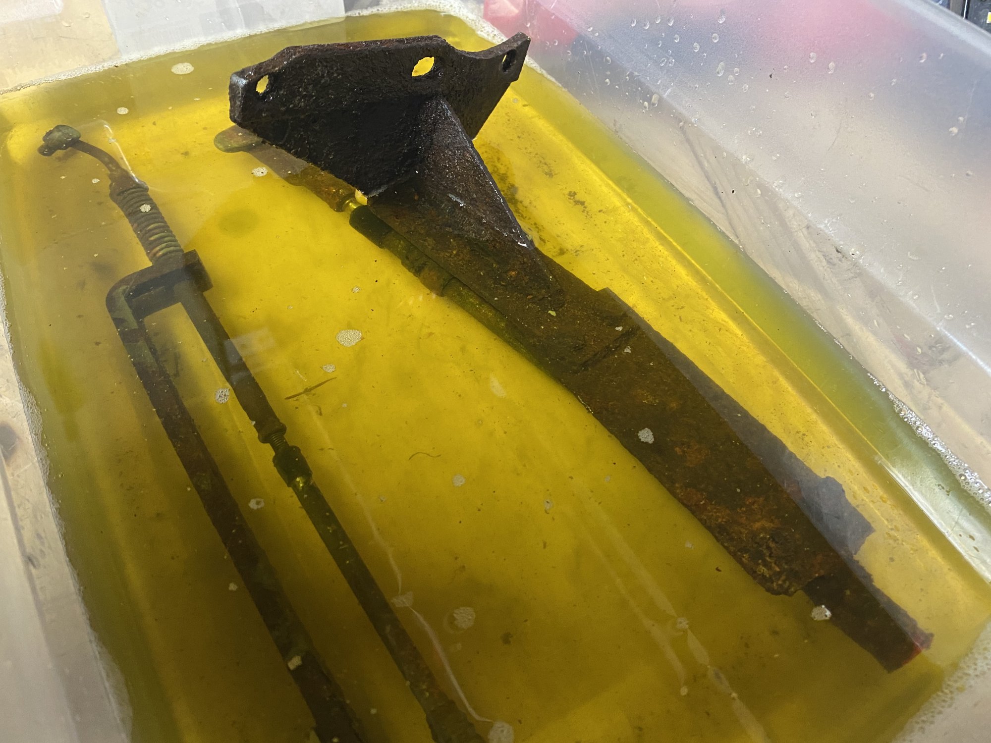

Not much to report today, I cut my old cables and set the brackets in the EvapoRust so it can do it’s thing over the next day or two. I also got new fuel filler hose and a new fuel filter/water separator. Next up will be my order from CD with my new cables and gauges. Once I have those a new panel will be in the works as will a new engine wiring harness.
Here are the before pics of the engine brackets.
