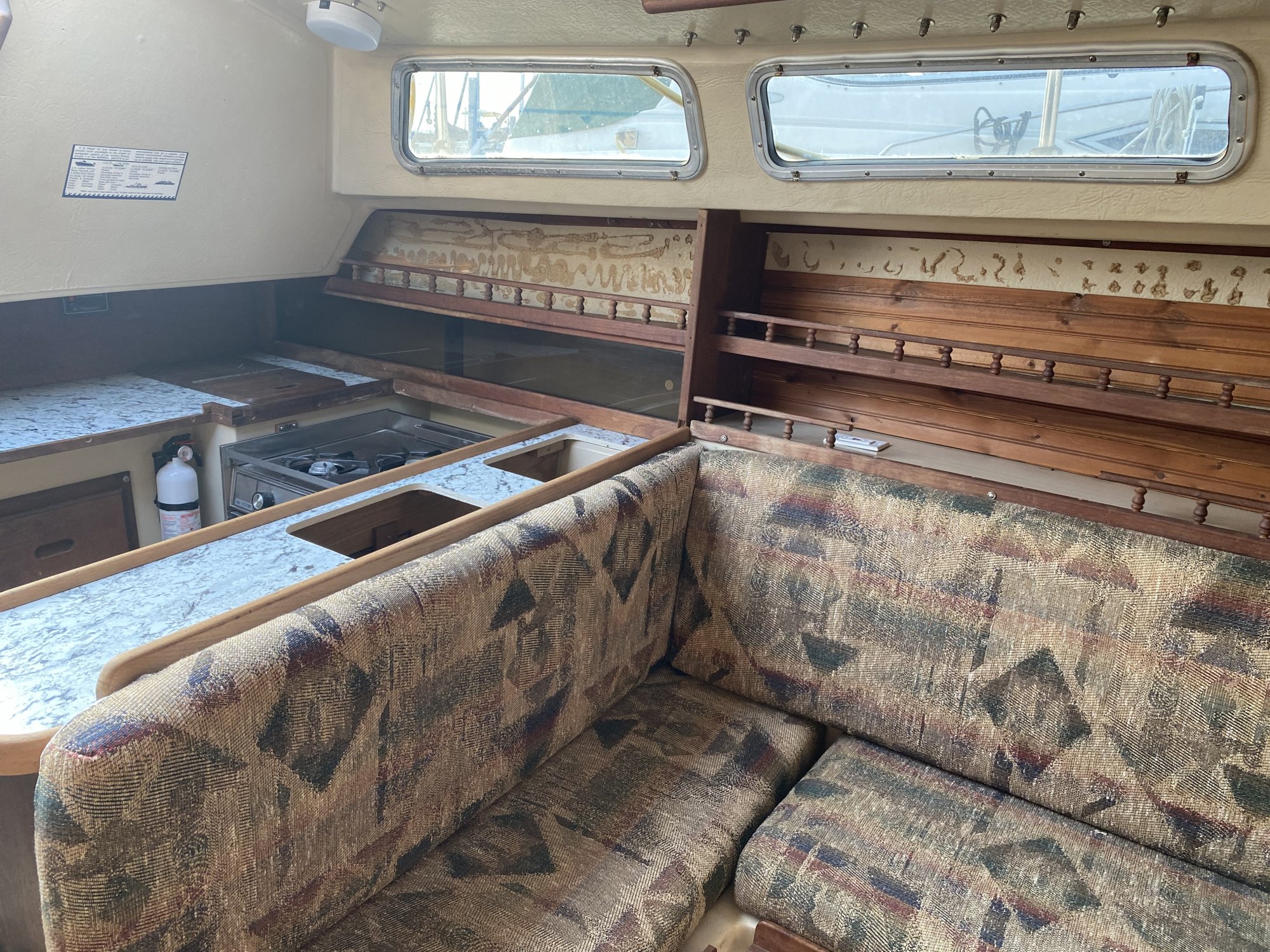

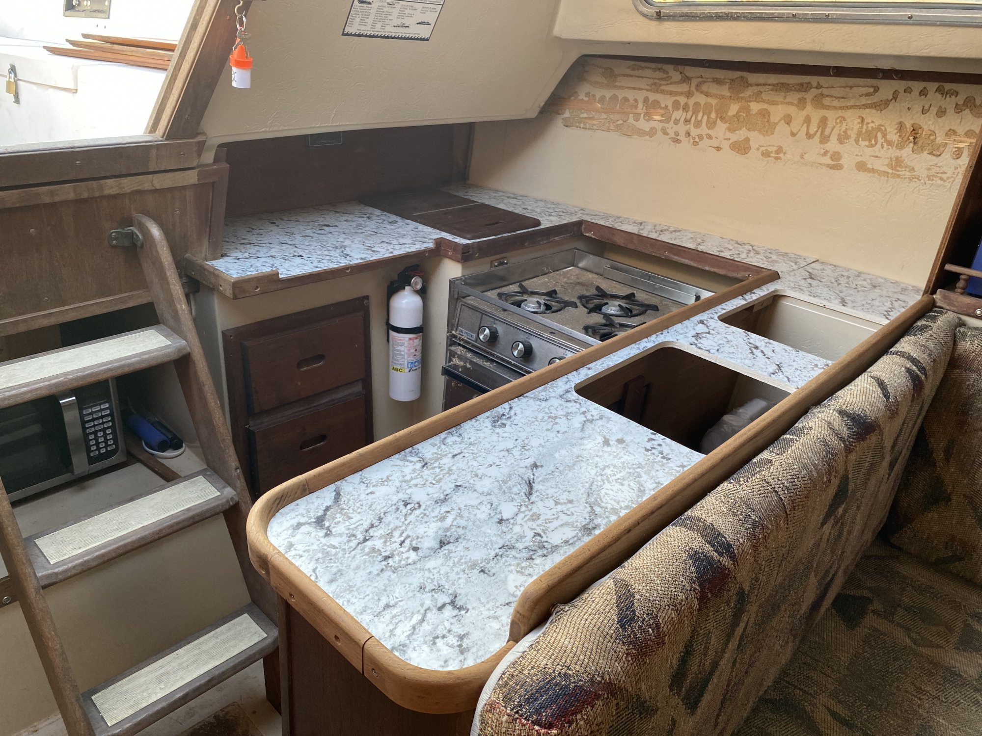

Well Luna will have a new owner by the end of the week. I’m sad to see her go but I need to. This doesn’t mean the work has stopped. I still have a bit more to do.
Countertops have been trimmed and set in, the cupboard will be next.
