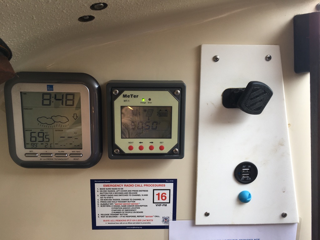

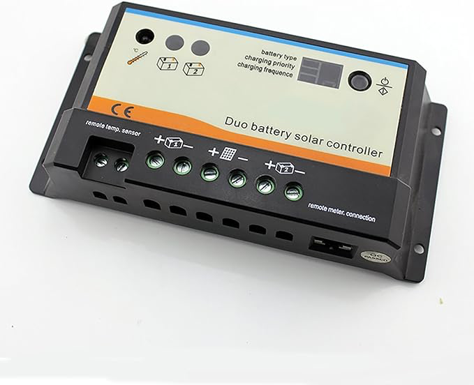

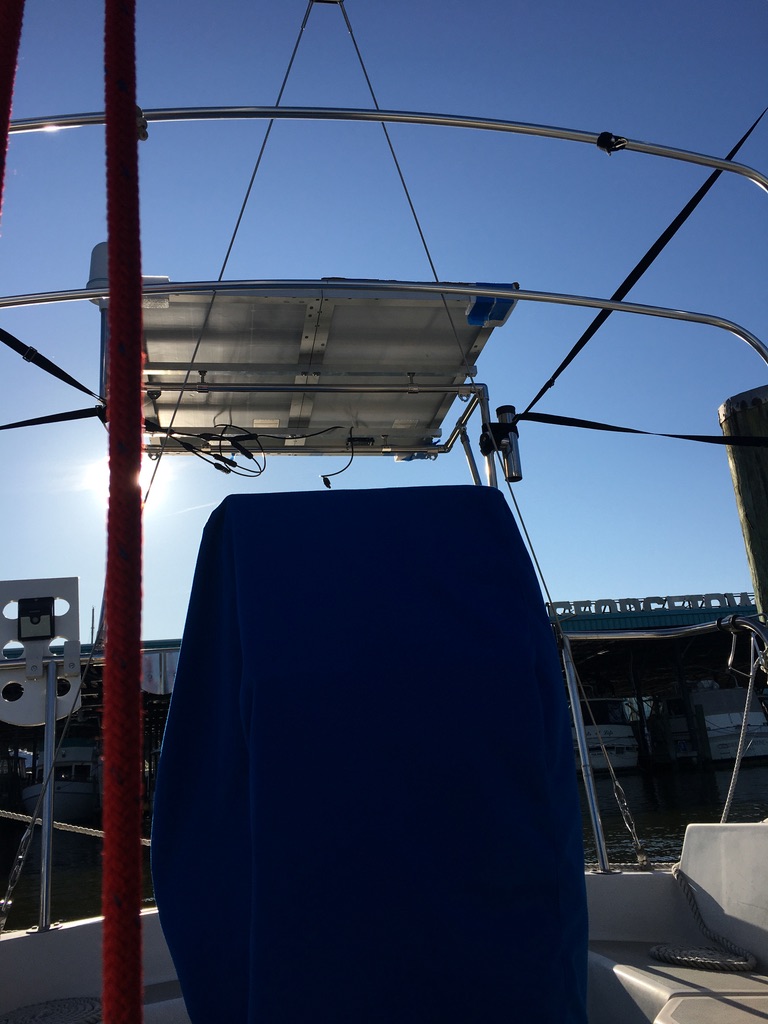

I created my own "a la carte" system which currently works for me. I have two 100W panels hooked up in parallel to a dual battery charging/monitor (20Amp), with an external readout gauge (ethernet cable connected MeTer brand). My power banks consist of two 100ah batteries connected parallel on switch #2 for a house bank to run all lights, the 1500w inverter and my electronics. On switch #1 I have a starting battery with 850 CCA, basically only used to start and as I use the engine. All batteries are lead acid as AGM and better currently don't fit in my budget (FI). The controller flips from one battery over to the other and tops up as needed. Simple, basic and inexpensive.
I've had this system in place for the last four years with no issues. It keeps my batteries topped up while I am docked and away from the boat and gives me sufficient power to enjoy long trips, albeit with frugality of use. Yes, I yearn for more, maybe one day I can make it more efficient and more powerful.

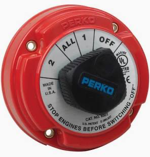

Not to pull us off course too far, but do you have to switch the battery switch to #1 when you start the engine, then back to #2 to run the house?
Or do you mean you have 2) On/off battery switches (1 for each bank)?

I switch from OFF to #1, then I start the engine and keep it there whilst the engine is in use. Once I kill the engine and say "WOW, IT'S SO NICE AND QUIET OUT HERE!" , I then switch to ALL and then over to #2.

Got it. My set up is essentially the same. I typically just run the boat (engine start and house loads) off my 215 ah “house” bank, and keep the Group 24 start battery in reserve in case I do something stupid and drain the house bank.
I am still considering the merits of wiring the start battery directly to the starter ( using an On/Off switch) and keeping the house bank wired to the 1/both/2 switch ( really just using it as a disconnect for the house bank). Just haven’t figured out if it is worth it.

The value of separating the house and start/reserve bank varies based on how much time on spends cruising and away from shore power. With the 1-2-All switch it is easy to leave the switch on All, anchor in a nice cove and wake up in the morning to dead batteries.

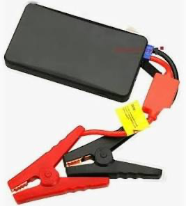

For this scenario I carry a fully charged Weego

While I don't negate the value of back up systems, I prefer to design systems to prevent the need for back up systems. An ounce of prevention is worth a pound of cure.
Separating the start and house systems is prevention, carrying jump pack is cure. A well designed electrical system will make the jump pack a tertiary back up. Start battery dead, use the house bank; house bank dead use the jump pack. With a separated system the odds of having both banks go bad is much lower and reduces human error which the 1-2-all system doesn't do.

Taking it a step further to make it idiot proof, add a battery combiner (voltage sensitive relay) between the start and house banks. It joins the battery banks when it senses voltage at 13.2 or above (at float or bulk levels, but not at discharged levels). Connect the start battery to the alternator (with on-off switch) and any other charge sources (shore power, solar power etc) to the house bank. With this setup the house bank gets charged by the alternator when the start battery is full, and the start battery gets charged by the auxiliary power sources when the house bank is full.
