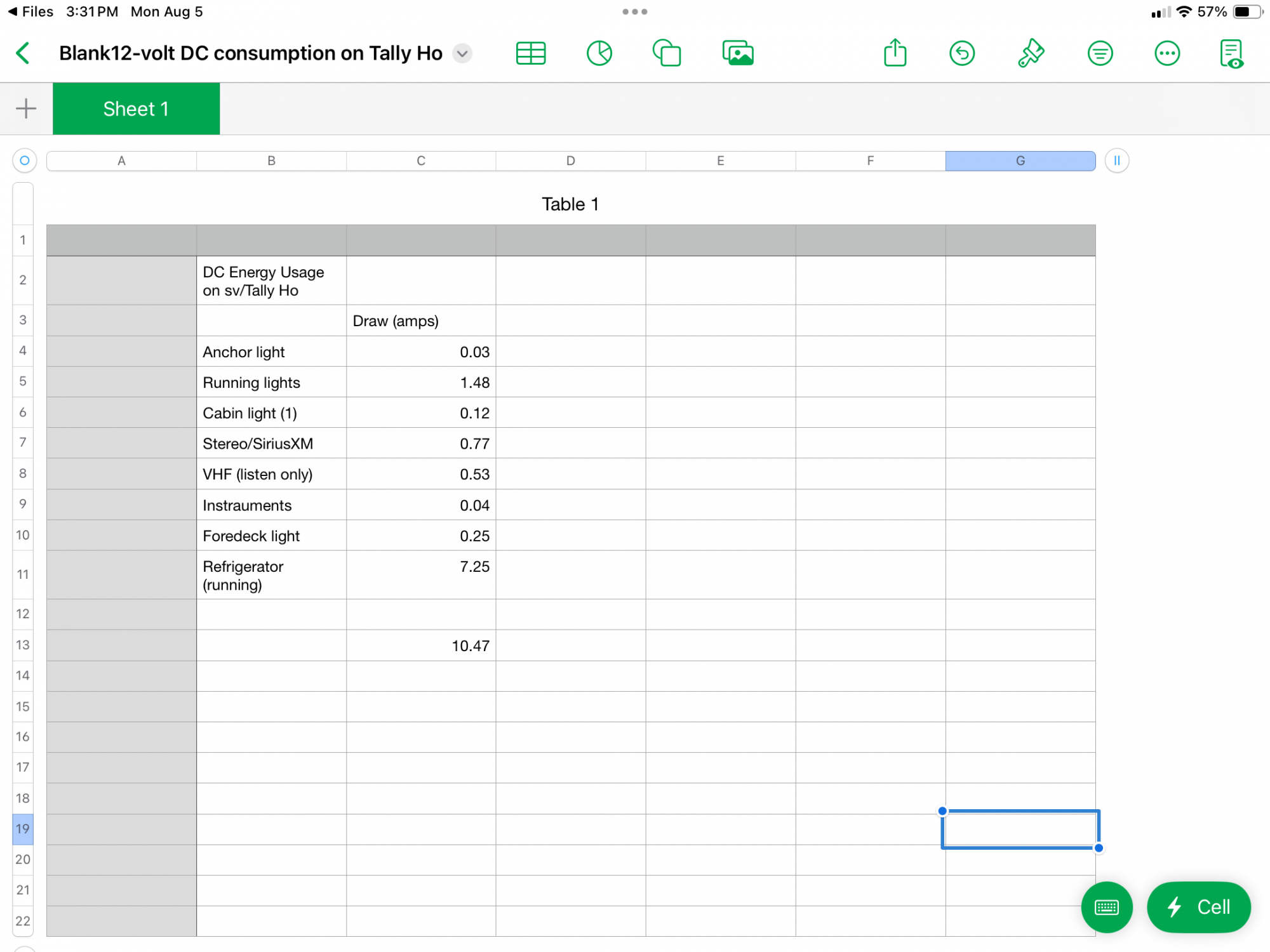

It sounds like your power needs are very light then. No refrigerator, which is one of the biggest draws.
I started to make a chart of power consumers on my boat (I am not an electrician either, but I do have a cheap clamp meter and a Renogy battery monitor that help figure out how much power is being used). Again, for your needs, you don’t need too much.
Lots of options out there. @BarryL gave a link that has a lot of different options for panel size.
