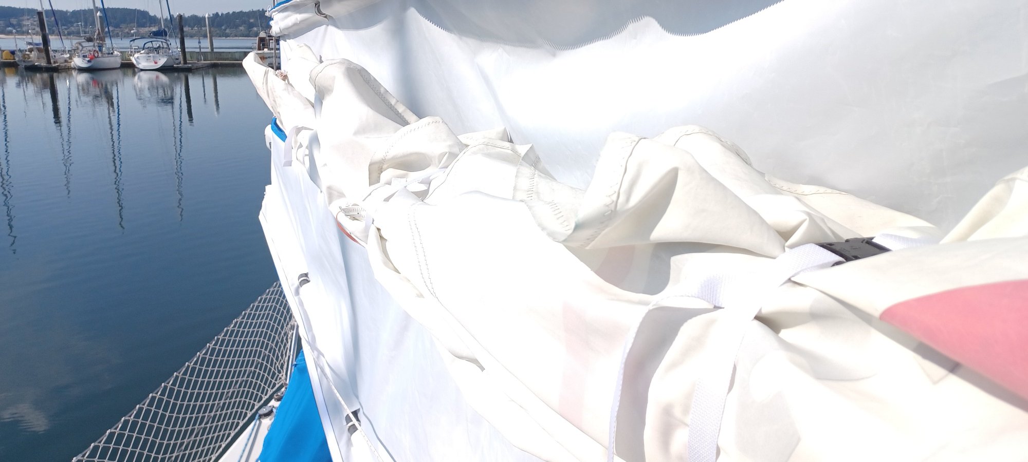

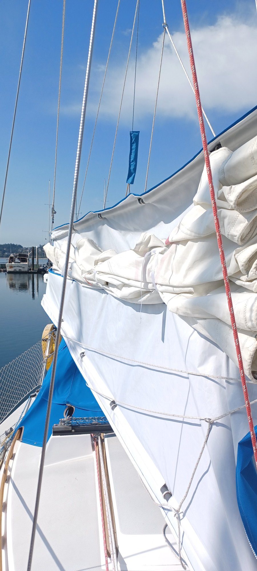

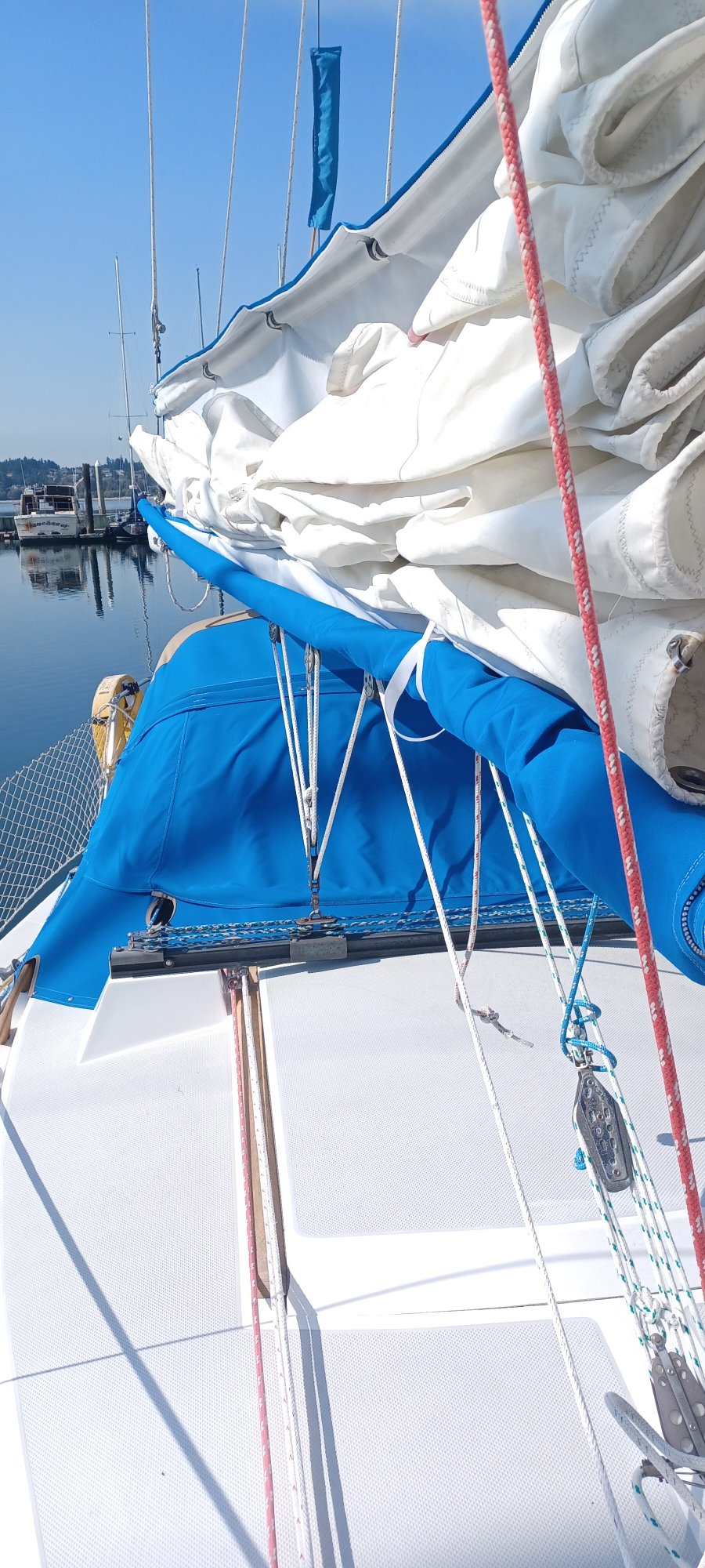

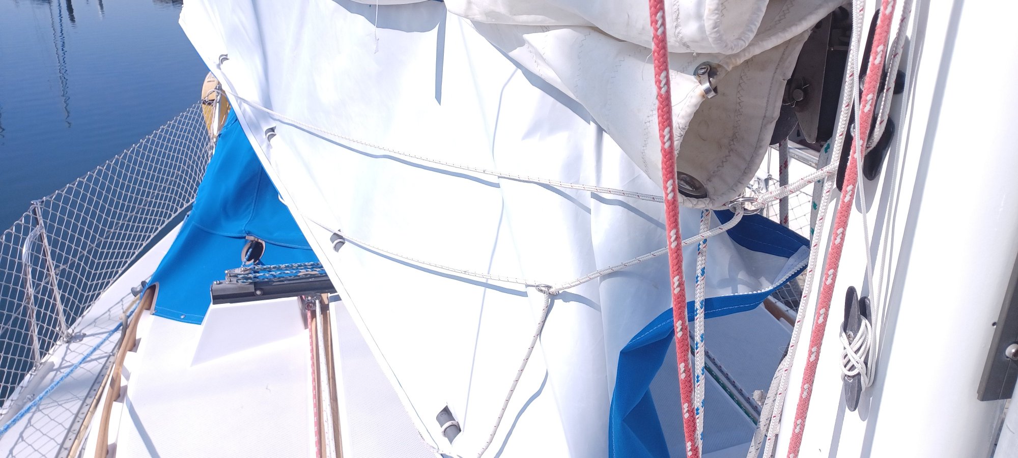

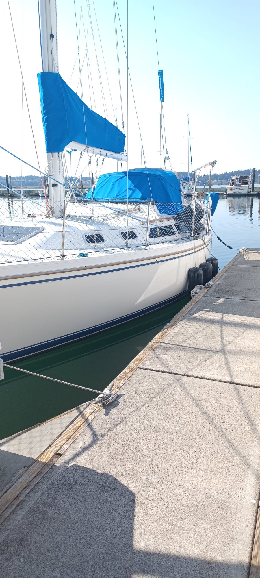

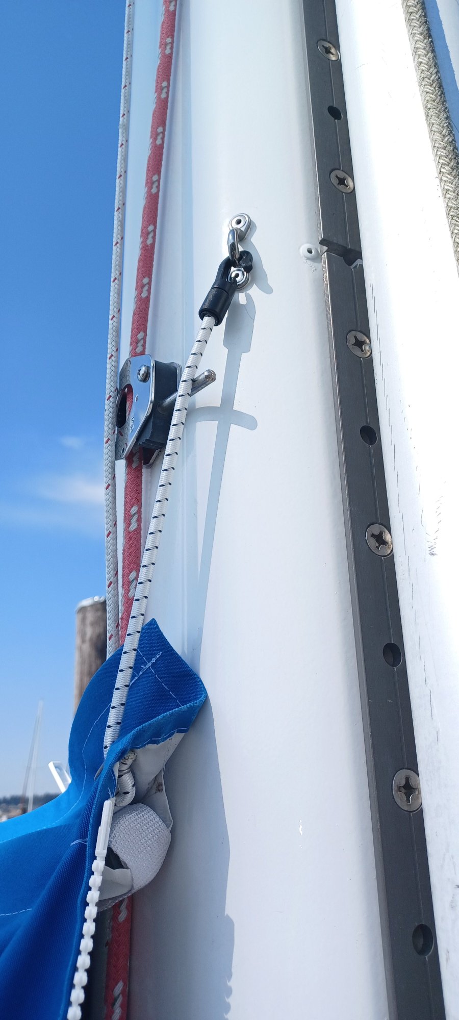

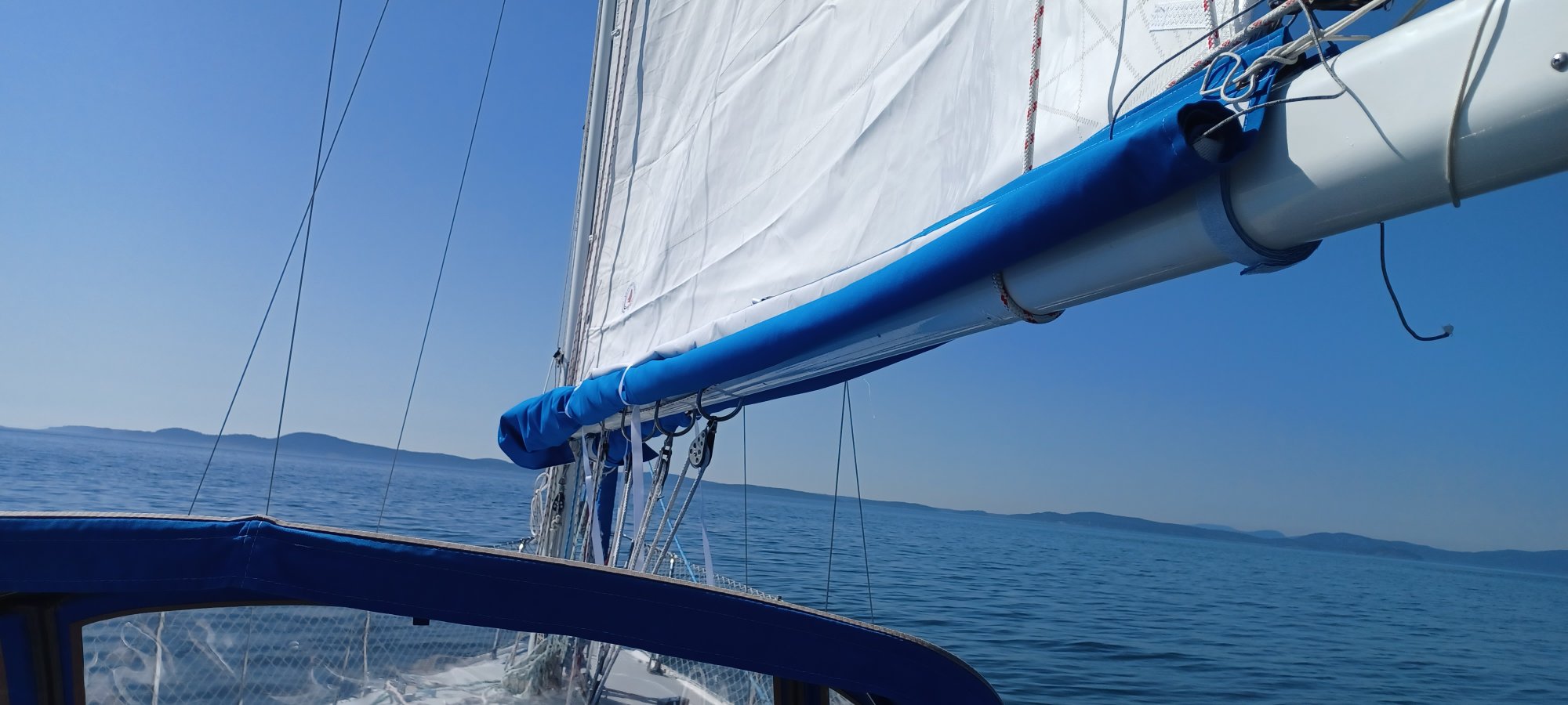

When I built my Pap-Pac, I wanted something that would maintain the advantages of the EZJax. My pac can be stowed by pulling the jax forward to the mast so that they did not interfere with raising the mast or trimming the loose footed main. I lower the jax and pull them forward, then roll the pac up and secure the roll with sail ties that are attached to the bottom edge of the pac. Here are some photos of the system.
Finished Pap Pac
Padeye and bungy to hole up front edge
Pac with one side dropped down. Note that inside is lined with sailcloth which provides a great deal of abrasion resistance which Sunbrella does not have and makes the inside much more slippery so that the sail slides inside easier.
Sail tied to boom with integral sail ties. These ties have an adjustable long leg on the inside and a fixed short leg on the outside. The clips on these ties are opposite on each side. To tie the sail to the boom, the inner ties are adjusted out long enough to reach over the sail. To tie the pac to the boom, the inner tie is adjusted short so that it fits snuggly around the rolled up pac.
Jax pulled forward in preparation for rolling up pac.
Starboard side pac rolled up and secured with integral sail ties.
Pac rolle and jax stowed for sailing.
