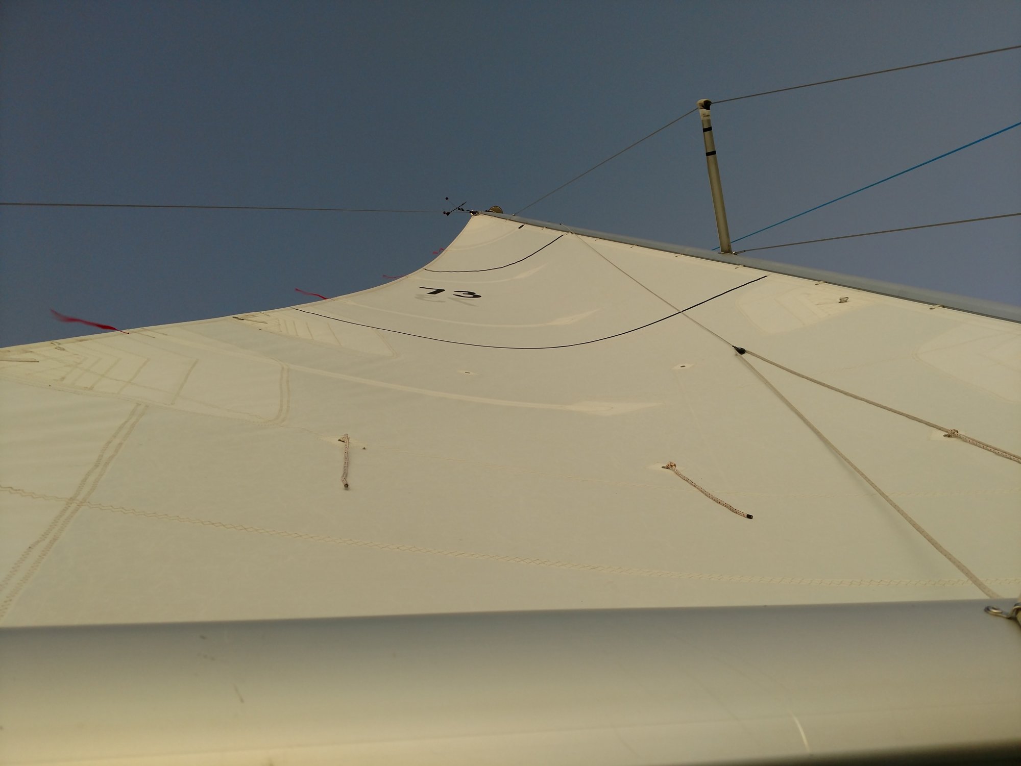

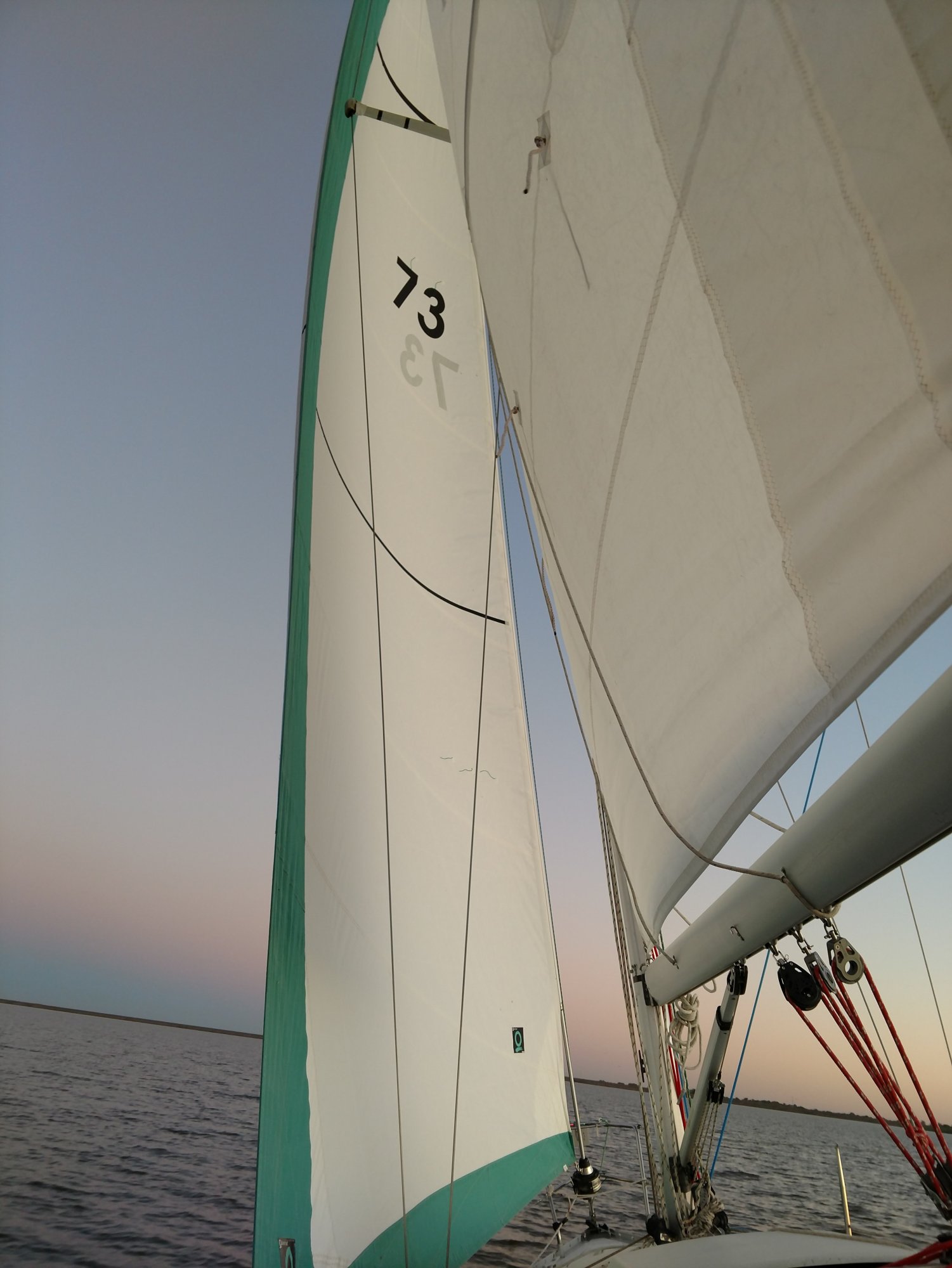

I have two on my 31. Cable comes down from the upper part of the mast to a small block. Jack line runs up from the forward end of the boom through the block and back down to the boom just behind the aft turning block for the mid mounted mainsheet. See the pics. Works sufficiently. You do have to gather the tail end of the sail when it's dropped but that does not seem to be a problem.
Quantum Jib 13 Apparrent IMG_20171025_185009196.jpgQuantum Main 13 Apparent IMG_20171025_184955618.jpg

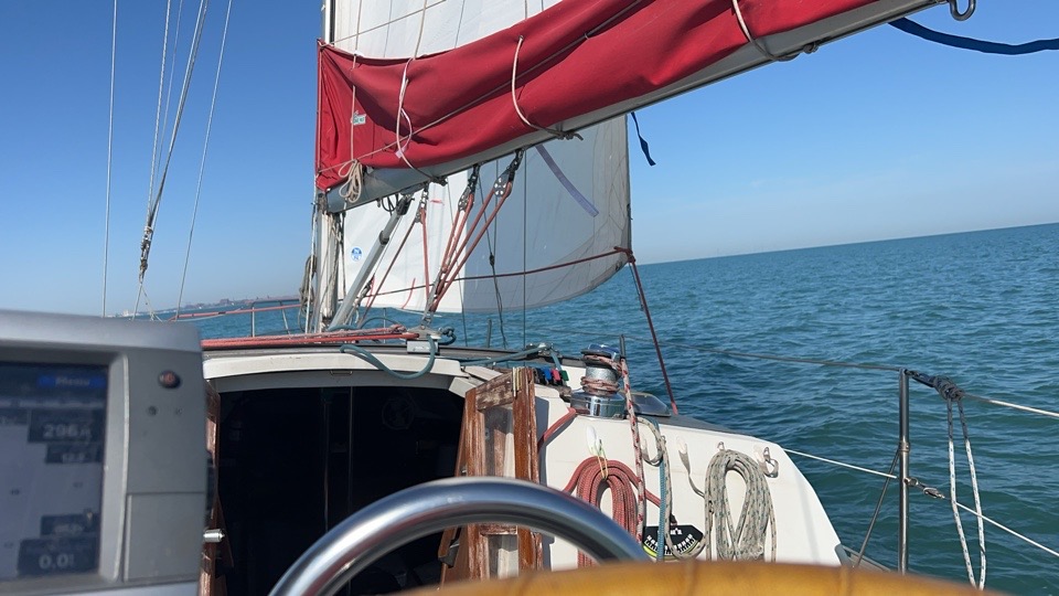

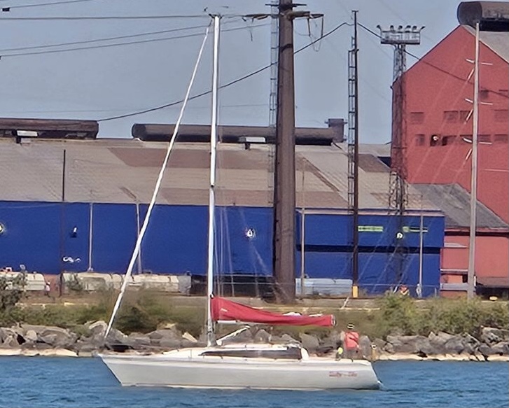

I have 3 on my O’Day 322 and in conjunction with my Mack Pack, it works well for dropping the main sail.
Not great photos, but you get the idea. On the bottom photo, I was coming in from a sail, dropped the main into the Mack Pack and had it pretty much all put to bed before I got back to the marina.
If anything, adding a 4th leg (or spacing my 3 legs out a bit more) would help keep the tail end of the sail on the boom. Everything else pretty much falls in place.

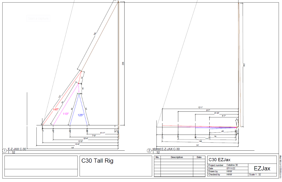

Before I built my Pap-Pac, I used a set of EZJax that were on my boat when I got her. With them, they are designed to be in the stowed position along side the boom except for the few minutes when the sail is being dropped and the sail ties put on. Once the sail is secured to the boom, they are stowed. This is nice because then you use a normal sail cover that does not need to be modified for the jacks.
Here is a drawing I made for the C30 group. You would want to make the lines a little shorter for your C27 but otherwise it would be the same. The construction is just 1/4" line, some SS welded rings or similar, a couple of cheek blocks and a couple of cleats.

It sounds like my EZJax solve or eliminate all of your concerns.
  • No modification to the sail cover
  • Nothing to foul the leach of the sail when hoisting.
  • No messing with the boom while hoisting.
  • No lines to chafe against the sail while sailing.
  • Nothing to interfere with tensioning the outhaul tension.
  • Support to the full length of the sail foot.
  • Fully captures the excess fabric when reefed if you deploy the Jax before reefing.

I installed the EZJax, LazyJacks system, shown by @Hayden Watson on my boat. They work exceedingly well.
