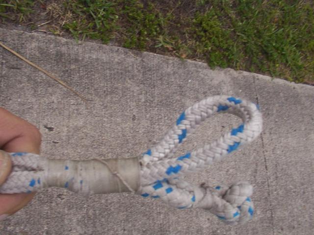

I am surprised that there was only one vote for soft shackles. They are smaller and cleaner (as they don't get tangled on the shrouds).
Marek
Gunni
Mar 16, 2010
5,937
Marek
That is an elegant solution, however it requires a special eye splice on the sheet. Perhaps OK if I was using single braid, or a racer looking to reduce weight, but I don't want to be fussing with splicing new jib sheets into my old double-braid if I break or damage them.

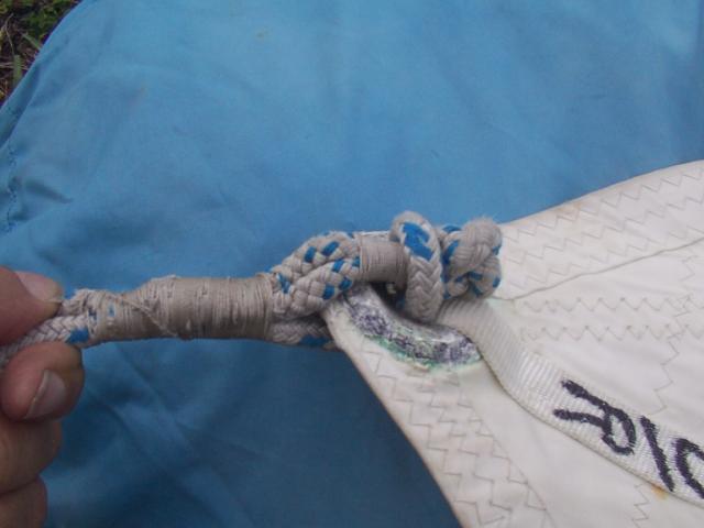

Here's what I've used for years. My jib has reef points, so this makes it simple to,move the sheets up to the reefed clew point. I have never ever had this come loose. Also makes it simple when I change from working jib, to genoa
Well, that's an interesting approach.
8,141
This knot appears to be overly large to me. And, I would be concerned that after tensioning it might be difficult to break. The website also Rx's an additional stopper knot on the tail. That would make it even larger. What is the advantage over the bowline?

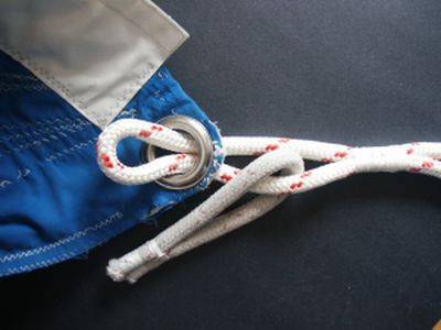

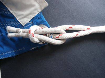

Thank you all for the awesome responses. I seriously appreciate your input. After some minimal research and minor considerations, I believe this may be the better solution for my needs, using the soft-shackle approach and one line.
How does this seem to you all?
Feb 20, 2011
8,062
I think I would shorten up the main loop some, requiring some finagling of the locking stub.
In essence, you should need to bend the stub fairly severely in order to get it in/out of its working position.
Make sense?
